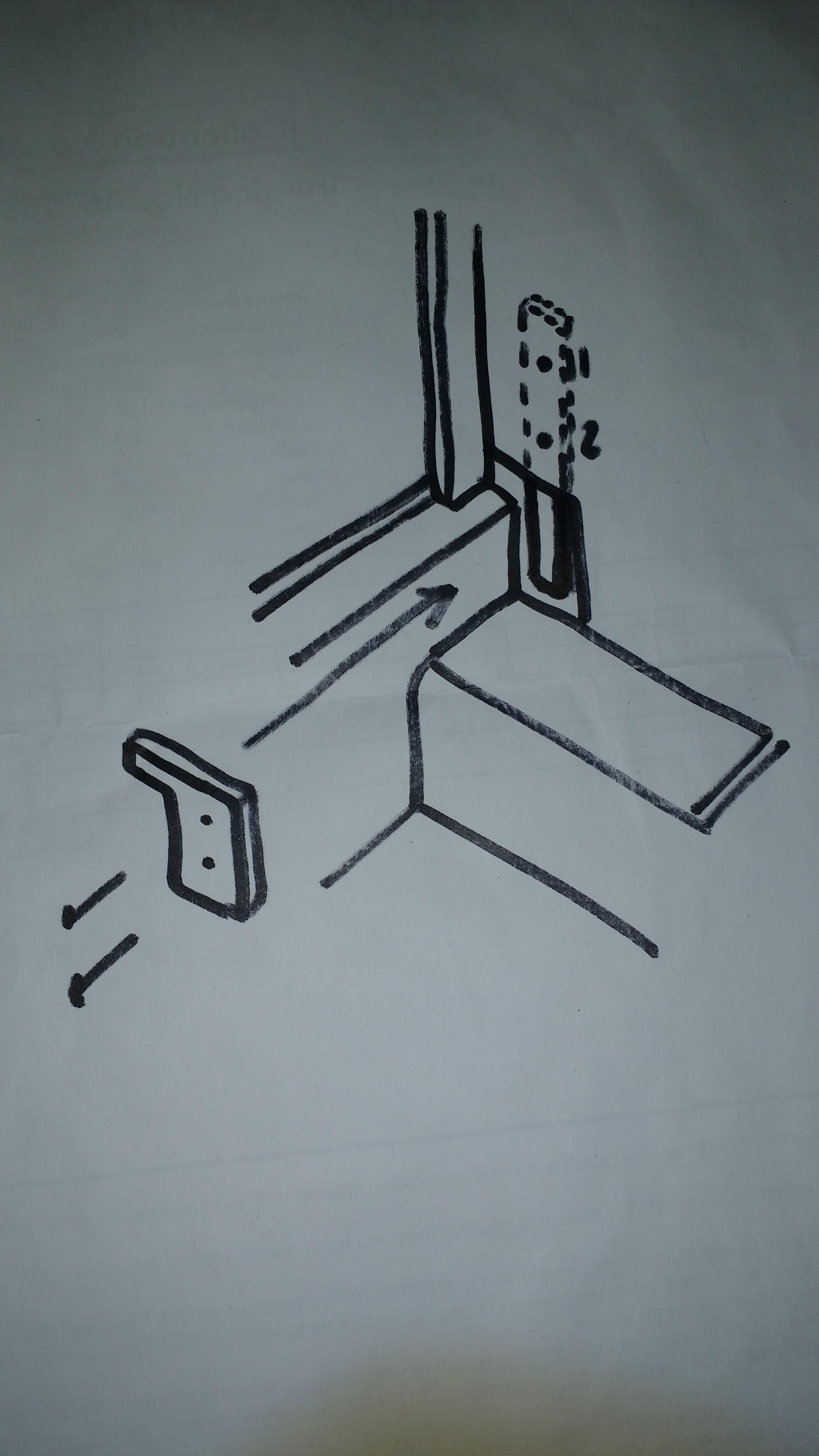

Please can someone advise how best to fill the gap/hole between my shower and wall? I have very little diy experience so don’t want to start ripping things out. As you can see from the picture below, the previous owners have done a bit of a bodge job and the hole was badly filled using mesh tape and a lot of uneven plaster which I’ve now removed.
I have watched videos where plasterboard is glued behind and then plastered over but I don’t know how I can actually get a large enough piece in the hole as it needs to sit behind the shower tray.i don’t think I’m explaining this well but hope you can see from the photo.
is there another easier way of filling that gap?
Also, any ideas how I can deal with the dodgy inch or so of plastic trim that looks so bad?
Any advice greatly appreciated.

Cut a piece of timber batten and slip it behind the existing plasterboard at an angle and fix through either end with a screw.  If the hole if too fiddly for you to get in, mark it out and cut it bigger.  Cut a new piece of plasterboard the size of the hole and screw it to the batten.  Fill, sand, repeat.  Paint.

What they said! A strip of softwood say 1" x 1/2" or similar. Stick it up inside the cavity, vertically or horizontally, it doesn't matter. You might want to drill through the plasterboard and into the strip first to pilot it and stop it splitting when you put the screws in. Two plasterboard screws at 1&2 to hold it. Then cut a piece of pb to fill the gap. You can either screw or stick that to the wood. Leave a nominal gap around the infill piece. I usually fill the gap with something like No Nails, Sticks Like Sh!t etc. Then fill over the top and sand/paint.
Why is that bit missing, the shower isn't leaking there is it?
If only self assembly drawings where so clear
  • Thanks 1
Thank you for the detailed reply and picture, very helpful.

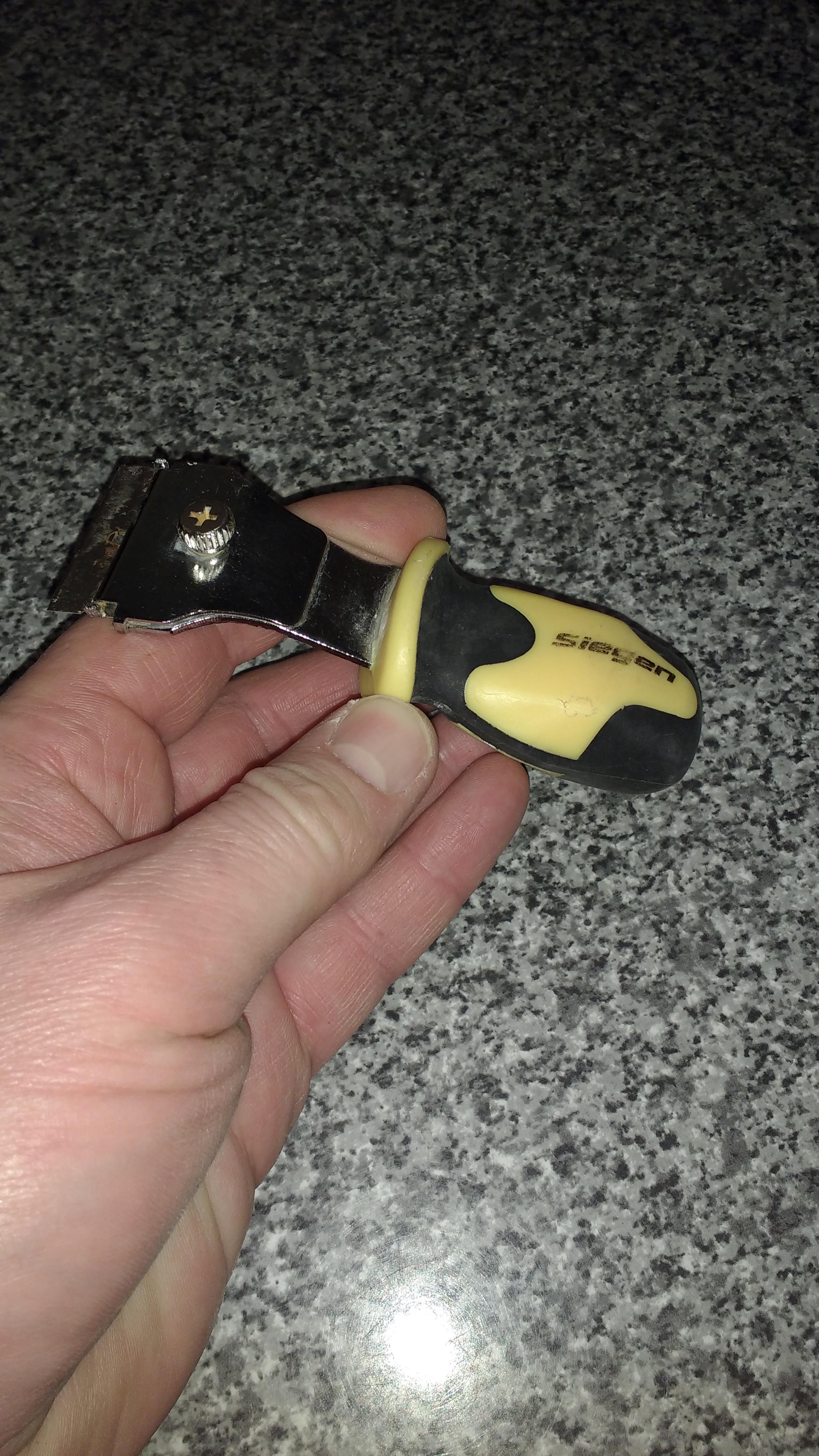

Removing sealant...horrible job!
Combination of removing the bulk with a tool something like this, which I have but don't particularly rate:
https://www.screwfix.com/p/vitrex-sealant-remover-profile-kit/82791?
A glass scraper with removable blade, not the sort that takes a Stanley blade but something like this. FFS don't use on "plastic" but just carefully on tiles.

Thanks again everyone for all the advice. I managed, after a bit of fiddling and swearing, to fix a piece of board in the gap and then glue a shaped piece of plasterboard onto it. Have to say I was very proud of myself for that! I’ve spent the last few days layering on filler and waiting to make sure it was dry. Just need to sand and paint now.

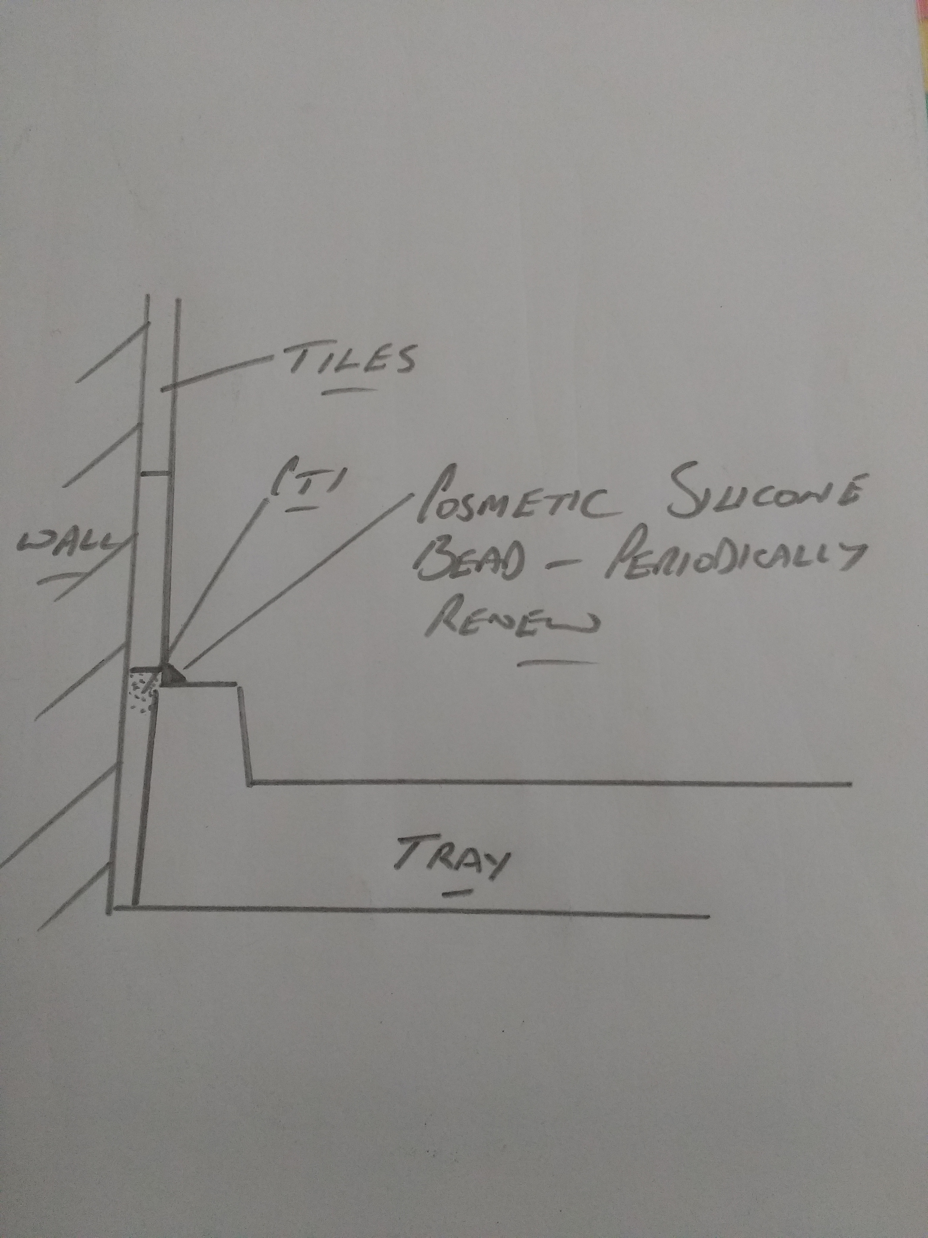

Yes, something like this:
When the silicone gets grubby, renew it.
How far off the tray do your tiles finish out of interest?

Btw, you want to aim for no more than 5mm silicone bead of silicone if you can. When I say 5mm as in using a "5mm" tool. Buy the Fugi Cramer silicone tooling kit. It allows even a novice (like me) to get excellent results.
You do not need soapy water or a wet finger!
Thank you, I hope with Sikaflex, layer of clear CT1 and then final BT1 bead it'll be super protected. Regarding the tiles, some are almost on the tray and some have gaps up to 3/4mm
