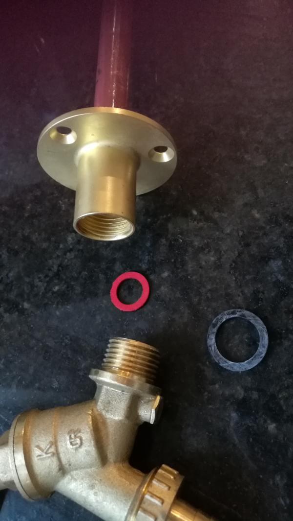

AlanUK Posted January 24, 2021 Share Posted January 24, 2021 Here's a basic plumbing question for you. I have this outdoor tap, and pipe with a connected fitting. How do I attach the tap to the fitting without it leaking? I've tried the rubber washer on the outside of the tap thread, and the fibre washer on the inside, and it still leaks under low pressure. Should I be using PTFE tape on the thread perhaps, or am I using the wrong kind of washers? Thanks. Link to comment Share on other sites More sharing options...
PeterW Posted January 24, 2021 Share Posted January 24, 2021 PTFE - washer won't work as its not designed for them. A good 10-15 wraps too..! 2 Link to comment Share on other sites More sharing options...
joe90 Posted January 24, 2021 Share Posted January 24, 2021 Wot @PeterW said, plus, I like to fit the tap to the pipe before the pipe is fitted, this means the tap can be vertical which is difficult to achieve after the pipe is fitted . 1 Link to comment Share on other sites More sharing options...
PeterW Posted January 24, 2021 Share Posted January 24, 2021 2 minutes ago, joe90 said: Wot @PeterW said, plus, I like to fit the tap to the pipe before the pipe is fitted, this means the tap can be vertical which is difficult to achieve after the pipe is fitted . Tend to use compression or push fit elbows on the other end for this very reason..! 1 Link to comment Share on other sites More sharing options...
AlanUK Posted January 24, 2021 Author Share Posted January 24, 2021 Thank you both. I did wonder about getting it vertical, and was planning on doing what you said Joe. Pete, do compression fittings allow the pipe to be rotated in the fitting after it's connected, or do I still have to get the tap put on first? Link to comment Share on other sites More sharing options...
Onoff Posted January 24, 2021 Share Posted January 24, 2021 I fitted the same here: @Nickfromwales said: Put about 25-28 turns of ptfe and turn it into the socket until snug and vertical. End of job. Don't overshoot and back turn it or you'll fack it up Link to comment Share on other sites More sharing options...
joe90 Posted January 24, 2021 Share Posted January 24, 2021 19 minutes ago, AlanUK said: Thank you both. I did wonder about getting it vertical, and was planning on doing what you said Joe. Pete, do compression fittings allow the pipe to be rotated in the fitting after it's connected, or do I still have to get the tap put on first? Fit tap to pipe with ptfe tape, insert into hole in wall and fit screws/rawlplugs, cut pipe to length, fit compression or push fit pipe fitting to water pipe indoors ? Link to comment Share on other sites More sharing options...

PeterW Posted January 24, 2021 Share Posted January 24, 2021 3 hours ago, AlanUK said: Thank you both. I did wonder about getting it vertical, and was planning on doing what you said Joe. Pete, do compression fittings allow the pipe to be rotated in the fitting after it's connected, or do I still have to get the tap put on first? No - just tend to tighten it up to nip the olive then back it off so you can rotate the pipes perfectly level. Then screw the backplate on and tighten up the elbow. 1 Link to comment Share on other sites More sharing options...
