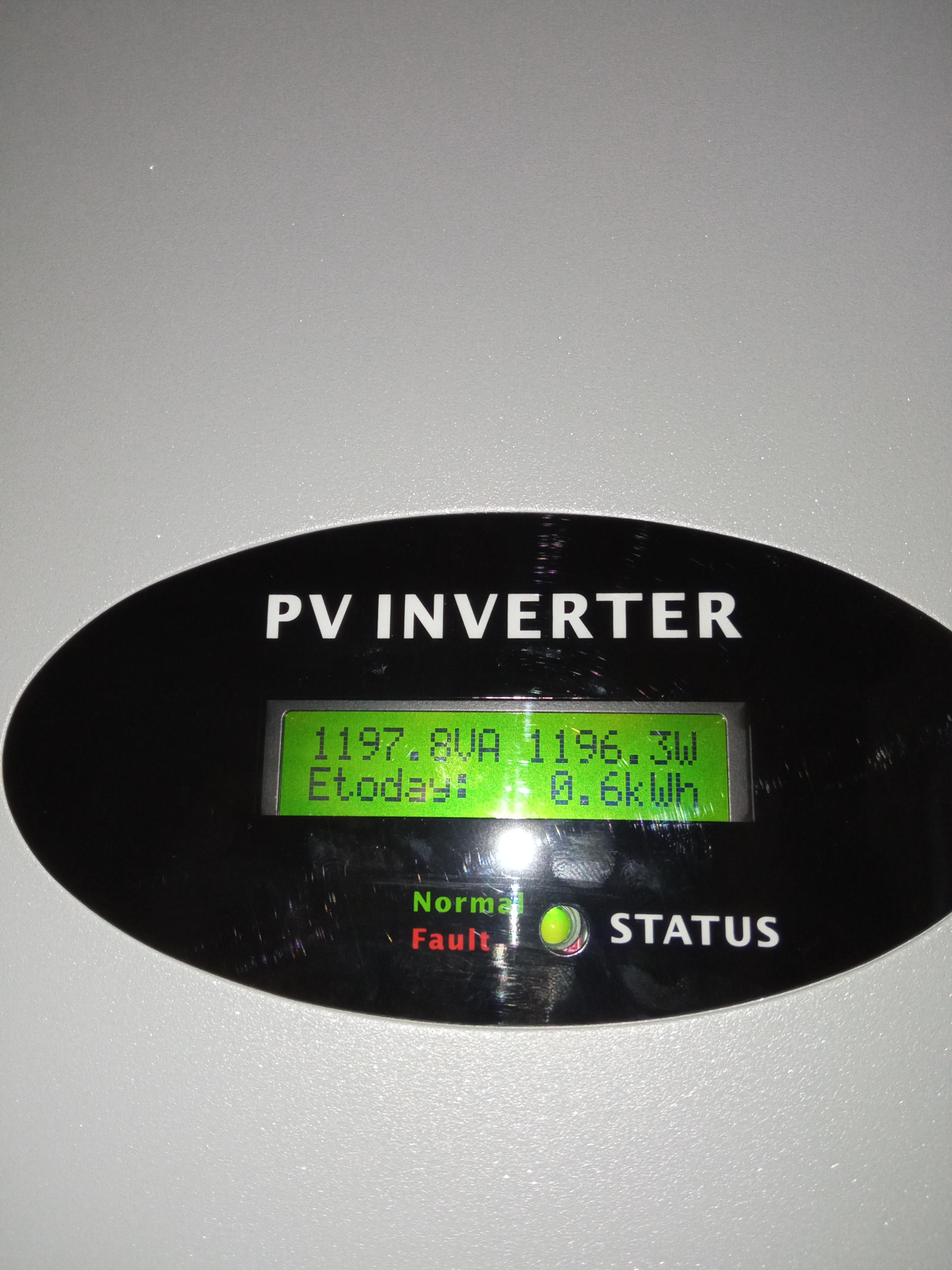

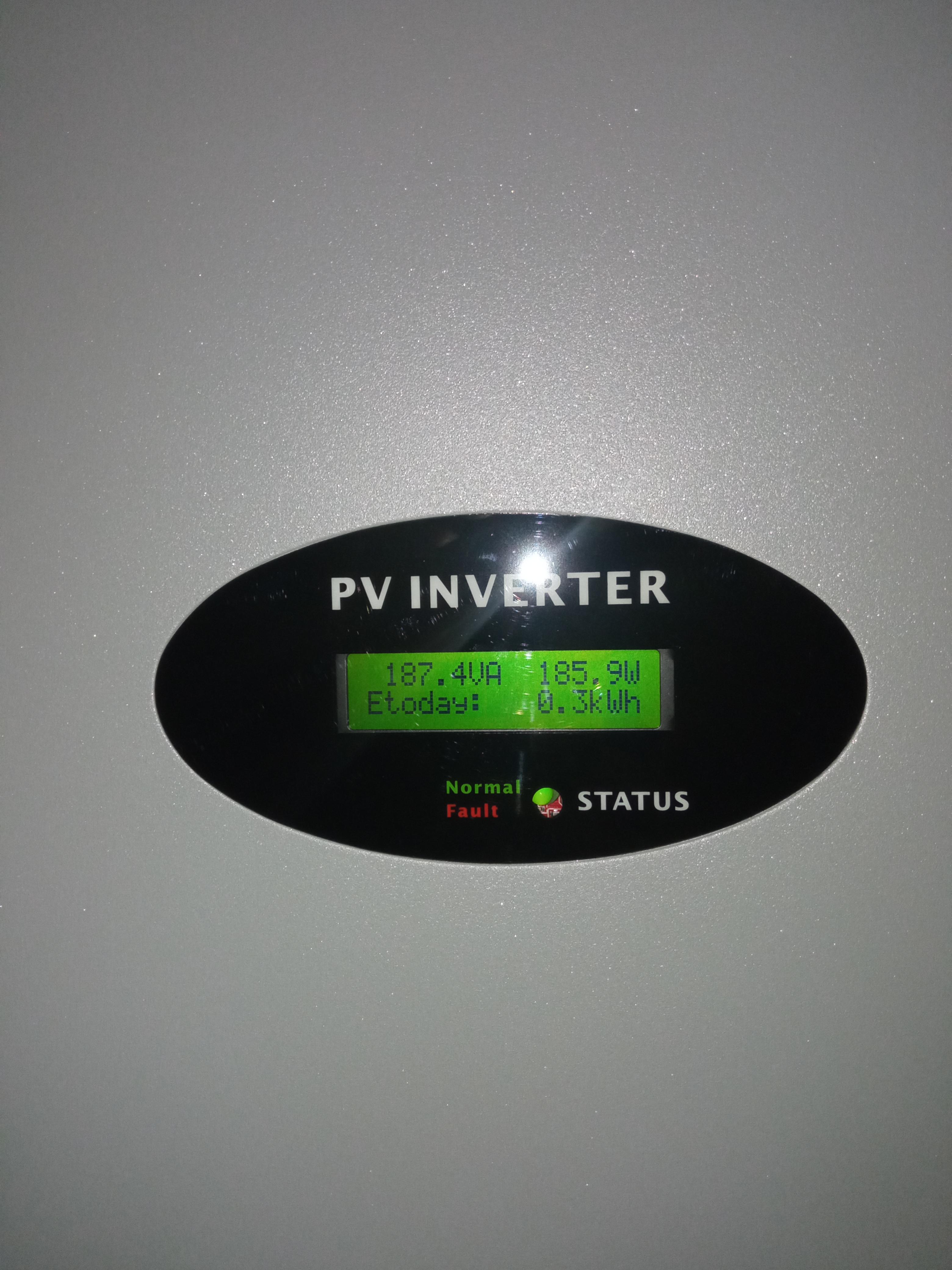

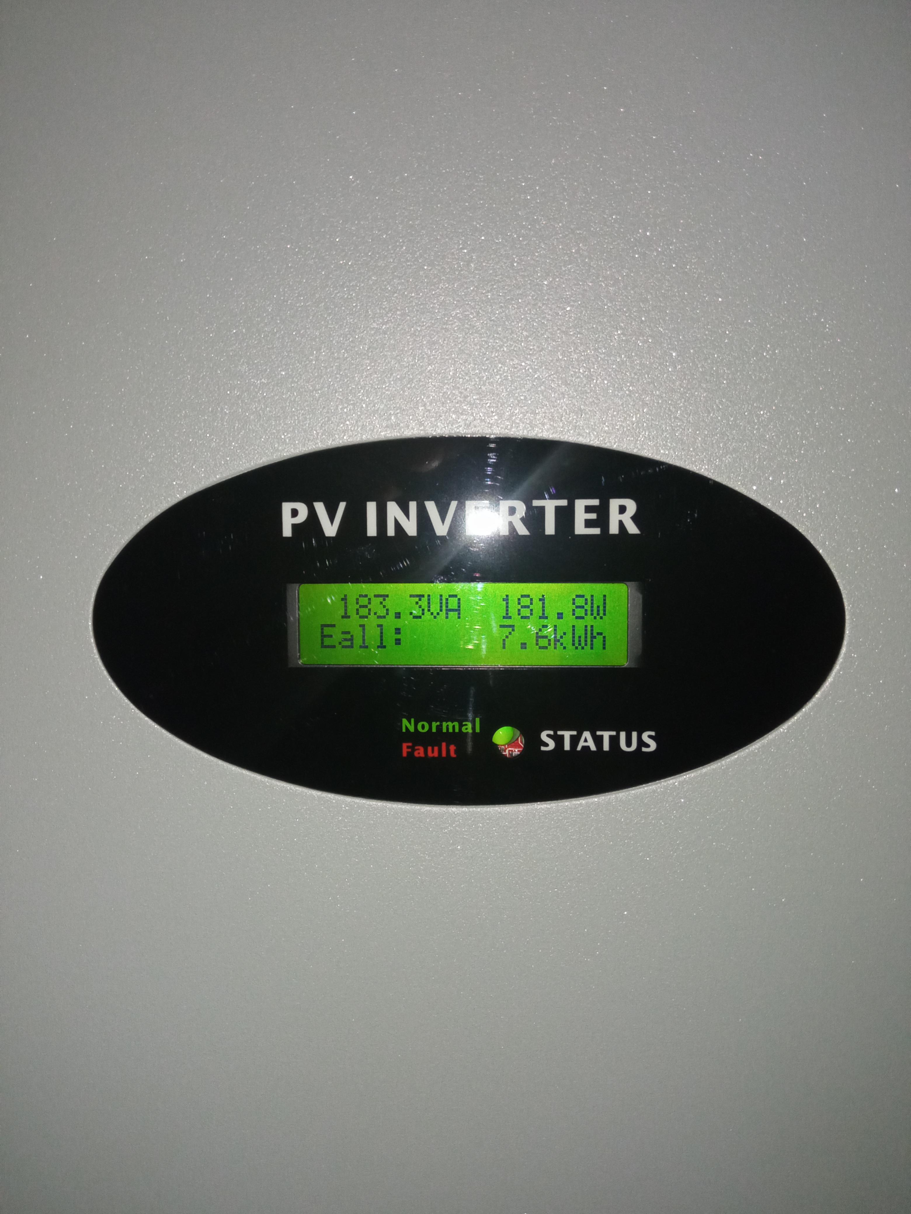

canalsiderenovation Posted January 25, 2021 Author Posted January 25, 2021 Next blonde question... I'm a bit confused on our solar on how to get a clear picture of what we are generating. On the inverter the screen flashes and there is one that says 'all' and one that says 'today'. When I just looked at it now (3:50pm) the 'today' was 0.3kWh but when I looked at it earlier it was around 2.2kWh. Does this mean it's just a snapshot of 'now' what it is generating? And the 'all' is this how many kWh since it was installed since Friday or as in all today? This thing is still showing with zeros.
ProDave Posted January 25, 2021 Posted January 25, 2021 When you looked "earlier" was it very much earlier? Before the sun gets high enough to start generation, the Etoday figure will still be showing what it generated yesterday. On a dull day in winter it can be quite late before it starts generating, and you can even get really dismal days when it generates nothing in winter. As soon as it starts generating Etoday will reset to 0 and start counting up. From this I deduce you have had a very dull day today, but yesterday was much brighter.
SteamyTea Posted January 25, 2021 Posted January 25, 2021 15 minutes ago, ProDave said: From this I deduce you have had a very dull day today, but yesterday was much brighter. Snow on the panels?
SteamyTea Posted January 25, 2021 Posted January 25, 2021 29 minutes ago, canalsiderenovation said: This could be the instantaneous power, 186W, which if it was a little higher for an hour, would be 0.3kWh.
canalsiderenovation Posted January 25, 2021 Author Posted January 25, 2021 (edited) 19 minutes ago, ProDave said: When you looked "earlier" was it very much earlier? Around lunchtime and it was at 2.2 after gradually going up throughout the morning but then when I checked again it was 0.3. 19 minutes ago, ProDave said: From this I deduce you have had a very dull day today, but yesterday was much brighter. The opposite! Yesterday we had snow pretty much all day and from the readings I took throughout yesterday until pretty much this time yesterday I think it was only around 1kWh. I've been roughly looking at it throughout the day and it looks to me like: 2.4kWh Friday 1.7kWh Saturday 1 kWh Sunday And the 'all' reading today is now 7.7kWh I would guess it has done around 2.6 kWh today. What I don't understand is the 'today' reading changes throughout the day, e.g. now it's 0.4kWh.... Edited January 25, 2021 by canalsiderenovation
SteamyTea Posted January 25, 2021 Posted January 25, 2021 32 minutes ago, canalsiderenovation said: This thing is still showing with zeros. This is a bit more concerning as if you are claiming from your energy company, this is the numbers then need.

SteamyTea Posted January 25, 2021 Posted January 25, 2021 2 minutes ago, canalsiderenovation said: is the 'today' reading changes throughout the day Is it just showing the last hour? Then a daily total, and a weekly total.
