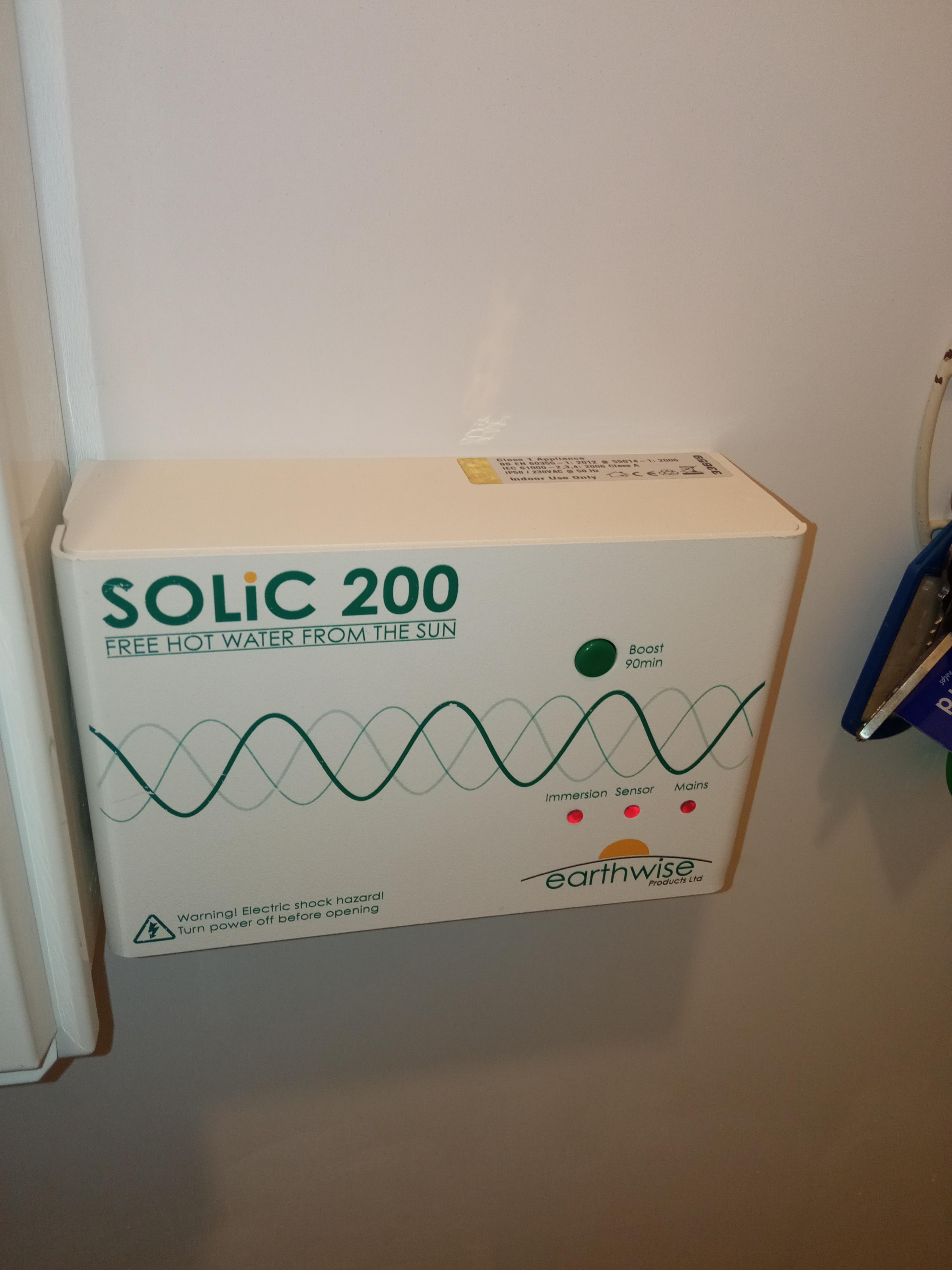

canalsiderenovation Posted January 21, 2021 Share Posted January 21, 2021 This is a silly question but if we have the solar PV and we then have the ASHP and the Solic 200 which diverts excess to the immersion - does the solar immediately go to the heat pump first? Just thinking there would never be any excess particularly in winter. Or am I missing something? Link to comment Share on other sites More sharing options...
Trw144 Posted January 21, 2021 Share Posted January 21, 2021 (edited) I sell a similar product, and assuming it works the same then it only runs the immersion as a last resort (instead of exporting to the grid). If your heat pump is in use, it is unlikely to have any excess to divert to the immersion so is only really likely to occur in warmer/sunnier months. Edited January 21, 2021 by Trw144 Link to comment Share on other sites More sharing options...
canalsiderenovation Posted January 21, 2021 Author Share Posted January 21, 2021 Just now, Trw144 said: I sell a similar product, and assuming it works the same then it only runs the immersion as a last resort (instead of exporting to the grid). If your heat pump is in use, it is unlikely to have any excess to divert tot he immersion so is only really likely to occur in warmer/sunnier months. Yep not exporting to the grid so that makes sense. Just wanted to check my thinking. I'm looking at electricity tarrifs too so wanted to make sure in addition we look at when to best make use of tarrifs that are cheaper at certain times. Link to comment Share on other sites More sharing options...
Conor Posted January 21, 2021 Share Posted January 21, 2021 (edited) Your solar diverter to the immersion will kick in once PV generation exceeds what your house is consuming. In the depths of winter you'd have to have most appliances off for there to be any excess generation. Edited January 21, 2021 by Conor Link to comment Share on other sites More sharing options...
ProDave Posted January 21, 2021 Share Posted January 21, 2021 Yes that is the whole point, they only send to the immersion heater the excess power that would otherwise have been exported. The best use for solar PV is to use it for something more useful, like do all your washing, dishwashing, tumble drying in the daytime close to mid day one machine at a time. Link to comment Share on other sites More sharing options...
canalsiderenovation Posted January 21, 2021 Author Share Posted January 21, 2021 (edited) 6 minutes ago, ProDave said: The best use for solar PV is to use it for something more useful, like do all your washing, dishwashing, tumble drying in the daytime close to mid day one machine at a time. See that's what I don't understand - would the heat pump electricity requirement have priority? For example if this is using electricity then any solar would go to this first before say the washing machine? And then if it was generating a lot, if the heat pump wasn't using any, it would go to anything we would be using like the washing machine and finally the immersion. So in winter when solar is minimal it would likely go straight to the electricity the ASHP uses? This may be a really blonde question. It's been a long day.... Edited January 21, 2021 by canalsiderenovation Link to comment Share on other sites More sharing options...
ProDave Posted January 21, 2021 Share Posted January 21, 2021 2 minutes ago, canalsiderenovation said: See that's what I don't understand - would the heat pump electricity requirement have priority? For example if this is using electricity then any solar would go to this first before say the washing machine? And then if it was generating a lot, if the heat pump wasn't using any, it would go to anything we would be using like the washing machine and finally the immersion. So in winter when solar is minimal it would likely go straight to the electricity the ASHP uses? This may be a really blonde question. It's been a long day.... Nothing has "priority" you are over thinking it. The inverter will spit out as much power as it is able to depending entirely how much sun is shining on it. Your house will use as much energy as ANY appliance turned on needs to use. If generated power exceeds power being consumed, then to prevent power being wasted exported, your device will send that power to the immersion heater. It can send anything from a few watts up to the full nominal 3kW to the immersion heater. In the winter the heat pump will use almost all that you generate, but even so, there are times when it is idle and I have seen power going into my immersion heater. The appliance thing is more for the summer, when you are generating most PV power but apart from DHW heating, the HP is not doing much. I have my HP timed to not start DHW heating until 11AM by which time there is a fair chance the PV is generating a good amount. But we also use the 3 big appliances one at a time around the mid day slot to try and self use as much as possible. 1 Link to comment Share on other sites More sharing options...

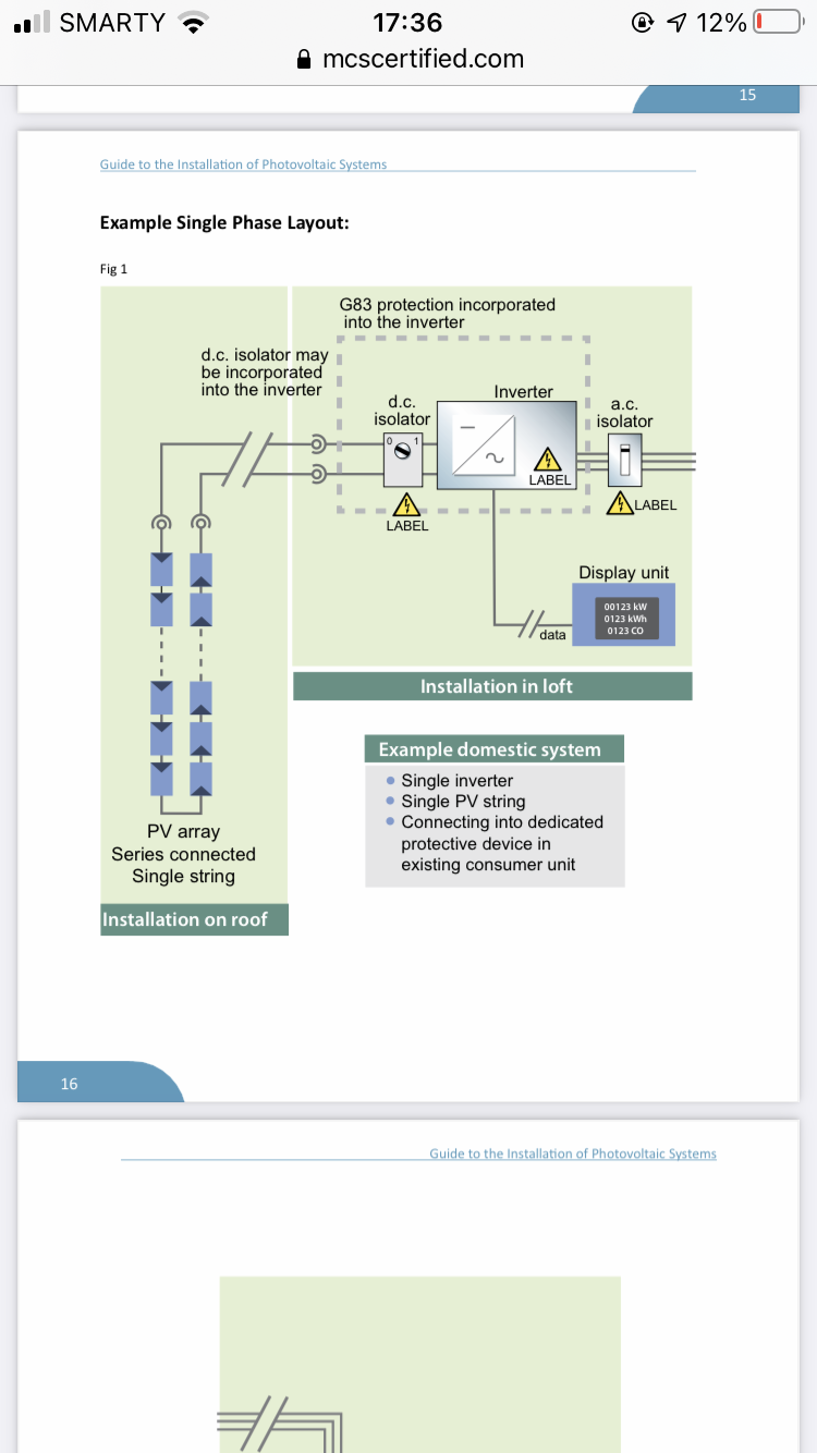

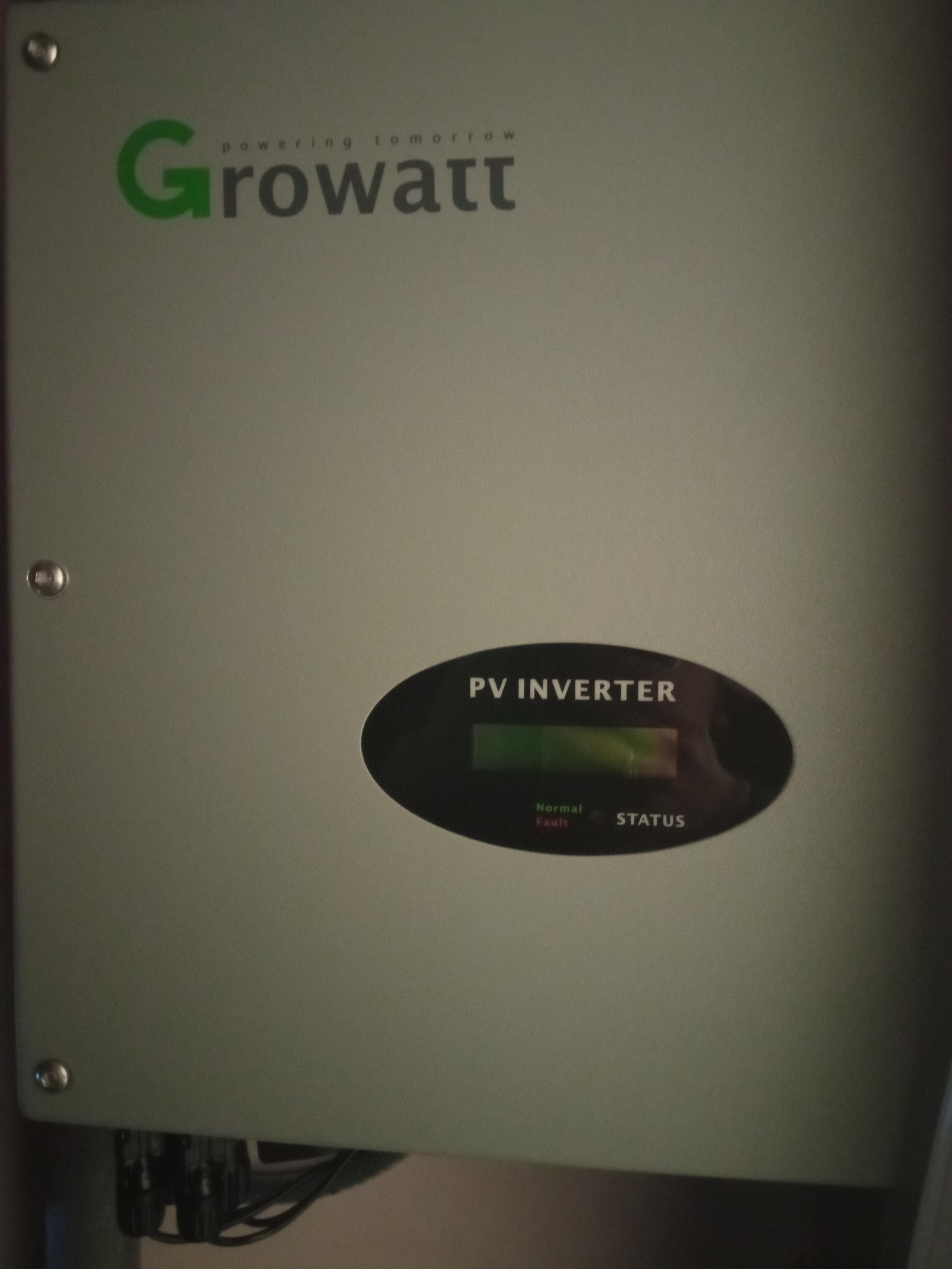

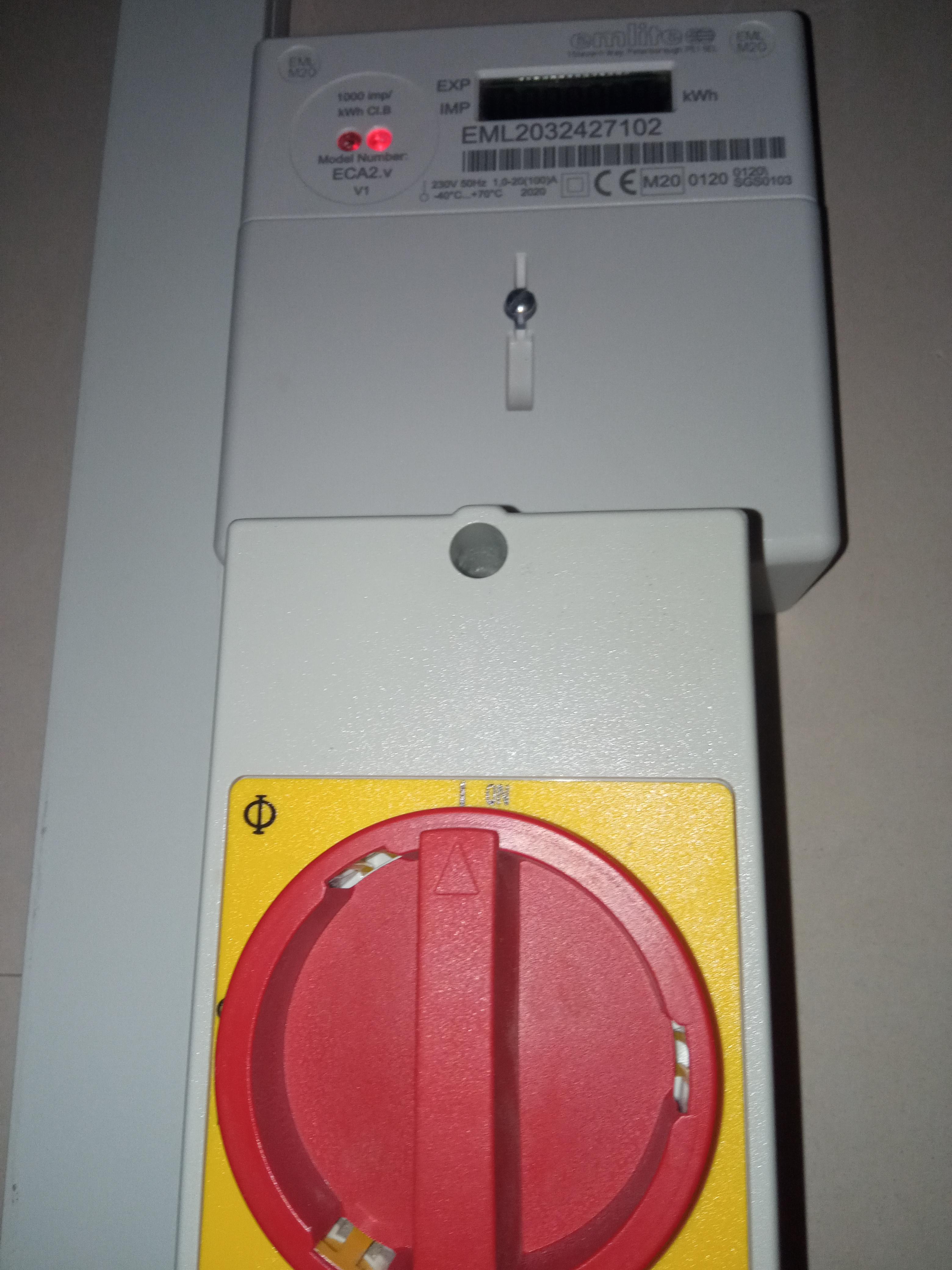

canalsiderenovation Posted January 21, 2021 Author Share Posted January 21, 2021 (edited) @ProDave ok another idiot question our solar is now up and running. We have the inverter, Solic and the meter thingy and isolator (very technical). Is there a way of seeing how much we are getting from the solar. I'm betting it is that meter thing above the isolator which is taller than me! Edited January 21, 2021 by canalsiderenovation Link to comment Share on other sites More sharing options...
TonyT Posted January 21, 2021 Share Posted January 21, 2021 The meter that’s above the red handled isolator will be the generation meter Link to comment Share on other sites More sharing options...
TonyT Posted January 21, 2021 Share Posted January 21, 2021 Is there another isolator close by, as there should be one for the Cabling coming from the panels( DC voltage) and one for the Inverter (AC Voltage) Link to comment Share on other sites More sharing options...
canalsiderenovation Posted January 21, 2021 Author Share Posted January 21, 2021 3 minutes ago, TonyT said: Is there another isolator close by, as there should be one for the Cabling coming from the panels( DC voltage) and one for the Inverter (AC Voltage) It's probably up the loft I presume? Link to comment Share on other sites More sharing options...
TonyT Posted January 21, 2021 Share Posted January 21, 2021 Link to comment Share on other sites More sharing options...
canalsiderenovation Posted January 21, 2021 Author Share Posted January 21, 2021 5 minutes ago, TonyT said: I can't see another one next to the inverter? Link to comment Share on other sites More sharing options...
