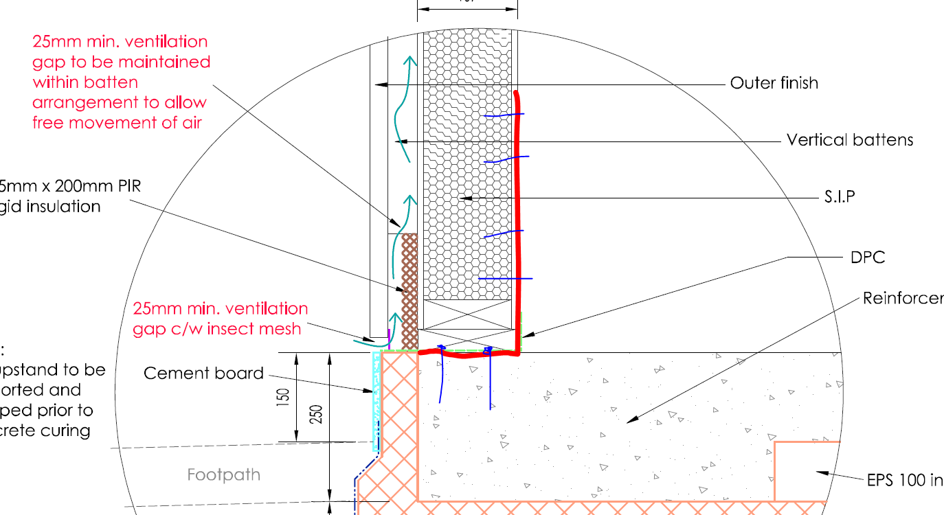

SuperJohnG Posted January 18, 2021 Share Posted January 18, 2021 I couldn't really find any details with the search. I've a KORE insulated foundation, with a SIPS kit going on top. The concrete slab will be the FFL, hence cannot fit internal holding down straps, that are L shaped. I have mailed Tanners, to check what the norm is. But can you just do the holding down outside with straight straps and screw into the EPS? seems like it's the only way, but not sure the EPS would be strong enough. I'm sure Tanners will tell me in the morning but keen to know what others done. Floor covering is LVT hence too thin to hide in grout or whatever. Link to comment Share on other sites More sharing options...

LA3222 Posted January 19, 2021 Share Posted January 19, 2021 21 minutes ago, SuperJohnG said: I coukd put them in and attach to mesh. But here must be a better way. Its a PITA. Tanners came back to me today but said its uo to the superstructure engineer. @LA3222 any chance you can provide some input your the only other I know with an insulated foundation and SIPS. What is the purpose of the straps? There were no straps used for my build. The soleplate was fixed to the slab with concrete screws, the same for the baseplates on the two steels. You got a drawing? May help people to see the issue. Link to comment Share on other sites More sharing options...
LA3222 Posted January 19, 2021 Share Posted January 19, 2021 Oh, as for fixing into EPS I can't see that working. Its rubbish to stick stuff in it - the U shaped pins you get from Kore are crap and don't work great. Link to comment Share on other sites More sharing options...

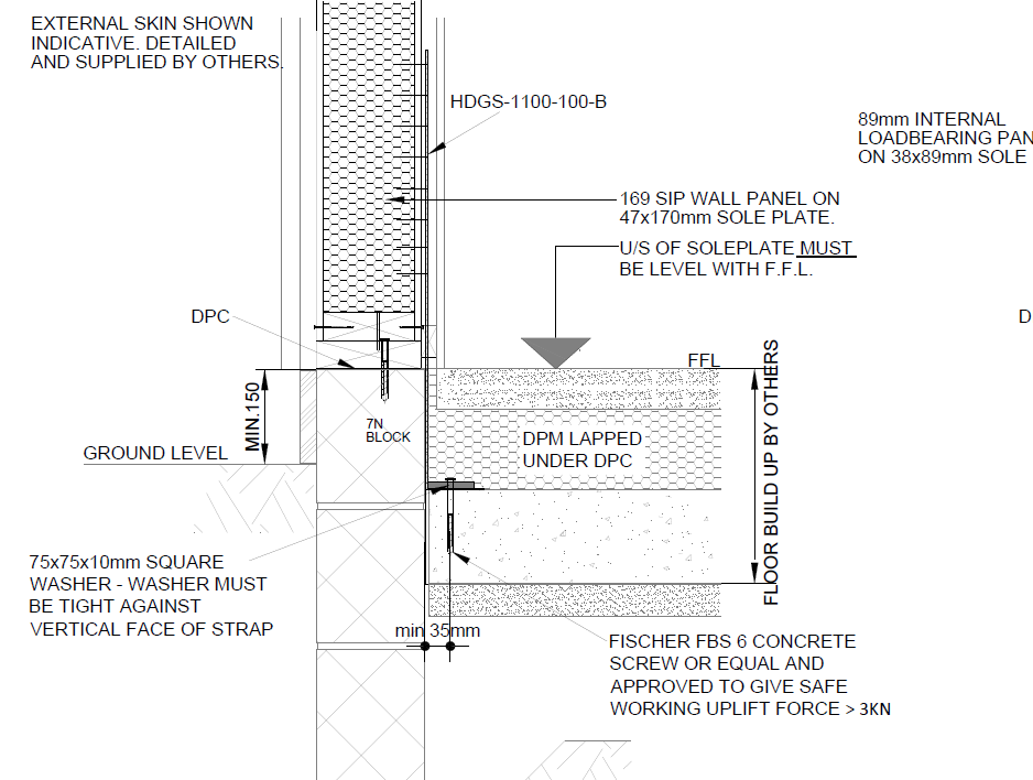

SuperJohnG Posted January 20, 2021 Author Share Posted January 20, 2021 Drama semi over - I think. The SIPS supplier has put hold down straps on the ground floor shown on his drawing. see here: However on inspection of the Structural engineer drgs he hasn't shown any straps on the ground floor. only the upper floors to strap the roof down. So I think it's a non issue! @LA3222 they tie the kit down on some designs, see above (HDGS item). @jamieled thanks for coming back to me, I thought that was what I would have to do with must have be a PITA. @Gus Potter helpful and insightful as always thanks. My own choice to use two different was more one of needs must and to ensure I got the best people for the job, the SIPS deisgner found their superstructure engineer, who are very good and I appointed Tanners as they are experts for insulated foundation design. Fortunately I discusssed with the superstructure engineers if they would do the SER also, which they did and signed off of Tanners design and also asked them to change a few items. So on the whole I am hoping it's merely a SIPS designer draughting issue and that's all. I will find out tomorrow and update the thread. For reference - I am SIPS without masonry outer leaf, but I do have steel portal frame on my big glass gable. Link to comment Share on other sites More sharing options...

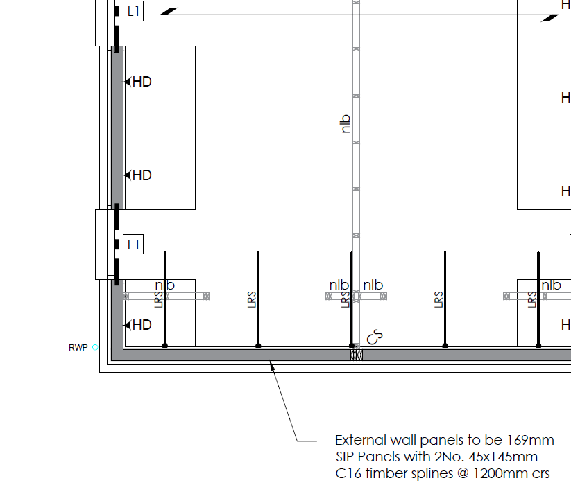

SuperJohnG Posted January 20, 2021 Author Share Posted January 20, 2021 As a bit of an update. The superstructure engineer hadn't included them in the drawing....albeit is stating they ae definitely required to provide lateral restraint against wind loading. I had a few words about why were they not shown and seems to have been a missed detail that shoud have really went on engineers drawings. Anyway they are in their calcs and are required to help with wind loading and help against lateral loading (As a mech engineer it's what I'd call and overturning moment. Imagine you are pushing on the thin end of the SIPS panel not the inner or outer face, load getting applied from another wall that's being hit with wind. So the gist of it is, sort of found a solution where it removes my need to chip out concrete or plan positions of straps prior to pouring. we will add an l shaped strap underneath the sole plate, so it is hidden. Every 1200mm the sole plate will either have a rebate in the underside or just cut a bit out thick enough to take strap, straps will be Hilt nailed to slab and then SIPS rail that provides SIP guidance into the panel rebate will go on top. SIP panel is placed then hold down strap attached. Seems to work and importantly someone else will have to do the work not me. A nice image to make it easy to understand, once agreed and implemented I will update this thread for others who come along. Link to comment Share on other sites More sharing options...
