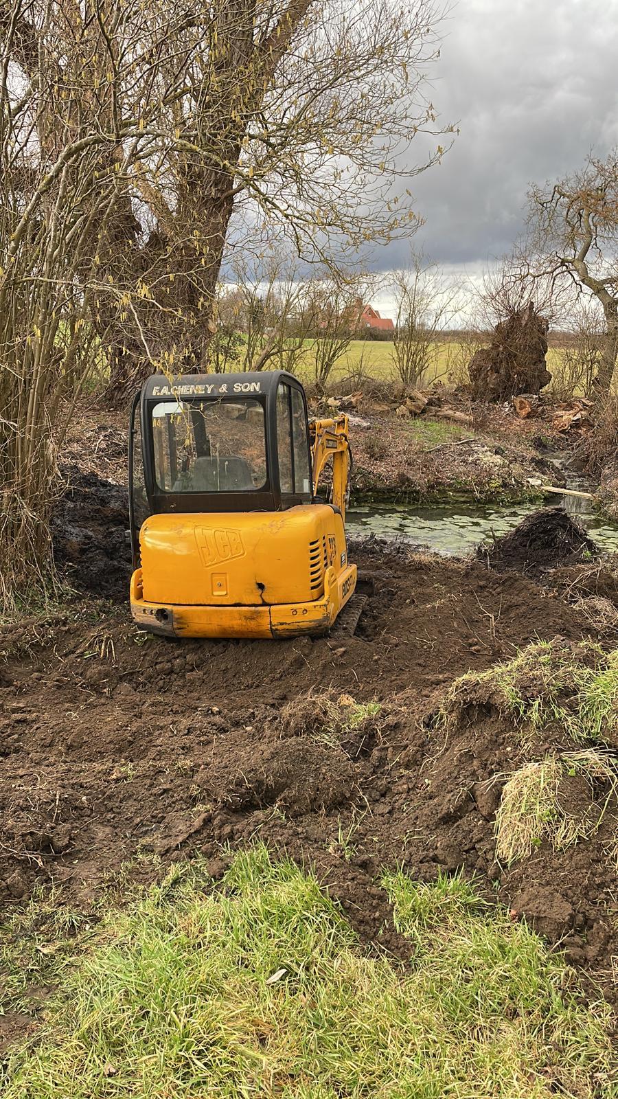

Wil Posted July 17, 2023 Posted July 17, 2023 So we have/ inherited a pond with a stream running into it, I’ve been clearing desperately and it turns out that at some point it’s been used as a well for the farmhouse. The old lead piping is still there in places. Half our roof also diverts through the pond. But the stream is dry in summer and runs fairly well in winter. Realistically any heating would be absolutely negligible given the flowing nature and at the moment it just clogs up with Algae and sediment running off the farmer’s fields. Considering the chemicals they’re using probably run through it too, it just seems like it’ll have to be ornamental. Gratuitous digger pic. I definitely wasn’t stuck at this point. Definitely.
