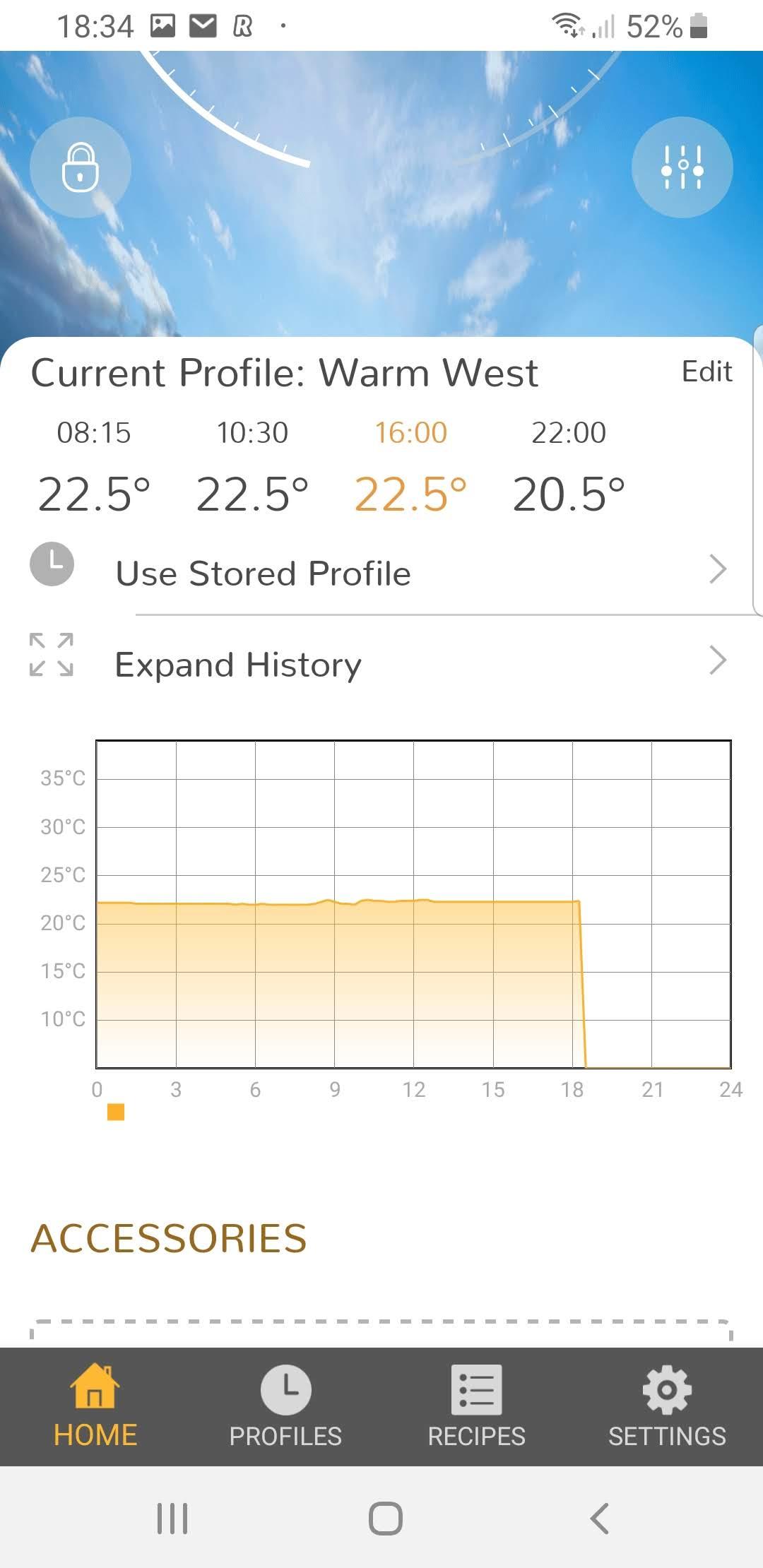

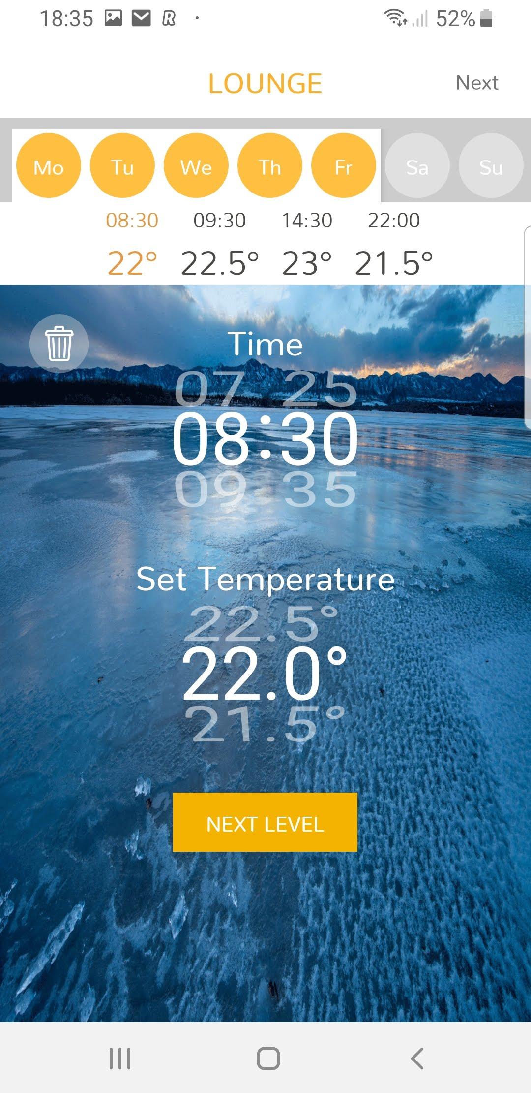

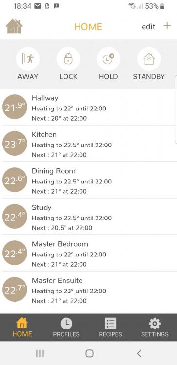

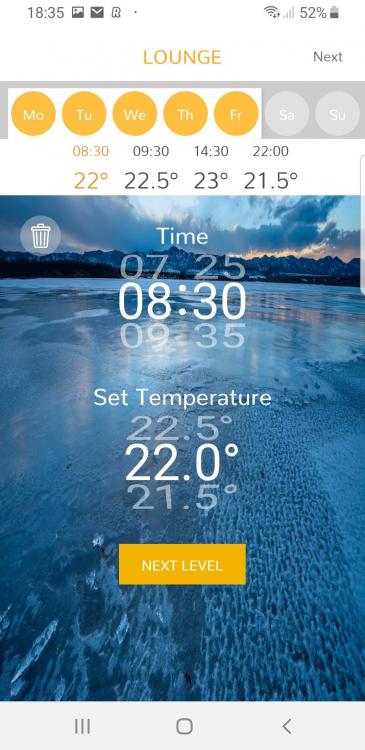

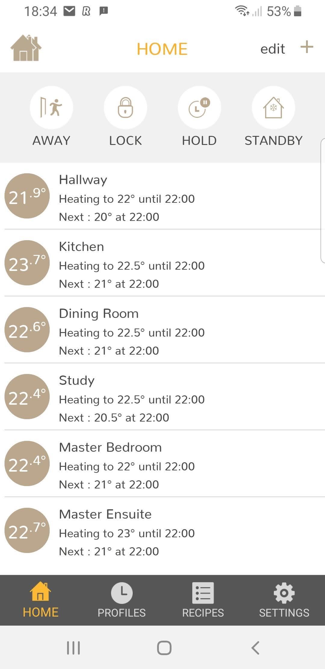

Ultima357 Posted January 20, 2021 Author Posted January 20, 2021 On 18/01/2021 at 15:25, Temp said: On 20/01/2021 at 11:00, MJNewton said: Might there be a cheap(ish) solution to be found by just concentrating on what these stats are really there to do - measure temperature. With so many zones I am assuming you are not using the timer/programmer functionality on each and every one? I am picturing a centralised controller that reads the temperature in the 14 locations and controls each zone as required in accordance with a common schedule. I don't know what off-the-shelf solutions exist for that or whether a roll-you-own approach based on something like Home Assistant would be better (certainly cheaper). Sure, for the latter there'll be a bit of a learning curve but the end result ought to be good. Expand Expand These stats are very sophisticated. Each has multiple timers and temperature settings which can be set via a saved profile. Eg a bedroom profile can be applied to each bedroom saving programming separately. The app means you can do this all from the comfort of your armchair, monitor temperature and speed of change, set some of the parameters in the stats too. Being internet connected, you can do it from anywhere too. The stats talk to each other, forming a wireless mesh network which hooks into the neo hub and hence onto the internet. Each is wired to the multiway wiring centres which in turn control the UFH actuators and pumps. ASHP is therefore dumb, just responds to heat call. So overall, I'm very happy with the functionality. It also hooks into Google, Alexa etc, so you can control each room via vouse if it takes your fancy. Some screen shots below. 1

MJNewton Posted January 20, 2021 Posted January 20, 2021 On 20/01/2021 at 18:37, Ultima357 said: These stats are very sophisticated Expand Ah yes, understood. Makes it all the more surprising doesn't it that they can do a great job with that bit but somehow bodge the temperature sensing side!
