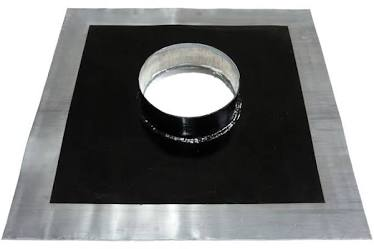

Paul_c Posted May 16, 2021 Posted May 16, 2021 On 21/03/2021 at 20:17, MortarThePoint said: I don't understand, the upstand is about 100mm high How does the next flue liner sit on this (how would it bond and not leak smoke) when you still have more sections to go up?
MortarThePoint Posted May 16, 2021 Author Posted May 16, 2021 13 minutes ago, Paul_c said: How does the next flue liner sit on this (how would it bond and not leak smoke) when you still have more sections to go up? For mine, the flue liner just passed through the hole unabated (i.e. the lead all sits outside the liner). In severe weather areas it is supposed to come inside the liner though.
Gary009 Posted July 29, 2022 Posted July 29, 2022 Is the whole lead dpc not a weak point? Like a plastic dpc in a garden wall?
MortarThePoint Posted August 5, 2022 Author Posted August 5, 2022 I guess, depends how well the mortar sticks to the tray. The weakness is in tension or shear I suppose. It's how it's typically done though.
