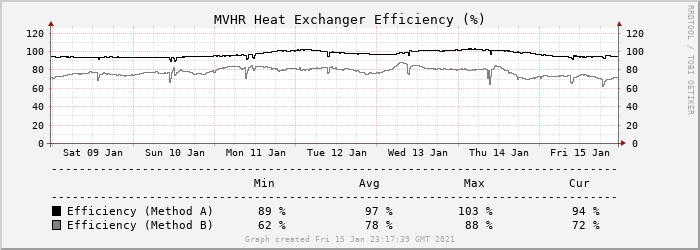

'Heat transfer' as in efficiency? If so, that seems to be pretty good at an average of between 80% and nearly 100% depending on the two methods described at the Paul Heat Recovery page on the subject:

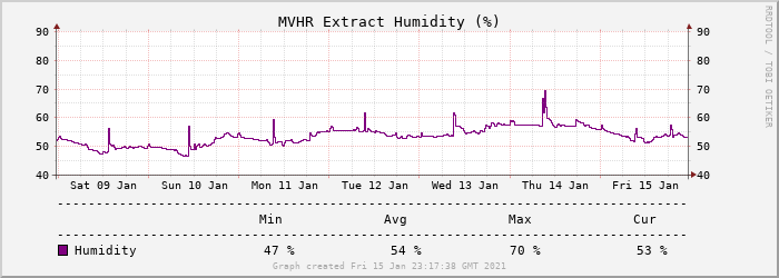

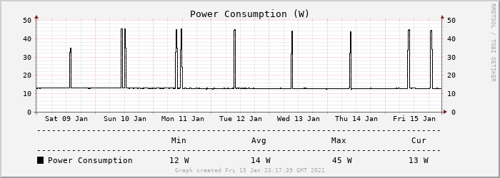

The negative 'blips' appear to align with going into boost as the humidity and power graphs demonstrate, and I guess would make sense as the air is moving faster hence less time for transfer:
(I have to laugh: when zoomed in you can even distinguish between my wife taking a shower and I! :D)

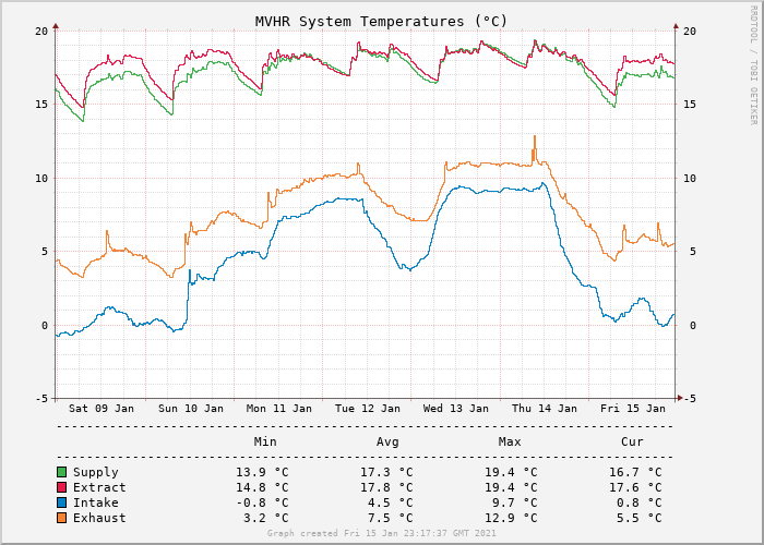

In terms of heat rise between intake and supply temperatures I am therefore seeing pretty much all of what I'm extracting out:
We don't tend to have the heating massively high (lounge stat set to 20C but bedroom TRVs tweaked down a little), and this is a retrofit to a 2007-built Persimmon house so far from a perfect environment I'm sure. The pipes are running within the ceilings so whilst they are within the heated envelope of the house I doubt the temperatures there are the same as the rooms and will be being cooled by air leaks here and there. The unit itself, manifolds and termination of all the pipework is in the cold loft so there must be losses there too. Still getting air delivered 17C when it's 0C outside so perfectly acceptable I think - even without a heater as I say, and particularly when compared to what would've been coming through the window trickle vents which I have not foamed up!

Thanks for that - interesting that on the Lossnay the recovery efficiency seems to increase with flow rate which is a bit odd as it’s supposed to decrease ..!! I’ll download the data from the Shelley’s that are on the ducts as it’s looking like for a fairly average install the efficiency is 78.8-82.3% which isn’t far off the actual numbers quoted by the manufacturer. This may be affected by the long run in an unheated but insulated service cavity for the en-suite (17m) and bathroom (10m) extract ducts. Interestingly the extract temperature increases on boost which makes me think some heat is lost in this duct.
