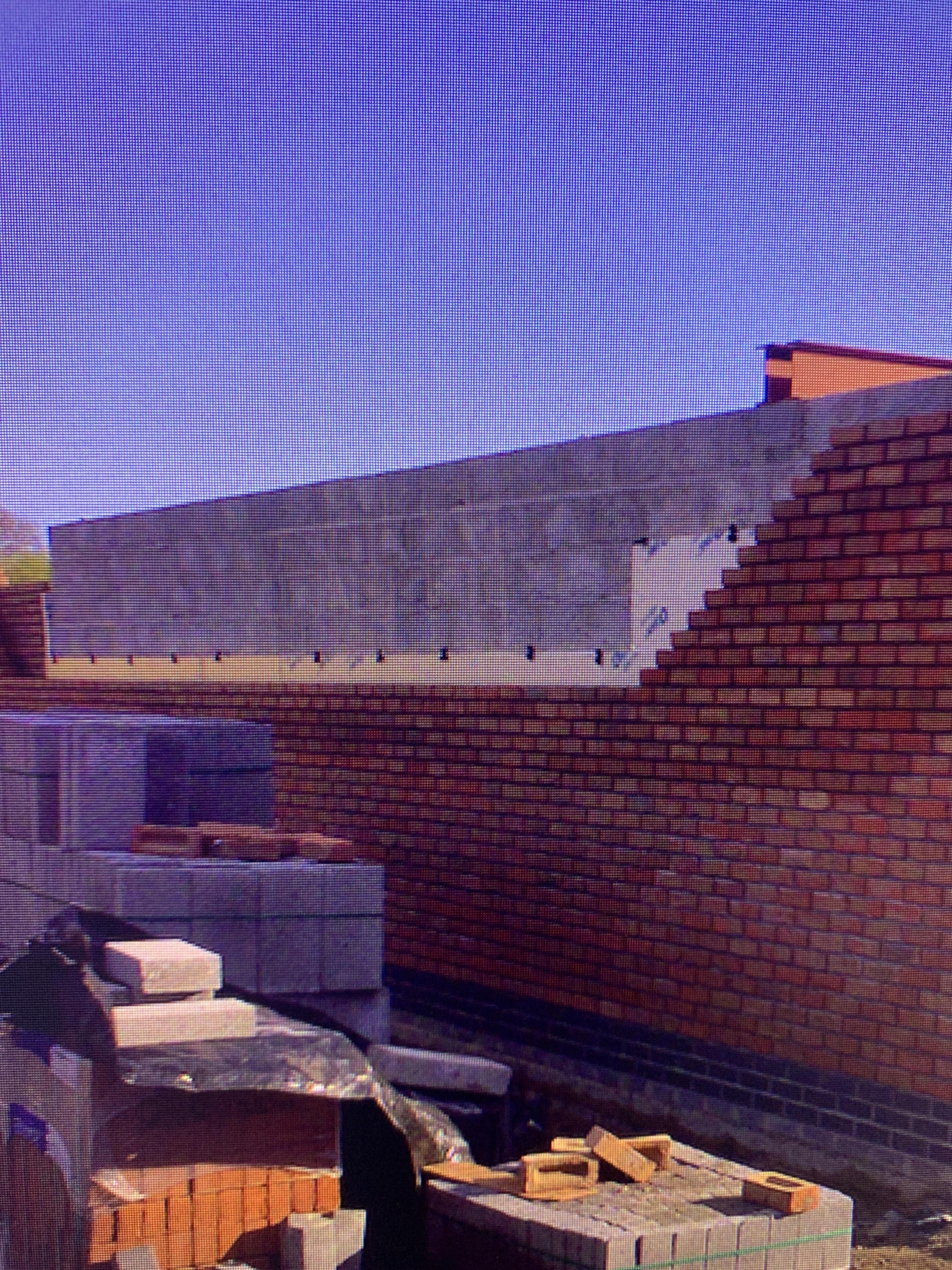

Chriswills Posted January 24, 2021 Author Posted January 24, 2021 (edited) Can’t understand how the rating reflects the build standard as I project managed this house together with building regs personnel and I personally rock wooled and insulated every single area inside the house. All the outside was cavity with k rendered block walls, insulation boards, thermo blocks, dry walled and skimmed. if the heat pump ever packs in, I will never replace it and go gas instead. They just can’t warm up enough in the cold so what’s the point of them really. Huge expense for a huge cost in electricity and no way is it a saver. At least gas is not affected directly by cold. Sorry, rant over Edited January 24, 2021 by Chriswills

PeterW Posted January 24, 2021 Posted January 24, 2021 3 hours ago, Chriswills said: Can’t understand how the rating reflects the build standard as I project managed this house together with building regs personnel and I personally rock wooled and insulated every single area inside the house. All the outside was cavity with k rendered block walls, insulation boards, thermo blocks, dry walled and skimmed. But if you used 100/100/100 wall build up with only rock wool in the cavity, and only 80mm of insulation under the floor you met the Regs at the time. And the rating will reflect that. The numbers in the report are far higher than current Part L standards. Did it have a blower test done ..?

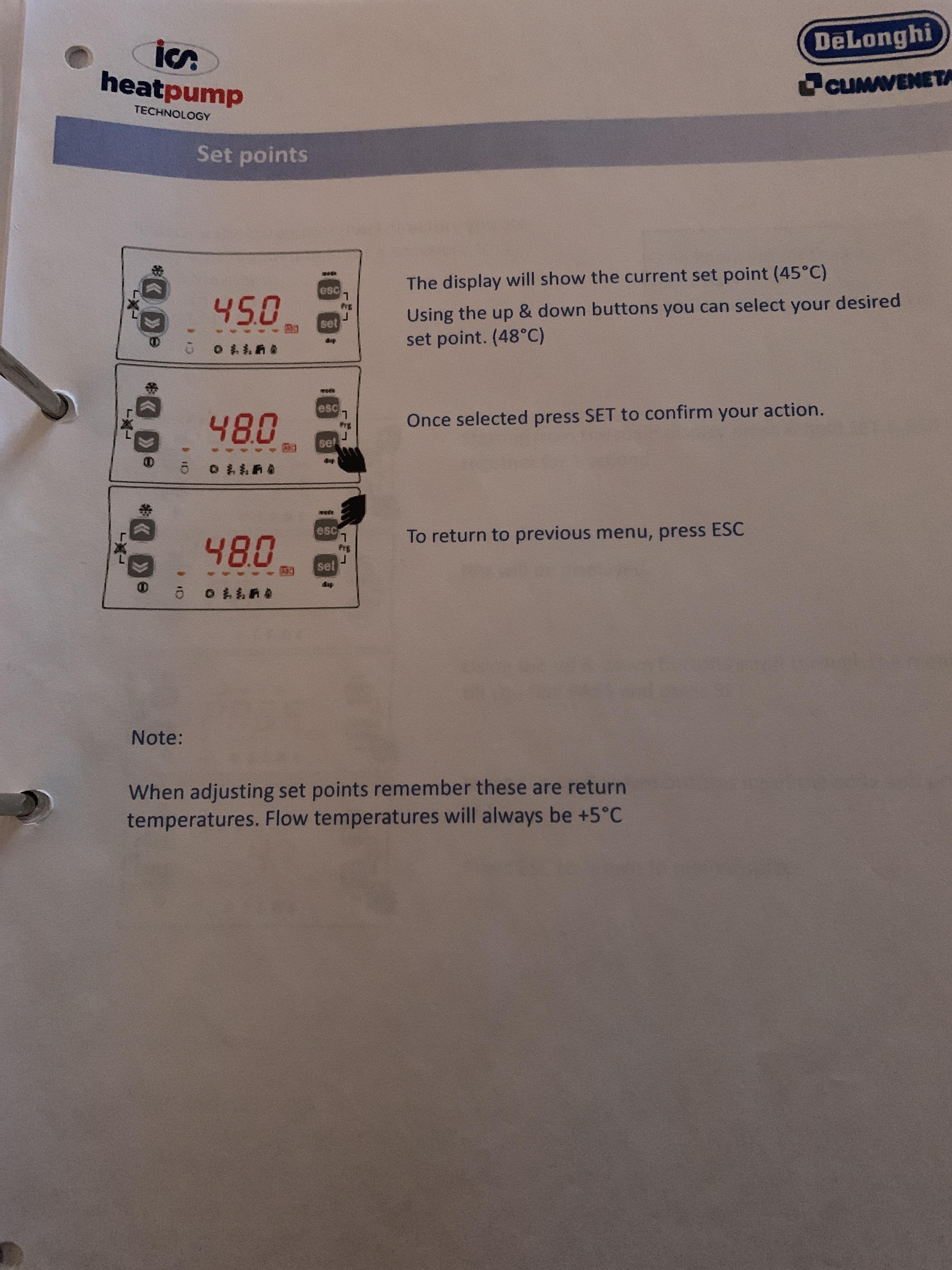

Chriswills Posted January 25, 2021 Author Posted January 25, 2021 44 minutes ago, ProDave said: It's "return flow" that confused me. It's the flow temperature that is usually of interest and the one that is controlled. Return temperature is what it is and may be of interest to note, but it is not the one usually controlled. It is on this unit but I can read the flow too. So for example I set the return to 37 and the flow will read 40. Always a 3 degree delta. The input is always entered by selecting return temp.
Chriswills Posted January 25, 2021 Author Posted January 25, 2021 3 hours ago, Chriswills said: It is on this unit but I can read the flow too. So for example I set the return to 37 and the flow will read 40. Always a 3 degree delta. The input is always entered by selecting return temp. What do you reckon @ProDave?
ProDave Posted January 25, 2021 Posted January 25, 2021 50 minutes ago, Chriswills said: What do you reckon @ProDave? I have never encountered one like that. Why would you want to control the return temperature? usually you set the flow temperature and the return will be a bit lower.
Chriswills Posted January 25, 2021 Author Posted January 25, 2021 @ProDave here’s the instructions. The delta to flow is plus 5 deg or supposed to be. Mine is set at 37 and when the return of the pump temp drops to 34 it switches on again until reaching the return of 37 and so on.

dpmiller Posted February 13, 2021 Posted February 13, 2021 On 25/01/2021 at 17:46, ProDave said: I have never encountered one like that. Why would you want to control the return temperature? usually you set the flow temperature and the return will be a bit lower. the default setup on my ASHP was return temp too, but "return" in this case is a wandering probe that could instead be in a buffer tank. I've now re-set it to flow to try. Power consumption seems very similar in both modes. In both cases my external probes tell me that return temp pretty much matches the circulating temp in the slab, but the delta and pump speed control are radically different. Tis velly interresting. I'm waiting for a flow-setter coming so I can get the pump speed best optimised. It's PWM but the limits are adjustable, plus I've got a secondary in the plant room too.
Chriswills Posted February 13, 2021 Author Posted February 13, 2021 10 minutes ago, dpmiller said: the default setup on my ASHP was return temp too, but "return" in this case is a wandering probe that could instead be in a buffer tank. I've now re-set it to flow to try. Power consumption seems very similar in both modes. In both cases my external probes tell me that return temp pretty much matches the circulating temp in the slab, but the delta and pump speed control are radically different. Tis velly interresting. I'm waiting for a flow-setter coming so I can get the pump speed best optimised. It's PWM but the limits are adjustable, plus I've got a secondary in the plant room too. GOT YOU...that could be an issue for me, as we have nothing coming from the ASHP to buffer to tell it anything. Maybe weather comp is my only hope here.
ProDave Posted February 13, 2021 Posted February 13, 2021 The "issue" I have with this ASHP having the return as the set point, is it then maintains +5 for the flow temperature. I have observed with mine when only one UFH loop is on, there is very little difference between the flow and return, perhaps 2 degrees or even less. So I would never achieve the 5 degrees it wants and I would end up running with the flow temperature hotter than I want, by which time the return temperature would overshoot it's target. But it is the way the manufacturer has designed it so you have to work with it.
