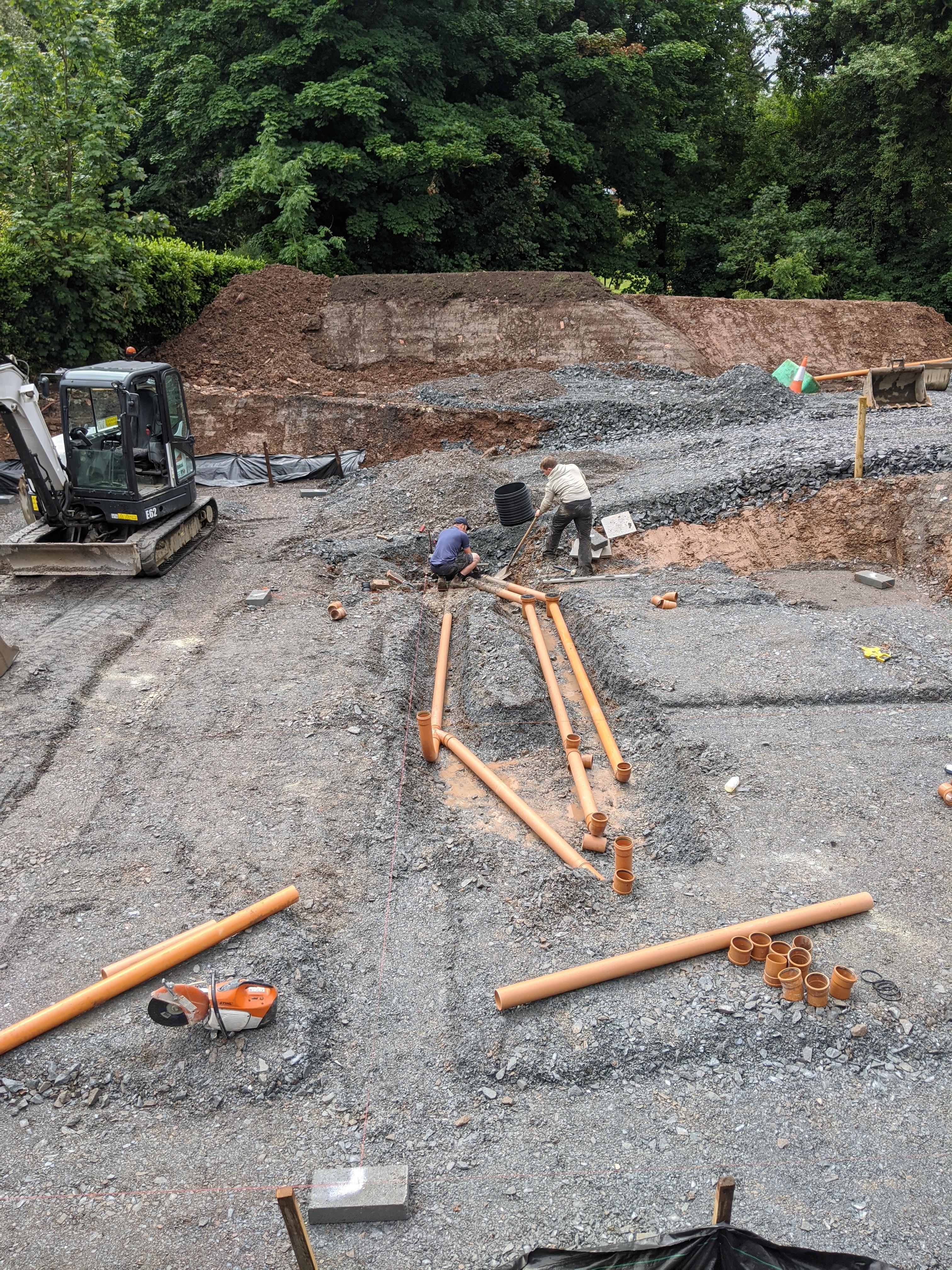

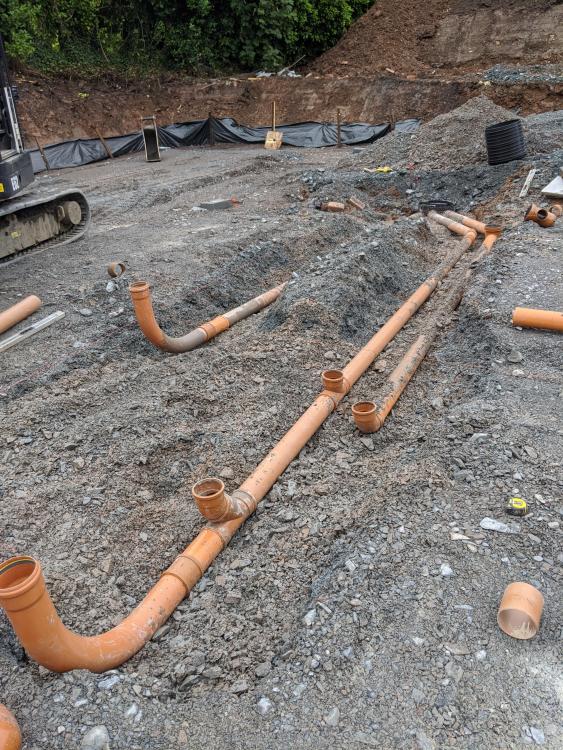

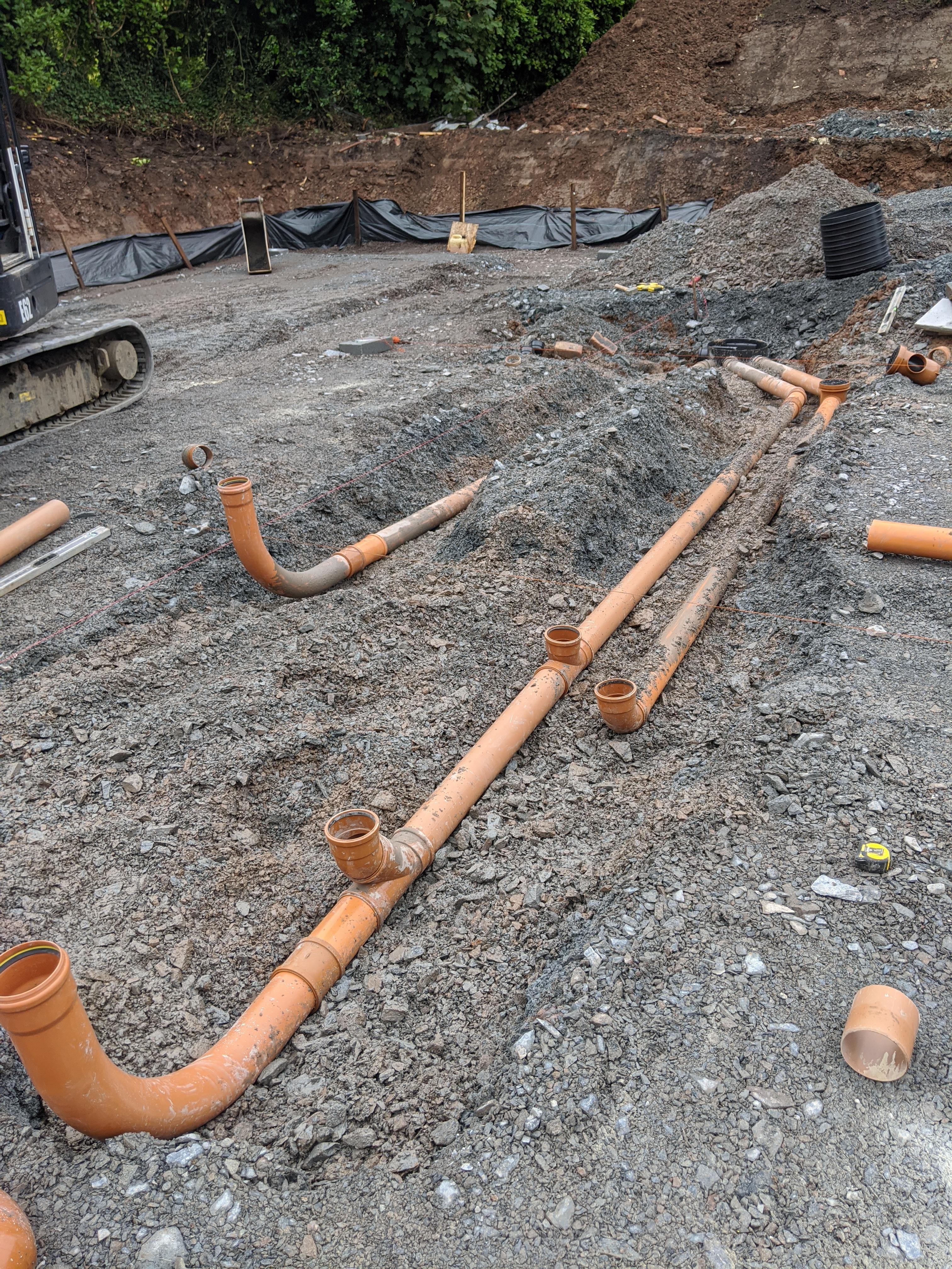

Conor Posted January 14, 2021 Share Posted January 14, 2021 (edited) Lhs line is the main vent stack with basement toilet connecting to it, them to the right we have the basin and shower, and finally utility sink / DW in next room. We originally had the toilet in same line as main soil stack from above, but BC asked us to put it in with basin and shower for some reason as it obviously meant the toilet line would be more than 6m unvented. Edited January 14, 2021 by Conor Link to comment Share on other sites More sharing options...

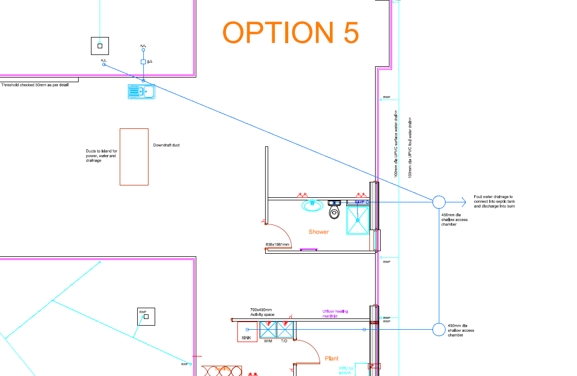

SuperJohnG Posted January 14, 2021 Author Share Posted January 14, 2021 17 hours ago, Temp said: Ideally avoid branches under the house. Better to run pipes down outside the footprint and branch off at inspection chambers. The bottom of all stacks should have large radius bends (aka Rest Bends) where they turn from vertical to horizontal. This seems to be hard for me as I have specifically lined everything up to make it easy, but can't use rest bends as they are line. see below - top IC flows out to TP, so I had lined this up directly from the 1st floor SVP, then just was going to add anothet stack directly behind for shower tray (level shower tray on slab, so shuttering required to allow drain to connect below FFL). then tack the toilet on further back. Kitchen could be a rest bend but, then how do I attach that gully trap or rodding end? I suppose to be fair, the gully trap is only there for an external tap and could really go directly into surface water to simplify. I don't see me needing a rodding end here at kitchen really? can't imagine what's going to get stuck in there I can't access from the IC rodding point. For the lower IOC - this only picks up the utility sink and plant room drain (MVHR condensate and UVC drain). Link to comment Share on other sites More sharing options...

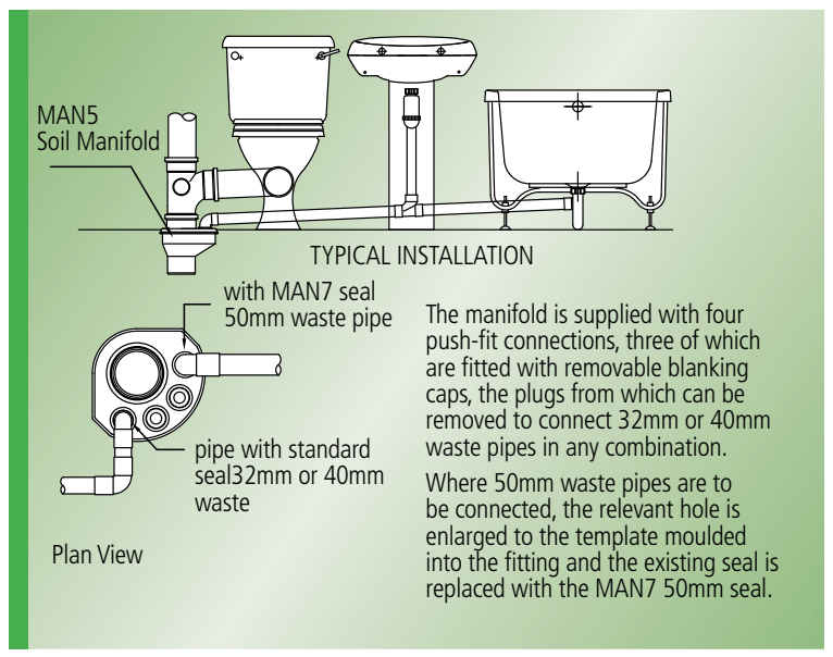

SuperJohnG Posted January 14, 2021 Author Share Posted January 14, 2021 This may actually deal with my downstairs shower issue if I shuttered that area at the shower, then dropped a soil manifold low, I can pick up the WC in there on a stack branch. Link to comment Share on other sites More sharing options...
Dave Jones Posted January 14, 2021 Share Posted January 14, 2021 12 hours ago, Conor said: Lhs line is the main vent stack with basement toilet connecting to it, them to the right we have the basin and shower, and finally utility sink / DW in next room. We originally had the toilet in same line as main soil stack from above, but BC asked us to put it in with basin and shower for some reason as it obviously meant the toilet line would be more than 6m unvented. you have used long radius bends NOT rest bends. rest bends should be used as they have a foot under them to provide support to the stack. Y branch is fine also on a single run. lastly you must use rockers (double joins) where your pipes will be going through the wall under lintels. Link to comment Share on other sites More sharing options...

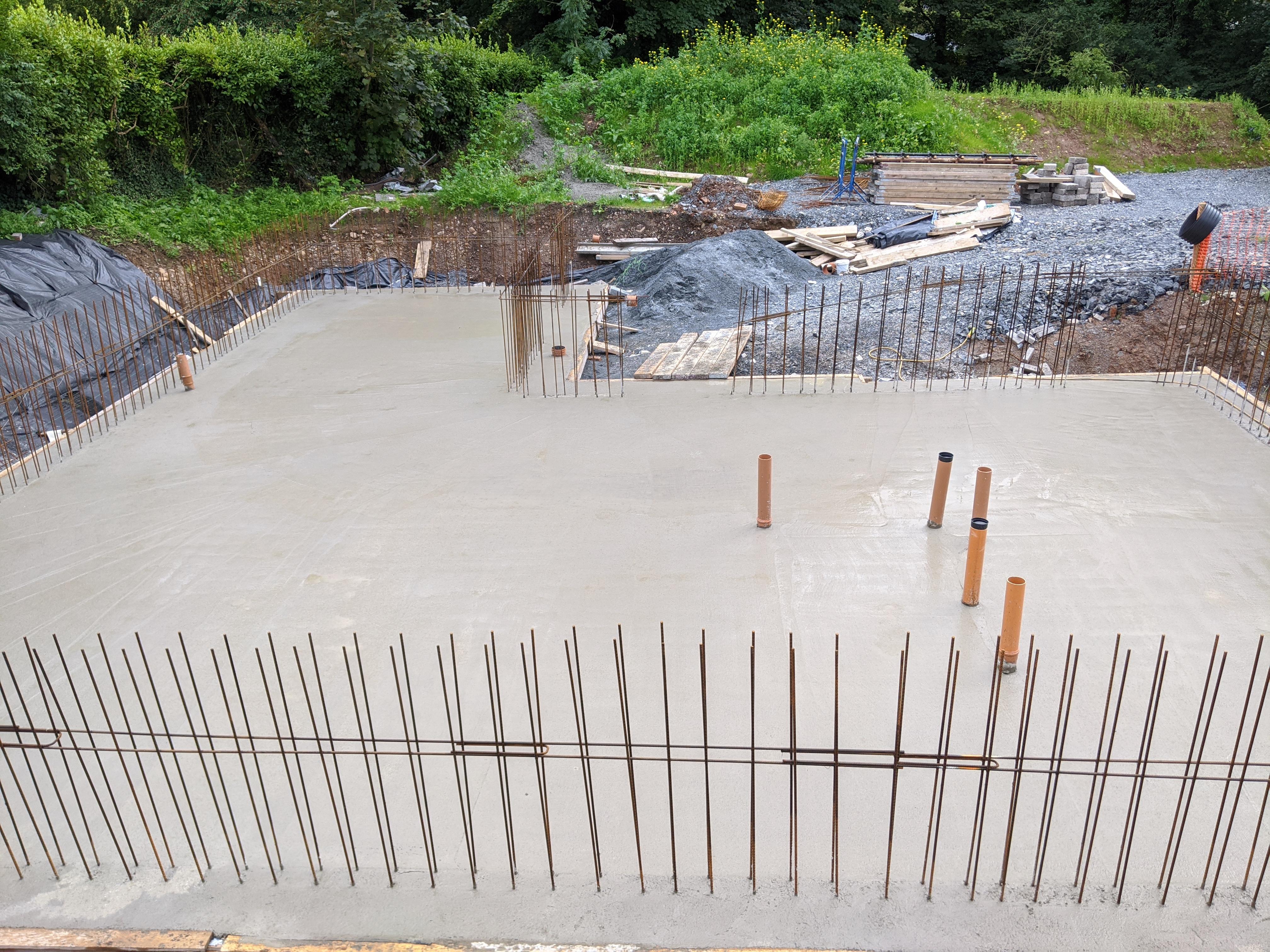

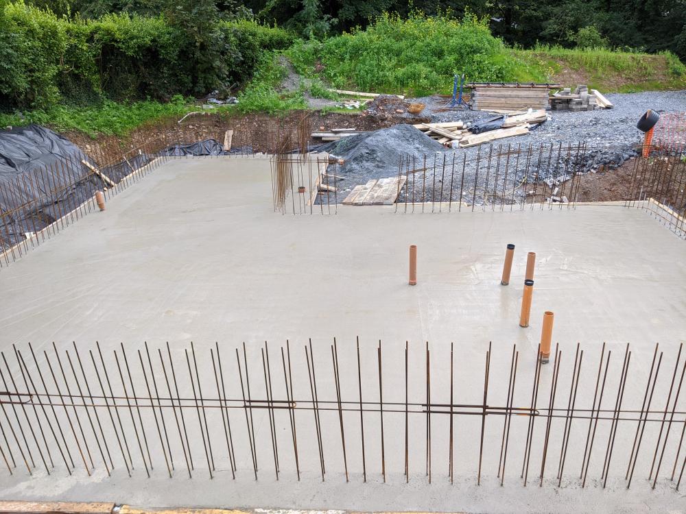

Dave Jones Posted January 15, 2021 Share Posted January 15, 2021 How are they bringing up the soil pipe through the slab/beam ? Can't see a valid reason for not using the correct part, note the leg under the rest bend to support it against the constant weight being dropped on it via the soil stack. Cheaper to bodge it and use a 90 ...... Link to comment Share on other sites More sharing options...
Conor Posted January 15, 2021 Share Posted January 15, 2021 It's encased in 200mm of reinforced concrete, it's not going anywhere. Link to comment Share on other sites More sharing options...
Dave Jones Posted January 15, 2021 Share Posted January 15, 2021 Just now, Conor said: It's encased in 200mm of reinforced concrete, it's not going anywhere. agreed. still a bodge. Link to comment Share on other sites More sharing options...
dpmiller Posted January 15, 2021 Share Posted January 15, 2021 which is inspected and agreed by BCO. Link to comment Share on other sites More sharing options...
Ronan 1 Posted January 15, 2021 Share Posted January 15, 2021 (edited) 32 minutes ago, Dave Jones said: agreed. still a bodge. Not sure on your background but as a former pipelayer I can tell you that it is NOT a bodge, yes a rest bend or duck foot bend would be preferable but in a domestic setting and unless he's dropping more than 3 floors a well installed standard long radius bend will bend will be more than adequate. Edited January 15, 2021 by Ronan 1 Link to comment Share on other sites More sharing options...
Dave Jones Posted January 15, 2021 Share Posted January 15, 2021 disagree. Rest bends are designed for the foot of a stack. I'm sure using a 90 will be fine but still a bodge. Link to comment Share on other sites More sharing options...

mvincentd Posted January 15, 2021 Share Posted January 15, 2021 12 hours ago, SuperJohnG said: This may actually deal with my downstairs shower issue if I shuttered that area at the shower, then dropped a soil manifold low, I can pick up the WC in there on a stack branch. Why not scrap the manifold and just drop the T (with two 40mm branches in the sides) straight in....worked for me. Link to comment Share on other sites More sharing options...
