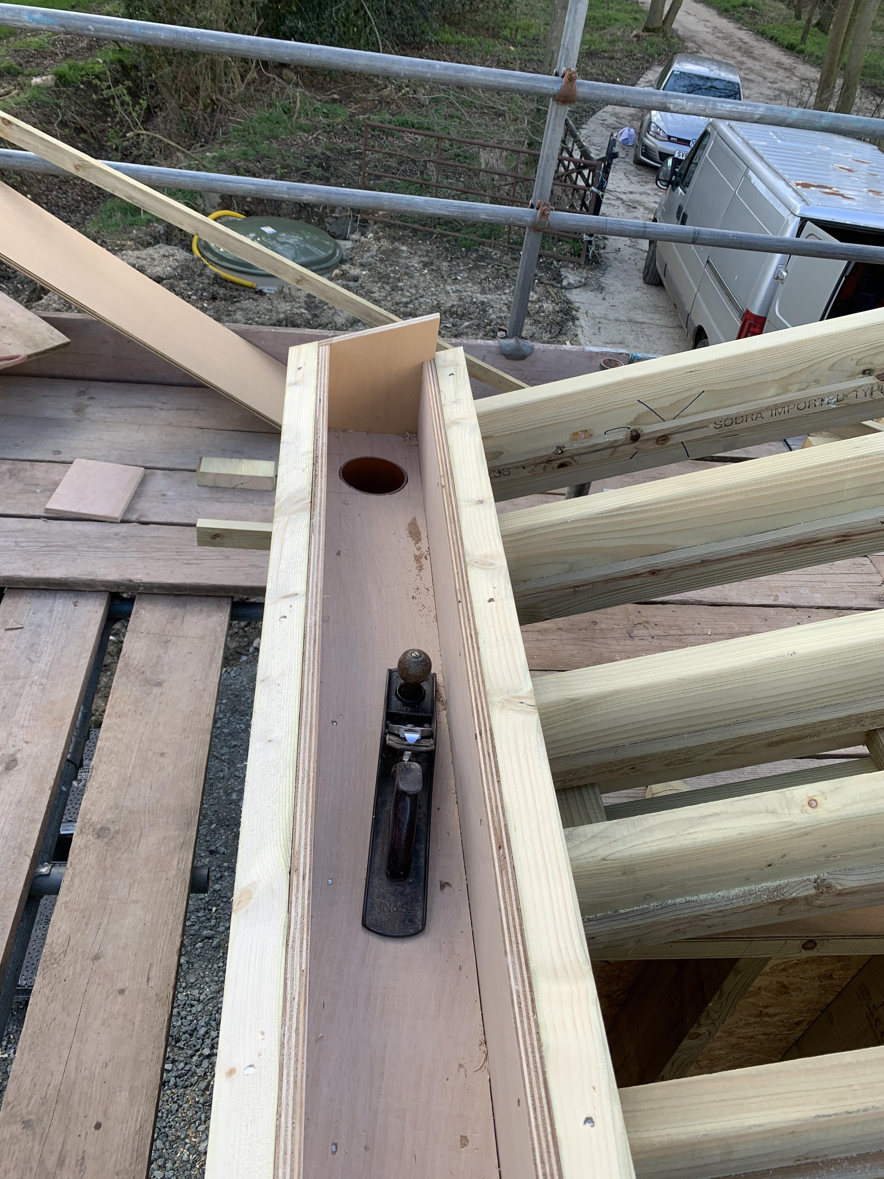

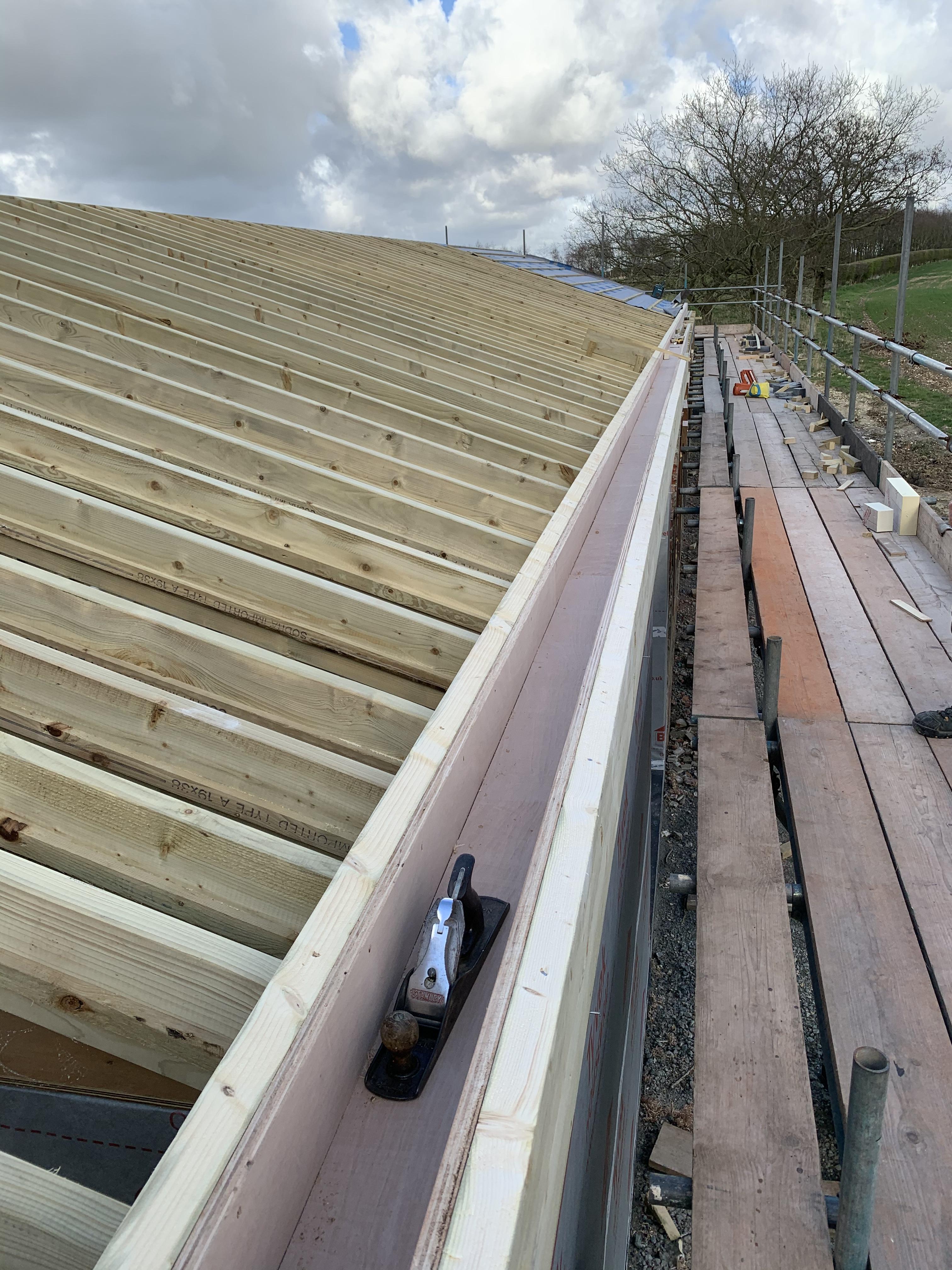

gc100 Posted January 16, 2021 Posted January 16, 2021 On 14/01/2021 at 17:04, Tom said: gc100, can I ask if your hidden gutter is an off-the-shelf system or fabricated by the roofers? my carpenter/joiner/builder made the gutter out of marine ply then the roofers made a zinc liner for it on site. At 14meters long it actually goes in 2 directions each end of the house with hidden pipes in the walls. 3
