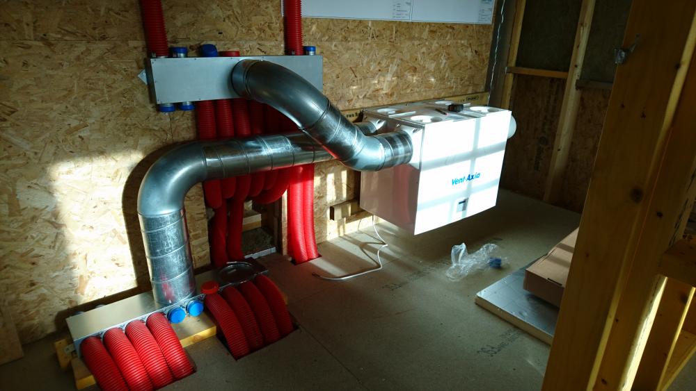

Hi all,
We've just installed the heat recovery system - whilst doing so, a thought struck me. Should I put an extract in the plant room itself? There will be a 400L Megaflow hot water cylinder there along with the manifold system for the DHW supply. Given that there will be inevitable heat loss, is it worth capturing this in the heat recovery and redistributing it? I've got a couple of ports on the manifold left.

As someone just starting my mvhr ducting design, can I ask why thenumber of inlet pipes is not equal to the number of outlet pipes?
Will be because there are more "dry" rooms than "wet".  Doesn't need to be the same number.
Also,  some rooms have twin ducts for extract or supply depending on room size. Ours balances but not because of equal number or extracts and supplies.
The two on the right going into the floor are the supply for the living room. The two going up the wall are single ducts to different rooms.
