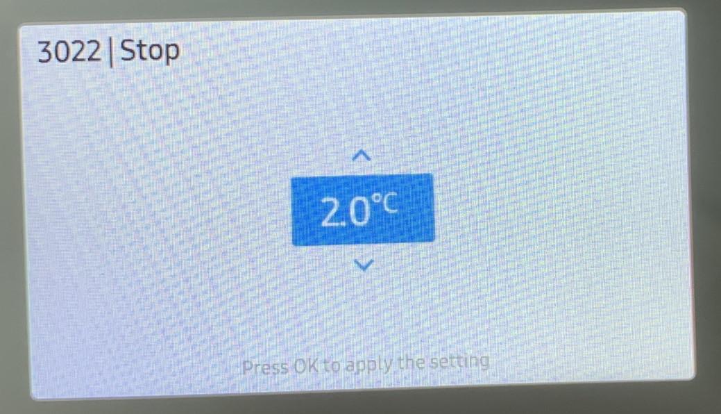

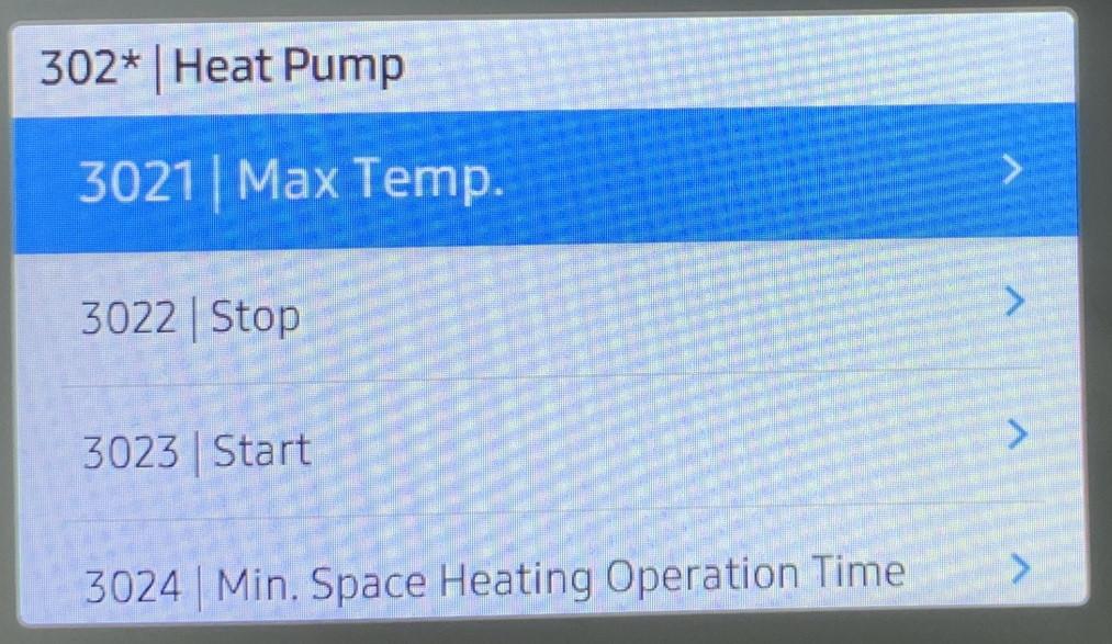

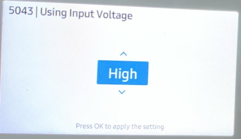

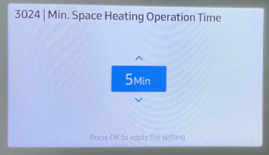

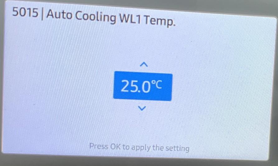

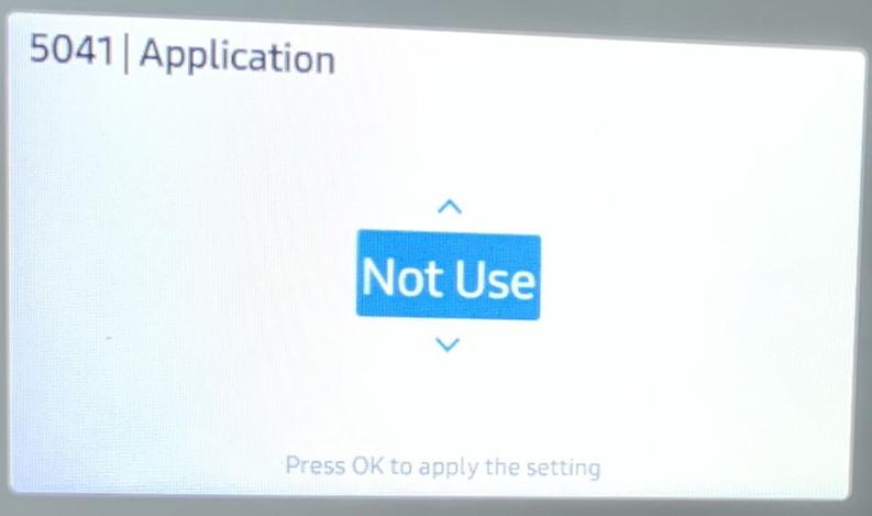

Posted (edited)

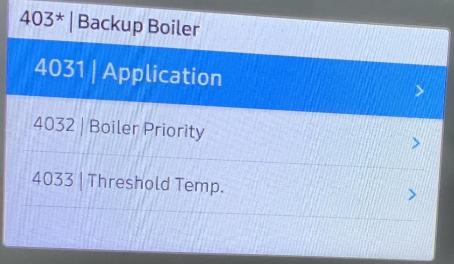

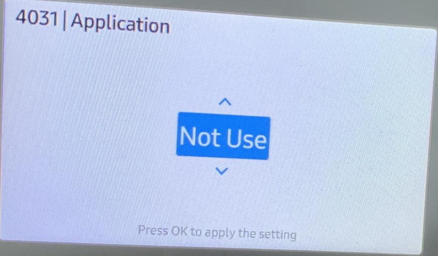

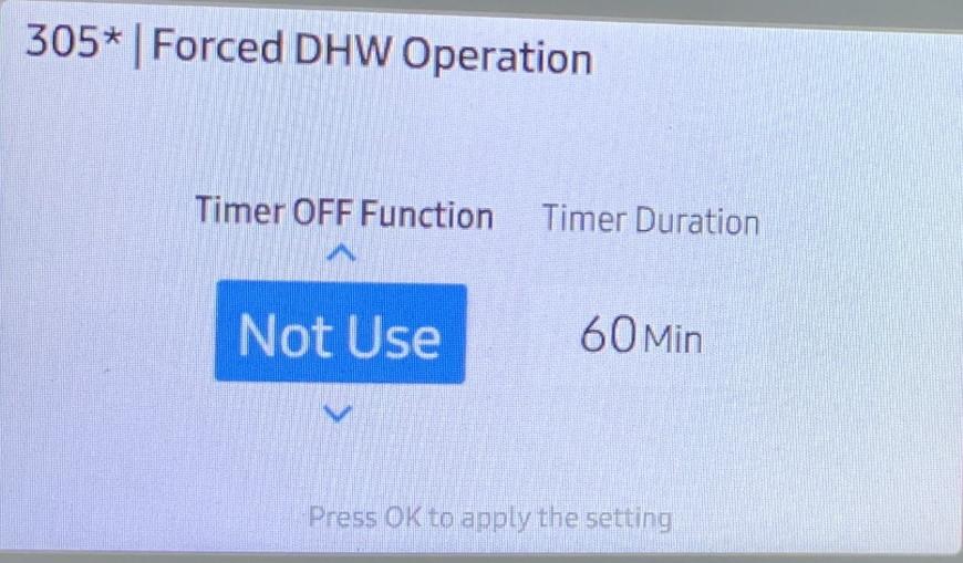

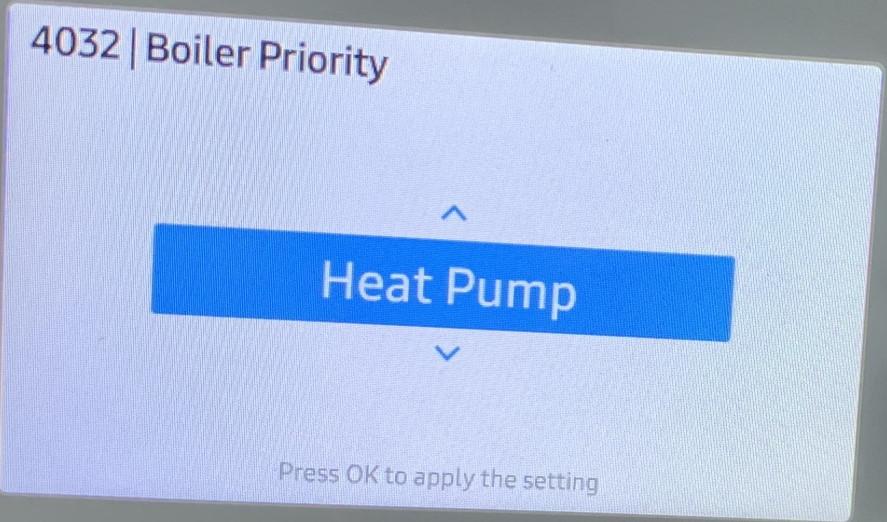

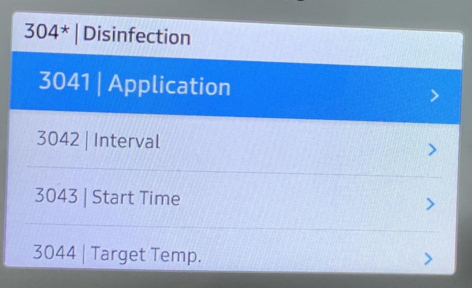

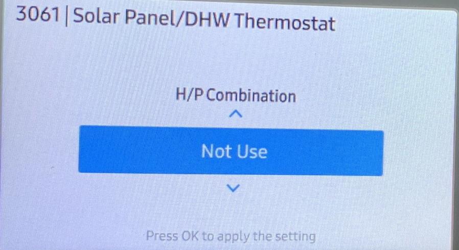

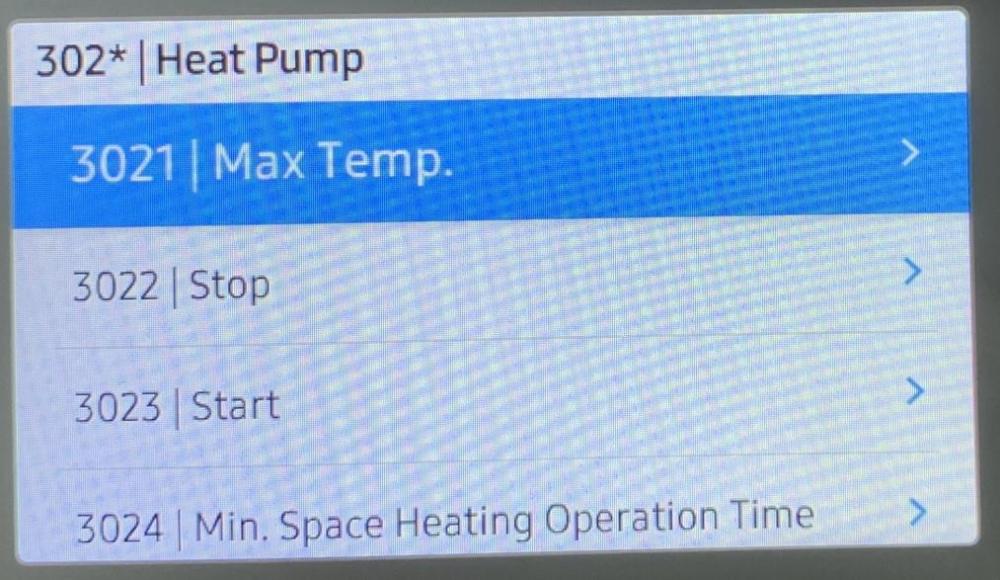

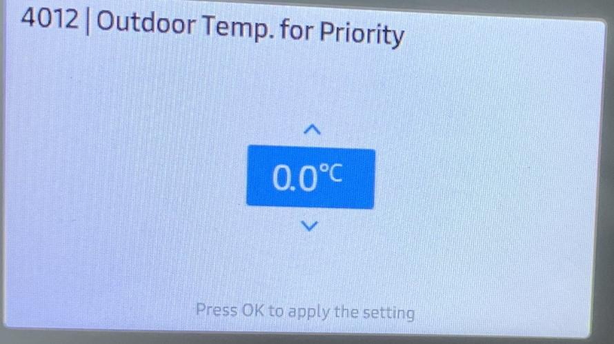

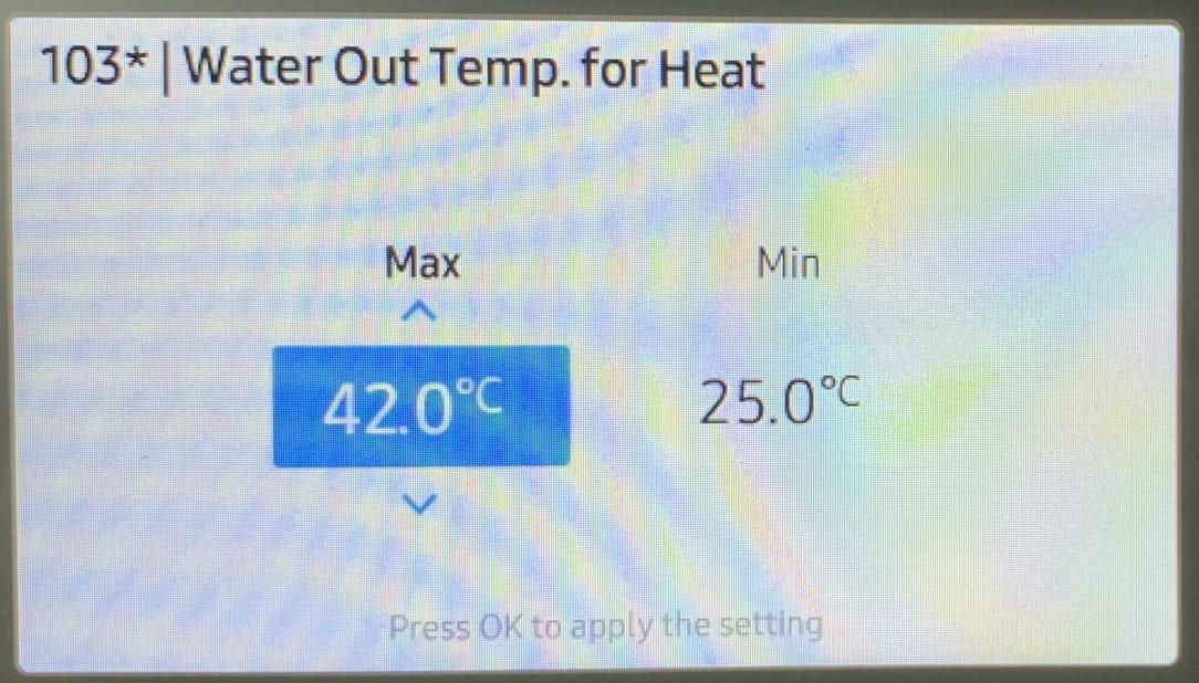

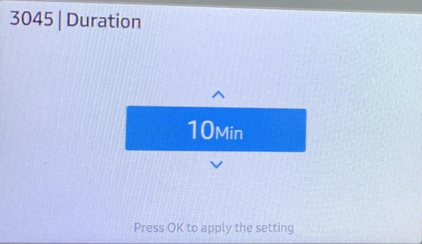

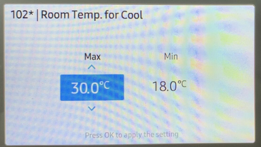

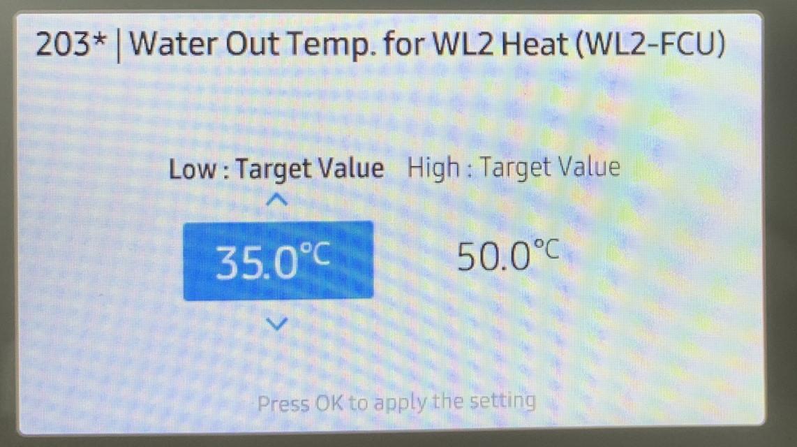

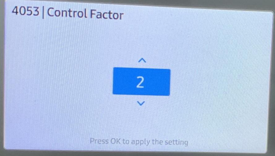

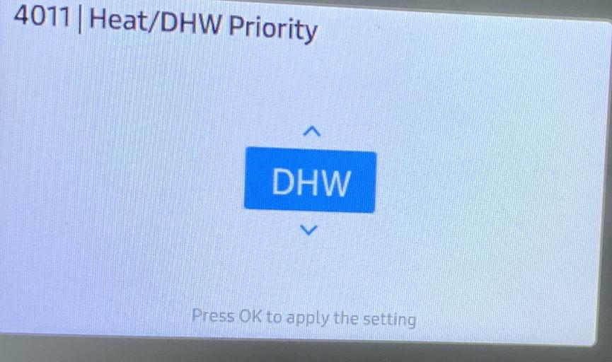

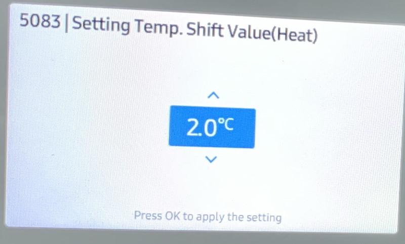

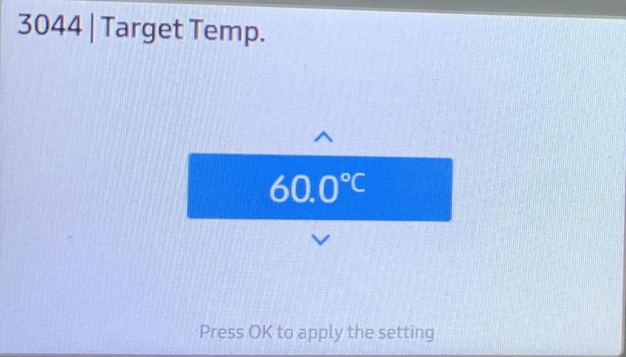

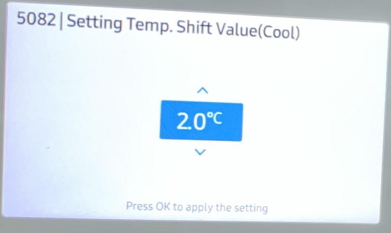

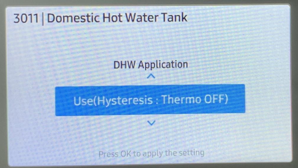

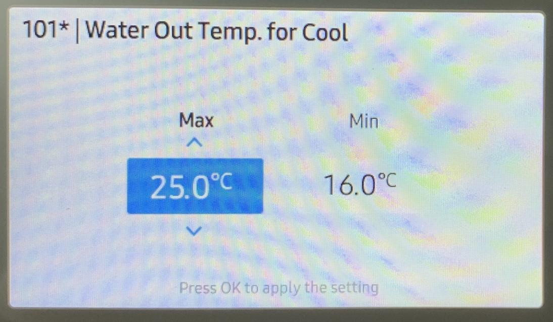

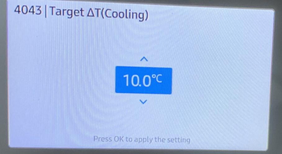

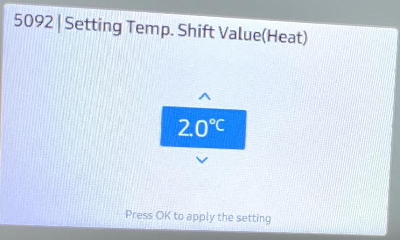

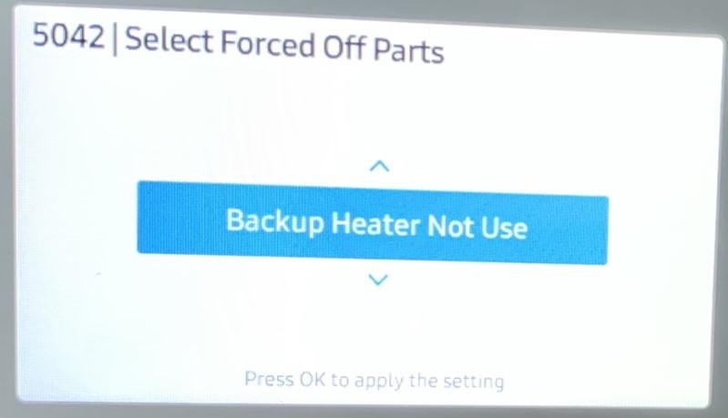

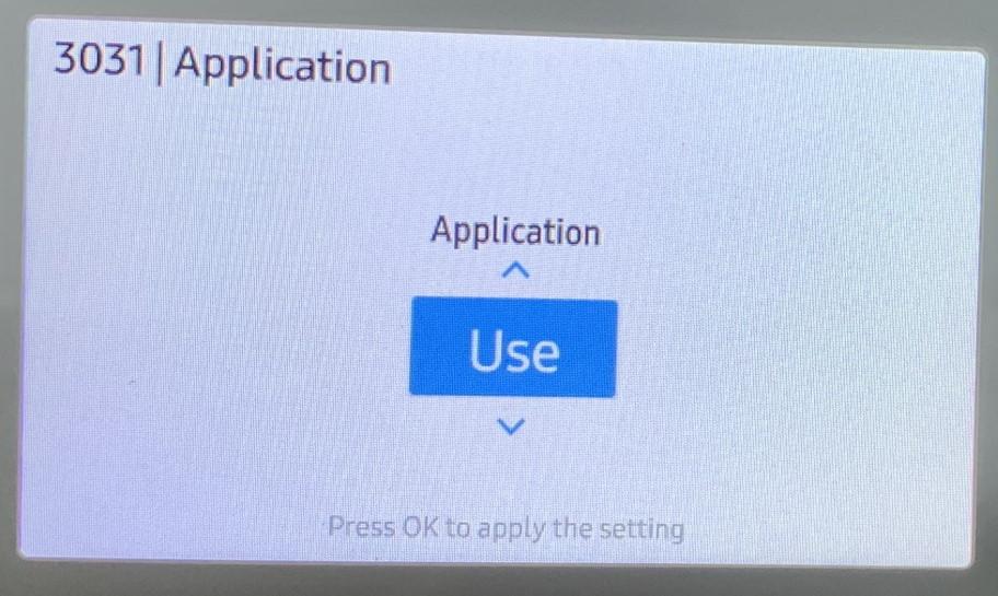

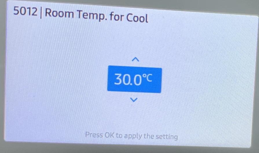

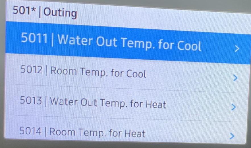

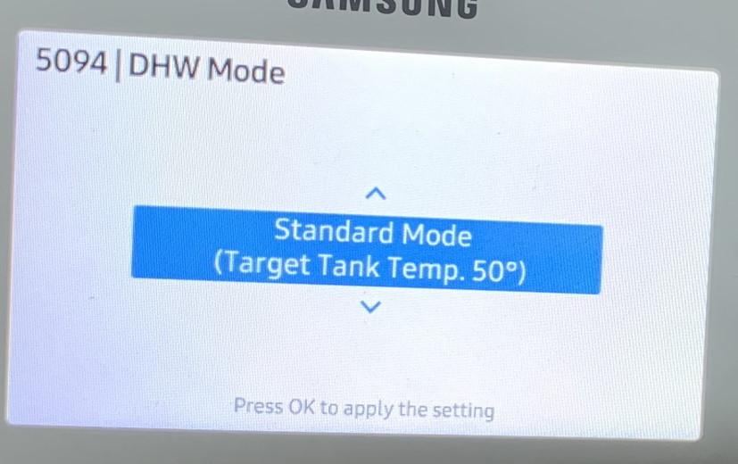

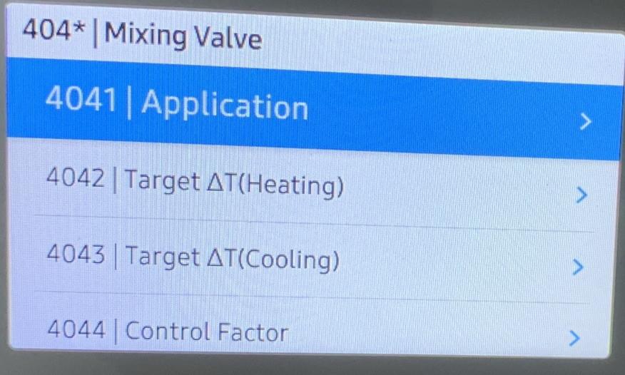

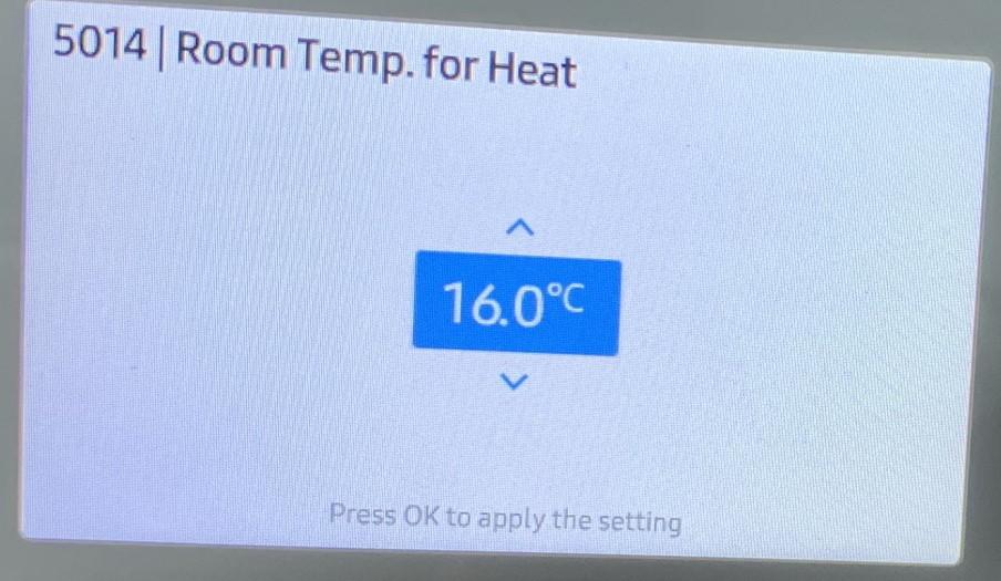

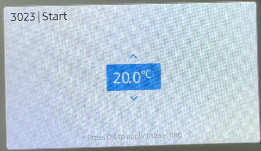

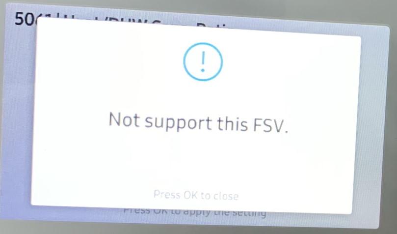

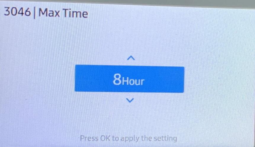

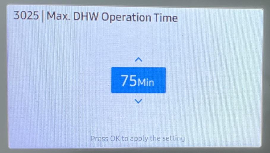

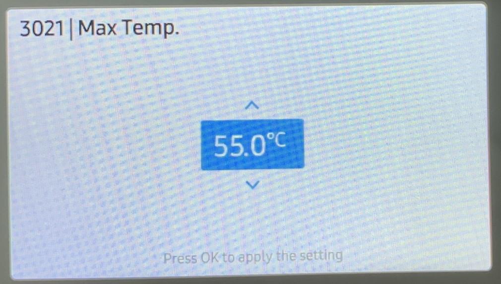

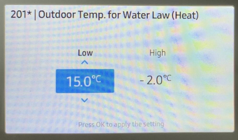

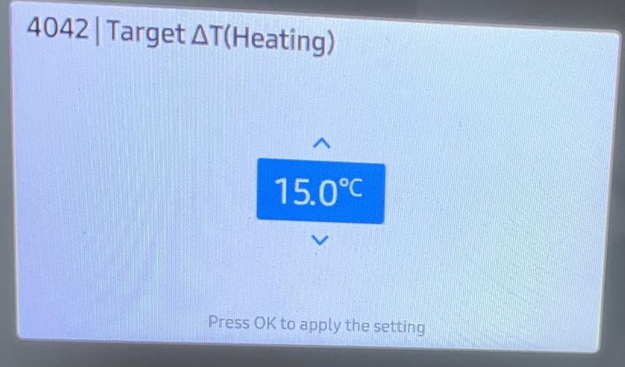

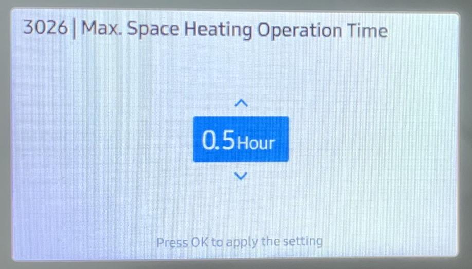

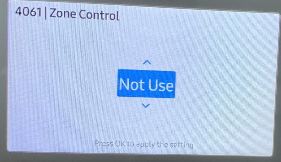

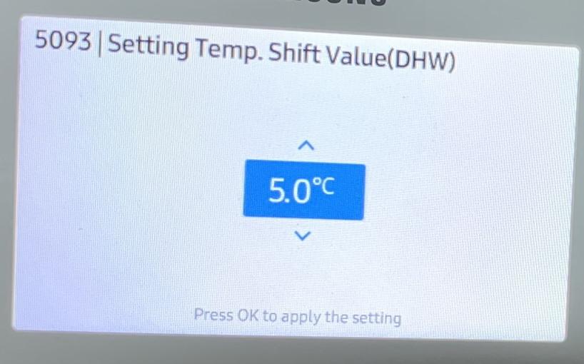

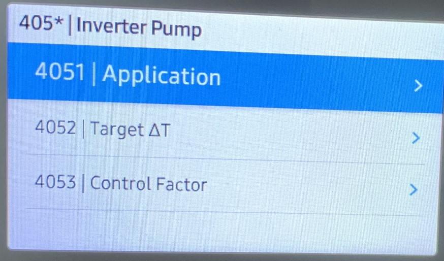

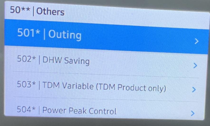

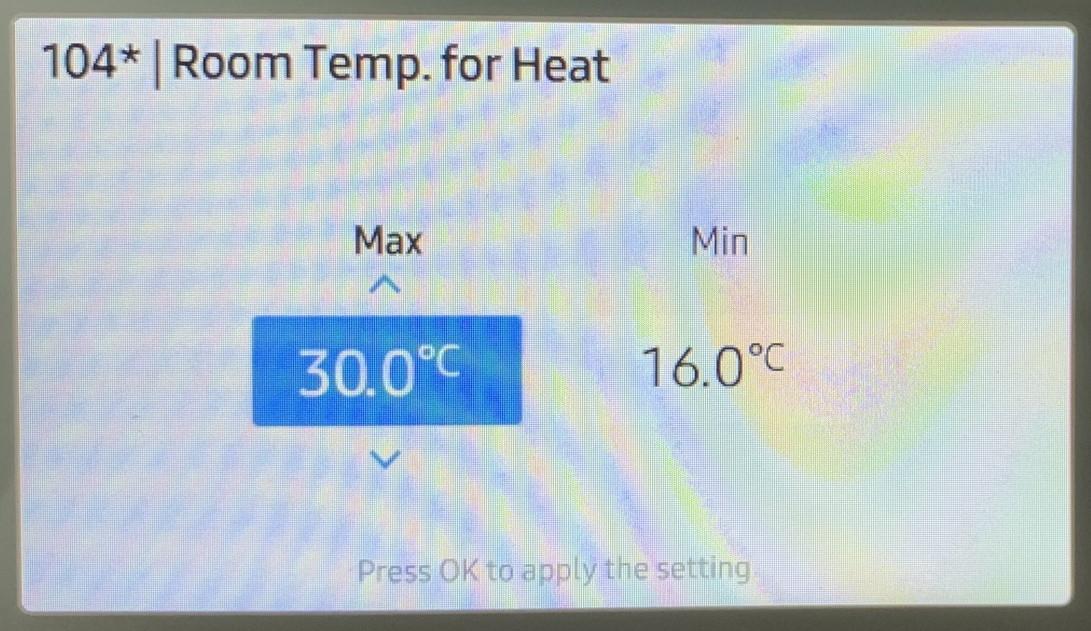

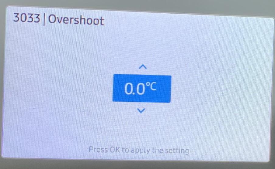

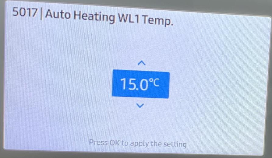

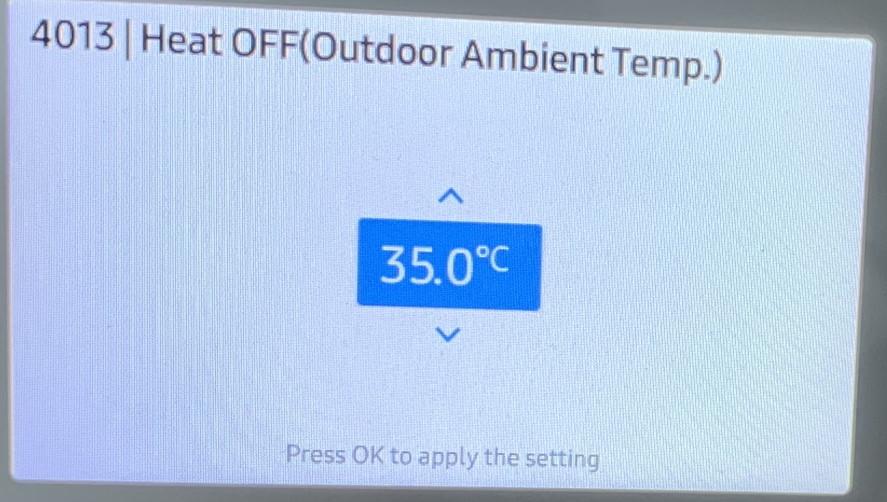

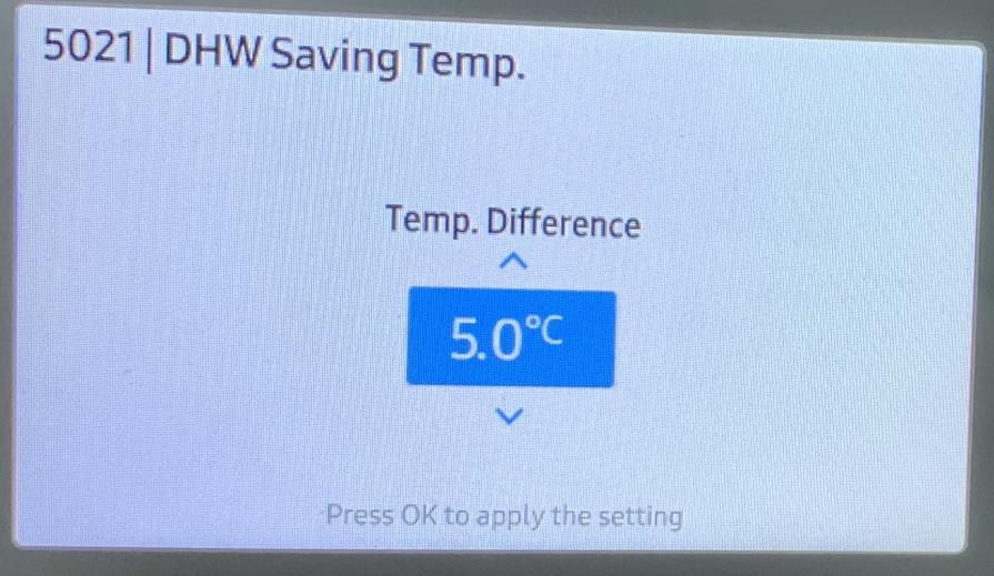

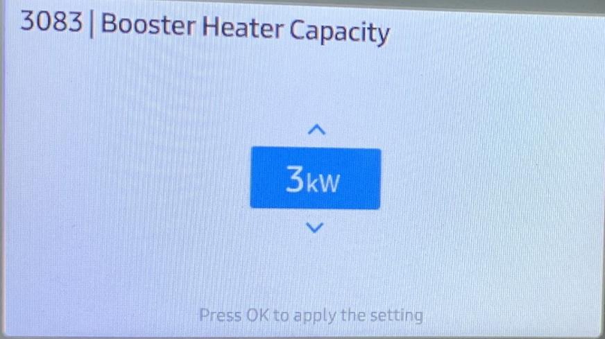

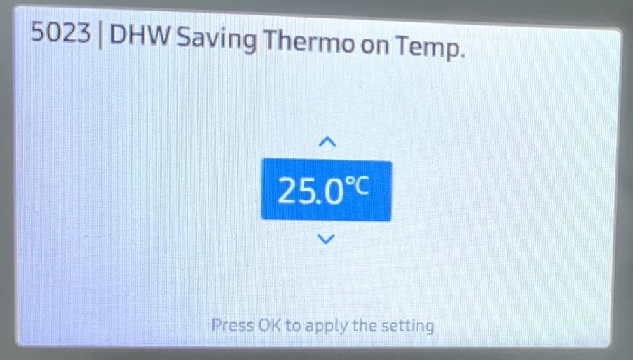

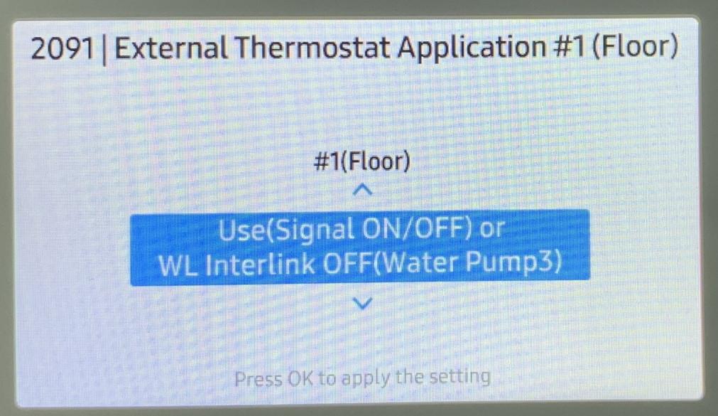

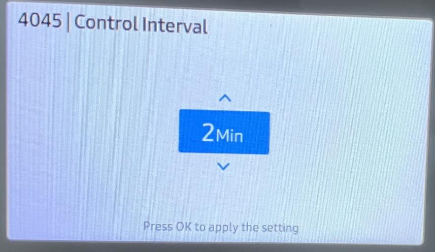

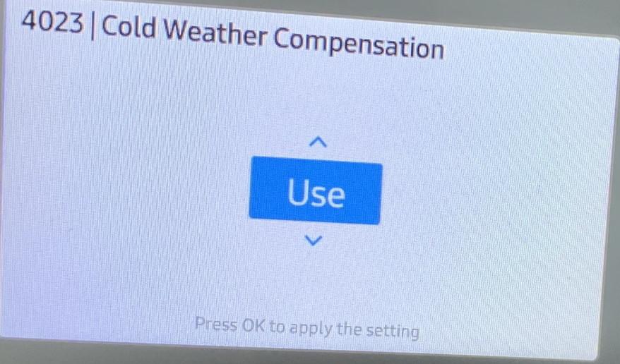

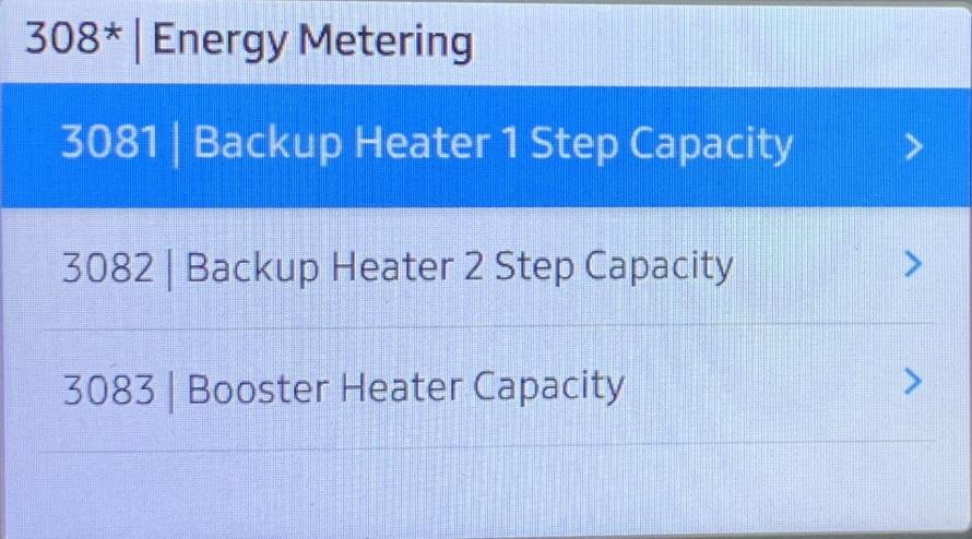

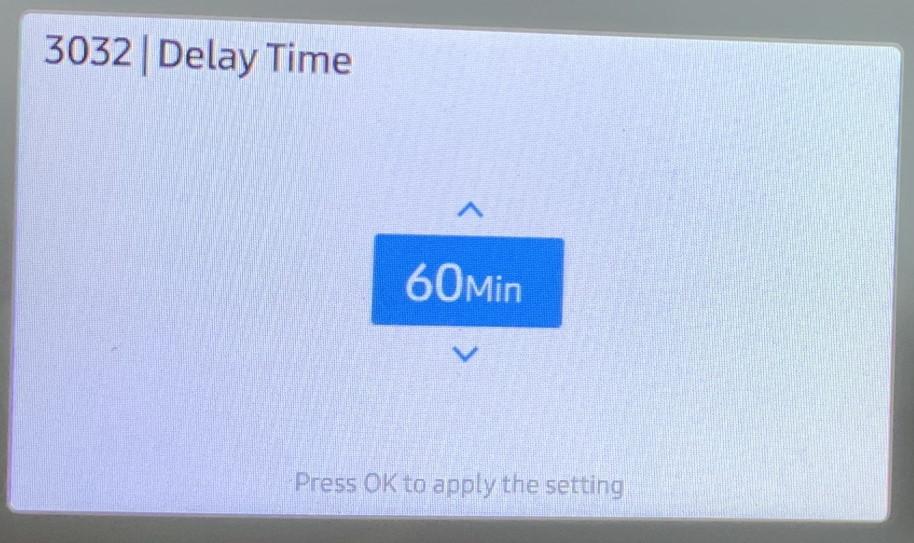

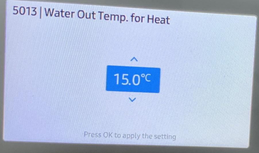

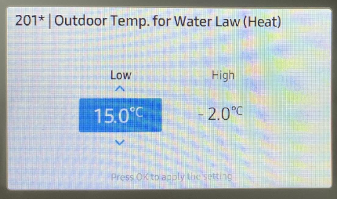

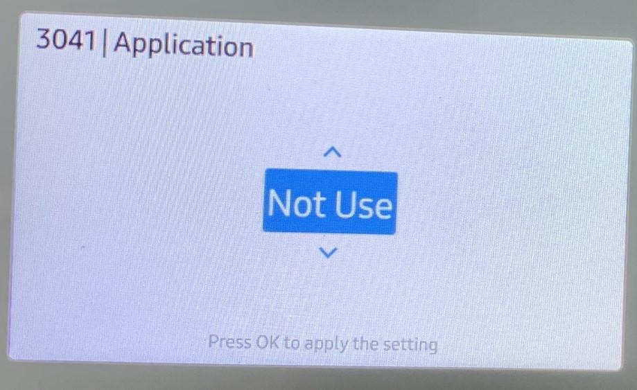

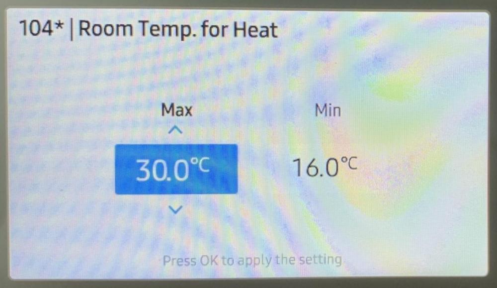

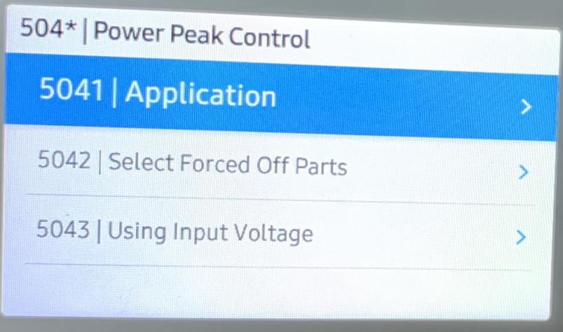

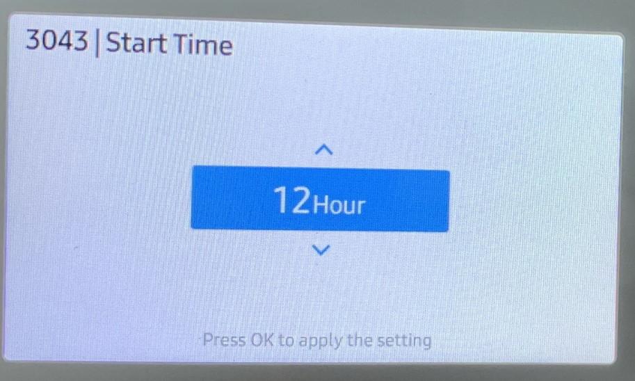

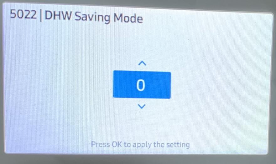

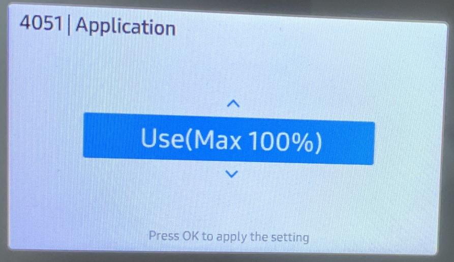

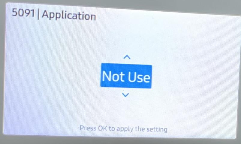

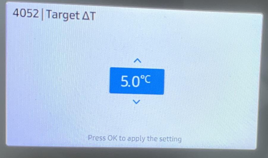

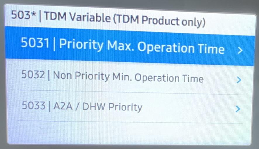

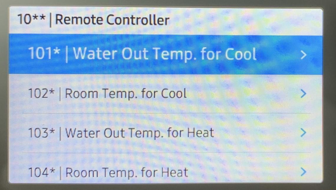

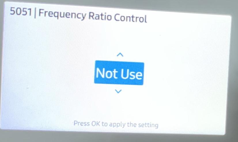

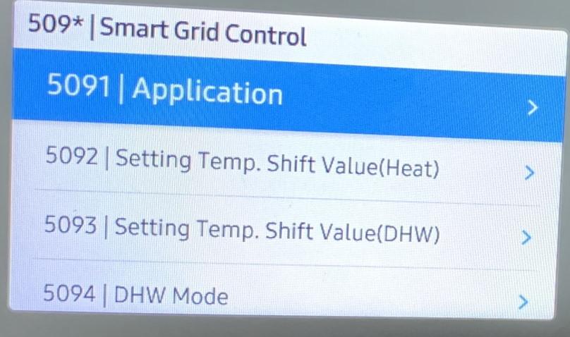

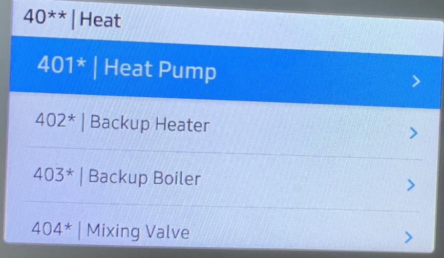

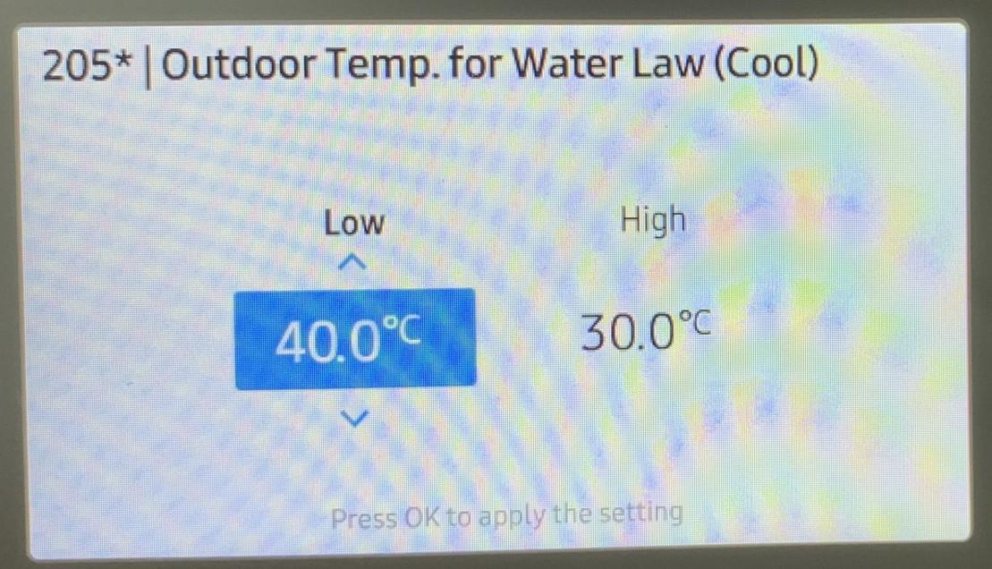

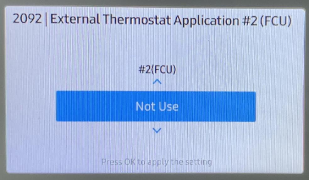

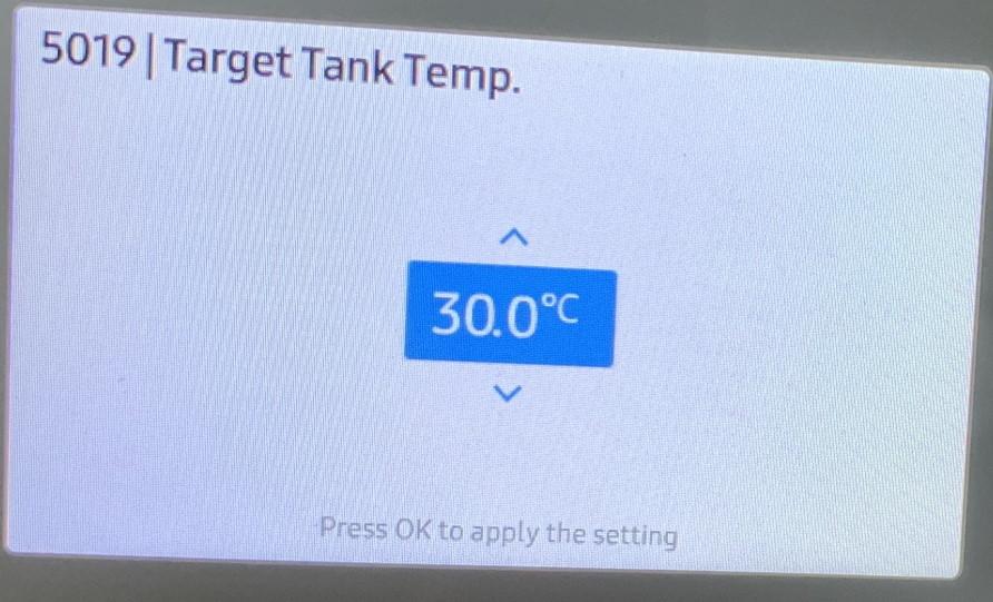

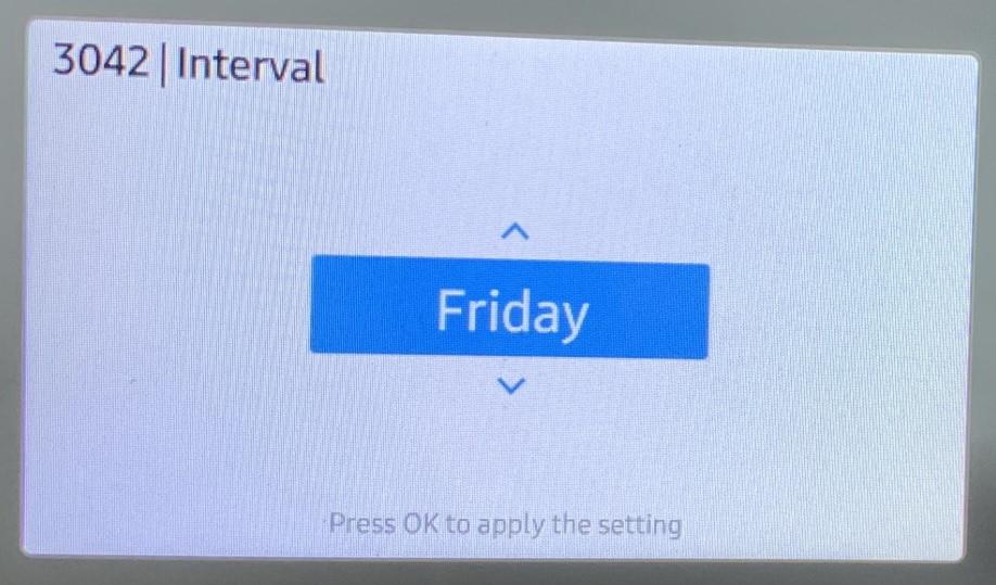

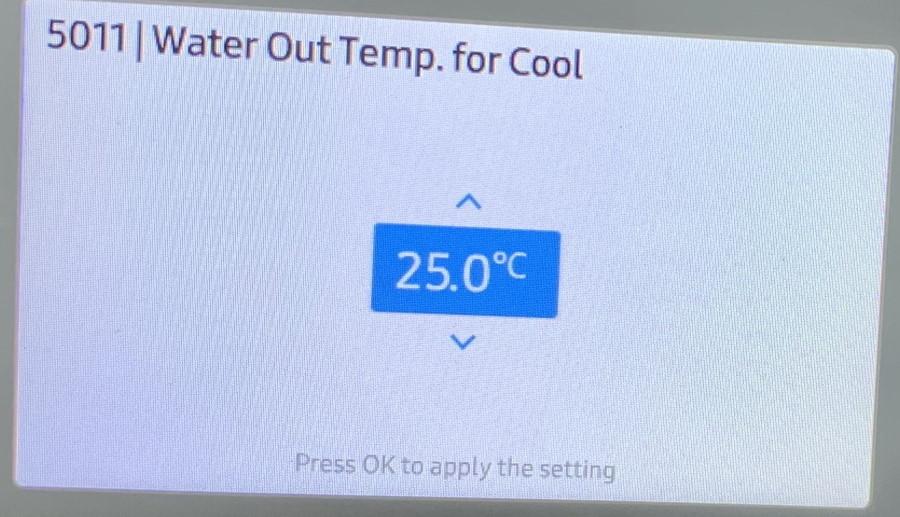

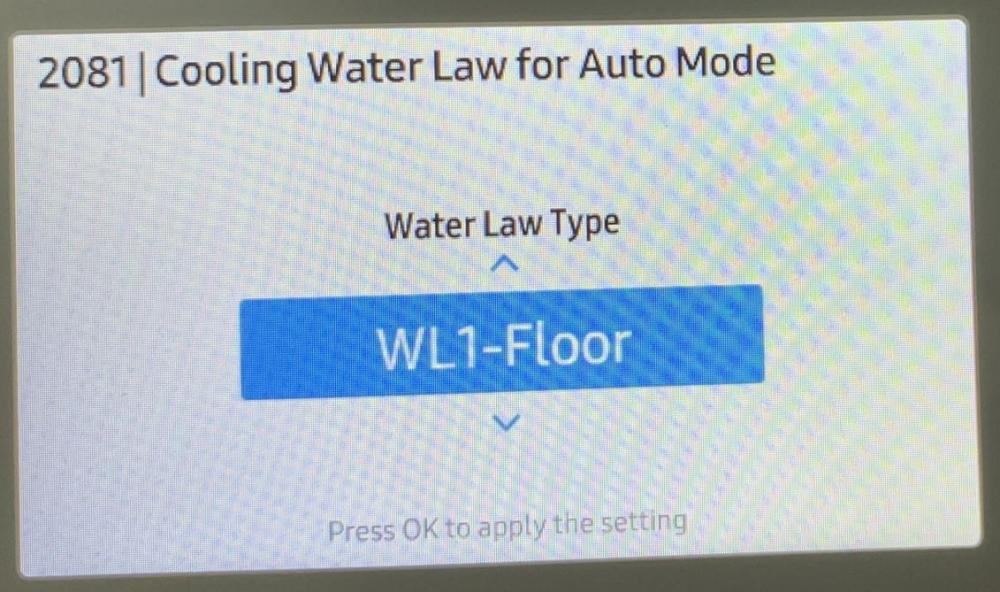

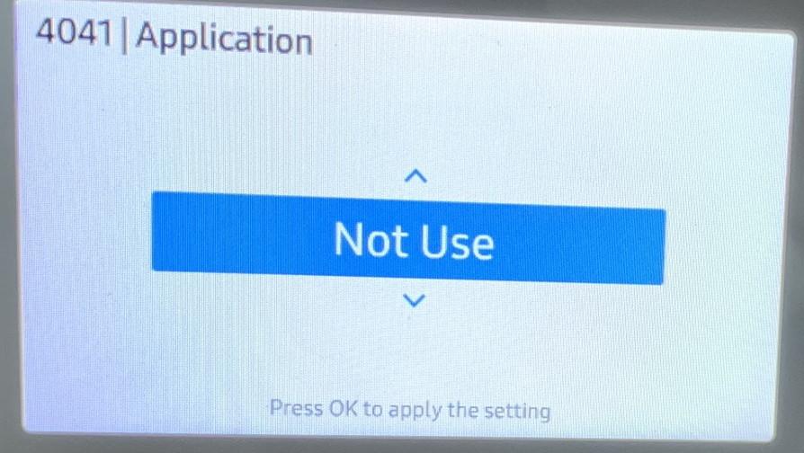

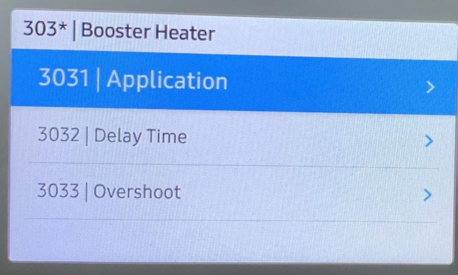

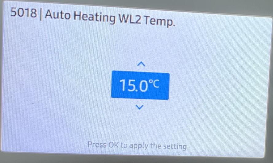

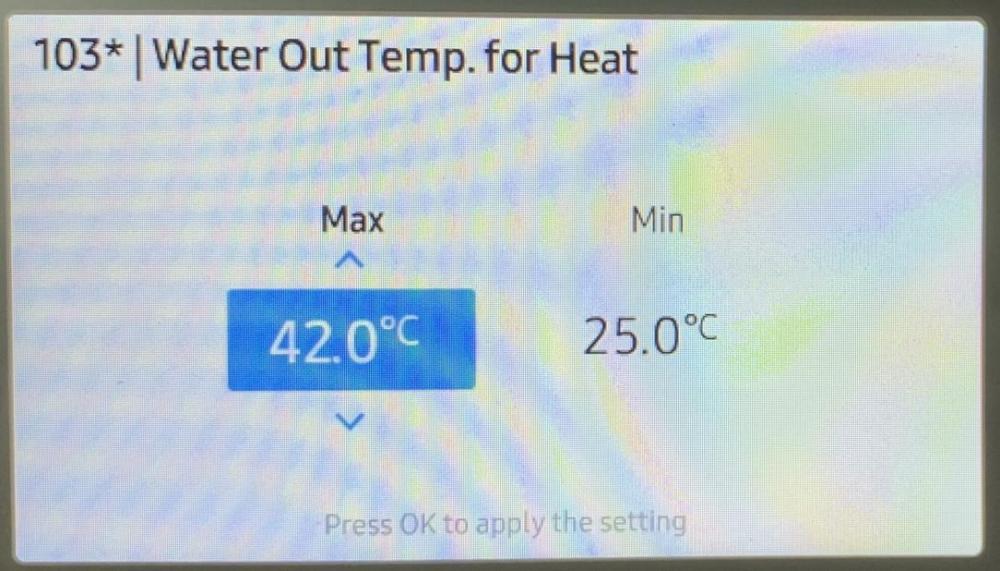

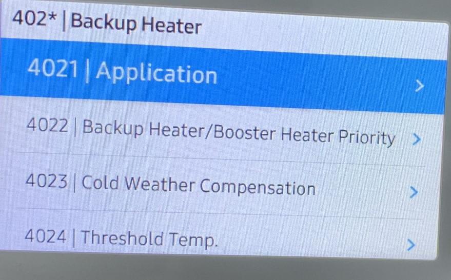

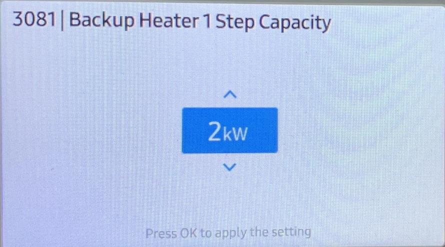

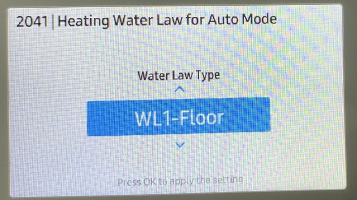

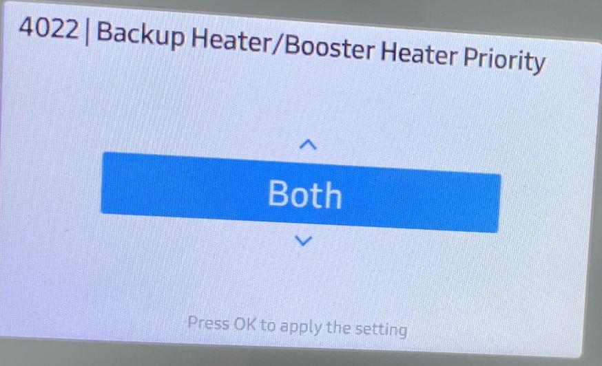

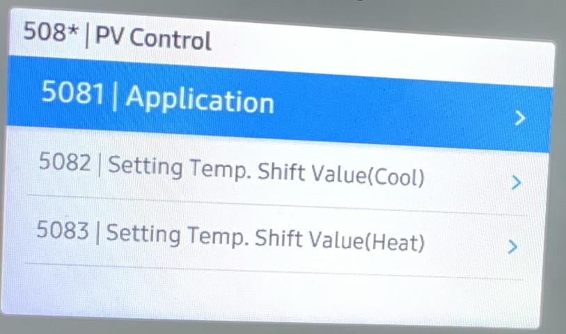

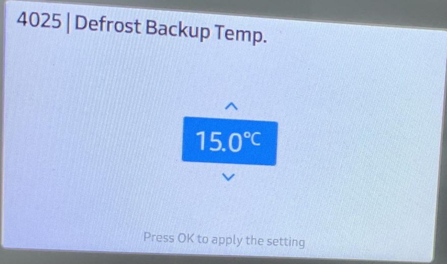

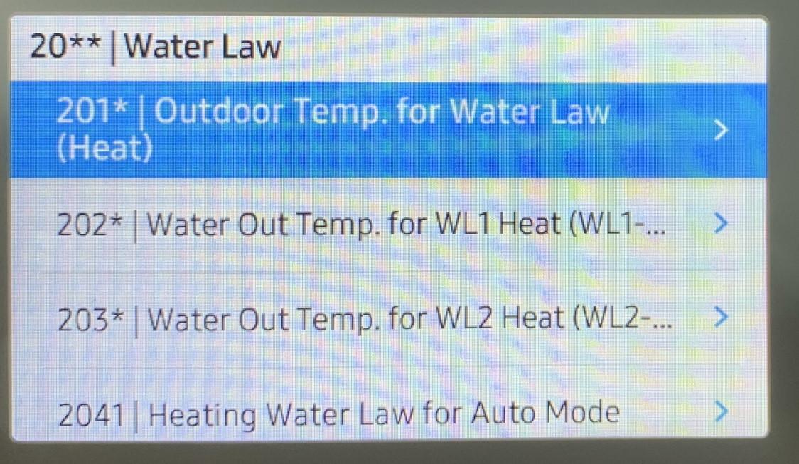

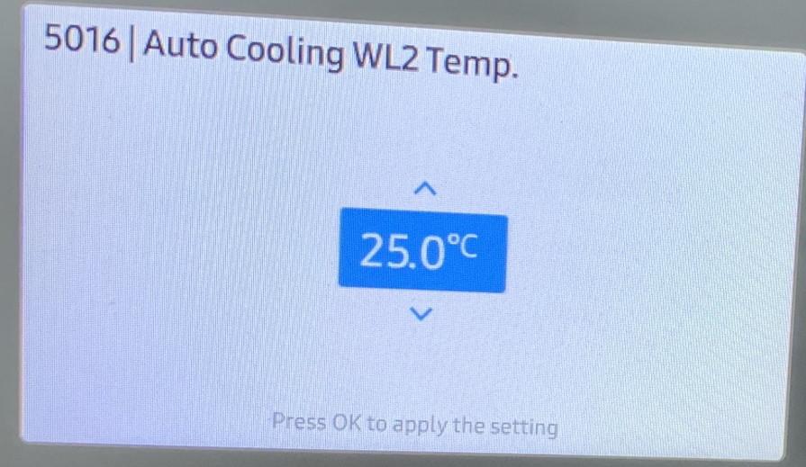

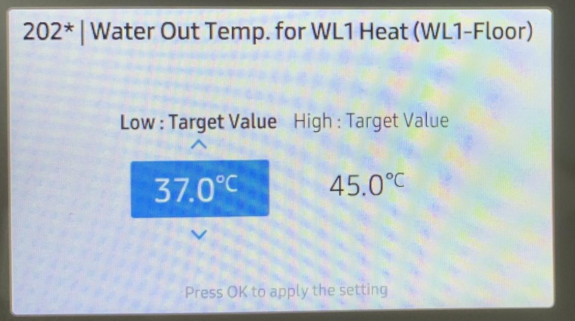

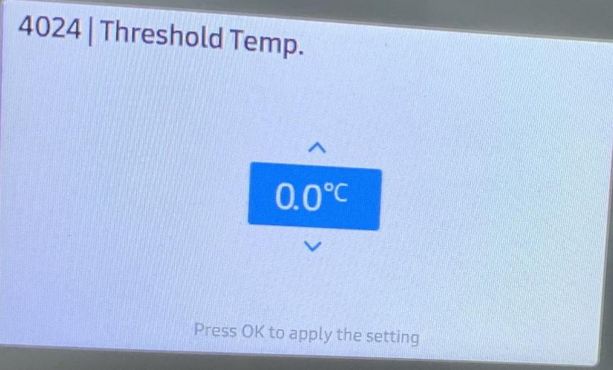

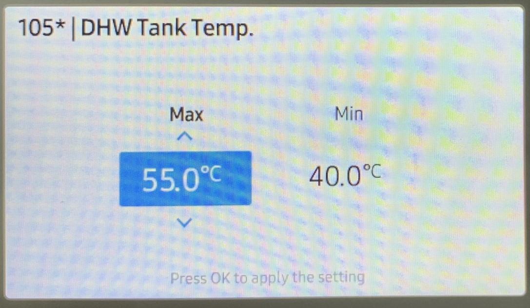

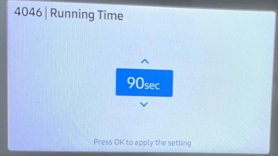

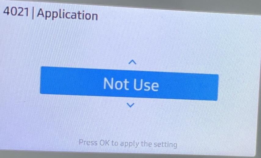

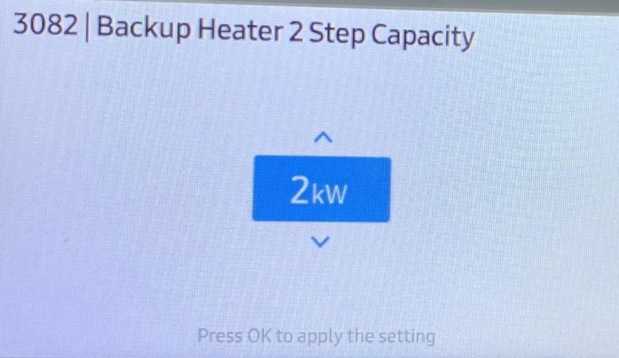

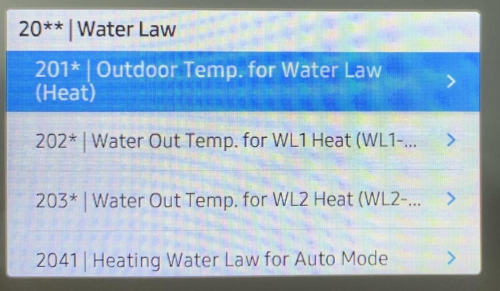

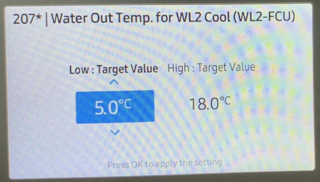

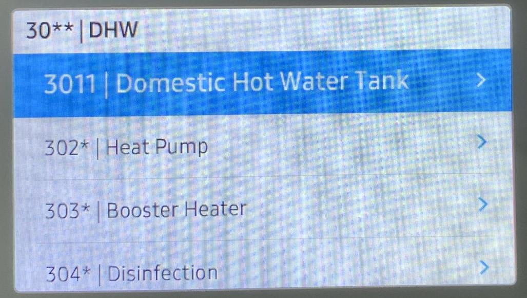

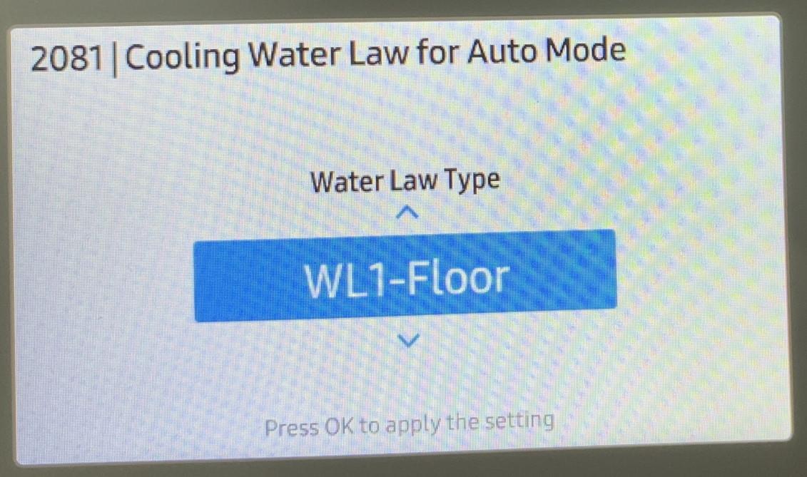

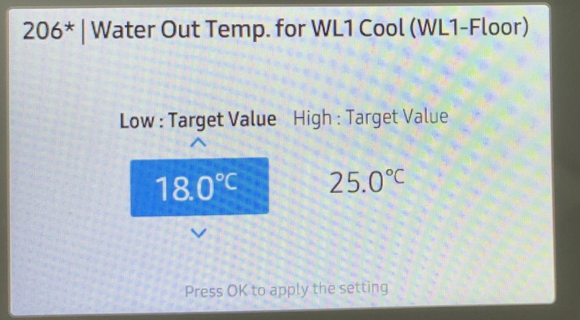

So, here you go - happy new year, here's my Samsung settings... sorry there are so many pics, did I mention I detest this controller?
4000.jpg.924d76288b7f24ddb0609affda1f38cc.jpg3011.thumb.jpg.3371bd9c311f382044fcb341788ab968.jpg4010.jpg.87b8a2ebb944f0bdb7f4e8c4f9090d04.jpg4011.jpg.1ea6a1164c49475bb6a1bd2aa2d6cca8.jpg4000.jpg.924d76288b7f24ddb0609affda1f38cc.jpg3083.jpg.5489a0bd6d16ef5e6b105ecb6dc34ef9.jpg3082.jpg.55b14ee3a1b0aa7e3180c0acb1135785.jpg3081.jpg.6f10b0db0c361eda6ae56c84dc2608a1.jpg3080.jpg.ac883cd7fdcd3fbaf1ee6a0cc70c51b6.jpg3071.jpg.6e6566d9d1275370bbd03f244a940bc5.jpg3061.jpg.fe5322464b764bcd2f797762d61c5973.jpg3050.jpg.53df9b043e07dbe902d80d0831631a1e.jpg3046.jpg.719636b2315f98638d898f8eb00d9d47.jpg3045.jpg.44d07254662f41b58a42fe764dd7bd2c.jpg3044.jpg.aa0e82d1f6f40784189bebaf2dd8b312.jpg3043.jpg.e4a38f98bea9084ad47e23230331d19b.jpg3042.jpg.62dbe81d52e5ba19907d411f37c57504.jpg3041.jpg.b3e5828ee4e0f25679494b4295fe26d5.jpg3040.jpg.ec750215ffcb1054b440e55fd79ce156.jpg3033.jpg.0b8f04d54160c8f8fdefdae5bd46deae.jpg3032.jpg.761ecbd6cfeeb8ee780225716027f4a8.jpg3031.jpg.803d72ceea649b3a0b3d1e7d04117bb4.jpg3030.jpg.39a1ea078e6e31bf691c75126880bc7a.jpg3026.jpg.289dc991f07c8e0c0aba51f8bc3dfe26.jpg3025.jpg.14bfc532c7f8b8e2013c6432415d6f5e.jpg3024.jpg.5733bf3fbf551bc6123191f3a79054be.jpg3000.thumb.jpg.78062205451064751a40676dba2eb566.jpg2093.thumb.jpg.2d07b05d4b26cee0b16d7e5dd987817f.jpg2092.jpg.2127d7936b3a3fc1c7732b527e801f5e.jpg2091.thumb.jpg.ed02e88ad6398994d3e1fcb07e9af3a6.jpg2081.thumb.jpg.1a7da65c3b0672180b904b19e2dced09.jpg2070.thumb.jpg.7d7203c2ae54b1e74579123a662720a3.jpg2060.thumb.jpg.646bb3bd197e39b6482345df8edb967b.jpg2050.thumb.jpg.e7185bd61153d837b6d751602b43524a.jpg2041.thumb.jpg.ca9402f97b11c53718f0c8c68eb528be.jpg2030.thumb.jpg.74a57db48bd0daf9e276b0ebddfc95c7.jpg2020.thumb.jpg.c298753a7f89dccab01a388475a9bfdc.jpg2010.thumb.jpg.3928777609e825fa60864ed7a9aa1d6e.jpg2000.thumb.jpg.b3d920a047ea40ac6525f51c026d9cb3.jpg1050.thumb.jpg.97c14b01d08c9832c68ff651d895f977.jpg1040.thumb.jpg.7587d04a6c7e2b742a777d0b6d389d4c.jpg1030.thumb.jpg.5f468c3cc48ac99fe5a03b868bf03c07.jpg1020.thumb.jpg.4629ba2ae4ded5a49bc826428634fdcc.jpg
Edited by andy
Posted
Any point having a mixer valve with ASHP?
The HP will control the flow and return temps and they are low anyway not like a boiler that needs to control the Max heat into the floor.
Ive never had a mixer.
Posted
Depends on the set up, my ASHP only has one temp setting to deliver heating and DHW, I set it to 47’ which is enough fir DHW, it heats a buffer to 35’ for the UFH and a mixer on the manifold brings the temp down to 25’.
Posted
Absolutely a requirement. See this regularly and they can overshoot and they can also not modulate down far enough. The modern ASHP refrigerants can hit 62°C too, they are borderline boiler temperature.
A mixer also gives you the pump which is essential - most issues with UFH come back to lack of flow and as soon as you start with 2 floors and multiple manifolds you need to manage the flows properly.
Posted
I don’t use my HP for DHW so it’s set to return temp of 35 C, so nothing to mix really.
I have a pump at the buffer tank side which continually pumps whether calling for heat or not but more often than not the rads always need some flow

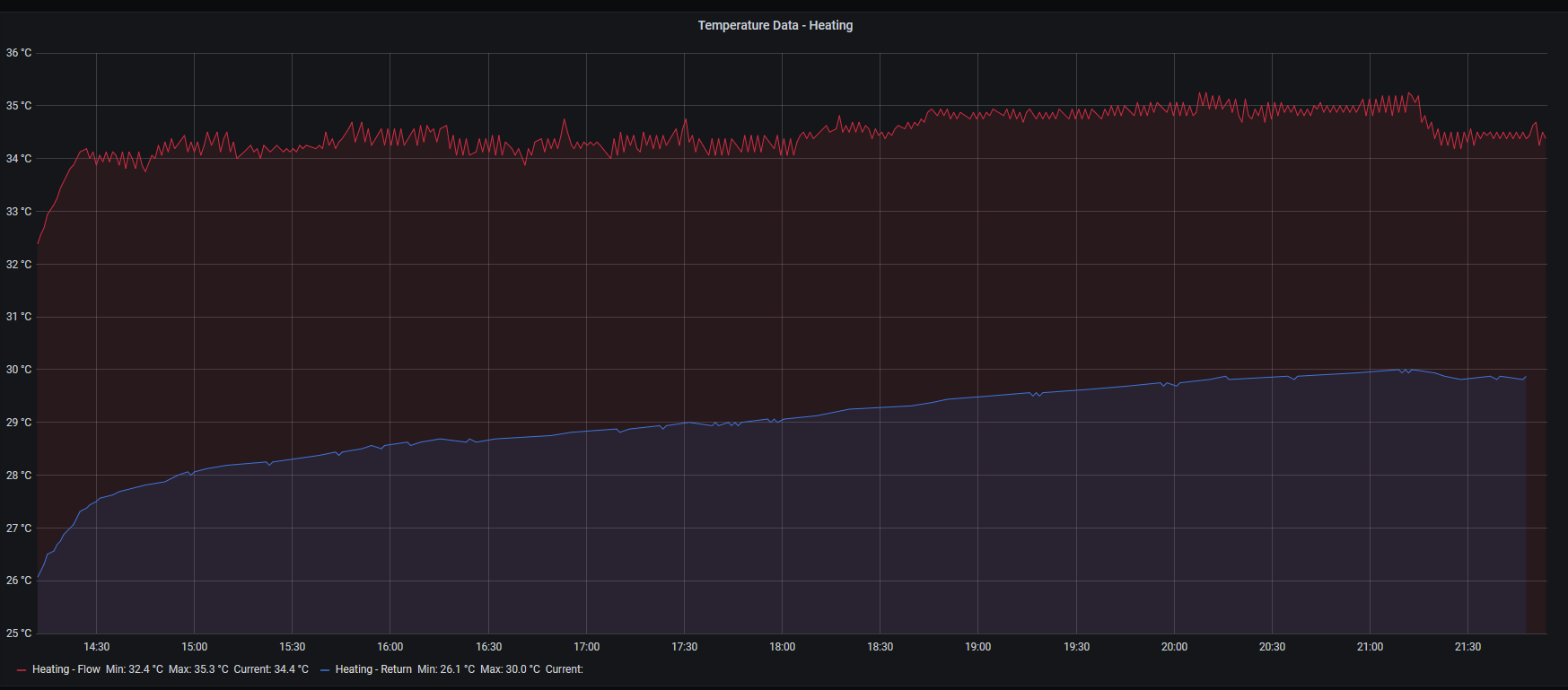

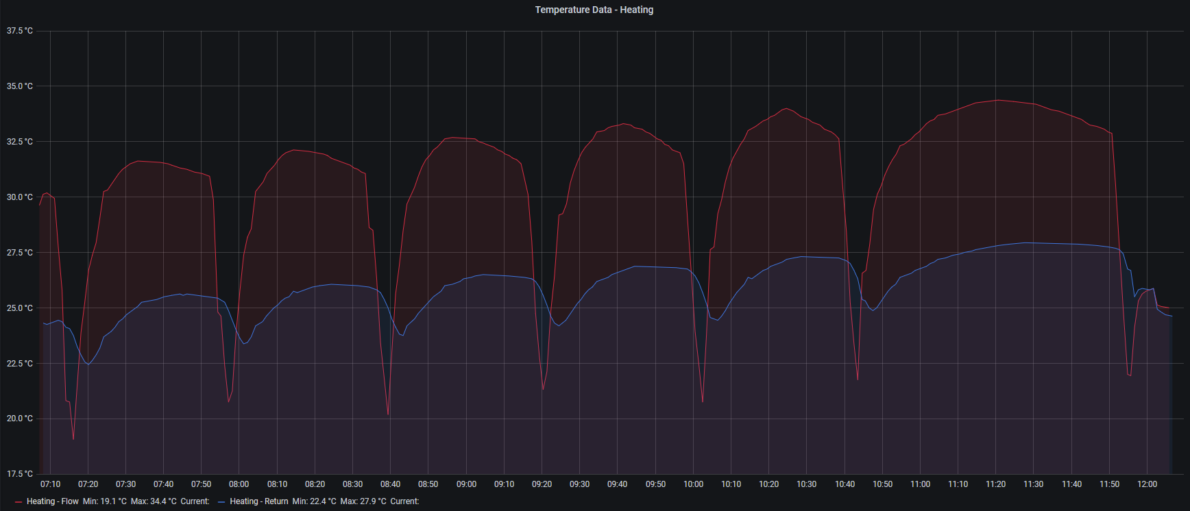

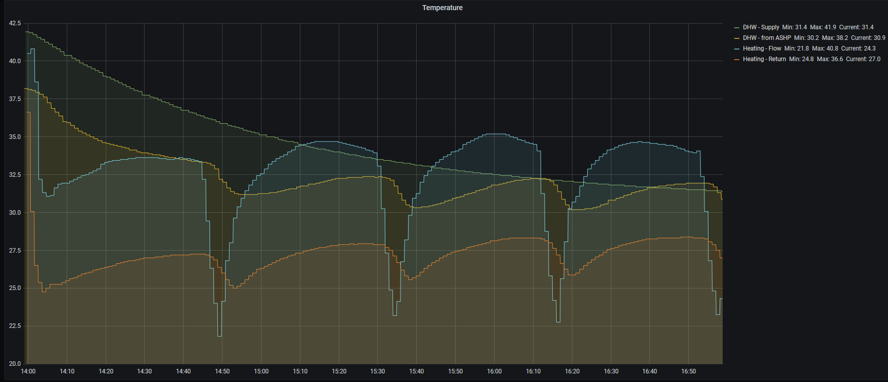

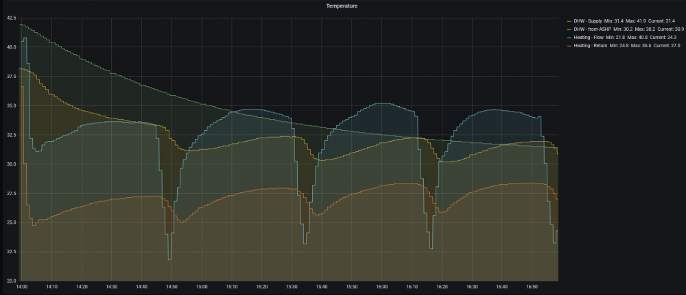

Right - made time to get Garfana up on my Raspberry Pi.  The flow 1-Wire sensors are in the loft, so we have data now ?:
Posted

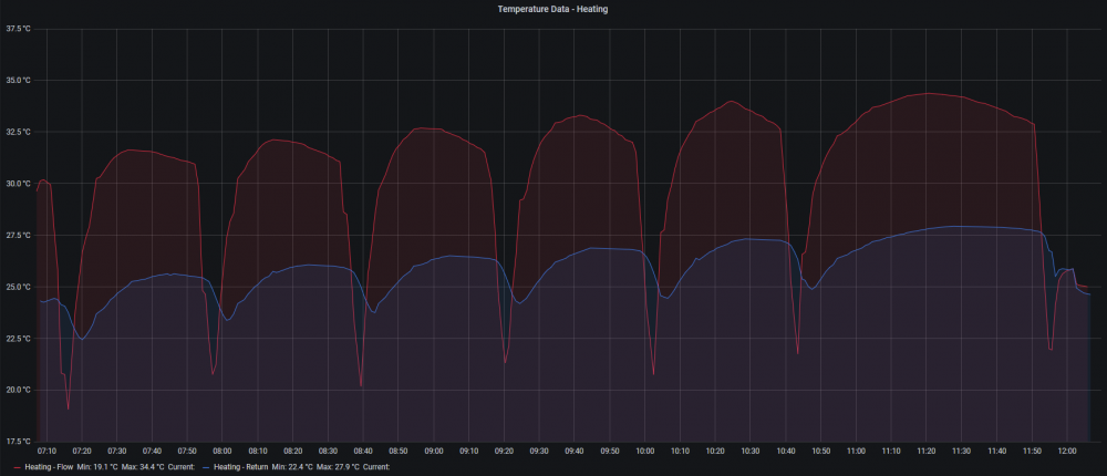

More data, this was yesterday morning flow and return temps - alas I don't yet have external temp sensor but it was around zero first thing and icy (outside).  I am wondering if a buffer tank might be a good call here but not a decision I will rush into.  As you can see the time spent either defrosting or recovering is considerable:
Compare that with the afternoon where ambient temperature is higher:
