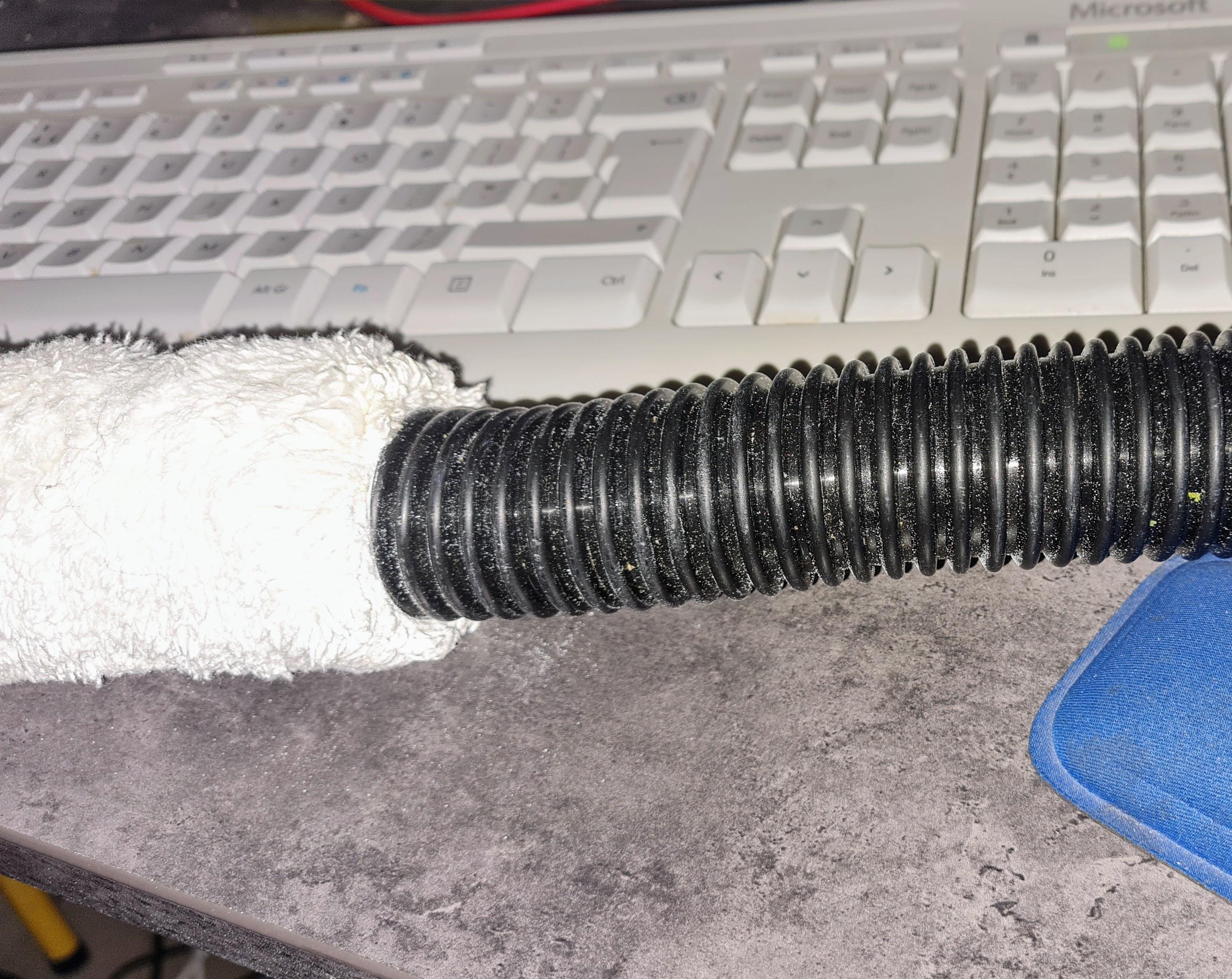

ToughButterCup Posted January 7, 2021 Author Posted January 7, 2021 (edited) I'm trying to make my own spinner to fit onto a drill. The idea is to make something that push-fits into the internal diameter of the paint roller . It would have piece of threaded bar in the middle (M6 ish) which fits into a small drill The internal diameter of the paint roller is 38mm. I've hunted around for something with a 38mm external diameter - loads of things are nearly right - like this bit of conduit for electrical wire. The idea would be to fill that bit of tube with foam and have a bit of M6 embedded in it to act as the drive. The roller sleeve would simply slip over that while it was being cleaned. Trouble is, this conduit is just a bit too big. Is there any common building 'tube' which is 38mm or 37ish outside diameter (so it fits inside a roller sleeve)? Edited January 7, 2021 by ToughButterCup

JFDIY Posted January 7, 2021 Posted January 7, 2021 (edited) £2.39 gets you the cheapest roller frame from TS. 38mm is 1.1/2" how close is that to the o/d of solvent weld pipe and few wraps of tape? Edit to add, 1.1/4" solvent weld waste pipe is a shade over 35mm Edited January 7, 2021 by JFDIY

ToughButterCup Posted January 7, 2021 Author Posted January 7, 2021 (edited) 35 minutes ago, ProDave said: ... Please don't tell me you have been washing it daily? Yes. For years, many years. Until I met you Dave, I didn't know any better. Army: if it doesn't move clean it. If it moves, salute it. Same with you @joe90, wise old bird that ' chare 23 minutes ago, JFDIY said: ... 38mm is 1.1/2" how close is that to the o/d of solvent weld pipe and screw wraps of tape? Yes, exactly wot I fought. Until I tried it ... the last lengths of that I bought were 41 or 42mm o/d Edited January 7, 2021 by ToughButterCup
JFDIY Posted January 7, 2021 Posted January 7, 2021 4 minutes ago, ToughButterCup said: Yes, exactly wot I fought. Until I tried it ... the last lenghts of that I bought were 41 or 42mm o/d Try 1.1/4" it's about 35mm And a couple of wraps of insulation tape, or a bit of old bike inner tube slipped on 1
joe90 Posted January 7, 2021 Posted January 7, 2021 32mm weld waste pipe and round head self tappers 8 off (4 each end at 90’) to grip the roller ? 1

joe90 Posted January 7, 2021 Posted January 7, 2021 (edited) 20 minutes ago, ToughButterCup said: Bloody Hell Joe: you're a genius. Nah, just been bodging/inventing/diying for many years (I am told its because I am a tight wad ?). Rather than foam I would cut two circular wood plugs that fit in the pipe either end, use above screws to secure to pipe and 6mm threaded bar bolted to wooden ends (can supply a CAD drawing on request) (crayon assisted drawing ?). any way, must get on, currently building a bee hive from a big log (cus I am too tight to buy one!). Edited January 7, 2021 by joe90 1
