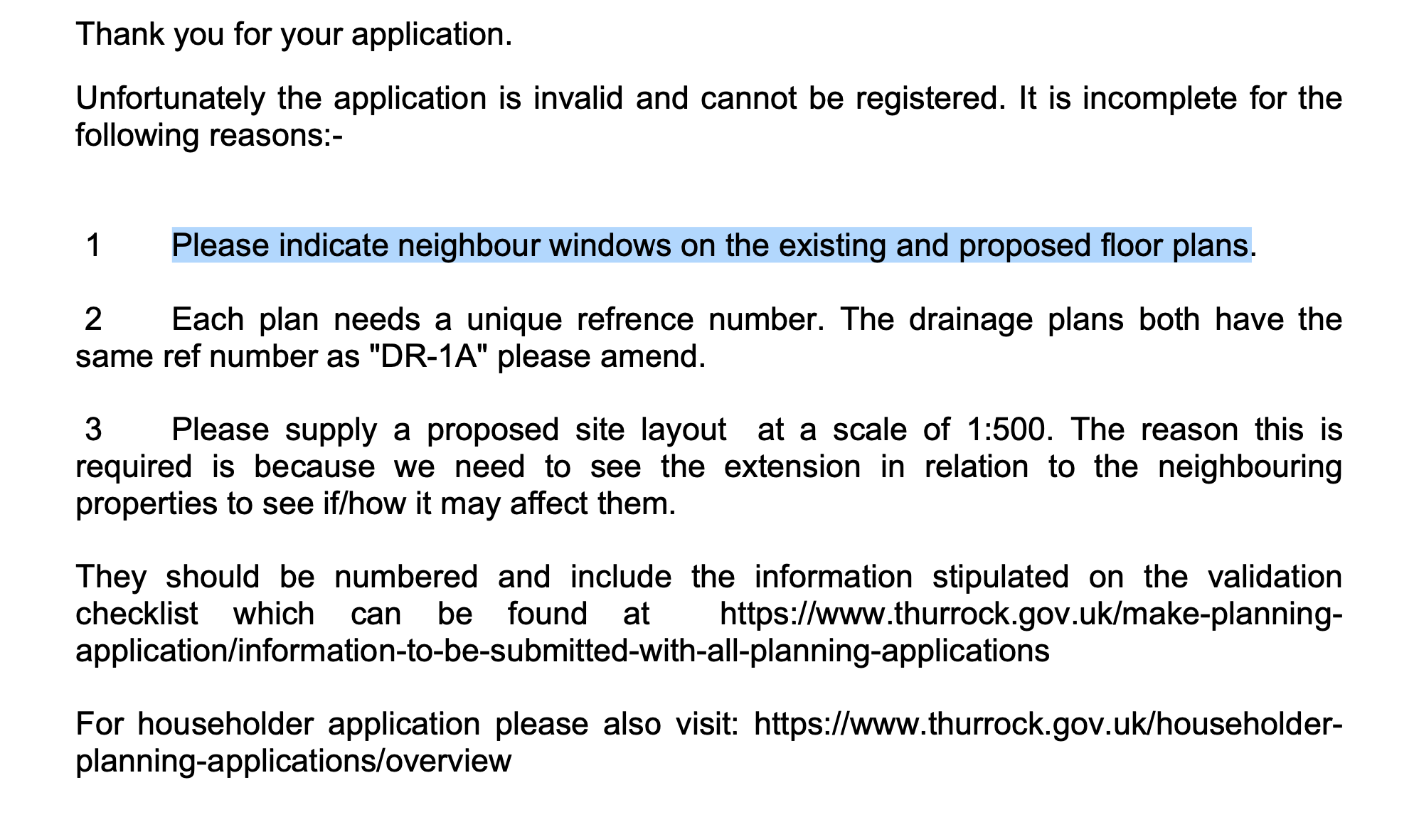

Stumpie Posted January 5, 2021 Posted January 5, 2021 Hi Guys, I wanted to try for planning myself. I did a larger project a few years back where the architect did it all, but this is a smaller project so I was hoping to do a little more myself. Anyway... I got my plans together and used planningportal.com to submit my application to the local authority. The confirmed receipt inside of 24 hours and rejected it citing 3 errors in my application - two of them were my own stupid fault and I corrected them. The third has me a little confused... This is a very small extension to the rear of my property. I'm basically squaring an L-shaped room off for a new kitchen. It's a ground floor. So getting to the point, they've asked me to indicate neighbours windows on the existing and proposed plans I've submitted. I've googled about and can't find any example of what they are asking me for. I called and a planning administrator wasn't sure what they wanted either? I've emailed the planning department for a little clarification but I thought I would ask here as well. Thanks in advance 11 Garth Road - Proposed.pdf 11 Garth Road - Existing.pdf
ProDave Posted January 5, 2021 Posted January 5, 2021 They need a site layout plan that shows the position of neighbouring properties in relation to yours, and that needs to show the position of windows on neighbouring properties so they can see if there are issues with overlooking. 2

Johnnyt Posted January 5, 2021 Posted January 5, 2021 You dont have to show your neigbours windows, just the outline of your neigbours propeties in relation to your propertiy04 Site Plan 060319.pdf on a site plan. Your elevation plan will show how each proposed window relates to your neighbours, here's a copy of mine 1
joe90 Posted January 5, 2021 Posted January 5, 2021 2 minutes ago, Johnnyt said: You dont have to show your neigbours windows But the planners asked “please indicate neighbours windows on the existing and proposed floor plans”? ? 1
Johnnyt Posted January 5, 2021 Posted January 5, 2021 Well that's a new one for me, I presumed it was a mistake or poorly written. That means you may have to submit an elevation drawing of your neigbours, can that be correct?

DevilDamo Posted January 5, 2021 Posted January 5, 2021 I have had a look at your LPA’s validation list and the requirement to plot neighbours’ windows is not one of those listed. If I was in your position, I’d argue that with them as it should “not” be a reason to invalidate an application. I have only had a similar requirement come up before but this was in the last 1-2wks of the formal 8 week determination period.
