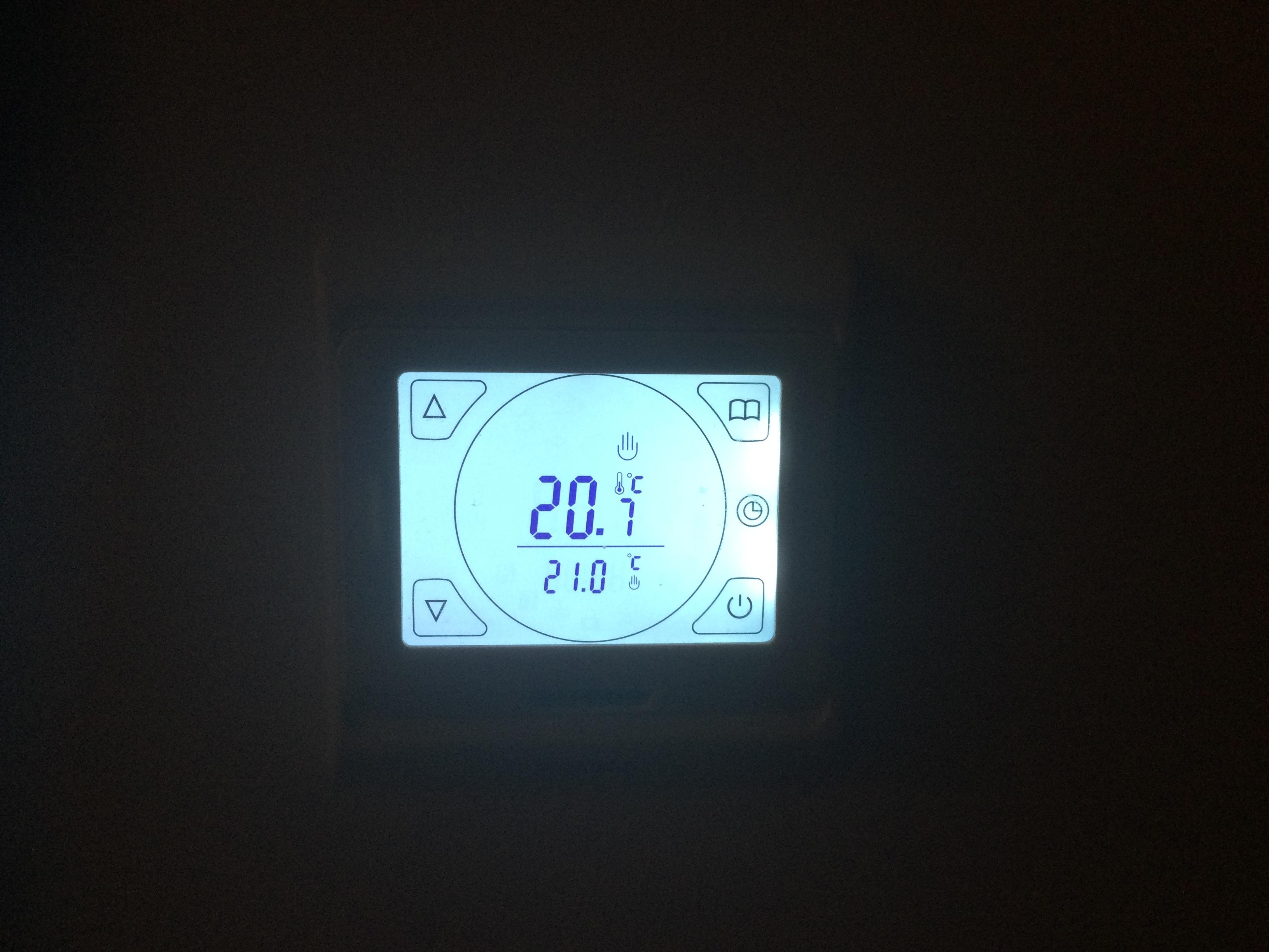

joe90 Posted February 7, 2021 Posted February 7, 2021 On 07/02/2021 at 18:54, ProDave said: What room thermostats do you have? Expand Just one in the hallway
ProDave Posted February 7, 2021 Posted February 7, 2021 On 07/02/2021 at 19:00, joe90 said: Just one in the hallway Expand So a posh electronic one? Why does it have so much hysterisis? Is that something you can adjust? Do you have a model number?
joe90 Posted February 7, 2021 Posted February 7, 2021 On 07/02/2021 at 19:06, ProDave said: So a posh electronic one? Why does it have so much hysterisis? Is that something you can adjust? Do you have a model number? Expand I will try and dig out the paperwork, I don’t think it’s changeable, also it’s not a dry contact type and I blew the ASHP main board so modified it to dry contact.

joe90 Posted February 7, 2021 Posted February 7, 2021 @ProDave it’s a Wunda wired stat, can’t find any instructions or spec on their website, might give them a call in the morning to see I can get any info from them. Just found another stat (spare from electric UFH) again with no instructions or box ?♂️ (It is dry contact tho ?).
PeterW Posted February 7, 2021 Posted February 7, 2021 On 07/02/2021 at 19:47, pocster said: Admin are slow on the weekend ? Expand Admin are still laughing at your joke .... 3
ProDave Posted February 7, 2021 Posted February 7, 2021 On 07/02/2021 at 19:50, joe90 said: @ProDave it’s a Wunda wired stat, can’t find any instructions or spec on their website, might give them a call in the morning to see I can get any info from them. Just found another stat (spare from electric UFH) again with no instructions or box ?♂️ (It is dry contact tho ?). Expand Here is the data sheet for your thermostat https://cdn.wundatrade.co.uk/wp-content/uploads/2017/08/E02-generic-E91-touch-screen-Stat-27-4-2018.pdf See page 3. Parameter 4diF Switching differential, adjustable from 0.5C to 10C 1
joe90 Posted February 7, 2021 Posted February 7, 2021 On 07/02/2021 at 20:35, ProDave said: Here is the data sheet for your thermostat Expand Well done mate, that’s really good, you are a star. Go to the top of the class ?
