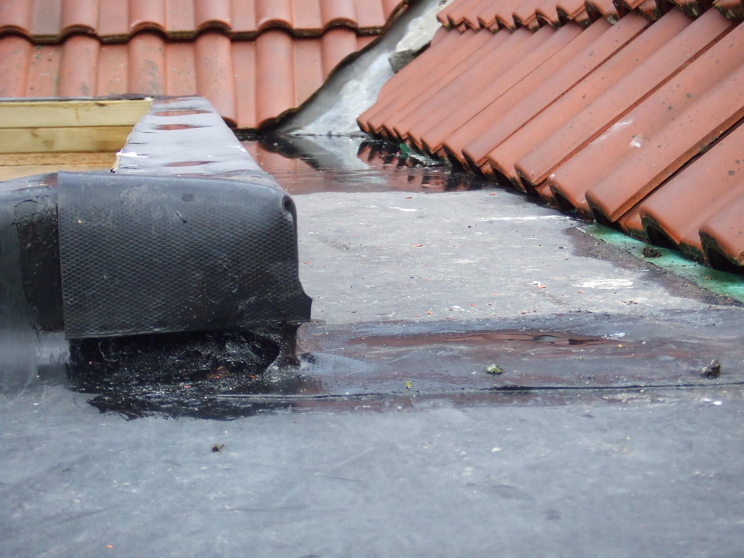

tillywiz Posted December 28, 2020 Share Posted December 28, 2020 flat roof epdm done and roof lantern installed no fall on roof now leaking does anyone know of a competent roofing and lantern installer who would inspect and asses problem and complete a report for submission to the conservatory company to redo or if necessary to alternative dispute resolution service as we think it may come to that. Link to comment Share on other sites More sharing options...

tillywiz Posted December 28, 2020 Author Share Posted December 28, 2020 hi mr newton the epdm has a felt backing do not know the make and the installer put it on in meter widths because that was the roll he got or had already no fall on the roof so pooling all acros the back where the roof tiles come down the lantern was not the one we were told per contract we think we have tracked the make down to stratus but it looks like anyone and his dog can produce the stratus make under licence.the roof leaked before the lantern was put on and was supposed to have been fixed first at one side but now looks like both back sides and one end at the front .also the lantern itself seems to be leaking through the peak at one side and the inside cover appears to be glued on with {evostick) type glue.the two roof pics showing the epdm as it was before the lantern was added and we were told that the corners had been recified.i have only been able to add a couple of the internal leak but i think you will see the level of water ingress. the company are supposed to be getting back to us after the holiday but finding all the leaks and leaving all the joins would not be satisfactory so we would like an independant person as we feel the whole thing should come off and be redone also it appears that the upstand is not high enough and goodness knows what has gone on under the tiles and my concern is that they are just going to want to bodge things again .if he does not want to redo the job properly i would like to know the correct price for someone else to do the whole roof from scratch the condensation is terrible and is right the way up both sides of all the truts and all the way along just above the upstand on the edge of the lantern.if you want pics i will do them on the next bit. Link to comment Share on other sites More sharing options...
MJNewton Posted December 28, 2020 Share Posted December 28, 2020 I must admit that doesn't look good. Thinking positively though, the worse it is the easier it is to justify redoing (perhaps completely) rather than being in the position where its not right but it's not (yet, at least) causing an issue. I think surveyors can provide valid independent opinions on this sort of thing. Flat roofs and openings are not particularly specialist constructions and so all surveyors ought to have sufficient knowledge to speak authoritatively about them. Link to comment Share on other sites More sharing options...

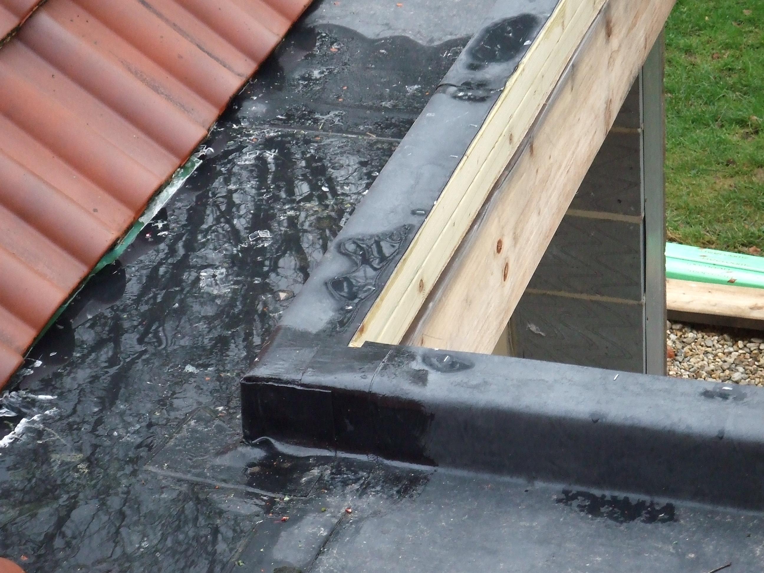

PeterW Posted December 28, 2020 Share Posted December 28, 2020 Kerb isn’t high enough by a long way - should be minimum 150mm from the deck that close to tiles. Also doesn’t look like it is insulated either ..? Roofing is rubbish; corner reinforcement looks like it was put on by a child. Needs 2 courses of tiles removed, ply put onto the roof lapped under the membrane then the rubber run up the roof. Kerb needs extending higher and preferably insulating but you may have problem with that now. And what is that socket blank covering. ..???! 2 Link to comment Share on other sites More sharing options...

Big Jimbo Posted December 29, 2020 Share Posted December 29, 2020 Upstand not high enough. Should be 150mm minimum high. Rubber roof is badly done. Ive done loads of epdm. It's not hard to do it right, and very easy to make a pigs ear of it. IMO your rubber falls looks badly done. If you look at the bottom edge of your lantern, you can see that it is filthy. Thats from water splash because your upstand is too short. Link to comment Share on other sites More sharing options...

PeterW Posted December 29, 2020 Share Posted December 29, 2020 @tillywiz does this all run off the 4th side ..?? Difficult to see the layout from these photos. You can do rubber with 1m wide rolls but it needs to be done with the correct laps and only on a roof with a fall otherwise the joints collect water. Have you got any photos of it being done..? Link to comment Share on other sites More sharing options...
tillywiz Posted December 29, 2020 Author Share Posted December 29, 2020 yes the water runs off the fourth side and when he did the rubber we said that he seemed to be doing it wrong but felt we could not realy interfere the first atempt was when we first complained about the standard the second pic here is his redo of one of the corners not sure whats happened with the picture but you get the idea of the shoddy work.we were Link to comment Share on other sites More sharing options...

PeterW Posted December 29, 2020 Share Posted December 29, 2020 10 minutes ago, tillywiz said: we were told categicaly that with a lanter the roof should not have a fall That’s correct - well, partially .... a lantern shouldn’t have a fall, but the roof around it should ..!! And those tiles are too low - should be further up so looks like they haven’t done the bottom properly either. Tiles shouldn’t rest on the membrane. Link to comment Share on other sites More sharing options...
joe90 Posted December 29, 2020 Share Posted December 29, 2020 I hate flat roofs myself but have done quite a few but in GRP (my favourite flavour). I always put a slight fall on a flat roof and never had one problem. Those upstands, tiles and quality of work is crap IMO (SORRY). Link to comment Share on other sites More sharing options...
