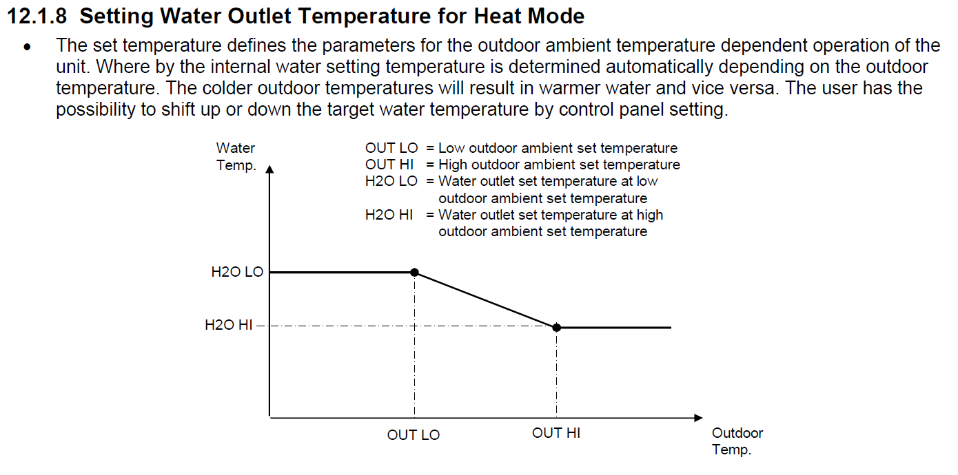

jack Posted December 28, 2020 Share Posted December 28, 2020 What do you mean by max 40 and min 25? Are they weather compensation values? What's your under-slab insulation like? 40 seems a high temperature if you have a lot of insulation. I have 300mm EPS under our slab and never have the temperature exceed 30 for heating. Generally I run it at 25, the lowest temp the unit will do, with weather compensation ramping up between 7 and 0. Bear in mind that the worst situation for defrosting is high humidity, cold outside temperatures, and high heat demand. Often, this peaks when the outside temperature is in the low single figures. As the temperature drops further towards and beyond zero, the humidity tends to fall quite fast too, which reduces icing. I don't know whether the delta value can be set in your ASHP. Unlikely, I'd have thought. Certainly there's no such setting I'm aware of in my Panasonic ASHP. How are you using Loxone to trigger the heating? Hopefully not with one of the intelligent heating controllers. I don't think they cope well very long time-constant situations, like UFH in a deep slab. Link to comment Share on other sites More sharing options...

jack Posted December 28, 2020 Share Posted December 28, 2020 23 minutes ago, andy said: Slab is 300mm EPS and I am not sure what the Samsung lingo is for weather compensation, the manual is terrible... I don’t know what the impact is of max/min water out temps tbh but I assume they are the target operating ranges? I could turn it down to 25-35 and see what that does. Re weather compensation, perhaps look for a drawing that looks something like this (from my Panasonic ASHP manual): Given the level of insulation you have, I'd say that 40 is too high. Hard to say for sure given how deep your pipes are buried, but I suspect if anything that would encourage the use of lower temperatures over a longer period of time. Link to comment Share on other sites More sharing options...

andy Posted January 5, 2021 Author Share Posted January 5, 2021 On 28/12/2020 at 13:03, jack said: Re weather compensation, perhaps look for a drawing that looks something like this (from my Panasonic ASHP manual): Given the level of insulation you have, I'd say that 40 is too high. Hard to say for sure given how deep your pipes are buried, but I suspect if anything that would encourage the use of lower temperatures over a longer period of time. So it seems it does, it's just the terminology and menu layout leaves a little to be desired... anyway! What I have it set to now is max temp of 42C at -2C outside or lower and 37C at 15C outside, so it should work harder in colder as per your compensation curve. Right now for DHW and heating on a 180m2 single storey, stretched building with UFH pipes that are too deep I am using circe 25kWh/day - and that's having a bath 'cos shower is still on the things to do list House is nice and warm but power consumption higher than I had imagined but c'est la vie. As an aside, I've given up on the idea of Loxone actuators now though, going to go with Salus instead to balance flow temps, still TBC about what Loxone switches I will configure to trigger the heating to come on as I think I will just heat the whole house as an entity, seems to be working at present doing that approach with the binary controls I have in place! Link to comment Share on other sites More sharing options...
