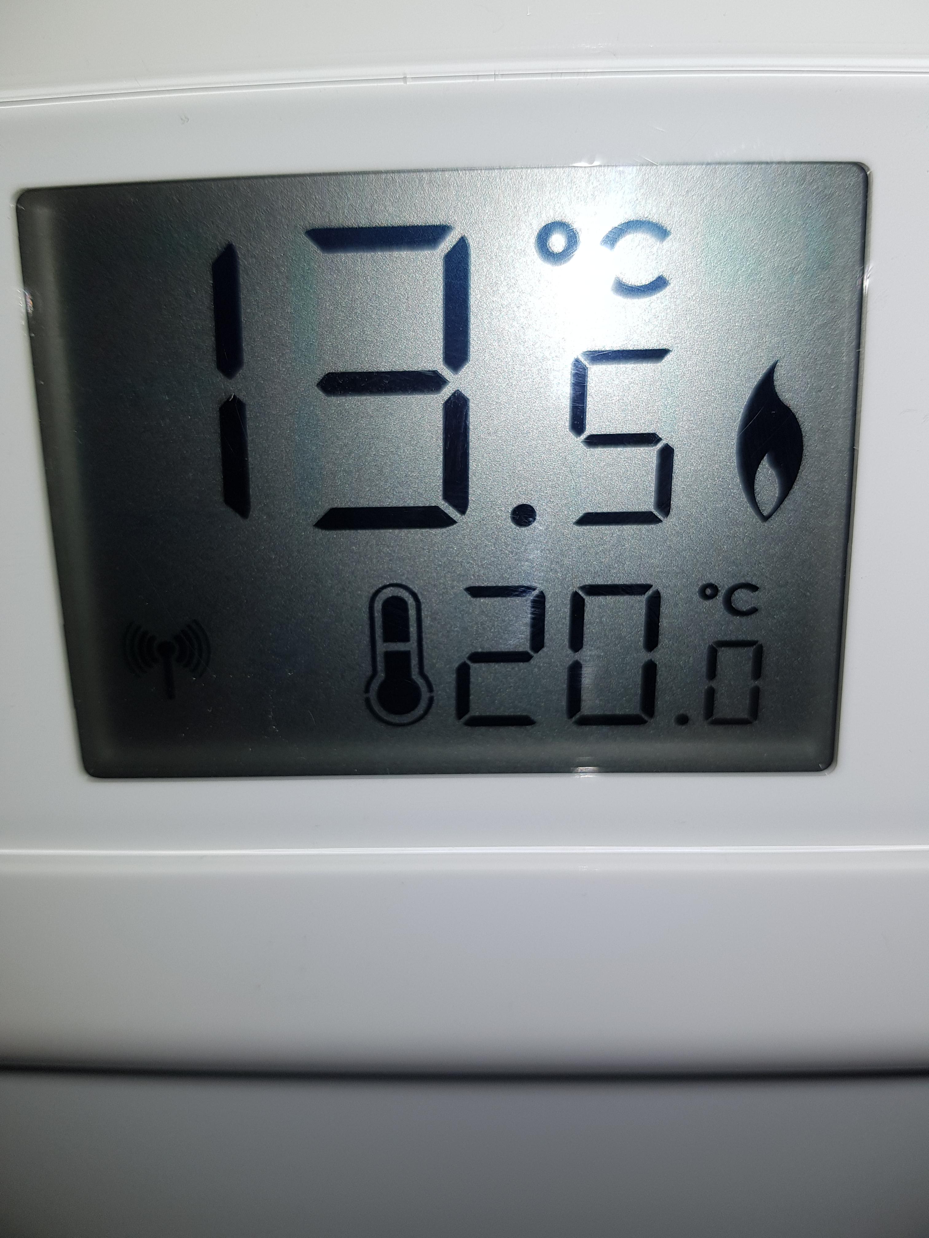

Switching on UFH for the first time

As far as I know all valves open as we flushed all the ufh lines before starting so all good there (I think)
Best way to check a UFH blender is working is to open it all the way and watch for the temperature rise on the gauge then bring it back down - keep an eye on the flow gauges to see if any of them stall.
Are the actuators installed or is this just with the manual valve heads ..?
Getting there, rise of 2 degrees overnight. Be toasty just in time for Santa!!
Result.  By the time we get to Xmas day you can spend the whole time in your Speedos!
What’s it at now? We need regular updates!
As of 1800 hrs it was 15.5 and we are moving in tomo!!
Perfect... tomorrow it should be comfortable!
We had a bit of experience of this when we returned from a 2 week holiday in the Autumn.  It was unusually cold here for the time of year and the house had been sat empty for 2 weeks with no heating and no incidental heating from occupancy and was down to 12 degrees when we got home.
Heating on and stove lit and by the next morning it was getting comfortable but probably more like 2 days before it was all back to normal.
Our house thrives on a regular low level of heat input and takes a long time to cool down if the heating goes off then a long time to heat up again.
In a new, properly insulated house it can take much longer to heat up and cool down.  I have had heating fail in the winter and not notice for a day.
