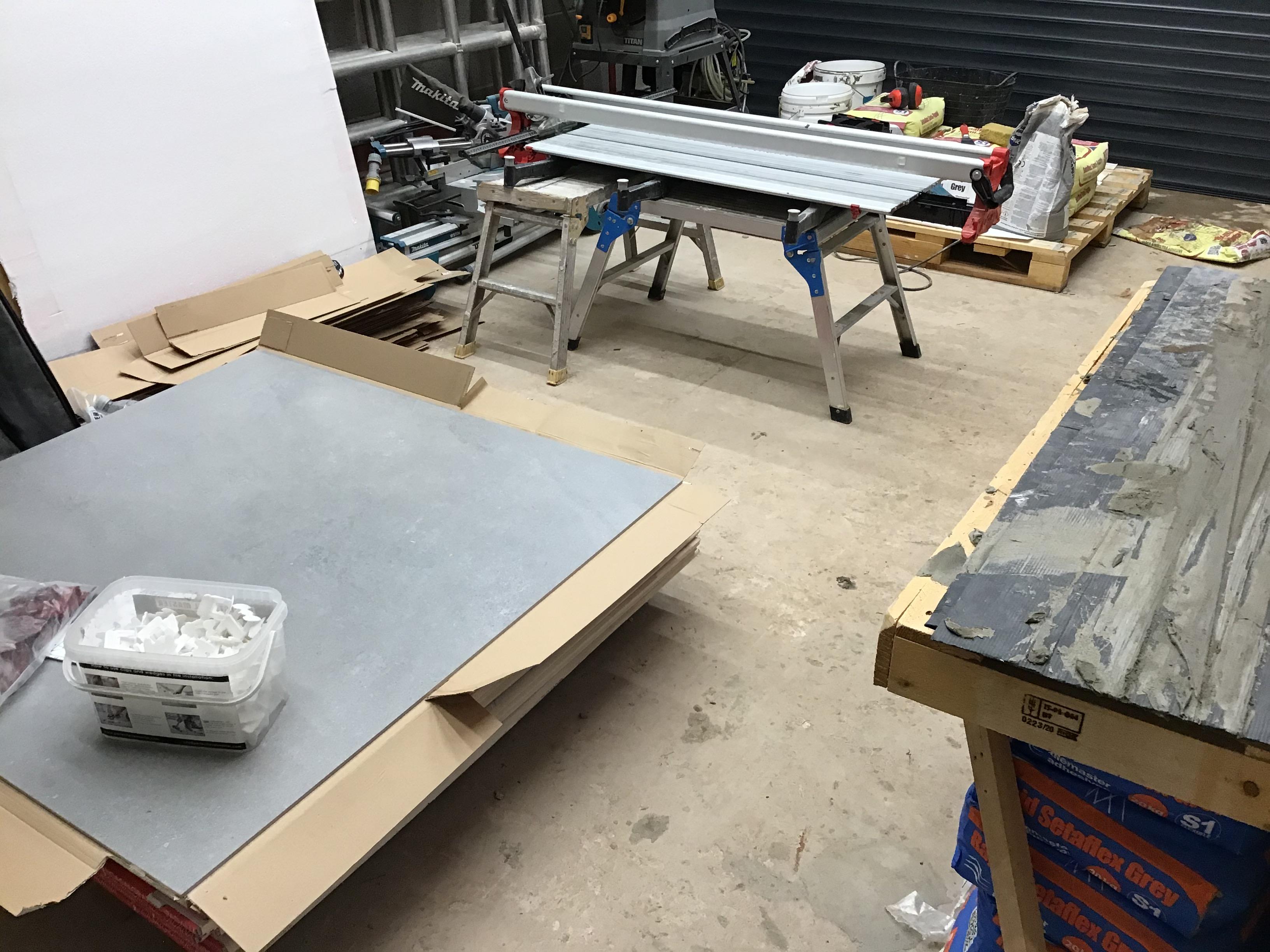

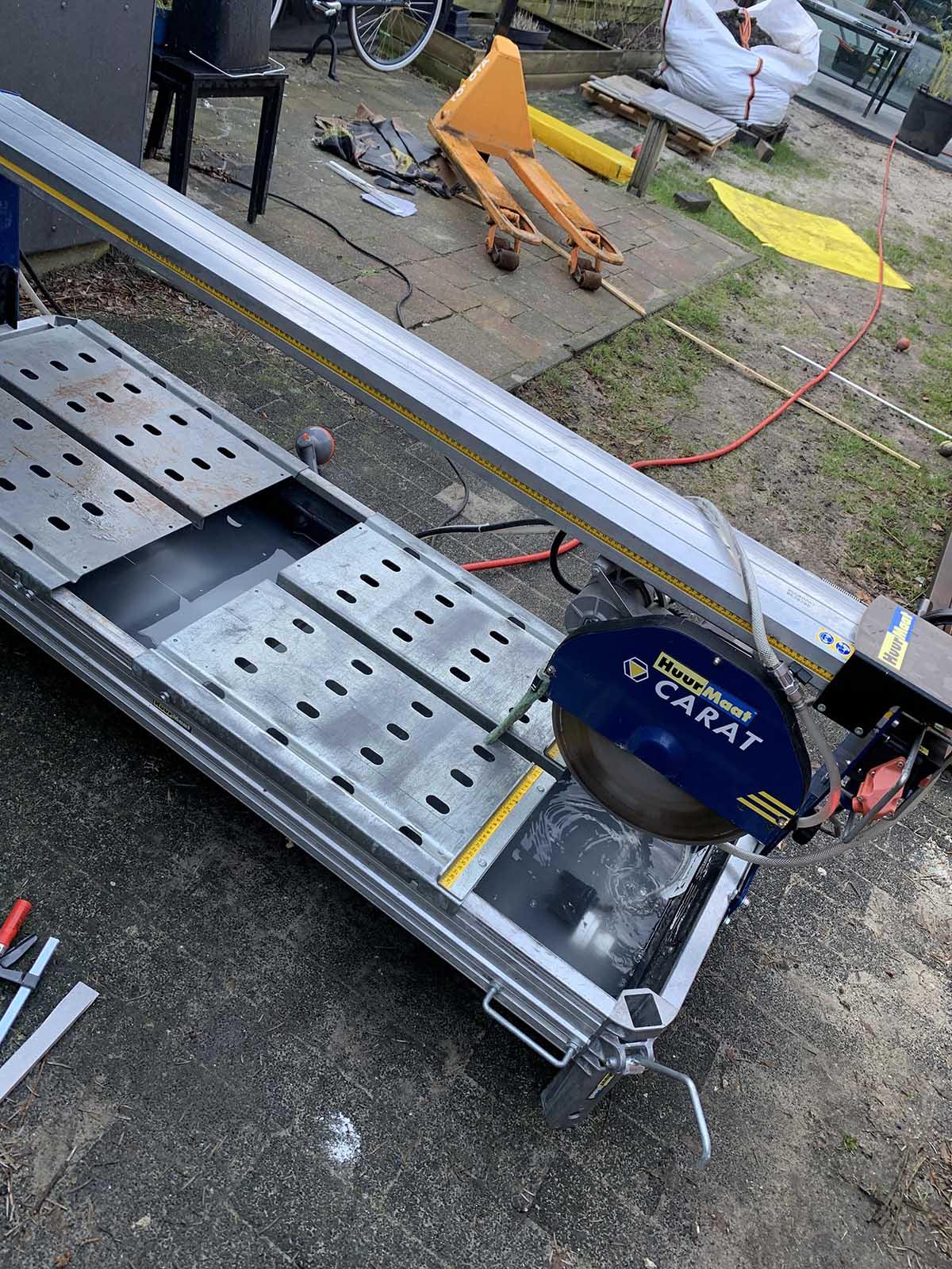

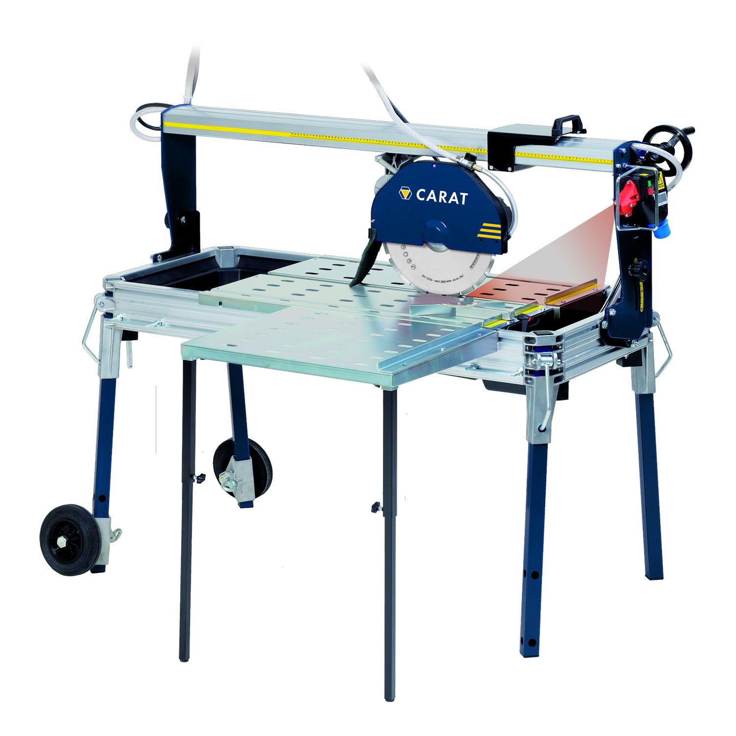

Yes, I am going to hire......my own rubi manual cutter only goes up to 60cm.
I have seen this one (below). which I can hire relatively decent priced.
Until now, I've been using my angle grinder with diamond blade - but it's messed up a few (luckily that can be salvaged for my step that I need to cut) but now I'm at point that breakages will be wasted tiles......

I have used the bridge type cutters for 900 x 900 porcelain used as splashback.  You need to be aware that the blade can wander on the cheaper ones.
Our tilers just used a big Rubi manual cutter for 600 x 600.

Big Rubi cutter for our 120cm tiles - using a brand new small wheel  (8mm I think)

Yeah a manual Rubi cutter - will do up to about 130cm, it had a new 8mm cutting wheel fitted, about 2 cuts did not break clean otherwise it was good, and we cut 1 full tile into 12 equal strips for skirting and it cut ok.

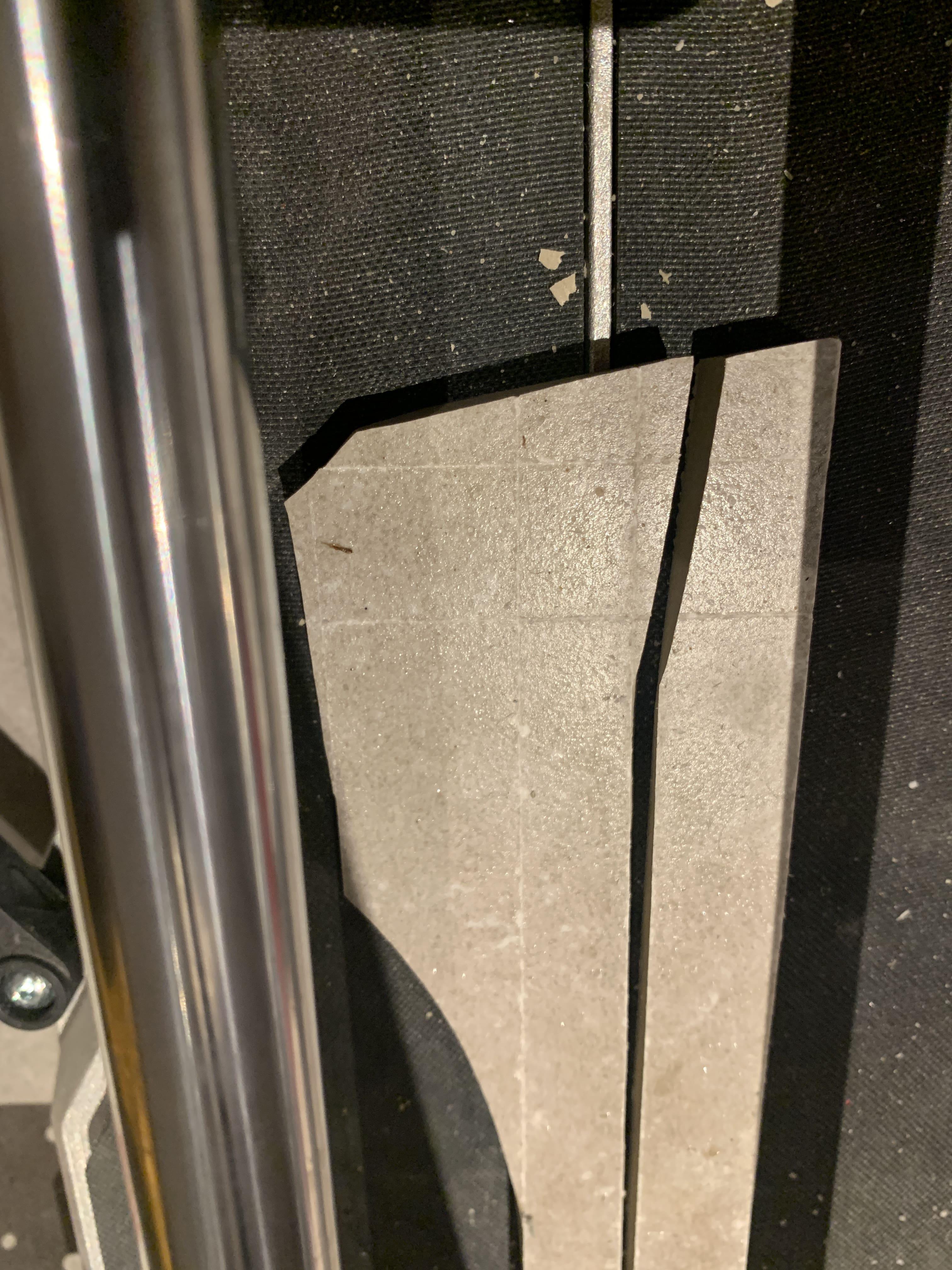

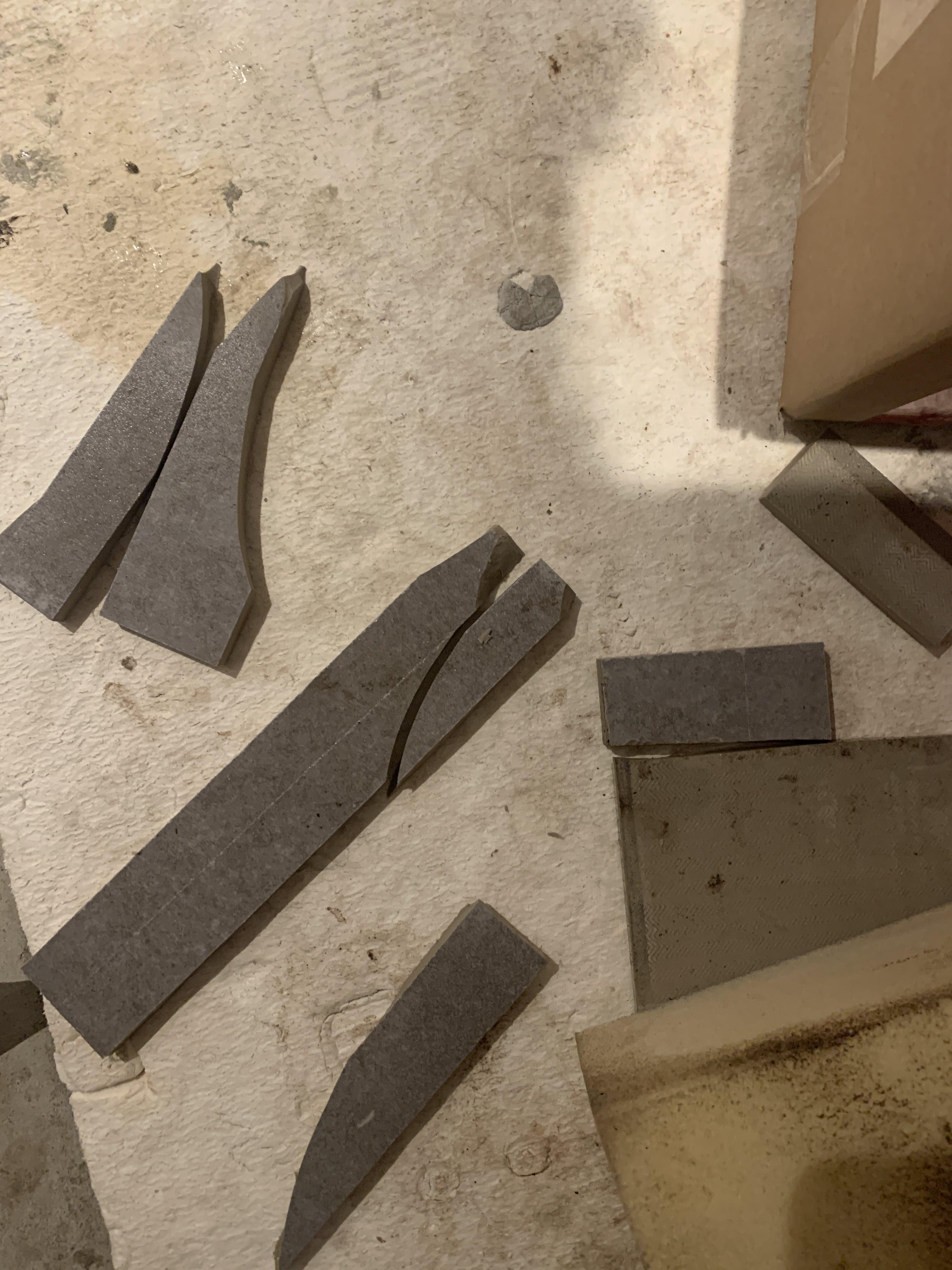

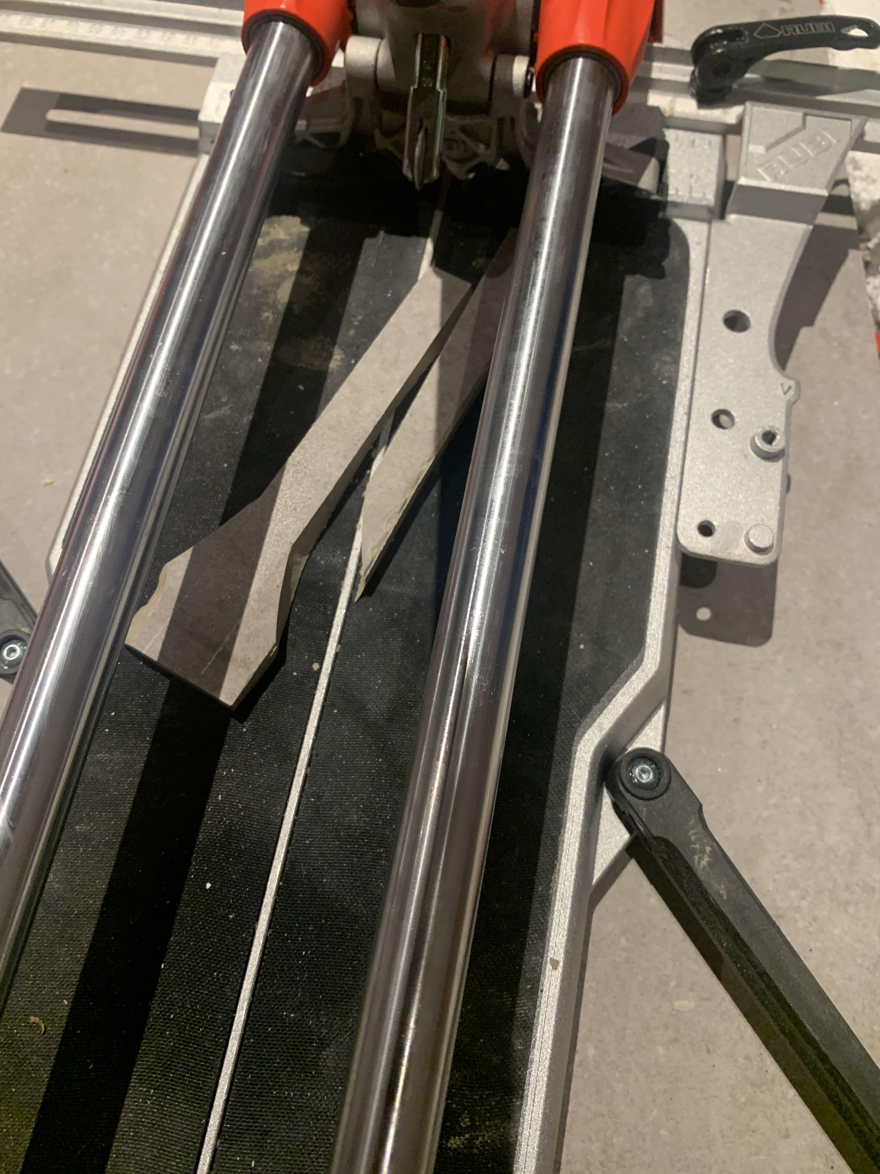

Hi All @Taff @wozza @Pete
Picking this up again, only finally got my tiles on back order. And not many to spare - I started to do some practice cuts on my Ruby cutter with some off cuts  (I will hire a 120cm 'Carat' branded manual cutter for the proper cuts).....
  • My practice cuts did not go well 😞  - It seemed that I could not get the cut started very well - and when I went for the snap, they didn't snap well....
  • I found I was either too light or too heavy (and the slider doesn't slide very well)
Do you have any tips I can follow to avoid this happening?
I found If I placed a little off-cut at the end - to start the cut on, this helped to get me started a bit.....
See images below (ignore they are thin pieces - that was because I was using an old off cut).
I have a selection of wheels available I was mainly using a 10mm one for these.
Any help is greatly appreciated - I'm not confident at this point 😞

I used a Sigma cutter. Like anything it takes a little getting used to. Do not apply great pressure when cutting. When starting the cut pull back at the beginning of the tile to ensure you have done the first couple of inches and then just one straight cut to the end. Quick positive snap on the lever and that is all ever did. YouTube is good for learning about this!!

You could try a smaller cutting wheel - I believe its an 8mm wheel that is recommended for porcelain.

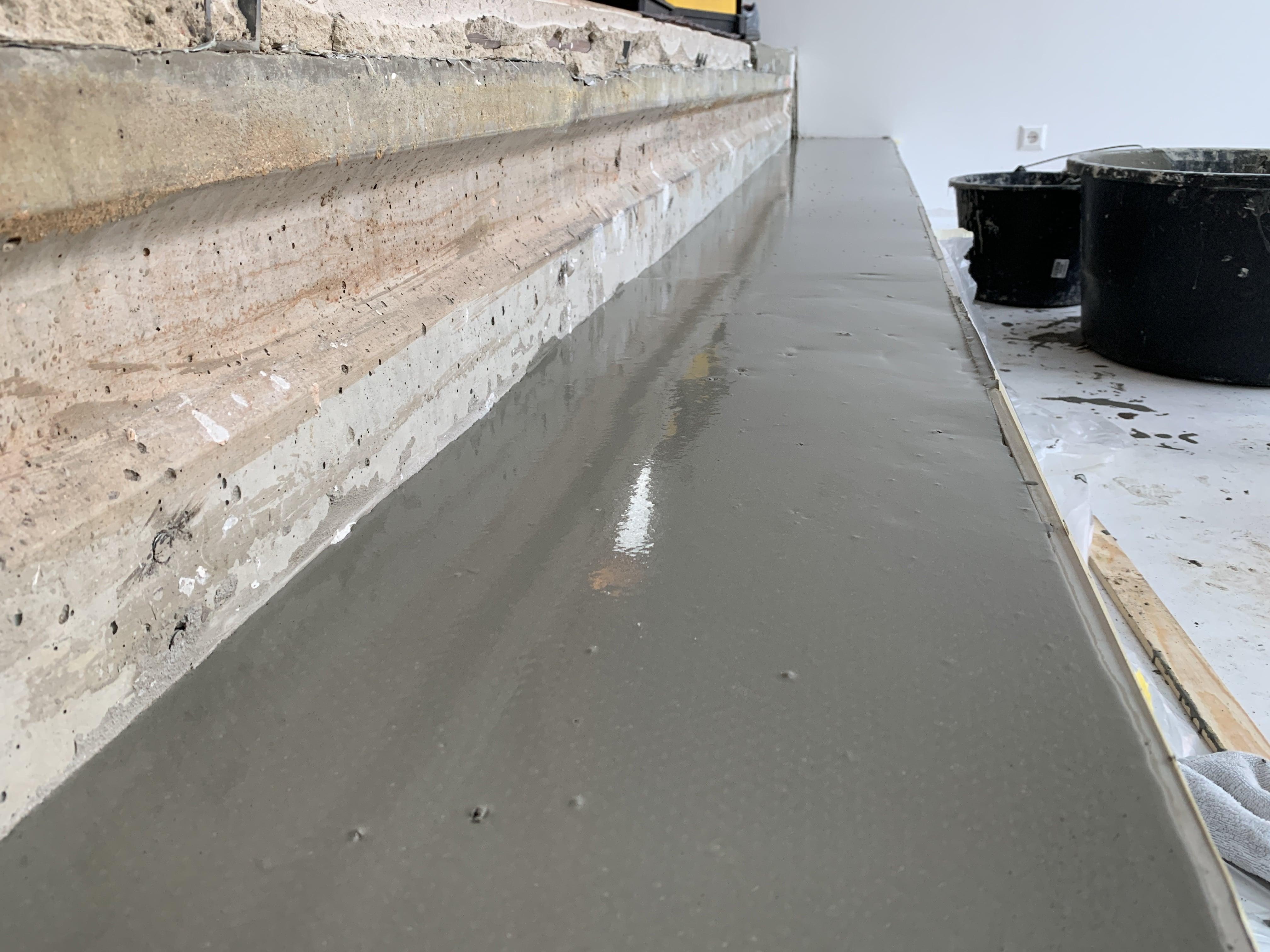

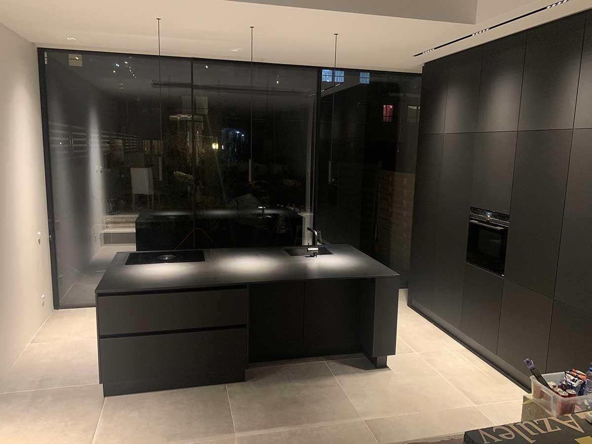

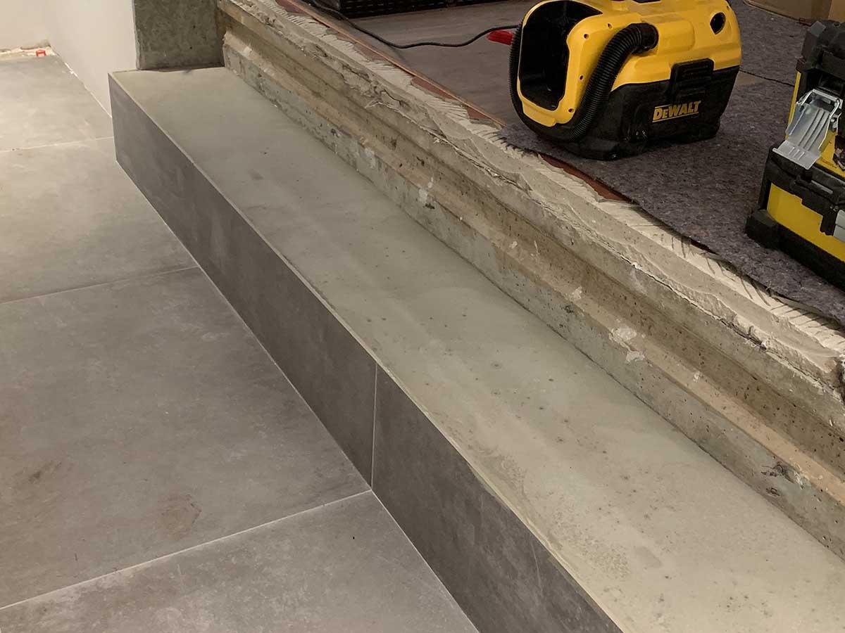

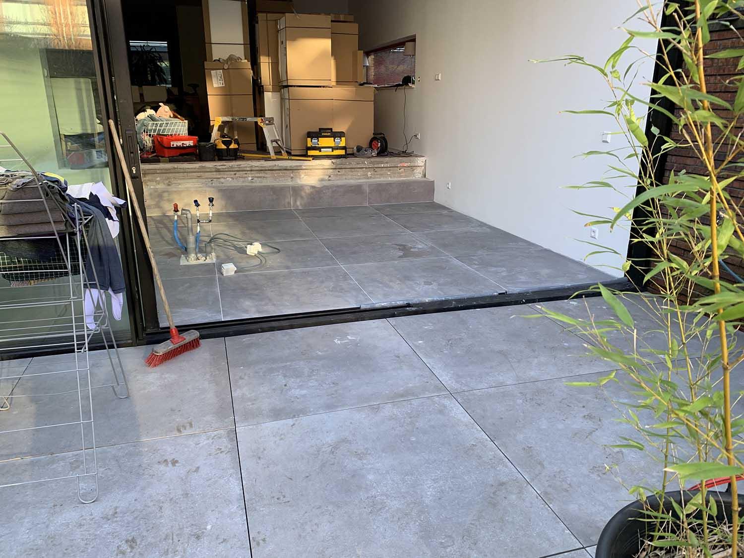

So... in the end I needed a proper saw, and even then it was so powerful it was chipping at the end of each cut. Luckily, on the side I didn't need.
I don't think I will ever buy these tiles ever ever again!!! haha..... 100 x 100 x 1 porcelain. Nightmare - i'm sure easy for a pro, but this is only my 2nd time tiling.

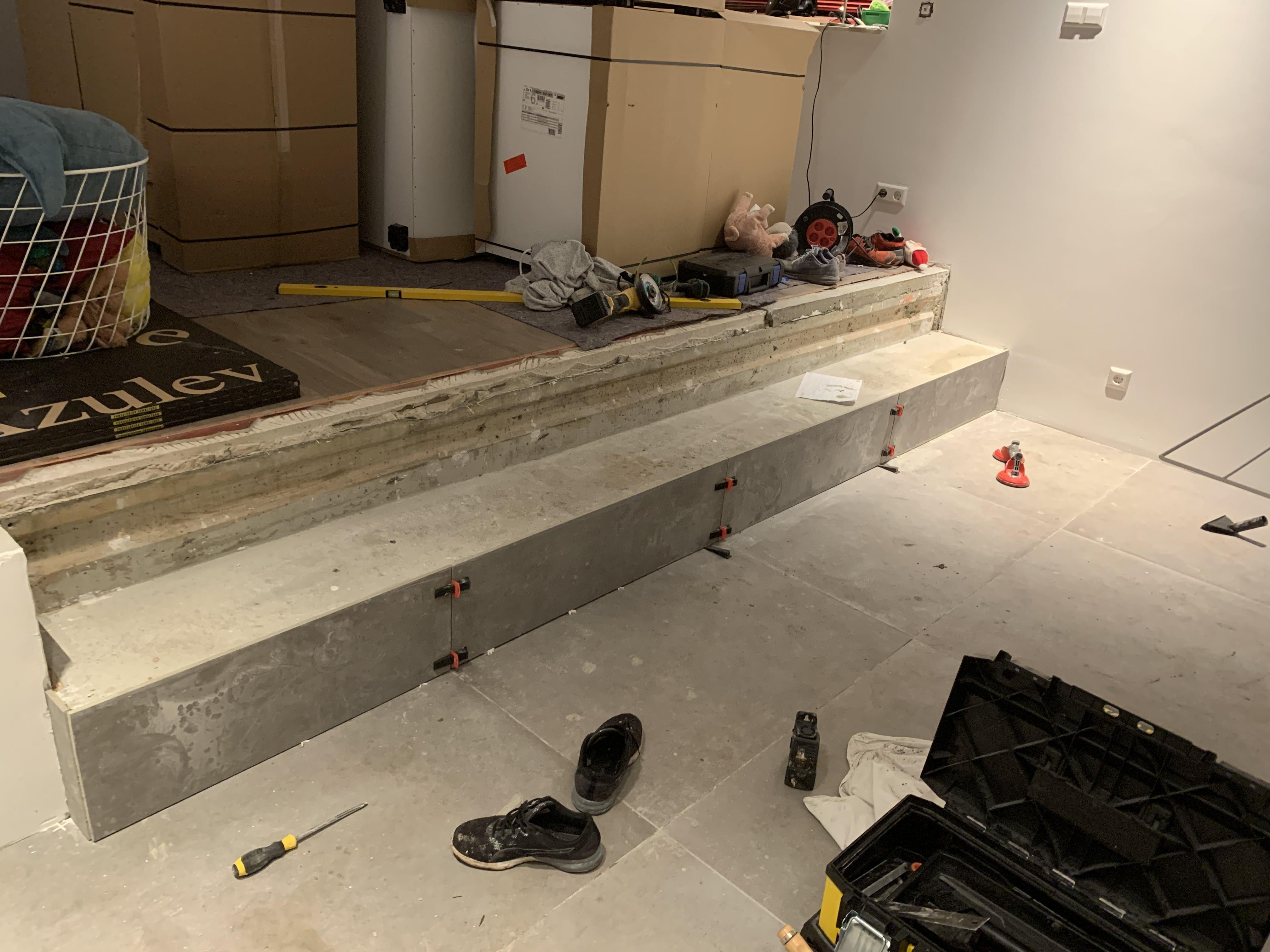

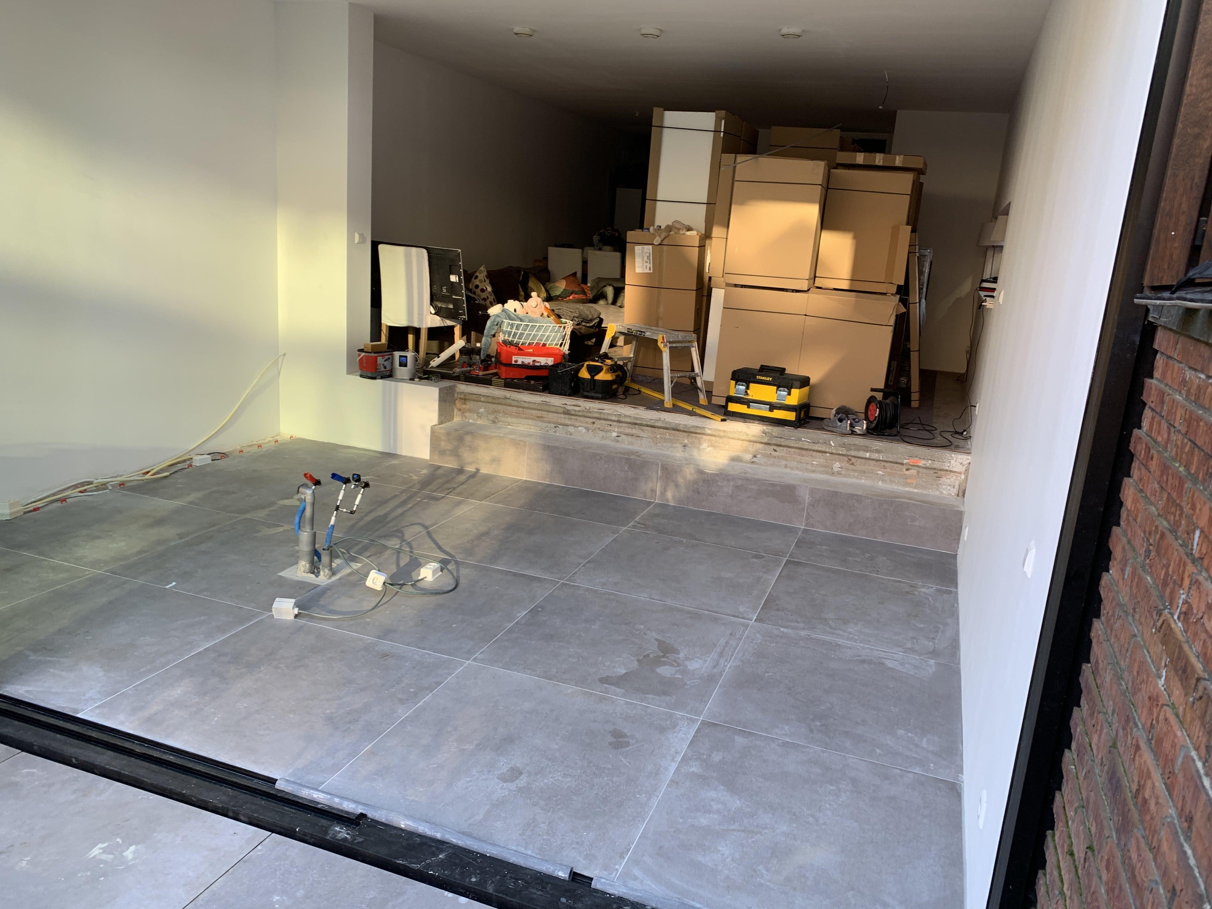

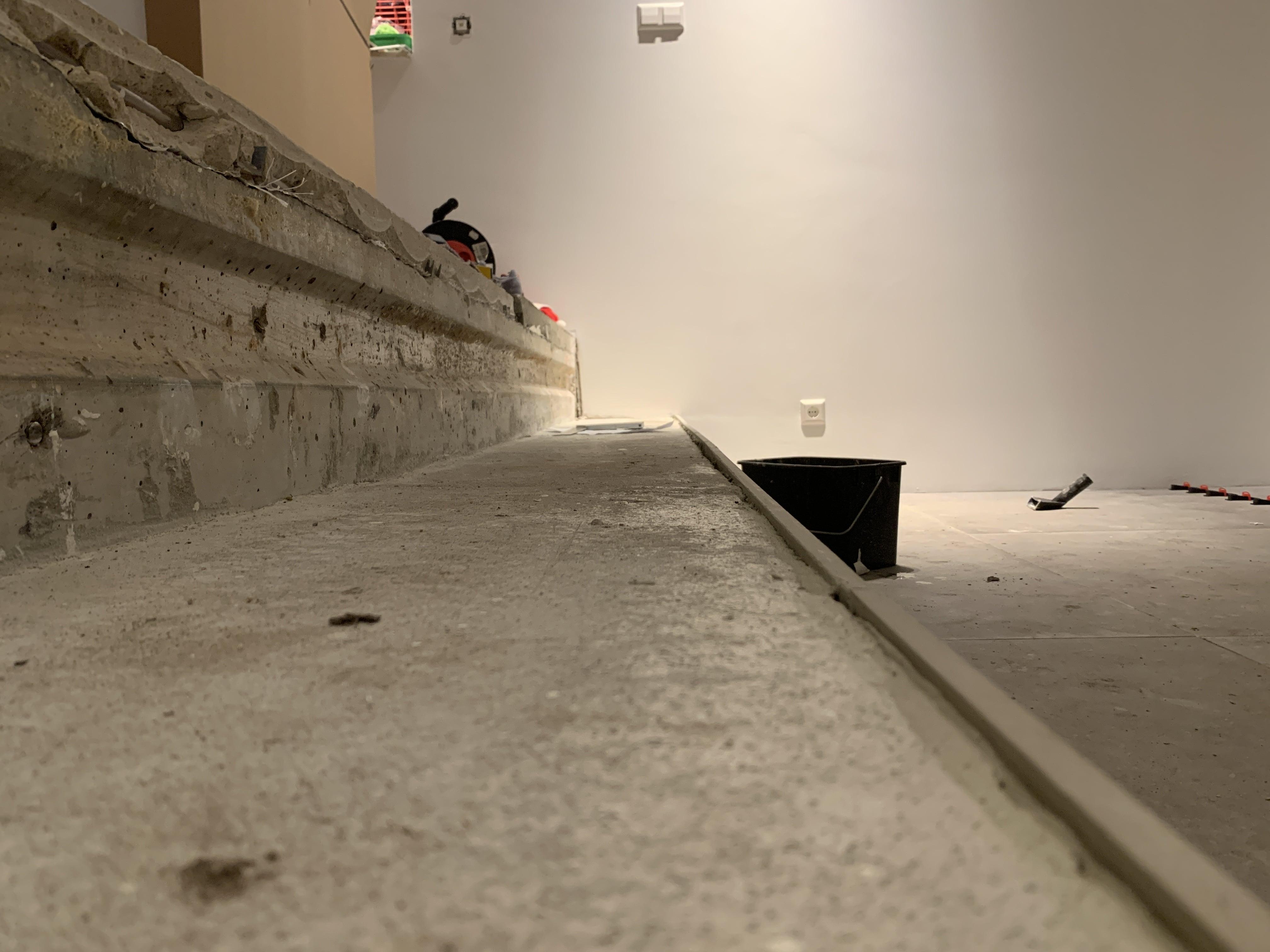

Most are now laid (had to lay a few before kitchen fitters came the following day). I also done all the cuts for the step (And laid one row). I leveled all tiles to the highest point on the step and used a self leveling cement to take up the difference - before I tile the step itself. And that's where I'm at now. Builders didn't leave such a level step and also some concrete was taken away when they done a repair job on the underfloor heating.

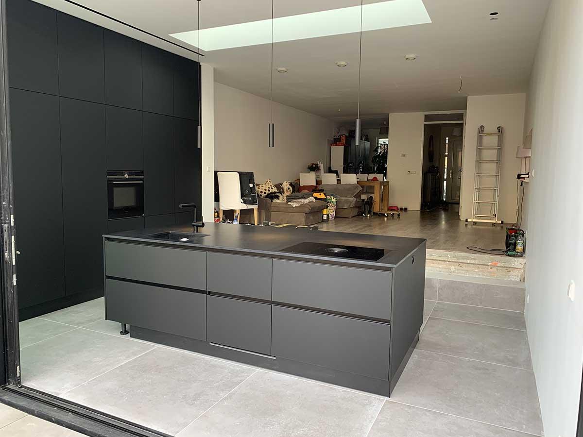

Overall, happy with it - but don't think I ever want to use such large format tiles again.
