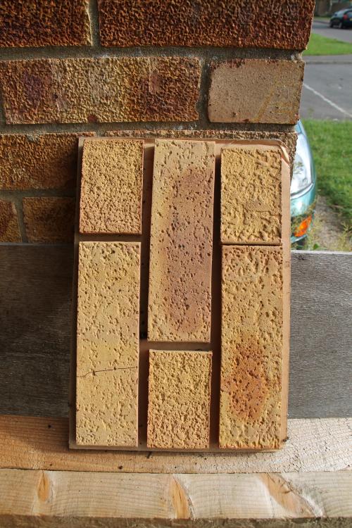

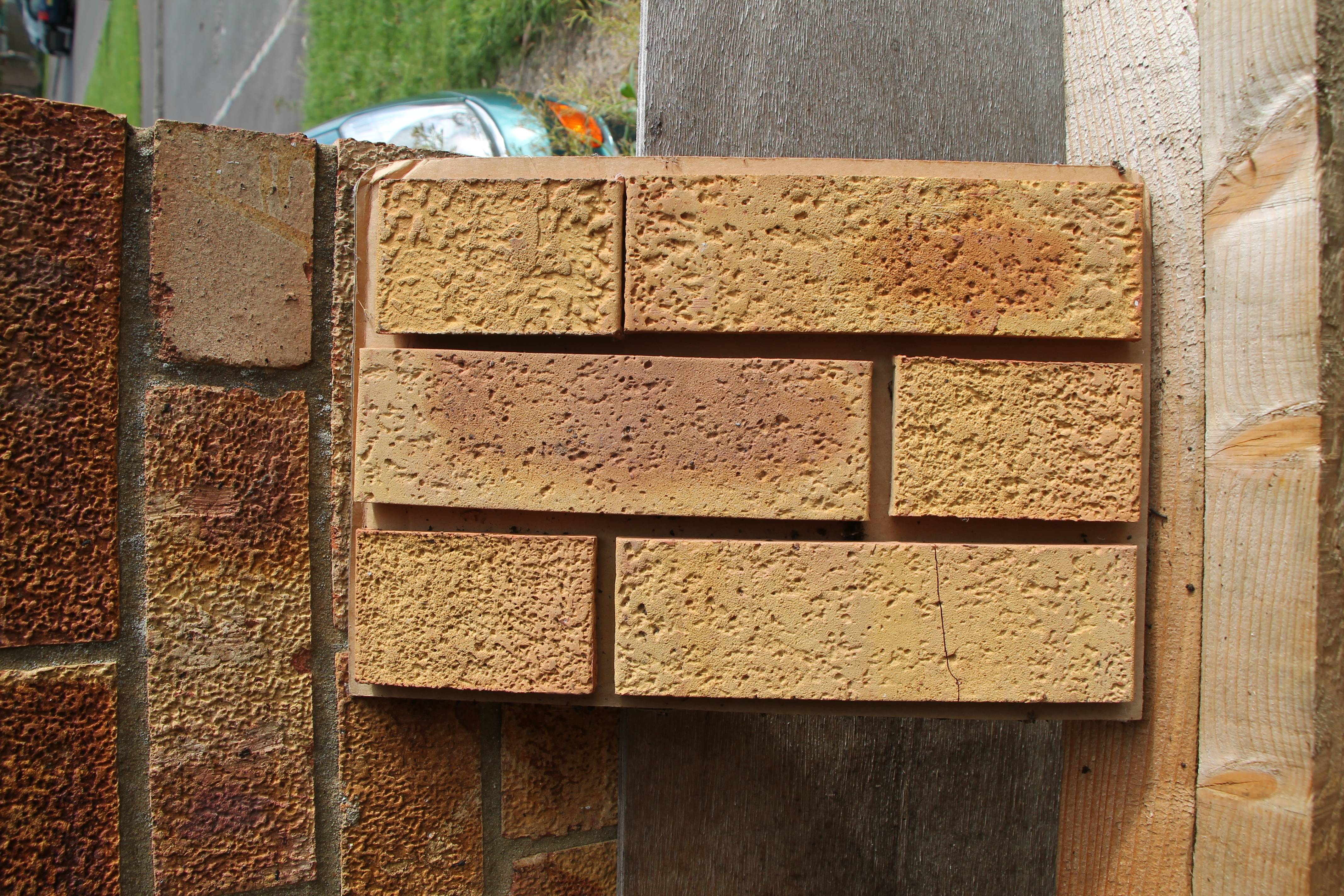

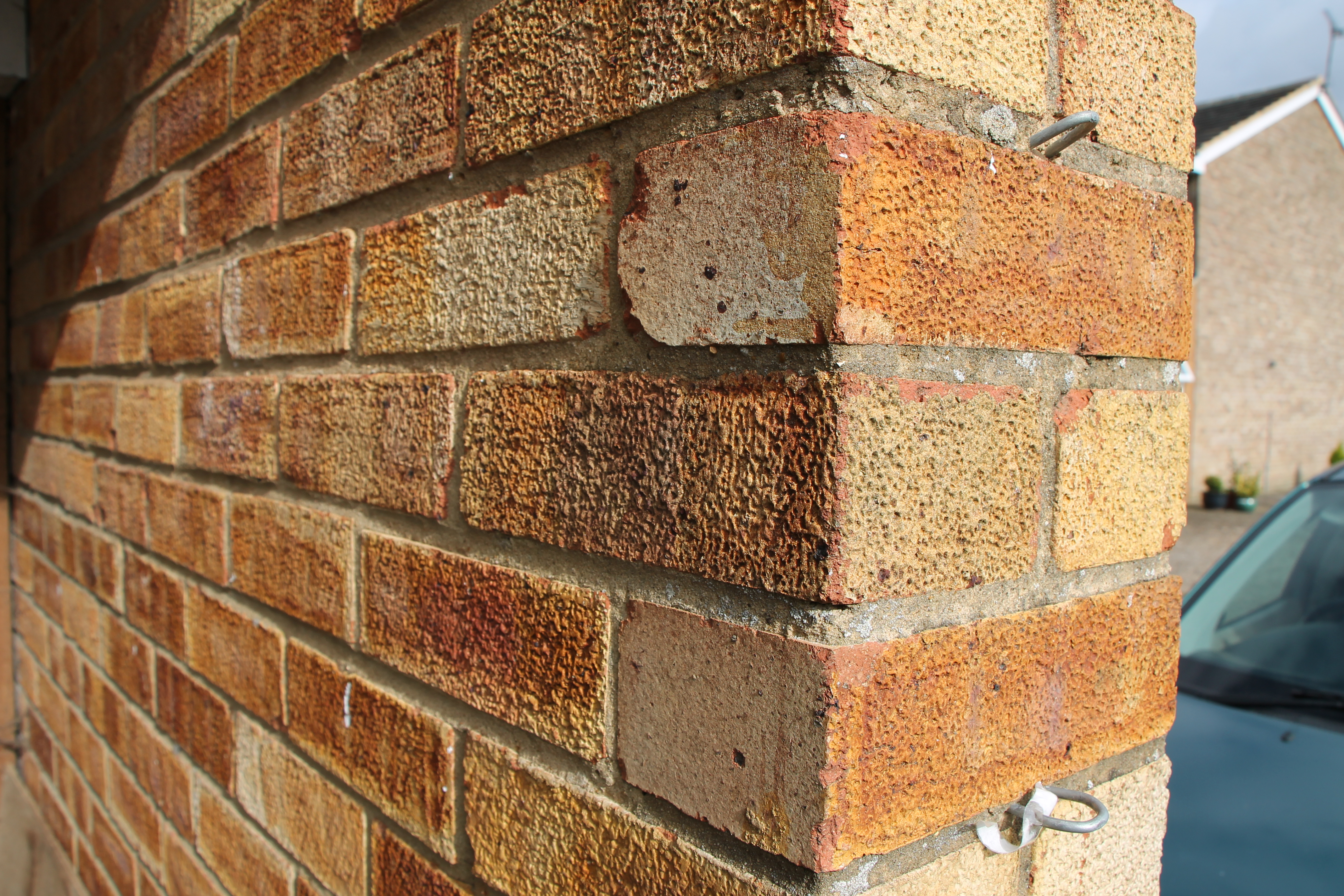

I've got planning permission for a large side and rear extension to my house (semi-detached) with a condition that the materials used in the construction of the external surfaces should be of similar appearance to the existing brickwork. I believe this to be Marston brick - see photo below. These are apparently no longer available and Selco's brick matching service have come up with an alternative - that doesn't match very well (see image with matched sample), they are also relatively expensive at 61p each exVAT.
From the outset I was keen to avoid a brick outer skin to my timber frame as it takes up valuable space and adds little to the thermal properties, but struggled to find any alternatives. I've now found a firm doing GRP brick-effect cladding in panels which are probably just as good a match as the matched sample above, but slightly different. This would be good as I could gain another 3 inches of internal room width, be quicker to put up and I hope cheaper overall.
Does anyone have any experience of this type of cladding? I can only find the one firm doing it so far, which is a little worrying. I also need to research fire resistance (it is offered as standard, or class 1 flame protection) and check it would be acceptable to the planners in order to discharge the condition.

That looks like a London - have you not got any you can pull out as a sample as matching by photo is a nightmare.
Have you considered a brick slip system ..?

Yep- that one looks like London Stocks.

In this application, the obvious problem I can see is that those segments are so small that you may end up with an obvious tessellating pattern. If they are that small they really need 5-10 slightly different 'tiles'.
The only way to be sure is to look at one they have already built and be sure that you are happy.

Gents, thank you very much for your speedy replies. I can remove a couple of bricks above the garage door if I arrange some weather protection. I guess then I should take a tip round the BMs to seek out  a match, or is there a smarter way?
I have considered brick slips, but certainly for the matched brick its very expensive as each brick needs to be cut. I have some stock slip samples which are a lot more economical. I haven't really identified a system to mount the slips on - there seems to be a few options, some of which alter the construction of the wall with insulation, cavity etc. Guidance and opinions very much appreciated please.

The look is critical - it could be made to look like a fake rock in a fishtank or the fake stone edges to one of those grp ponds.
So very important to go and look at a real example.
I might even argue for cladding your garage first to sanity-check it.
