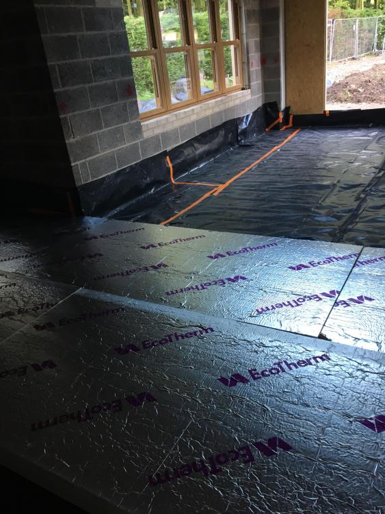

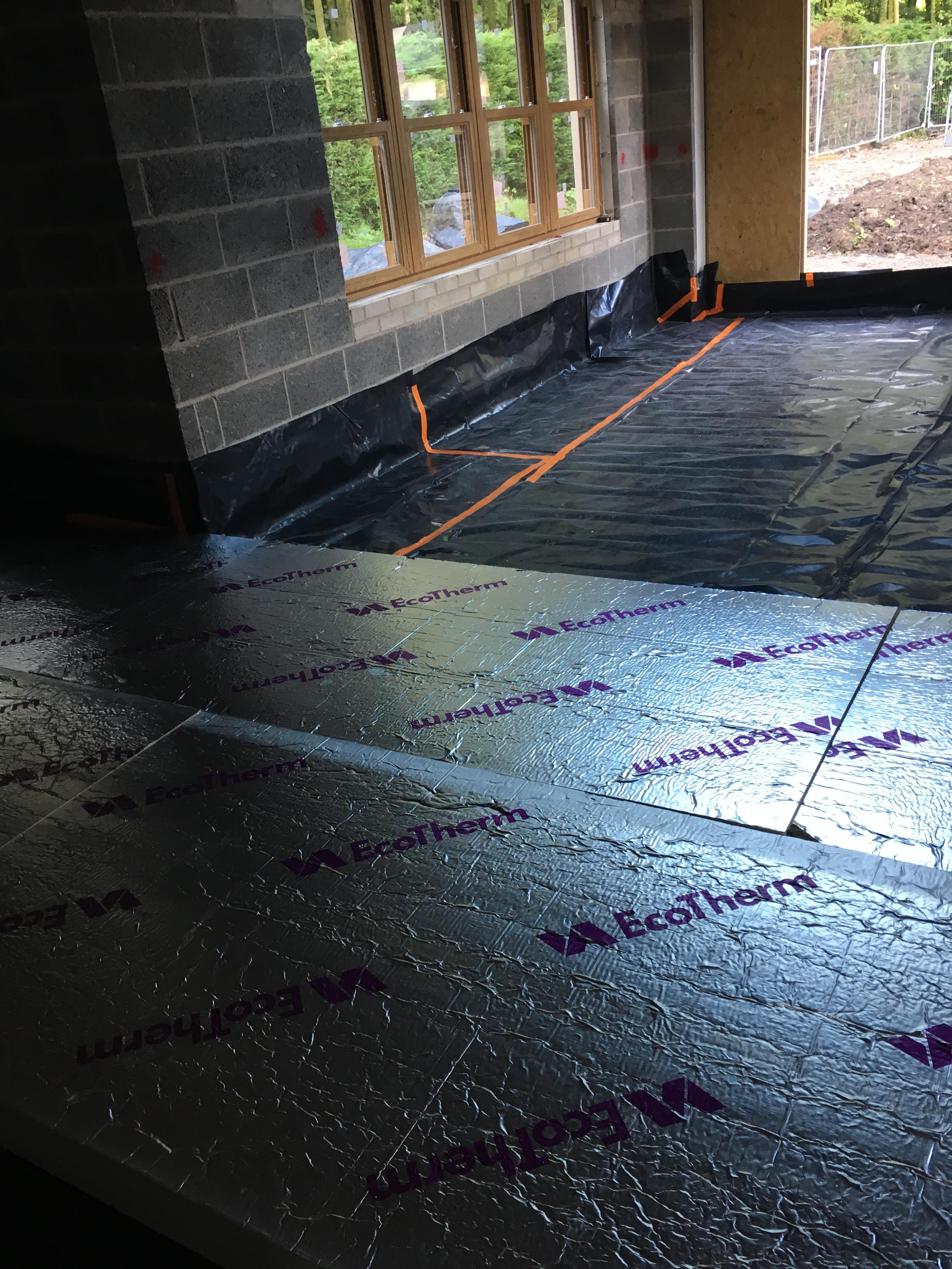

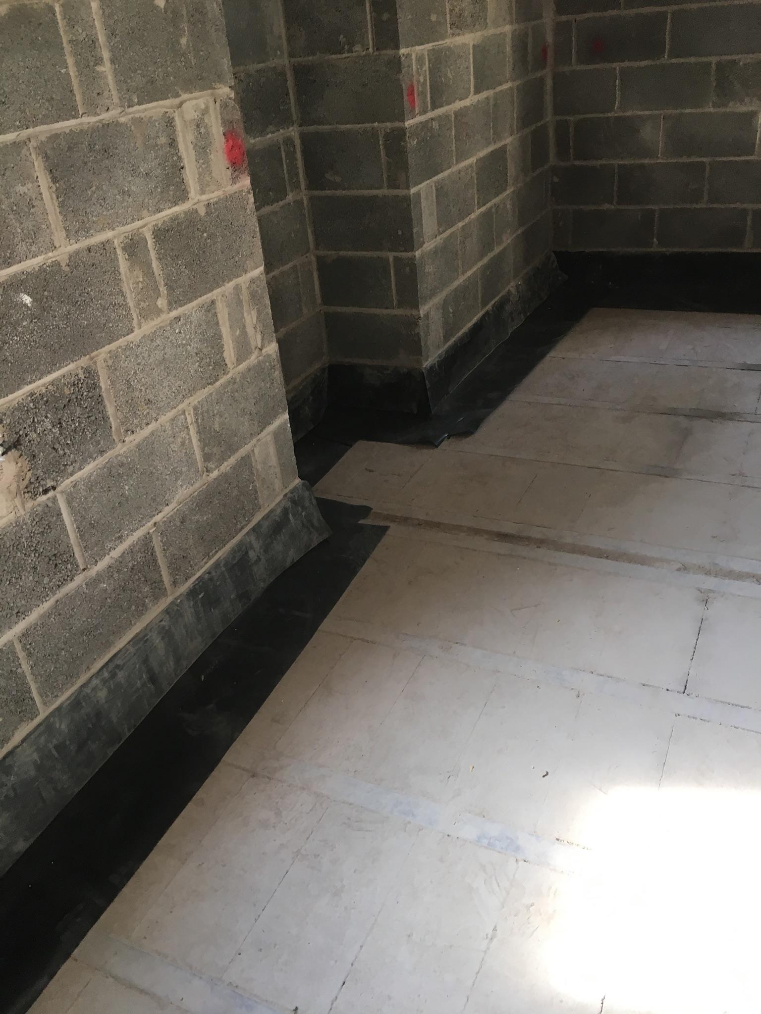

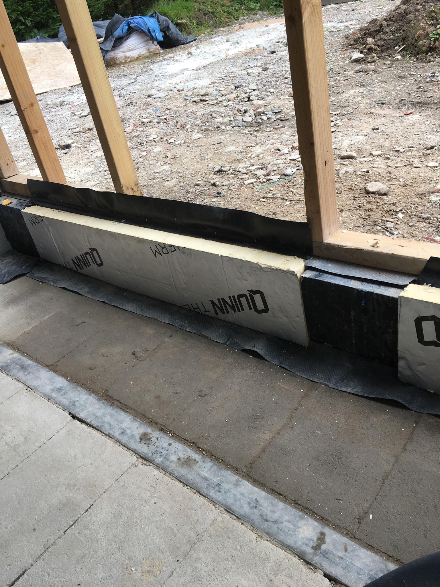

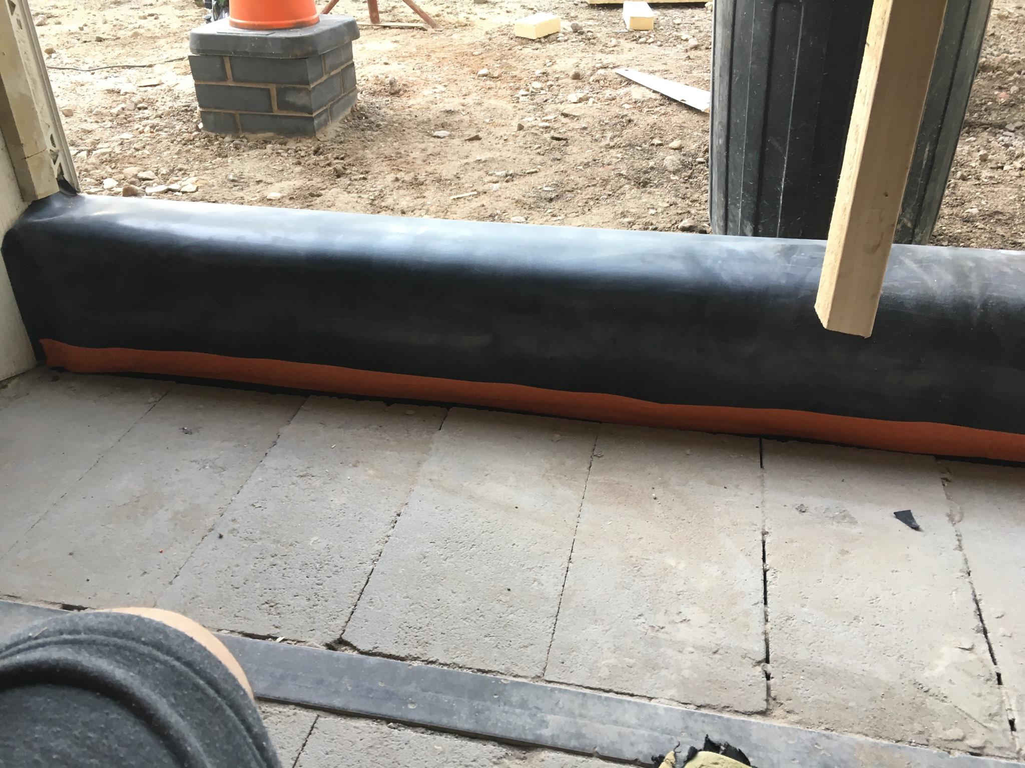

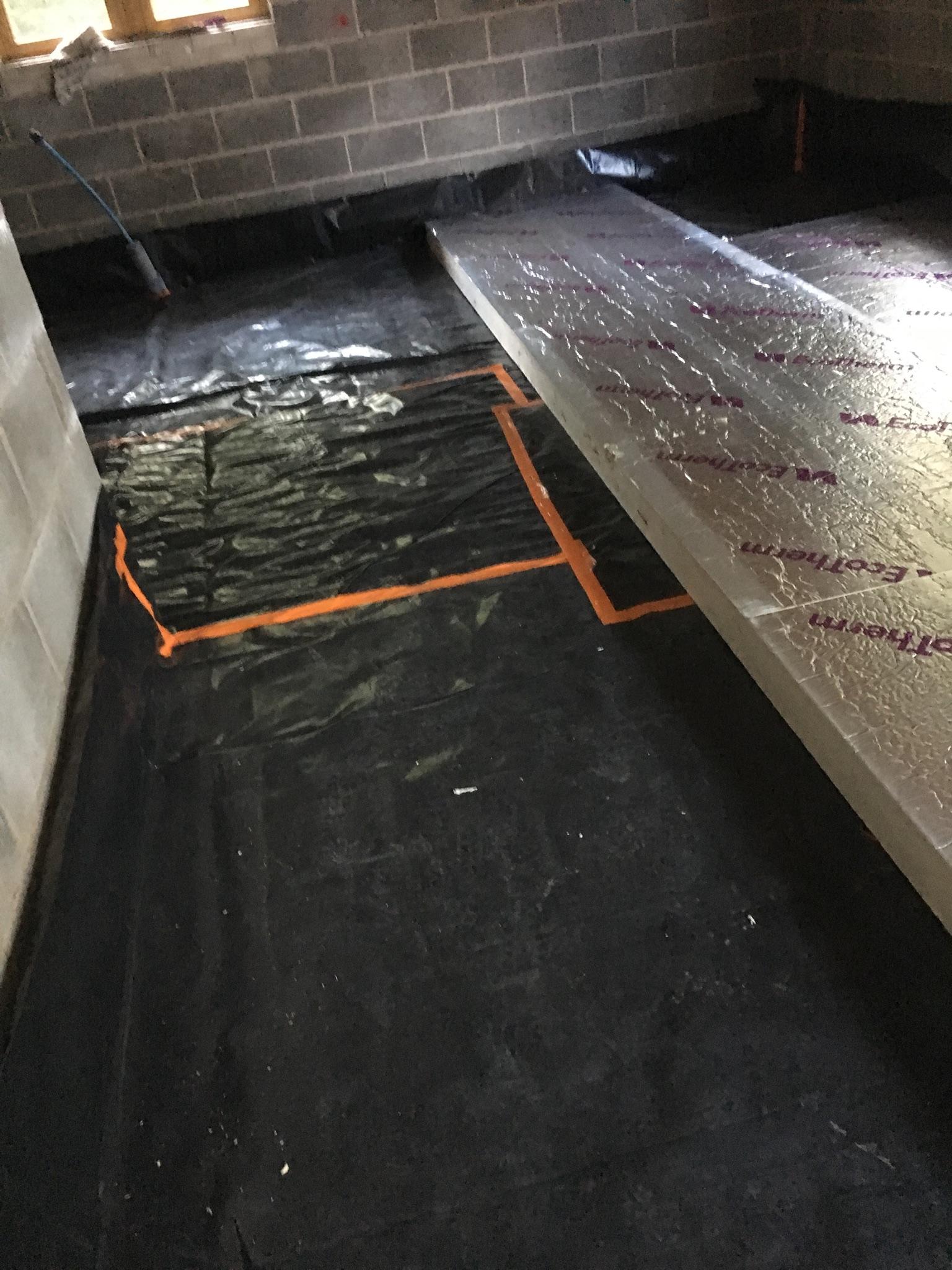

nod Posted December 7, 2020 Share Posted December 7, 2020 You will need to put a membrane below your insulation and attach it to your wall dpc It’s worth putting a slip membrane on the top also BC will want to see all this before the screed is laid and should be very keen that everything is done right 1 Link to comment Share on other sites More sharing options...
Russell griffiths Posted December 7, 2020 Share Posted December 7, 2020 2 hours ago, MikeGrahamT21 said: You'll need the foil boards, taped with aluminium tape, so it acts as a VCL, No he won’t, if it’s laid over a block n beam floor he will have a damp proof membrane laid on the floor first, this will be taped to your perimeter damp proof course. Just like @nod picture did bc come out and look at yours @nod mine wasn’t interested, he had seen so much other stuff he told me to photograph it and send him a couple of pics. Link to comment Share on other sites More sharing options...
nod Posted December 7, 2020 Share Posted December 7, 2020 6 minutes ago, Russell griffiths said: No he won’t, if it’s laid over a block n beam floor he will have a damp proof membrane laid on the floor first, this will be taped to your perimeter damp proof course. Just like @nod picture did bc come out and look at yours @nod mine wasn’t interested, he had seen so much other stuff he told me to photograph it and send him a couple of pics. Yes he did Some do and some are happy with pictures Though any of us would have to be pretty stupid to cheat on this So pictures should be fine Link to comment Share on other sites More sharing options...
