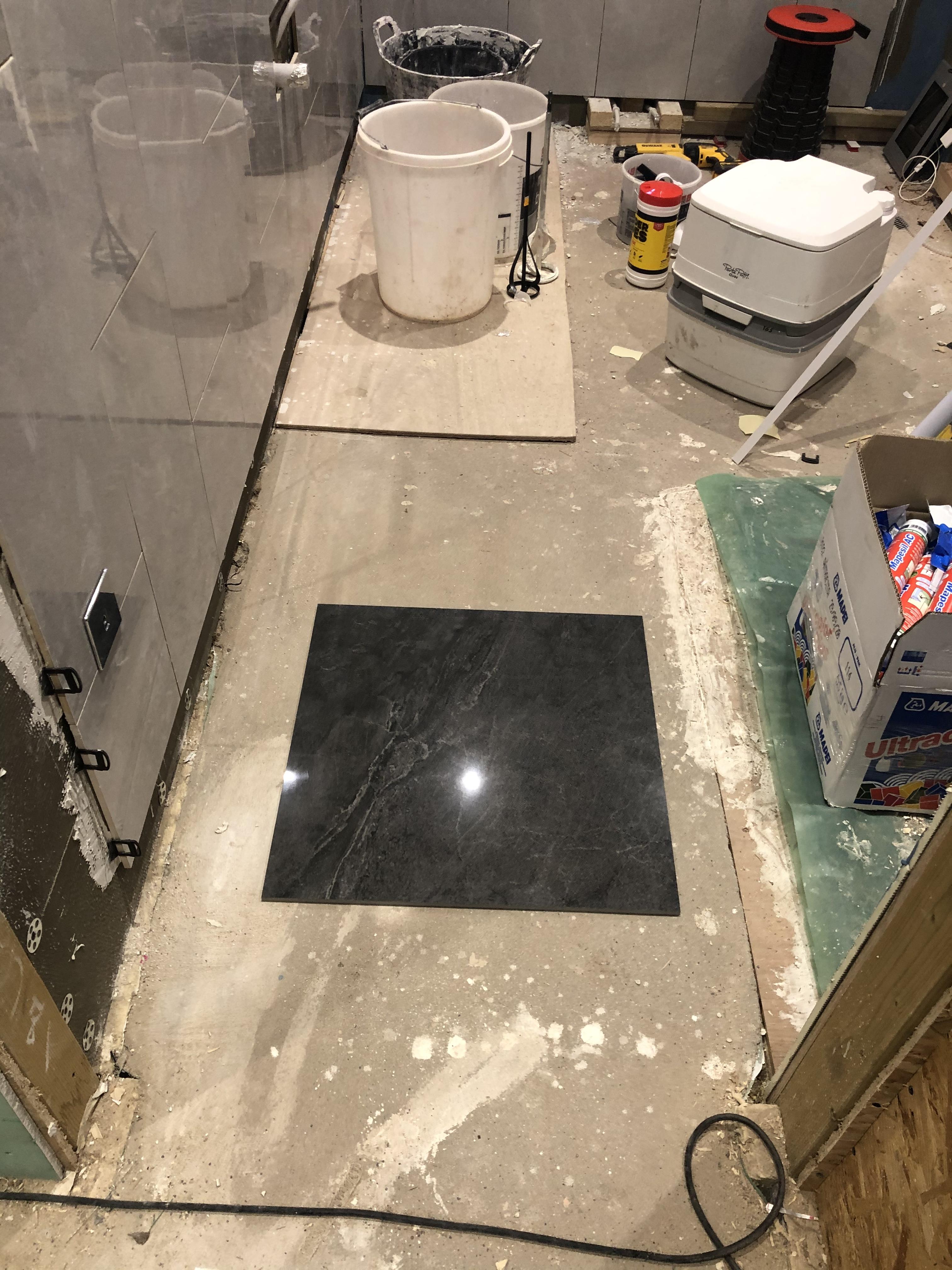

Pocster Posted December 5, 2020 Posted December 5, 2020 (edited) Getting near to this point . So advice welcome . Have a decoupling Mat to stick down first . This is the bathroom entrance ; I’m standing in the hallway . Hallway tiles are different to bathroom tiles . My plan is once I actually have the door and frame to put an expansion strip under it to seperate the rooms . So will leave off the 1st bathroom floor tile as I can’t be 100% certain where door will be when closed I.e don’t want to see hallway tiles from bathroom or bathroom tiles from hallway with a closed door . This a sensible plan ? Regarding floor tile placement- I assume I start with a whole tile in the middle I.e same distance between wall and shower tray as in the photo at the bathroom entrance . This equally sensible? ? Final question . I’m going to have tile upstands at the base of the wall I.e the black floor tiles . If I cut each end of the black tile I’ll only get 2 upstands . But have the nice machined edge . If I cut the whole tile I’ll get 4 or 5 upstands but only 2 will have machined edge . Does that matter ? Unless one of you gits gets down on your hands and knees to look at the base tile ? Edited December 5, 2020 by pocster

scottishjohn Posted December 5, 2020 Posted December 5, 2020 30 minutes ago, pocster said: Regarding floor tile placement- I assume I start with a whole tile in the middle I.e same distance between wall and shower tray as in the photo at the bathroom entrance . This equally sensible? ? or one floor tile dead in middle of door way ? Iwould play about and see what going to look best and see how cut bits at edge are going to work out 1

nod Posted December 5, 2020 Posted December 5, 2020 If your not looking to tile in one hit A row of tiles down the centre will look better and make it easy to work middle to either edge once set Unfortunately you will have to wast the middles of the upstands as they won’t have a glazed edge 2
Russell griffiths Posted December 5, 2020 Posted December 5, 2020 Regarding the cuts, just cut them twice, you cannot put a cut edge up against a factory edge it will look shit. 1
Pocster Posted December 5, 2020 Author Posted December 5, 2020 (edited) 5 minutes ago, nod said: If your not looking to tile in one hit A row of tiles down the centre will look better and make it easy to work middle to either edge once set Unfortunately you will have to wast the middles of the upstands as they won’t have a glazed edge Yeah - it’s a good weeks work for me . I’ll do as you say and I planned - whole tile path down middle of entrance then work left / right of that . So definitely do not use middle of tiles for upstands ?? Edited December 5, 2020 by pocster

nod Posted December 5, 2020 Posted December 5, 2020 29 minutes ago, pocster said: Yeah - it’s a good weeks work for me . I’ll do as you say and I planned - whole tile path down middle of entrance then work left / right of that . So definitely do not use middle of tiles for upstands ?? I’ve been helping a friend extend his house I advised him to do the same and it looks really professional Its so easy to drift with floor tiles Laying a row down the middle gives you a real solid base to kneel on But more importantly two parallel straight edges 1

Onoff Posted December 5, 2020 Posted December 5, 2020 (edited) 22 minutes ago, pocster said: I’ve run out of wall tiles . Also I think the wall tiles as upstands would look wrong if I understand you correctly ... +1 Wall tiles would have looked like pi$$y little rips there. Cut floor tiles will look much better. As Uncle Nick taught me: Put an upside down tile on 1mm / credit card thick packs. To get your cut line etc. Edited December 5, 2020 by Onoff 1 1
