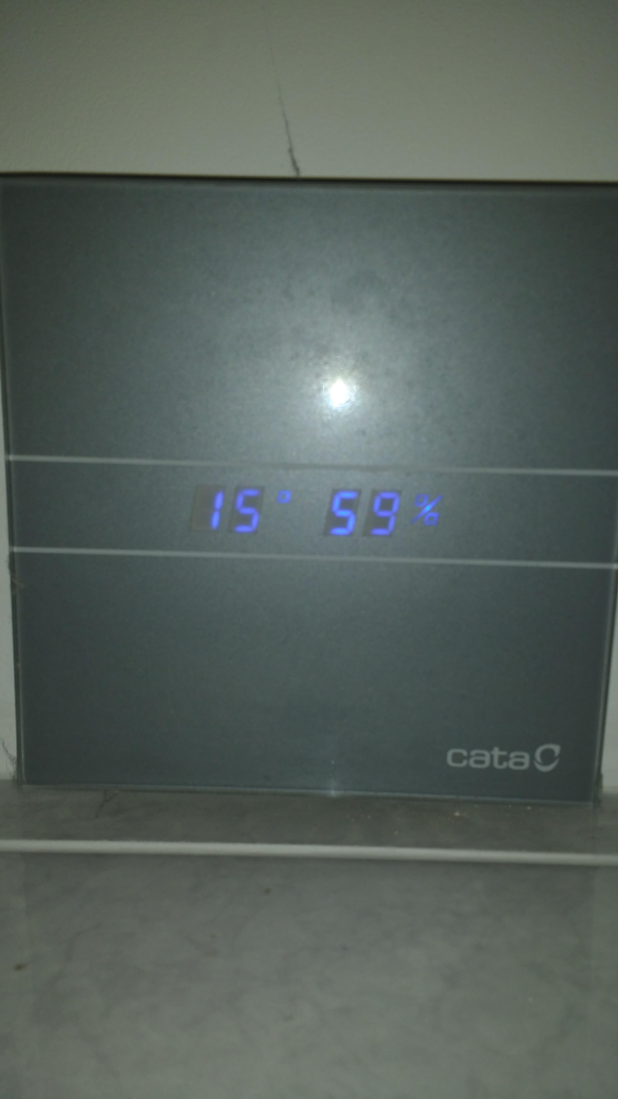

Pocster Posted December 3, 2020 Author Posted December 3, 2020 35 minutes ago, Onoff said: I'm going to get a small UPS if only for the bathroom Bluetooth unit here. We must have had half a dozen small power cuts last night and in the middle of the night the Bluetooth would play it's little power on tune! I should ring the supplier tbh and ask wtf is going on. Will the bathroom ups heat the bathroom also ? ?
Onoff Posted December 3, 2020 Posted December 3, 2020 5 minutes ago, pocster said: Will the bathroom ups heat the bathroom also ? ? That'd be nice: Check that grout line though! 1
Pocster Posted December 3, 2020 Author Posted December 3, 2020 2 minutes ago, Onoff said: That'd be nice: Check that grout line though! Shite - it’s at least a mm out
