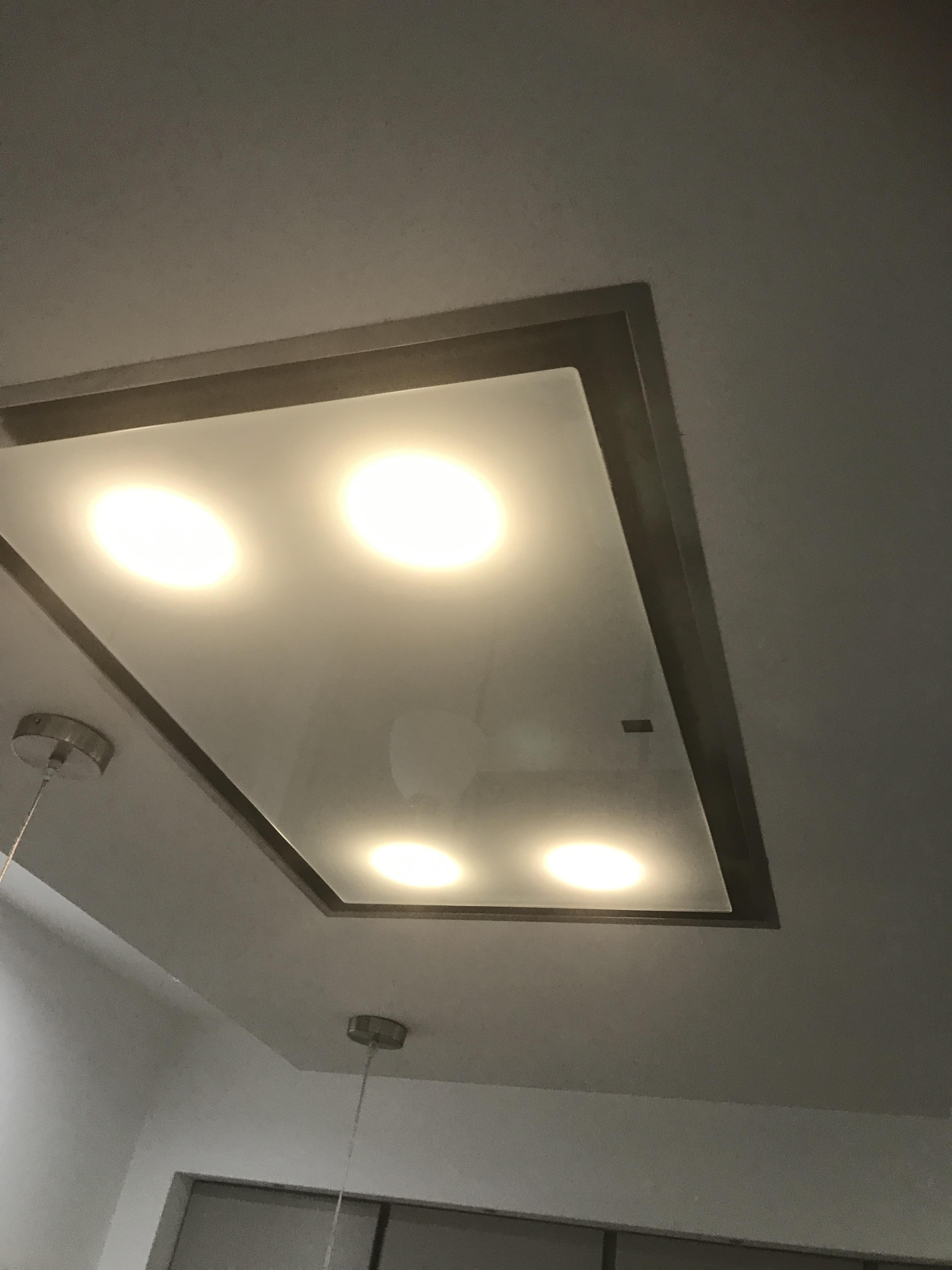

Declan52 Posted November 29, 2020 Share Posted November 29, 2020 1 hour ago, nod said: I’ve a Luxair very powerful It’s quiet on setting one On setting four we need to hold on to Something fixed Which model have you got as mine is mounted on a drop ceiling and is struggling to extract so need something with more power. Link to comment Share on other sites More sharing options...
nod Posted November 29, 2020 Share Posted November 29, 2020 15 minutes ago, Declan52 said: Which model have you got as mine is mounted on a drop ceiling and is struggling to extract so need something with more power. Link to comment Share on other sites More sharing options...
Declan52 Posted November 29, 2020 Share Posted November 29, 2020 5 minutes ago, nod said: Very nice indeed. Link to comment Share on other sites More sharing options...
nod Posted November 29, 2020 Share Posted November 29, 2020 7 minutes ago, Declan52 said: Very nice indeed. La90 Delux 1 Link to comment Share on other sites More sharing options...
