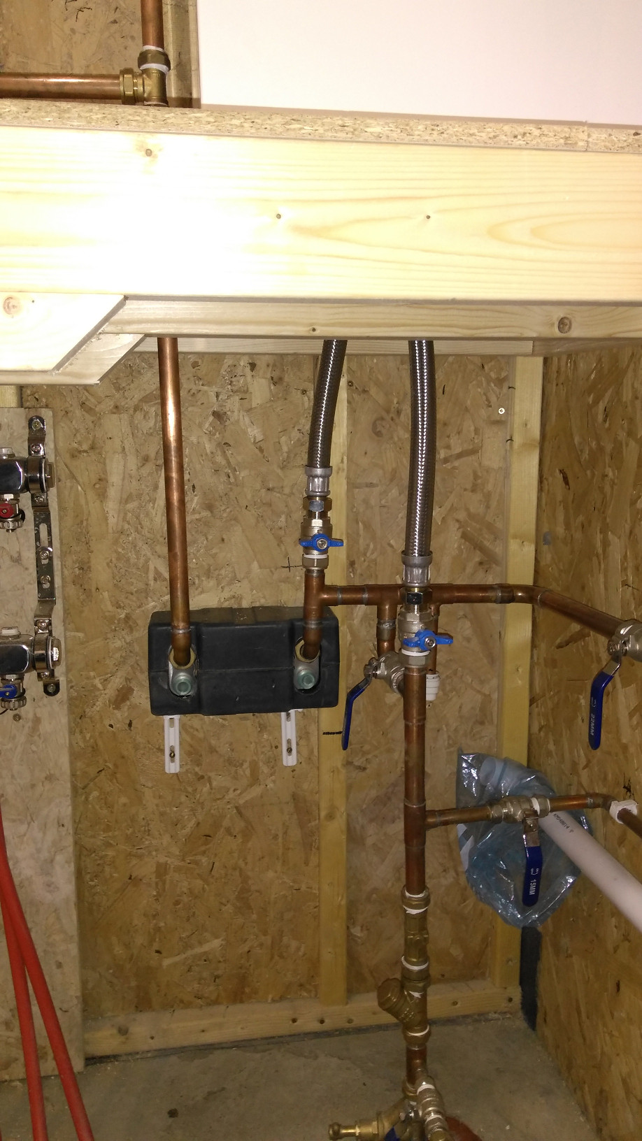

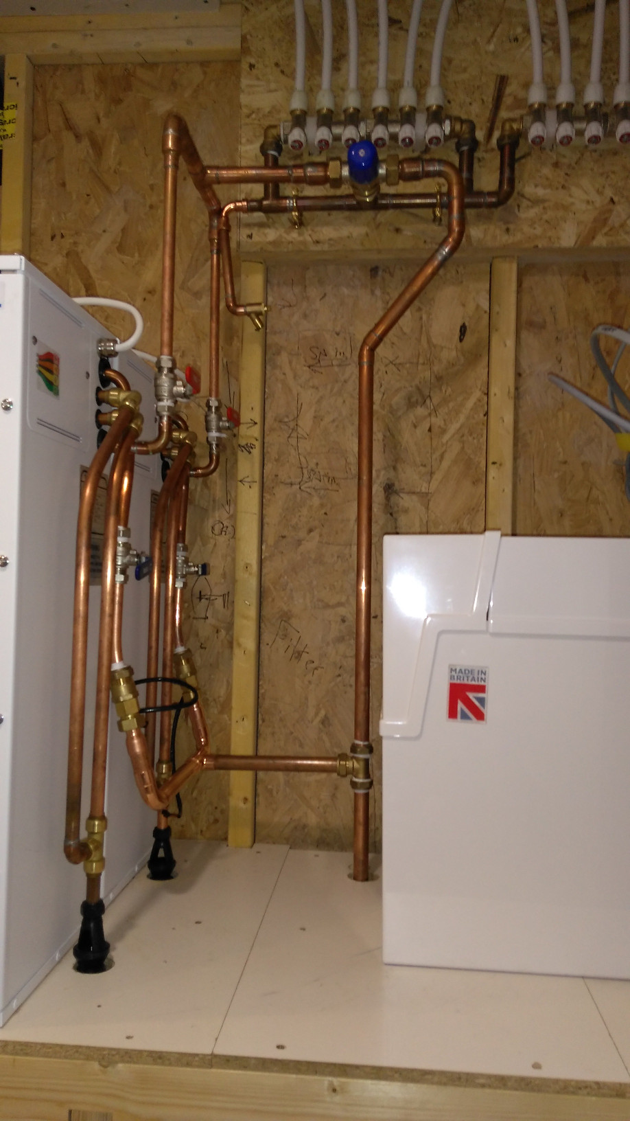

TerryE Posted March 9, 2017 Author Share Posted March 9, 2017 Potable water all plumbed up (apart from one pipe section which has been cut to length and fitted but not as yet soldered up). Time for a glass of wine intervened. To give you a sense of the size of the water services area, the two SunAmps on the left are hard against the LH wall and the Harvey water softener on the right hard against the right one. You will see from the picture below that I've still got to add the loop between the manifolds, Willis Heater and PHE, plus the expansion vessel / fill system for the UFH, but that's tomorrow's job. I've designed the connections to the SunAmps so the two SunAmp units can be isolated, disconnected and removed or swapped, so I can always take one out for maintenance. @Alphonsox, also note the two flow meters on the feeds into the SunaAmps. This flow and the temperature rise will together tell me how much (and when) I am using DHW. I've also gone to great lengths to minimise or remove any unnecessary bends on the main water paths. The manifolds on the left pic are the DHW so I will be boxing these in. 1 Link to comment Share on other sites More sharing options...
TerryE Posted March 10, 2017 Author Share Posted March 10, 2017 All potable water plumbing pressure tested today. TaDa!! I've got about 30cm (of the 2m coil lead-free solder that I bought) left so it's touch and go as to whether I will have enough to do the last UFH copper loop, so I might still have to do some lead soldering, but this is for the UFH so that's allowed. Link to comment Share on other sites More sharing options...

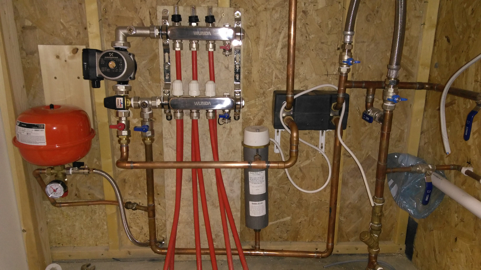

TerryE Posted March 12, 2017 Author Share Posted March 12, 2017 So here is the UFH setup. There's one fill line missing; I was just about to fit it but Jan ordered me in for dinner. The Wllis heater is in between the UFH and the PHE. Link to comment Share on other sites More sharing options...

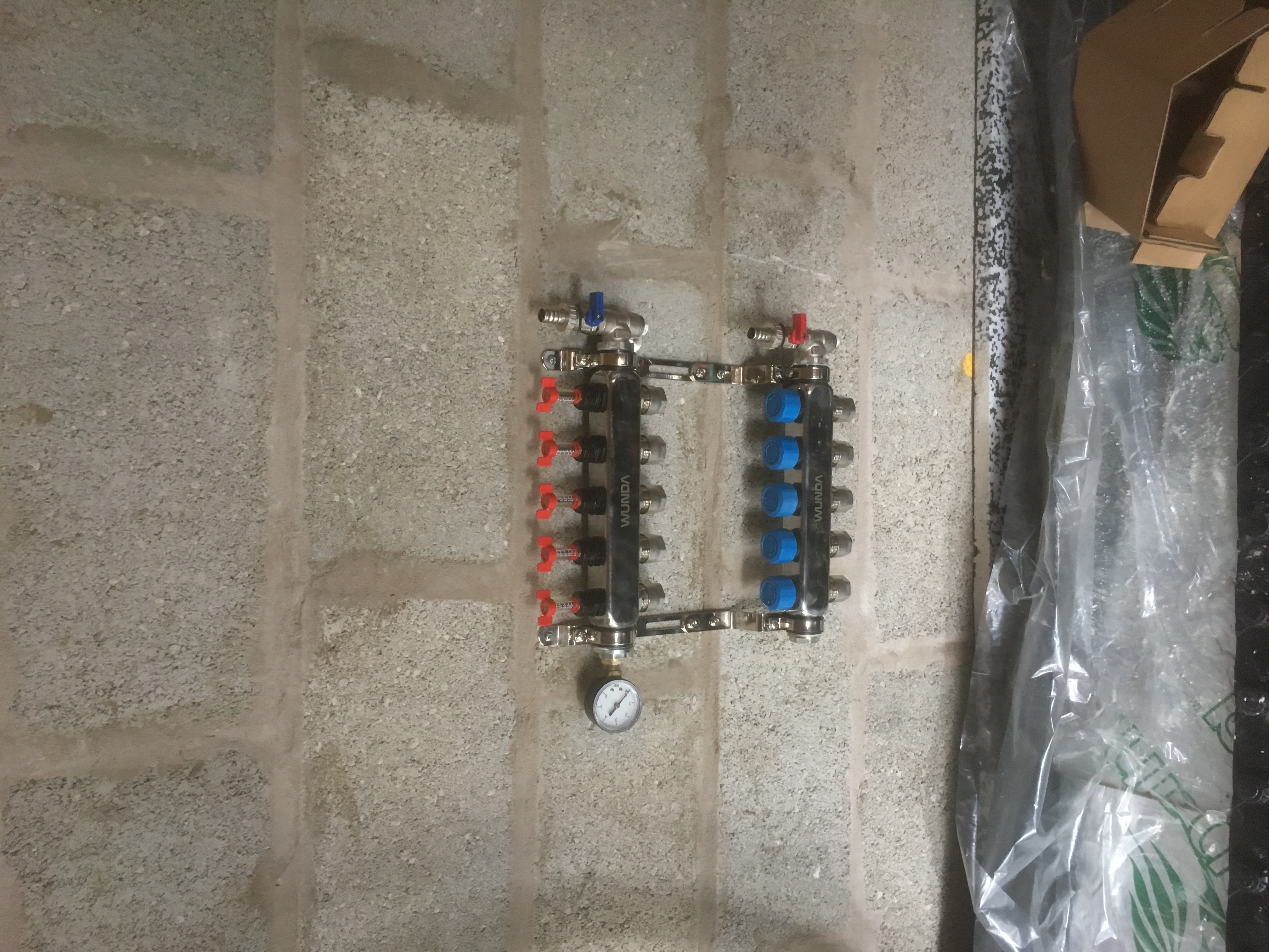

TerryE Posted March 12, 2017 Author Share Posted March 12, 2017 When did you buy your manifold. I've got the "premium manifold" which is the one that they are selling now on the Wunda website. This uses one of the port pairs for the two filler / drains. Is your manifold the previous generation? If looks as if the filler / drains on your are for left hand mounting and isn't listed on the website. Which pumpset have you got? Is it the one which can be mounted on either side? If so then one option would be to reverse the flow direction, that is have the pumpset on the right. Mine is designed for left hand mounting only. Link to comment Share on other sites More sharing options...
PeterW Posted March 12, 2017 Share Posted March 12, 2017 It arrived on Thursday ..! It's the premium manifold but the ESBE valve is only good for up to 5 ports. I'm also in discussions with them about getting the 20-43c blending valves into stock for low temp floors. Watch this space .. Link to comment Share on other sites More sharing options...

Dudda Posted March 15, 2017 Share Posted March 15, 2017 On 12/03/2017 at 20:08, TerryE said: So here is the UFH setup. There's one fill line missing; I was just about to fit it but Jan ordered me in for dinner. The Wllis heater is in between the UFH and the PHE. Does it matter if the expansion vessel and fill loop is on the flow or return (like you have) or does it make a difference? Any advantage to either or is it whatever is easiest? Link to comment Share on other sites More sharing options...
TerryE Posted March 15, 2017 Author Share Posted March 15, 2017 16 hours ago, Dudda said: Does it matter if the expansion vessel and fill loop is on the flow or return (like you have) or does it make a difference? Any advantage to either or is it whatever is easiest? IMO No. I wouldn't expect to fill it with the pump running anyway. 1 Link to comment Share on other sites More sharing options...
