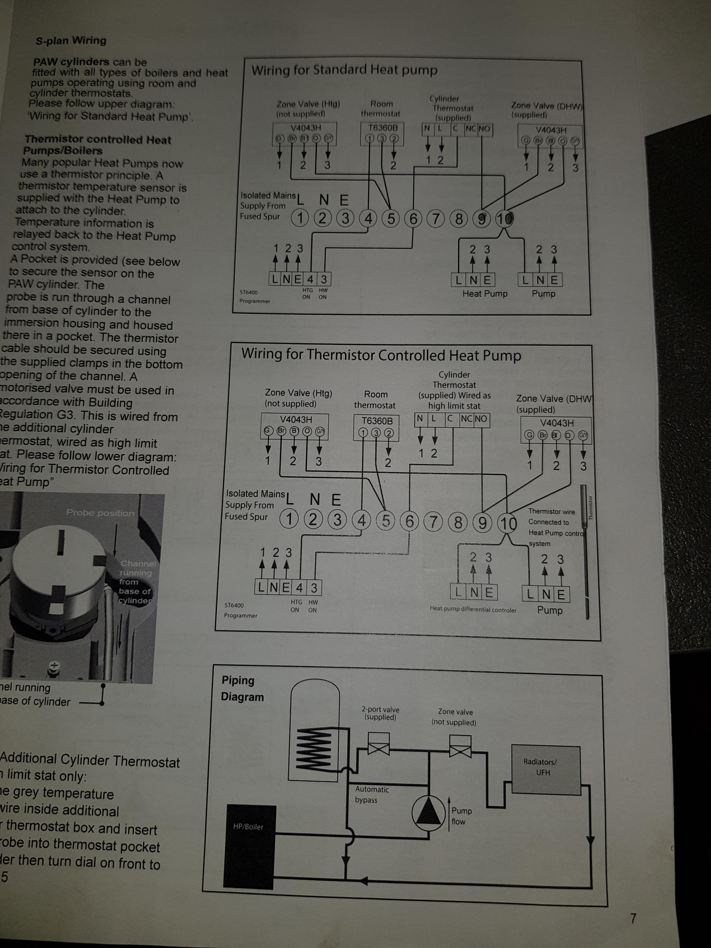

PeterW Posted December 15, 2020 Posted December 15, 2020 1 hour ago, Pete said: Plus how can the heat pump control the buffer tank as the buffer tank has no sensor, it is purely a buffer tank with no coil etc?? It can’t ..! Need to put a stat in or on it somehow. Has it got any insertion pockets or is it foamed..?? And thats a really crap way to wire a pump and valve on that picture ..! Trigger the valve with the thermostat, then use the micro switch to trigger the pump otherwise the pump is pushing against a closed valve. Daisy chaining is poor design Also on the other picture it show a NV thermostat connection and then states 230c switching ..? Which is it ..?
Pete Posted December 15, 2020 Author Posted December 15, 2020 1 minute ago, PeterW said: It can’t ..! Need to put a stat in or on it somehow. Has it got any insertion pockets or is it foamed..?? And thats a really crap way to wire a pump and valve on that picture ..! Trigger the valve with the thermostat, then use the micro switch to trigger the pump otherwise the pump is pushing against a closed valve. Daisy chaining is poor design Also on the other picture it show a NV thermostat connection and then states 230c switching ..? Which is it ..? No insertion pockets and it is foamed. Which picture are you referring to as there are two? The diagram of the circ pump wired from the heat pump is what Panasonic are advising. The other drawing ( where the circ pump is triggered by the thermostat)has come from heat pump supplier and he is recommending to wire it up this way. At the moment I am going round in circles as the advise is so conflicting so I put it on here and it changes again. At the end of the day I just need a working system for a Passive house that I can just forget about. My sparky mate was meant to be coming over from France to get me connected but even that looks dodgy at the moment (but he is old school with vast experience of older type systems) so any advise without turning everything upside down would be beneficial. Also non of the diagrams include how the tank/immersion stat on the side of the HW tank is incorporated into the design? As I understand it the stat is wired from the heat pump and is 230v ( I think)
Pete Posted December 15, 2020 Author Posted December 15, 2020 19 minutes ago, PeterW said: It can’t ..! Need to put a stat in or on it somehow. Has it got any insertion pockets or is it foamed..?? And thats a really crap way to wire a pump and valve on that picture ..! Trigger the valve with the thermostat, then use the micro switch to trigger the pump otherwise the pump is pushing against a closed valve. Daisy chaining is poor design Also on the other picture it show a NV thermostat connection and then states 230c switching ..? Which is it ..? How would you wire it @PeterW? Many thanks

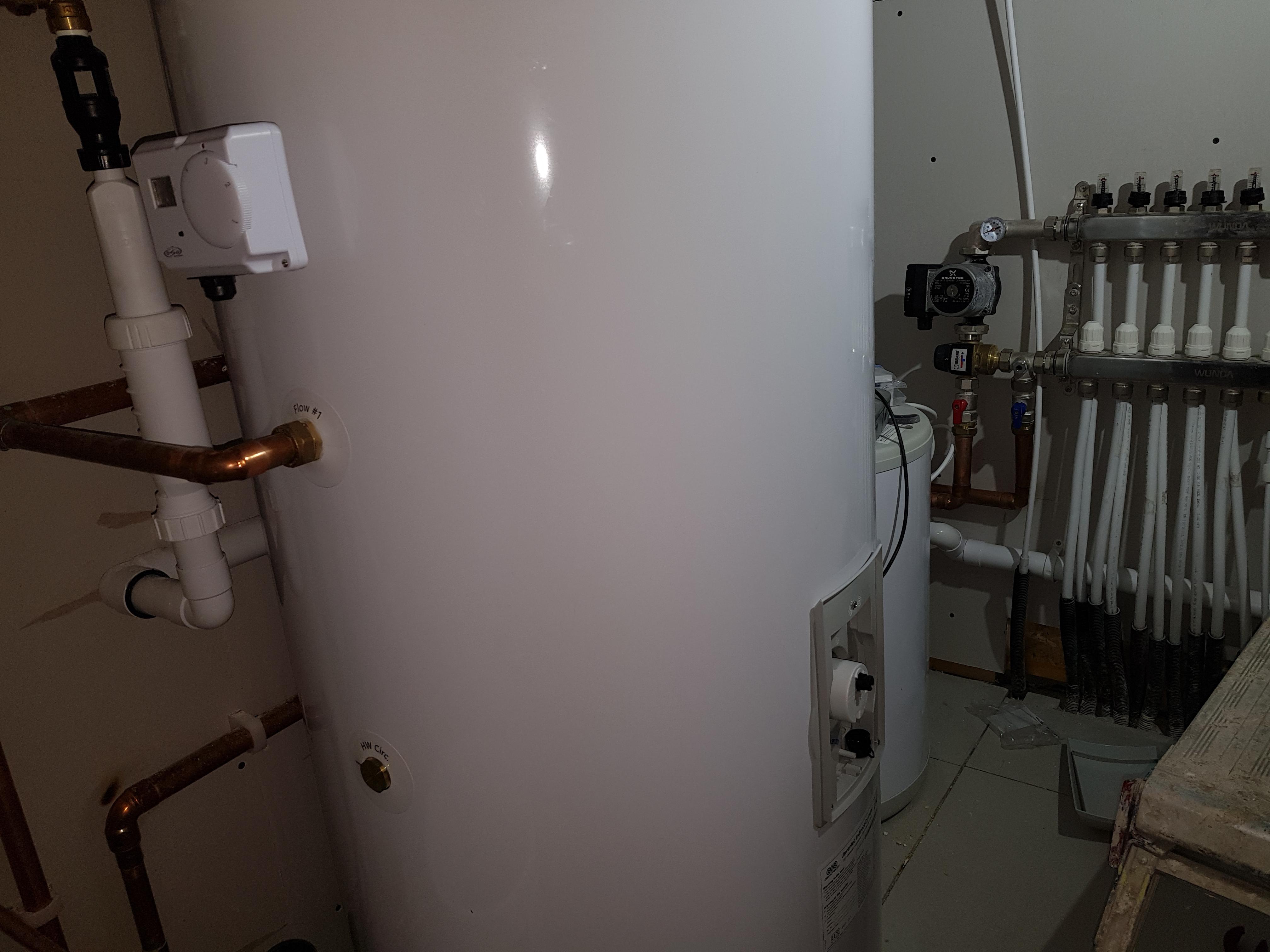

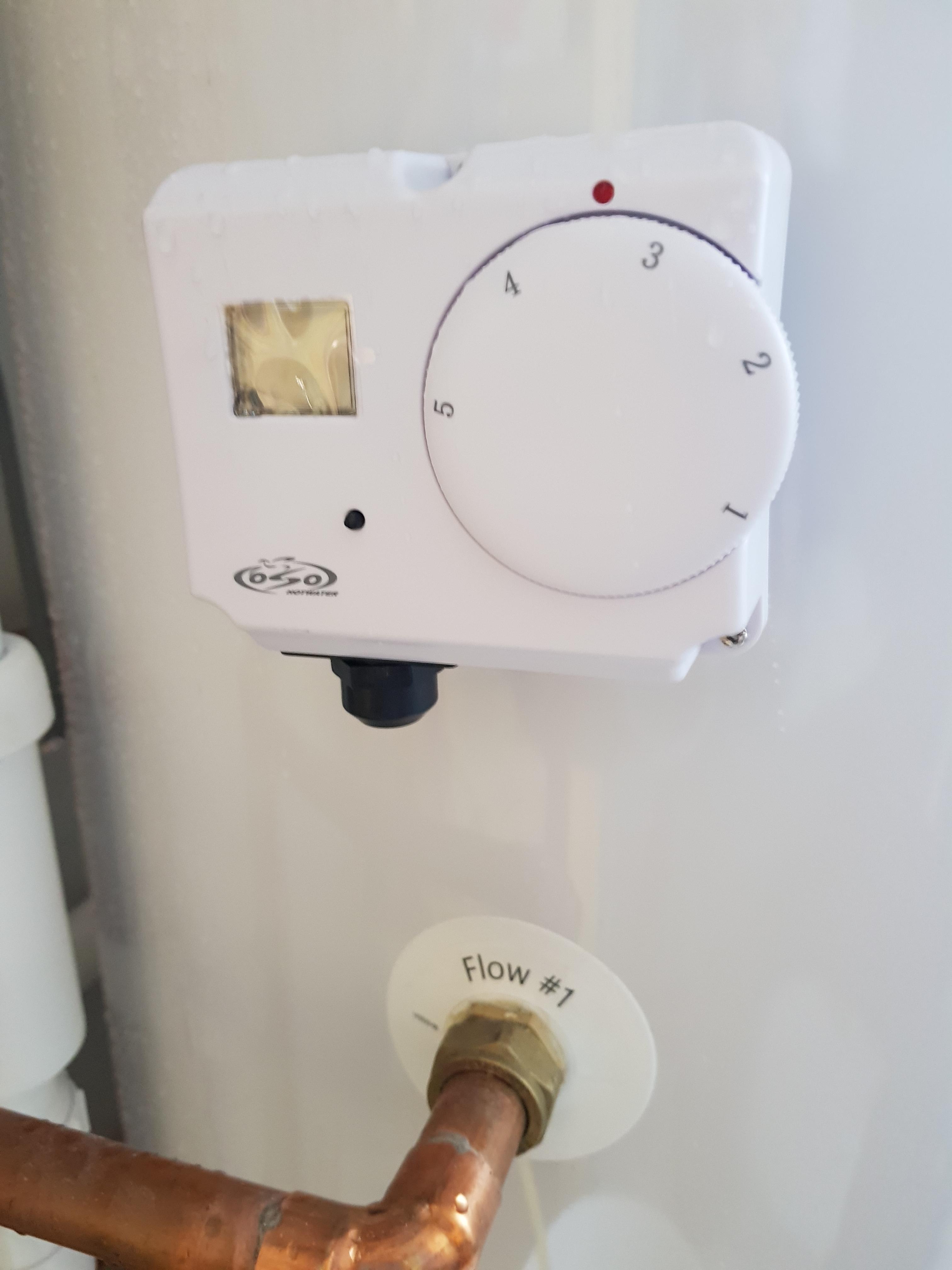

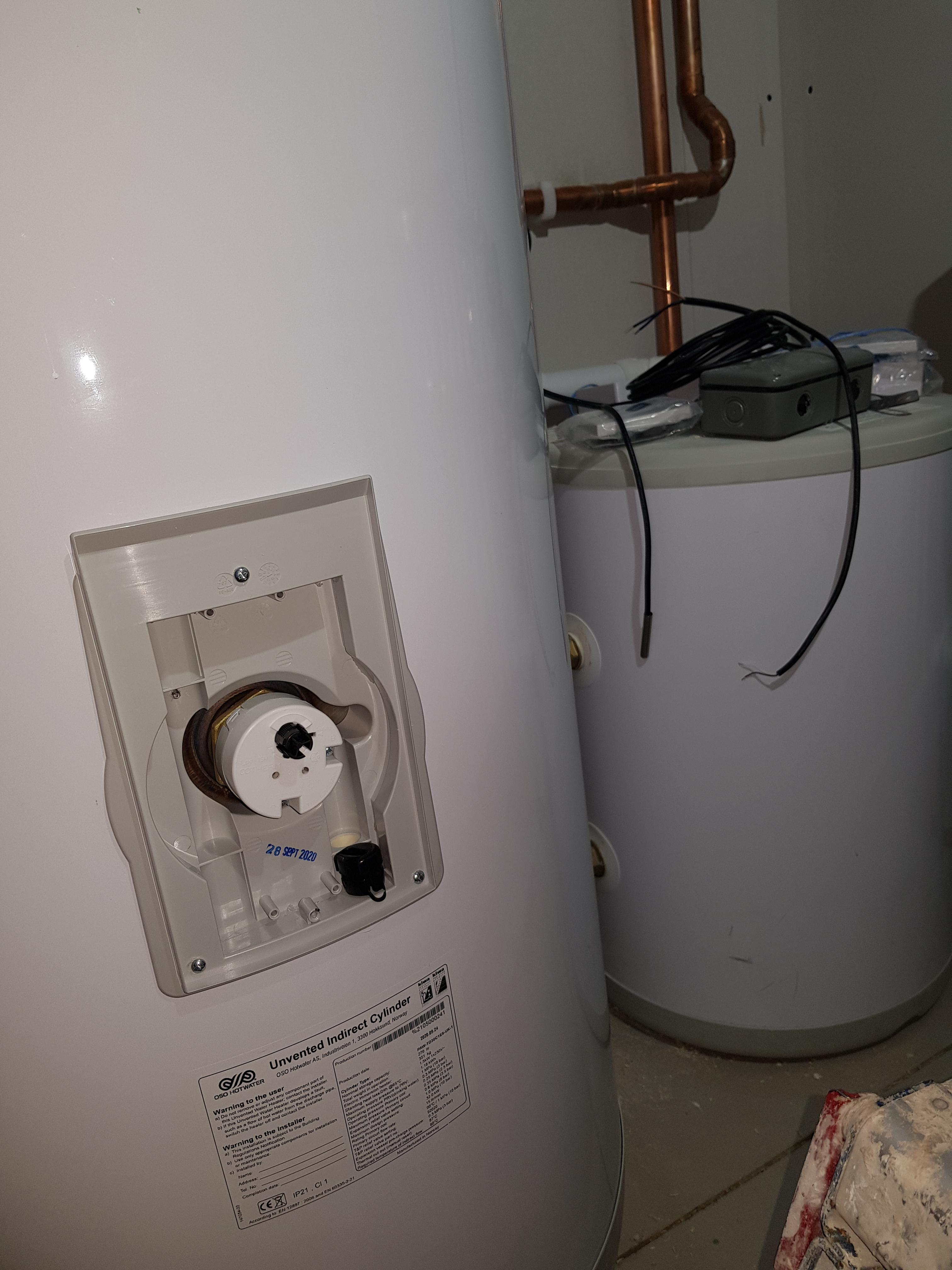

Pete Posted December 16, 2020 Author Posted December 16, 2020 12 hours ago, PeterW said: Inmersion is wired off Boost Heater. or do you mean a different stat..? This little rascal!!
PeterW Posted December 16, 2020 Posted December 16, 2020 3 minutes ago, Pete said: This little rascal!! Yeh that is a standard boost immersion - look at where it says “Boost Immersion” on the wiring diagram.
PeterW Posted December 16, 2020 Posted December 16, 2020 Just now, PeterW said: Yeh that is a standard boost immersion - look at where it says “Boost Immersion” on the wiring diagram. Actually ignore me..!!! That looks like a tank stat so should be hooked up to the DHW on the controller. So controller should say go for DHW when that is open. Is this a pre-plumbed cylinder ..?
Pete Posted December 16, 2020 Author Posted December 16, 2020 1 hour ago, PeterW said: Actually ignore me..!!! That looks like a tank stat so should be hooked up to the DHW on the controller. So controller should say go for DHW when that is open. Is this a pre-plumbed cylinder ..? Thanks Peter. No it is not a pre plumbed cylinder but in the two wiring diagrams it is not mentioned as far as I can see. There is a separate tank stat that ( 2 wire cable with torpedo on the end that fits into a pocket and this goes back to the Panasonic controller) so not sure where/how or why this fits in to the system

dpmiller Posted December 16, 2020 Posted December 16, 2020 does that wee stat even have wires connected to it?
PeterW Posted December 16, 2020 Posted December 16, 2020 2 hours ago, dpmiller said: does that wee stat even have wires connected to it? No there is a gland on the right hand side. Oddly I think that may need batteries !!

Pete Posted December 16, 2020 Author Posted December 16, 2020 2 hours ago, dpmiller said: does that wee stat even have wires connected to it? No but when you open it up there is a circuit board where incoming wires should be connected to and two smaller wired are connected to the circuit board and disappear behind the insulation round the tank 25 minutes ago, PeterW said: No there is a gland on the right hand side. Oddly I think that may need batteries !! Dont think so as there is nowhere for the batteries and there is a gland for cable access
PeterW Posted December 16, 2020 Posted December 16, 2020 What’s the make and model of that cylinder ..? Something odd going on there ..!
dpmiller Posted December 16, 2020 Posted December 16, 2020 (edited) https://www.oso-spares.co.uk/thermostats/80345---thermostat-for-boiler-delta-cylinders https://osohotwater.kmc.fless.co.uk/content/uploads/2020/03/OSO-DELTA-DCF-F1-MANUAL-UK-142227-00-1.pdf Edited December 16, 2020 by dpmiller additional infos
Pete Posted December 16, 2020 Author Posted December 16, 2020 It's a matching Panasonic cylinder and heat pump so nothing wrong it is just wiring it up to work efficiently. When I look inside the inst booklet it includes these wiring diagrams but as I have already said the heat pump guy (Seconrenewables) has said to wire it up like the one in the other drawings I have sent which shows the ufh circ pump being wired into the room stat base station..
dpmiller Posted December 16, 2020 Posted December 16, 2020 take the cover off that stat and see which wires are connected. I'm guess in the two you can see are for it's thermistor sensor and it hasn't yet actually been wired to anything else...
Pete Posted December 16, 2020 Author Posted December 16, 2020 3 minutes ago, dpmiller said: take the cover off that stat and see which wires are connected. I'm guess in the two you can see are for it's thermistor sensor and it hasn't yet actually been wired to anything else... If you look at the picture of the cylinder there is a grey cover halfway down RH side. Under this cover is the electrical connection to the immersion and the tank sensor connection which is a complete stand alone cable. This cable consists of a two core cable with a metal torpedo which I assume is the sensor so this cable is not connected to the sensor with the rotational wheel
PeterW Posted December 16, 2020 Posted December 16, 2020 So that other box is the high temp stat. You need to wire as the thermistor wiring or the lower diagram. 1
Pete Posted December 16, 2020 Author Posted December 16, 2020 30 minutes ago, PeterW said: So that other box is the high temp stat. You need to wire as the thermistor wiring or the lower diagram. But the lower diagram is not my setup. My flow from the HP goes to a diverter valve and then either UFH or HW. Normal op is to go to UFH and then when heat is called for HW the valve operates to change the flow.

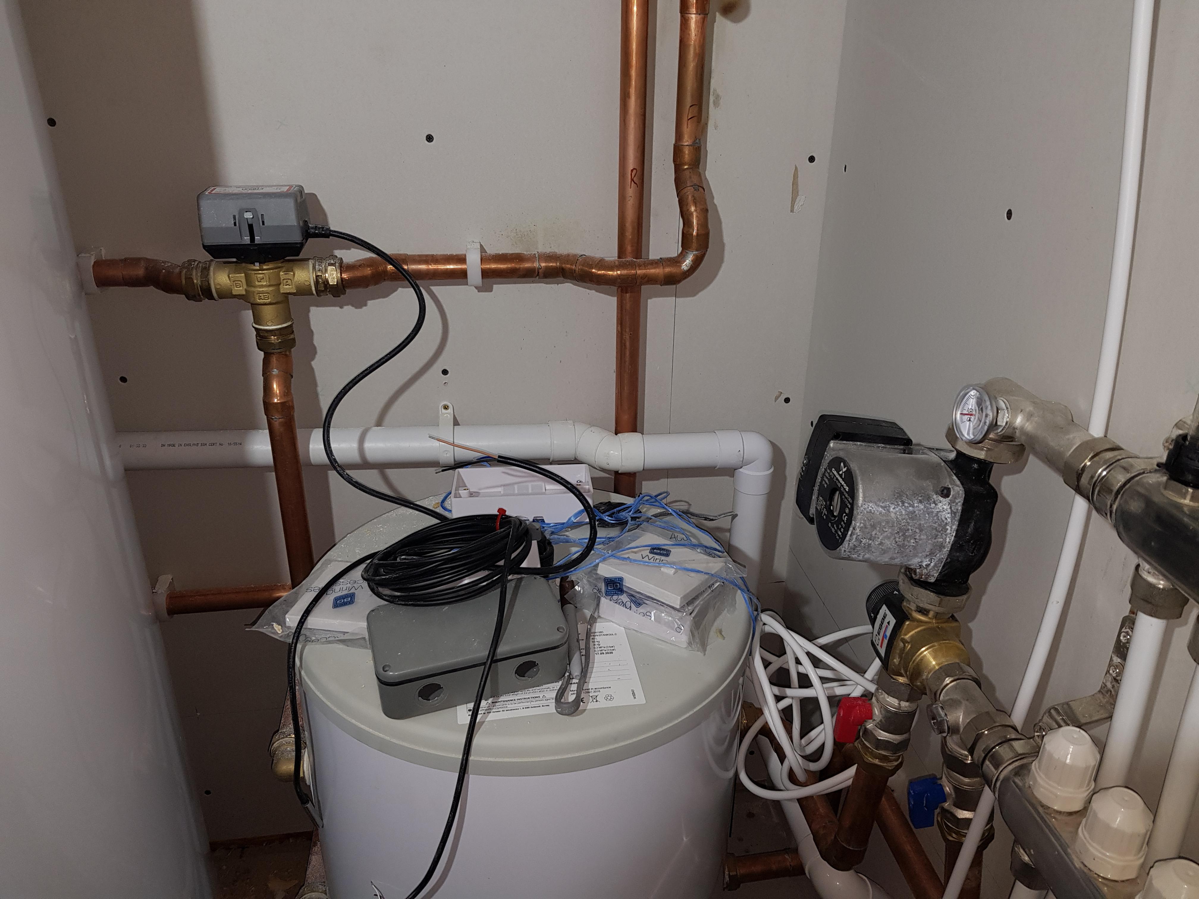

PeterW Posted December 16, 2020 Posted December 16, 2020 Ok so what you’re saying is that you don’t have a pair of zones but a diverter valve ..? 3 or 5 wire..?? model number ..?
Pete Posted December 17, 2020 Author Posted December 17, 2020 9 hours ago, PeterW said: Ok so what you’re saying is that you don’t have a pair of zones but a diverter valve ..? 3 or 5 wire..?? model number ..? This one
PeterW Posted December 17, 2020 Posted December 17, 2020 Ok so that could be a 24V valve ...! What label is on it ..?? So it’s part of the heat pump set up and I can now see why the installer wants you to use their wiring ... that’s not ideal as the high level stat I expect needs 230v to operate so you can’t wire this as a normal W Plan or S plan if they have provided a 24v valve (and I think that’s diverter but not sure without the model number off the valve) Did Secon provide this all as a kit that works as one ..? I am concerned that if you wire it as per their description and something is “wrong” then Panasonic may not pay out as it is not wired as per MIs Did Secon provide any other info..? And is there a buffer in all this ..??
Pete Posted December 17, 2020 Author Posted December 17, 2020 14 minutes ago, PeterW said: Ok so that could be a 24V valve ...! What label is on it ..?? So it’s part of the heat pump set up and I can now see why the installer wants you to use their wiring ... that’s not ideal as the high level stat I expect needs 230v to operate so you can’t wire this as a normal W Plan or S plan if they have provided a 24v valve (and I think that’s diverter but not sure without the model number off the valve) Did Secon provide this all as a kit that works as one ..? I am concerned that if you wire it as per their description and something is “wrong” then Panasonic may not pay out as it is not wired as per MIs Did Secon provide any other info..? And is there a buffer in all this ..?? Valve is 240v, it says on it. It is a VC6013 Honeywell. Yes second provided as a kit. Yes there is a buffer tank.
