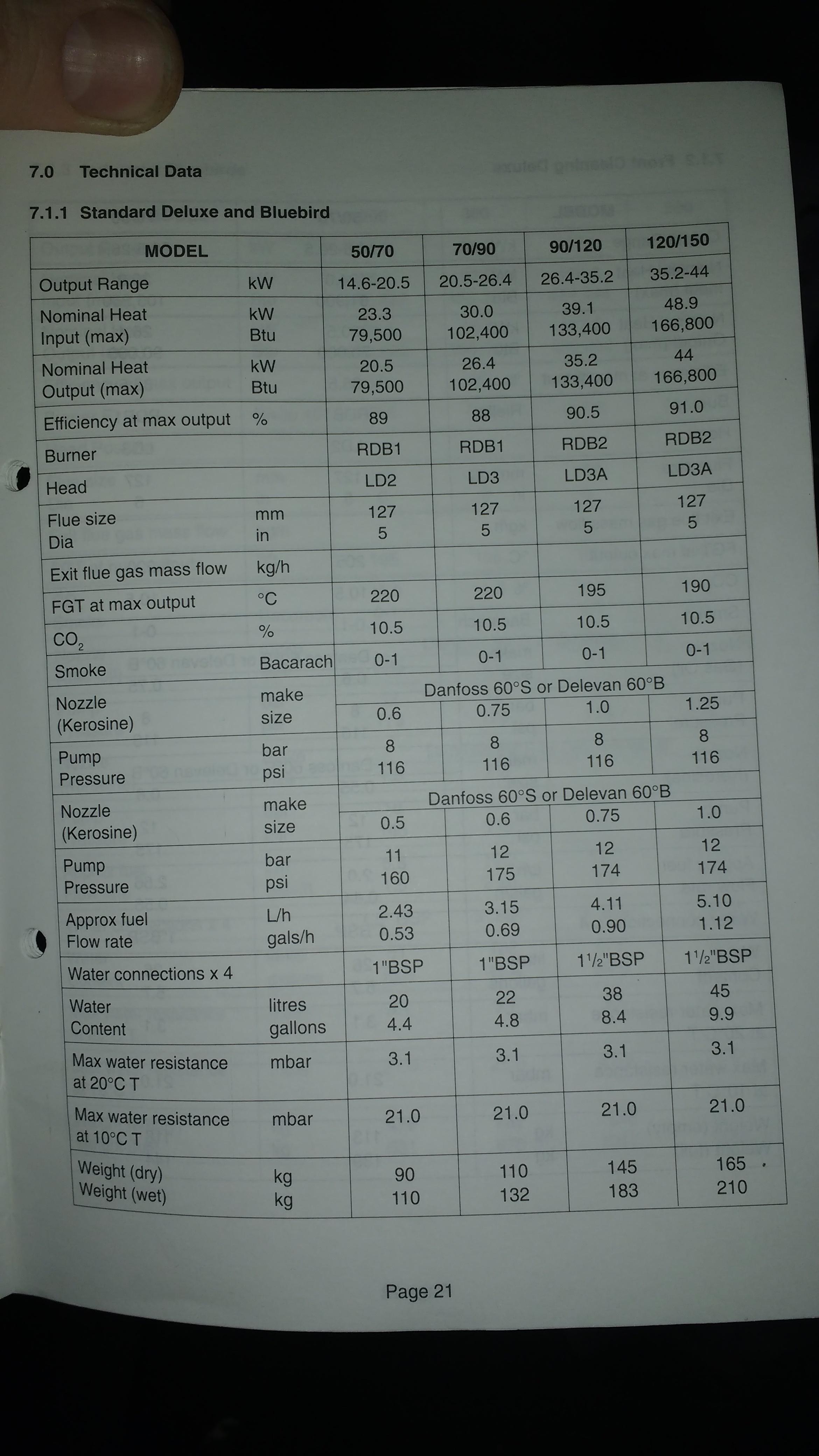

Onoff Posted February 14, 2021 Author Share Posted February 14, 2021 4 hours ago, dpmiller said: combustion analyser So what gases etc would you look for? Would an automotive one do? 1 minute ago, dpmiller said: did oil run out when you broke the oil line at the pump? Yes? firevalve is OK. It did but wondering if the flow is enough? Link to comment Share on other sites More sharing options...
dpmiller Posted February 14, 2021 Share Posted February 14, 2021 your jet will be something like .55 USgal/hr and it's a one pipe system so that all the flow you need. No, a car one doesn't really do it. Your really looking at the balance between CO2 and O2 in the flue gas (it needs to be pretty badly rich before the CO starts rising in my experience) there's a kind of a knee-point in both of the gasses and you can balance them looking at flue gas temperature too. Minimum excess O2 that keeps the CO2 at specced levels, with no CO and minimum flue temps. Easy. Link to comment Share on other sites More sharing options...
Onoff Posted February 14, 2021 Author Share Posted February 14, 2021 7 minutes ago, dpmiller said: your jet will be something like .55 USgal/hr and it's a one pipe system so that all the flow you need. No, a car one doesn't really do it. Your really looking at the balance between CO2 and O2 in the flue gas (it needs to be pretty badly rich before the CO starts rising in my experience) there's a kind of a knee-point in both of the gasses and you can balance them looking at flue gas temperature too. Minimum excess O2 that keeps the CO2 at specced levels, with no CO and minimum flue temps. Easy. The jet thing, 0.55USgal/hr....any relevance to the 0.9gals/h flow rate? Got the 90/120 model: Link to comment Share on other sites More sharing options...
dpmiller Posted February 14, 2021 Share Posted February 14, 2021 jeez that's a monster for your wee bungalow... jet's either 0.75 or 1.0 but that's quoted at a standard pressure, so the actual recommended pressure varies. Link to comment Share on other sites More sharing options...
Onoff Posted February 14, 2021 Author Share Posted February 14, 2021 2 minutes ago, dpmiller said: jeez that's a monster for your wee bungalow... jet's either 0.75 or 1.0 but that's quoted at a standard pressure, so the actual recommended pressure varies. Never worked out the sq.m area here... Most of the big boiler is used heating cold loft space or under the suspended floor! ? Link to comment Share on other sites More sharing options...

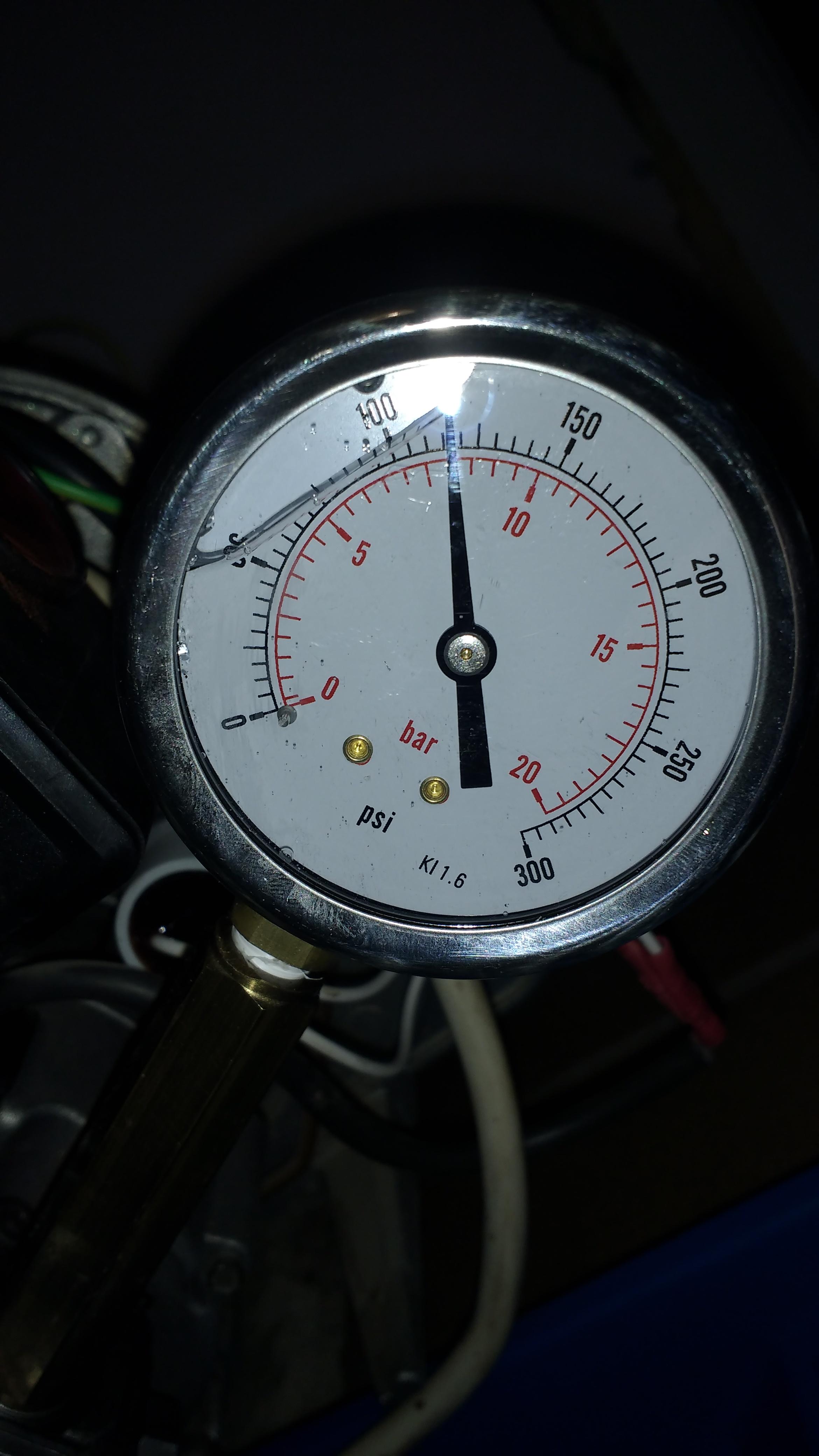

Onoff Posted February 16, 2021 Author Share Posted February 16, 2021 Got the pressure gauge in the post today and found the pressure a tad high, nearly 9bar. Lowered to 8bar as per the book. Screws straight into the hex extension piece on the burner with some PTFE tape round the1/8" BSP thread. Link to comment Share on other sites More sharing options...

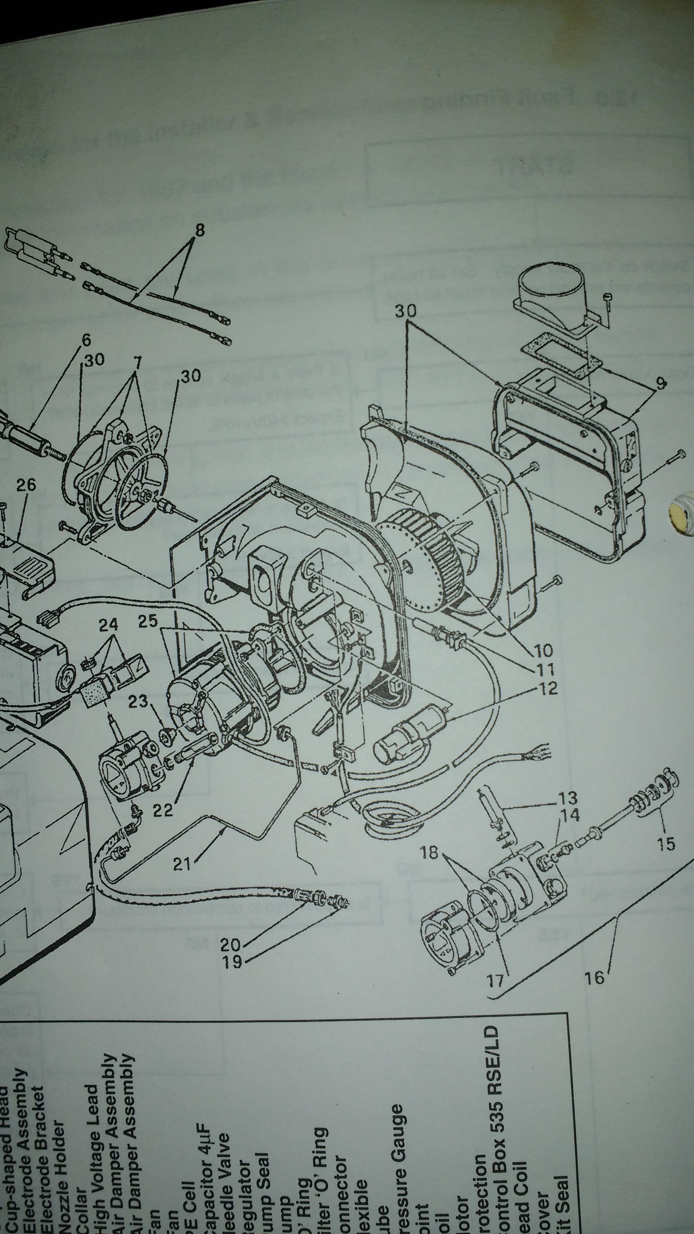

Onoff Posted May 22, 2021 Author Share Posted May 22, 2021 Bearings changed. New ones just slid on tbh. Cheap crap I guess. Squished the shaft ends in the toothed vice jaws a tad to rough 'em up a bit then used some medium strength Loctite too. A bit mucky with dirt / dust whatever in here. I wonder if that was blowing about a bit and obscuring the photocell occasionally? Reassembling now. Link to comment Share on other sites More sharing options...
Onoff Posted May 22, 2021 Author Share Posted May 22, 2021 Boiler hasn't missed a beat since changing the bearings. However it now has an annoying, underlying buzz/vibration though it rises and falls. I should have probably just done the cleaning in where the photo cell sits and tried it! ? Original bearings were SKF, new ones are unbranded. I'll take it apart again just to see if I've done anything wrong. I'll change the bearings to a better make. Have ordered a new (plastic) pump coupling, part number 3000443 that sits between the pump and motor. That's a bit worn. Link to comment Share on other sites More sharing options...

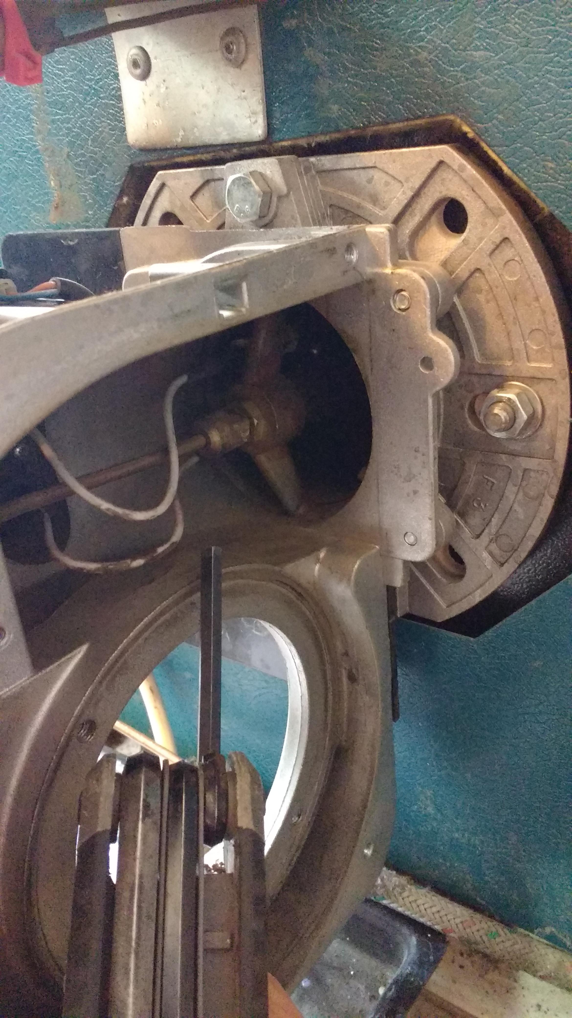

Onoff Posted March 30 Author Share Posted March 30 (edited) Got in yesterday and happened to say it felt a bit cold. "Oh yes, it was warm this morning but not as warm as it usually is!" said SWMBO. That plus she thought she could "smell oil" by the boiler. Oil boiler was starting then locking out, the 90-120 Riello RDB2 burner. Checked the cap, first, AOK. Photocell clean, solenoid ok. Plenty of oil. Traced to the pump. Chucked a pressure gauge on and zilch. Took the pump off and rotating the shaft it felt a bit gritty. Somehow I found what appeared to be a brand new pump sat in the garage! Chucked it on, set to 8bar and happy days! Last night everything working. Just came in today from a day's tree felling and and the bloody thing is locking out again. Edited March 30 by Onoff 1 Link to comment Share on other sites More sharing options...
