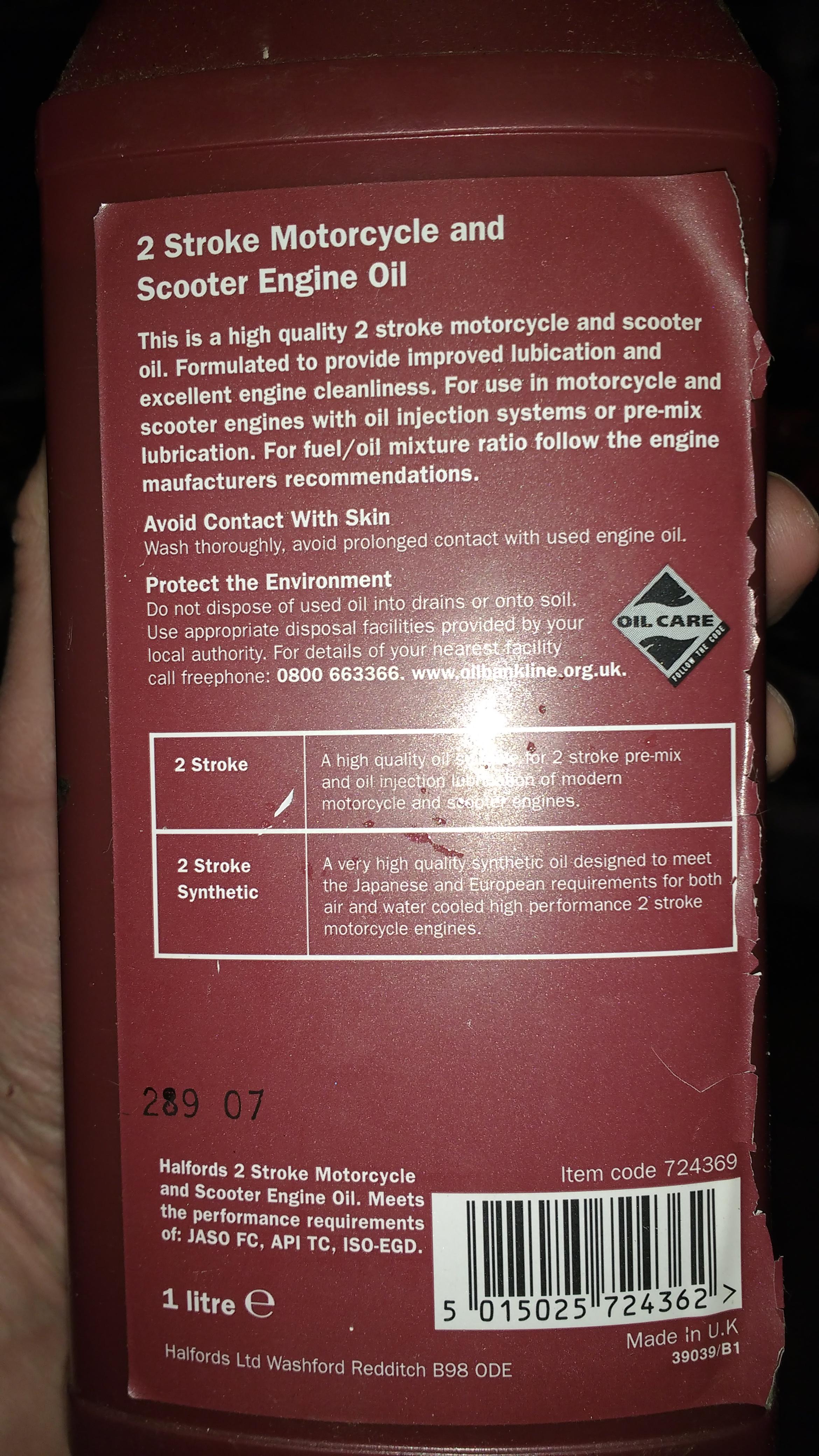

All firing up again but I was wondering about the adding some lubricating oil trick. You say "ash free" 2 stroke, and "a cupful". Say 500ml? Do I just sling this in the tank or mix with some heating oil first? Down to about 700L/160gal.
This any good? (Bought for the Puch Maxi that came with the house...another project! ?).
Cheers
that'll do. Lash it in with plenty of splashing, it'll mix OK

Out of interest why is a "capful of 2-stroke or a gallon of diesel" better than "engine oil"?
both diesel and 2T are designed to be burned and do so with as little residue as possible. 2T is formulated to disperse in the base to lubricate, diesel's additives protect sensitive injection equipment at speeds and loads far in excess of your burner's capabilities.
Engine oil, unless it's one of the latest formulations for cars with Particle filters creates a fair bit of metallic ash when burnt...

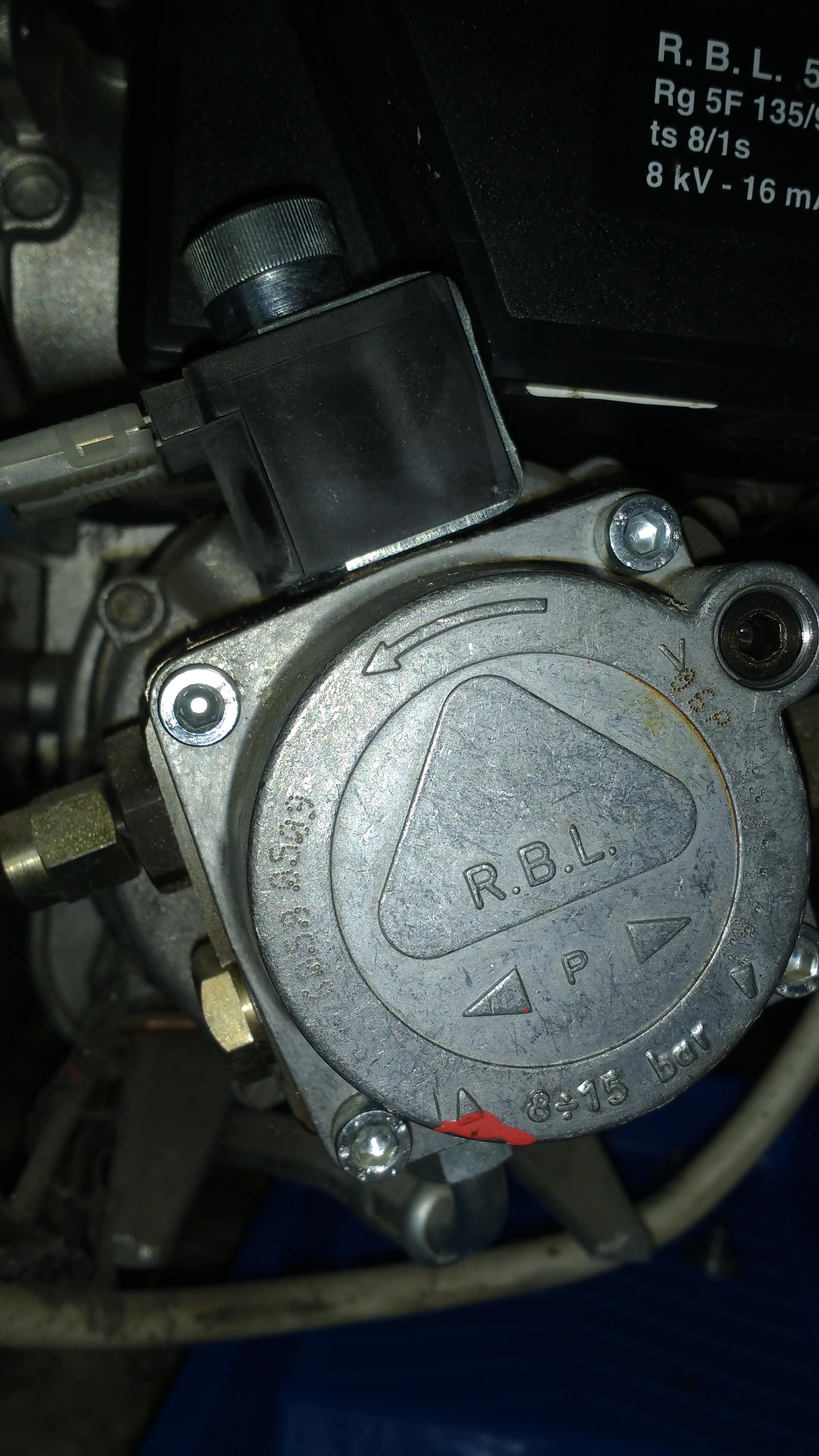

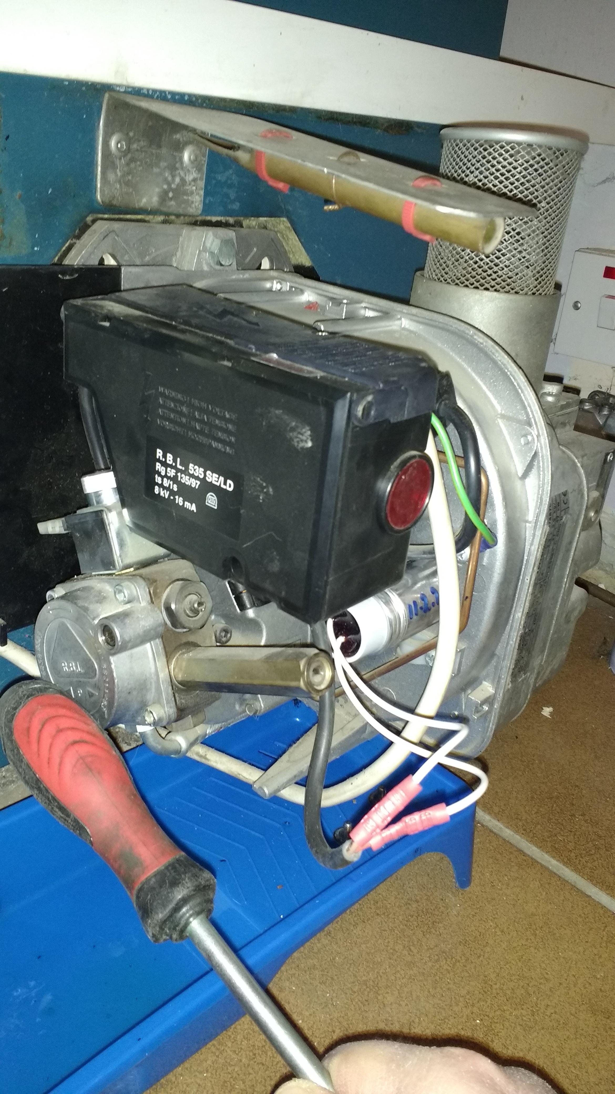

Pump maybe? Another lock out tonight. Took a sharp rap on the pump with a screwdriver seemingly to get it to go and fire up.
So gummed up or worn?
(Took the time to swap out the fridge cap for a proper Riello spare one whilst I had the lid off).

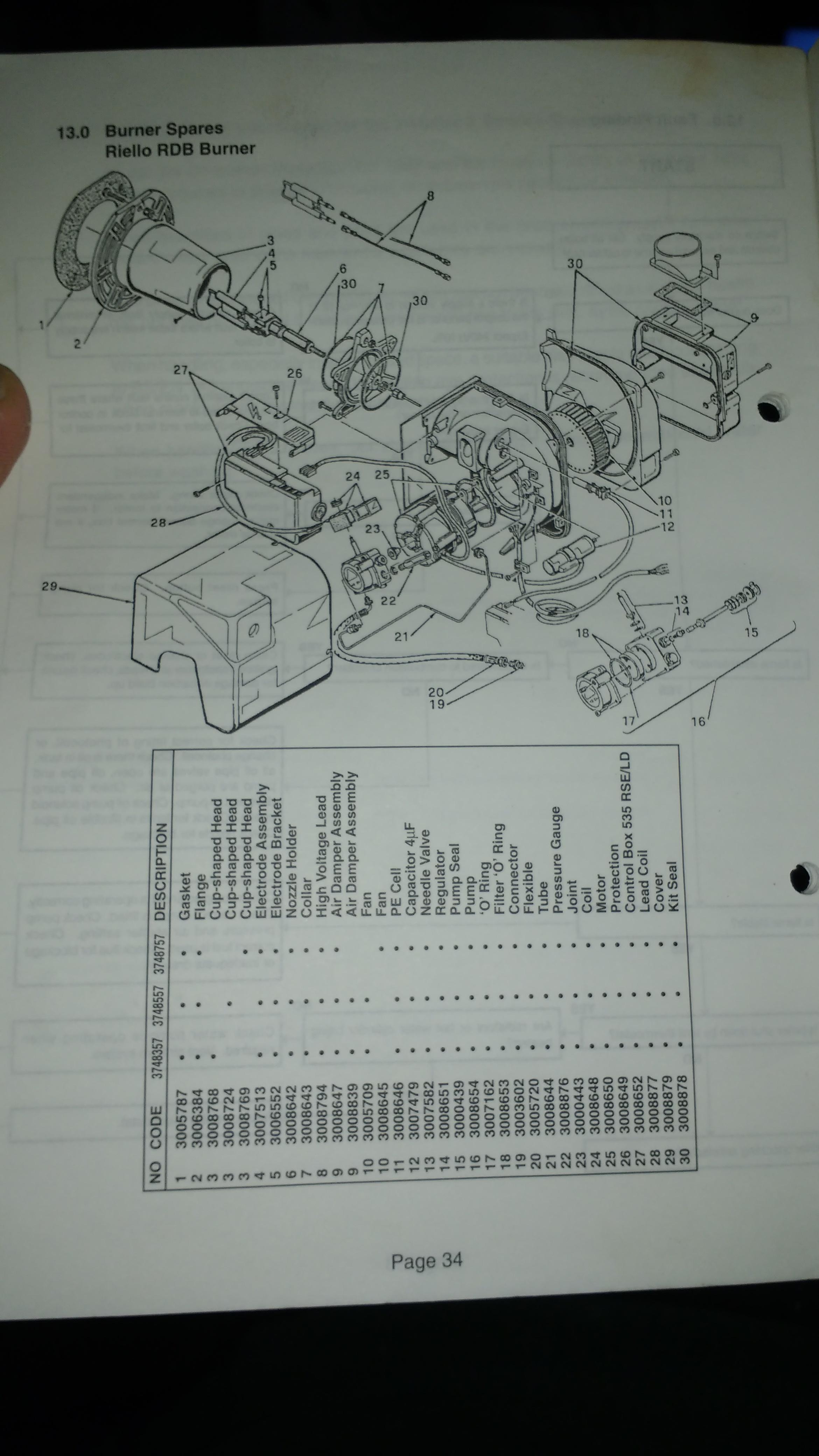

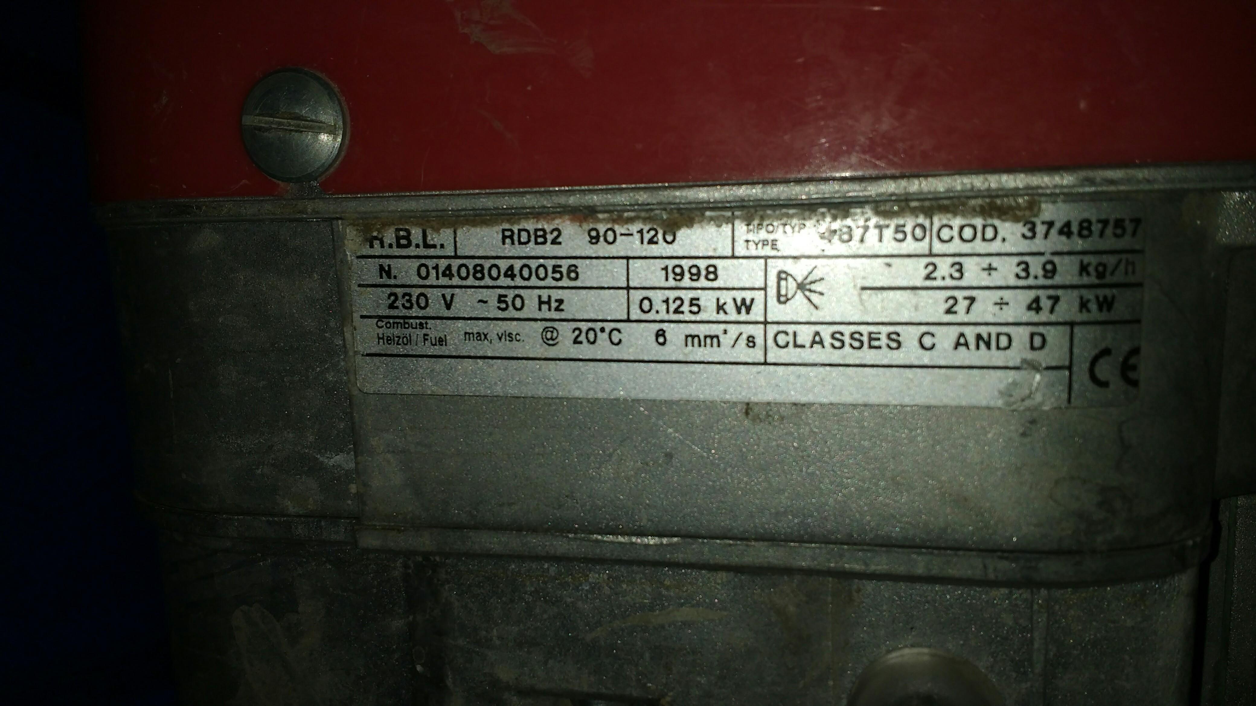

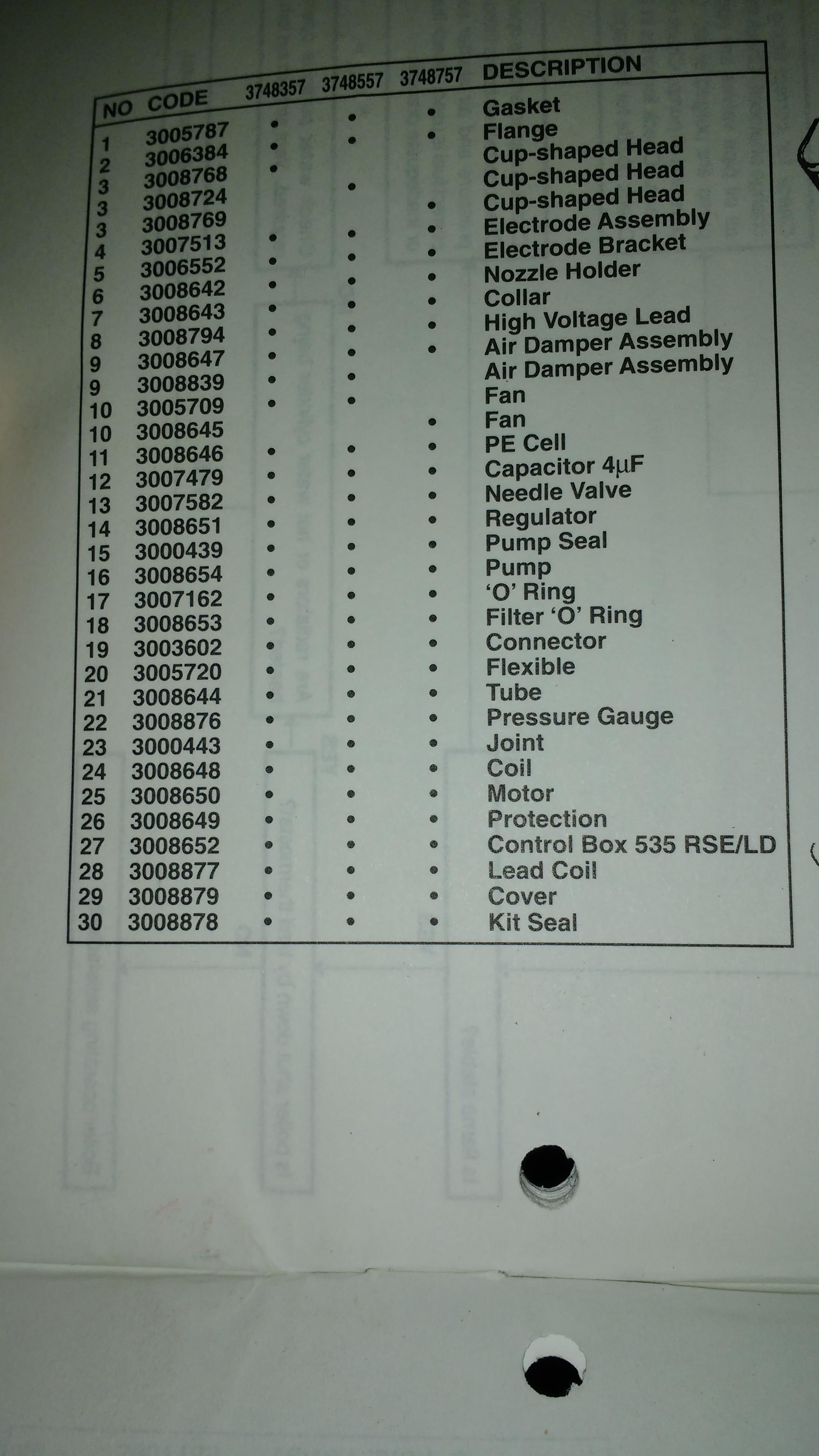

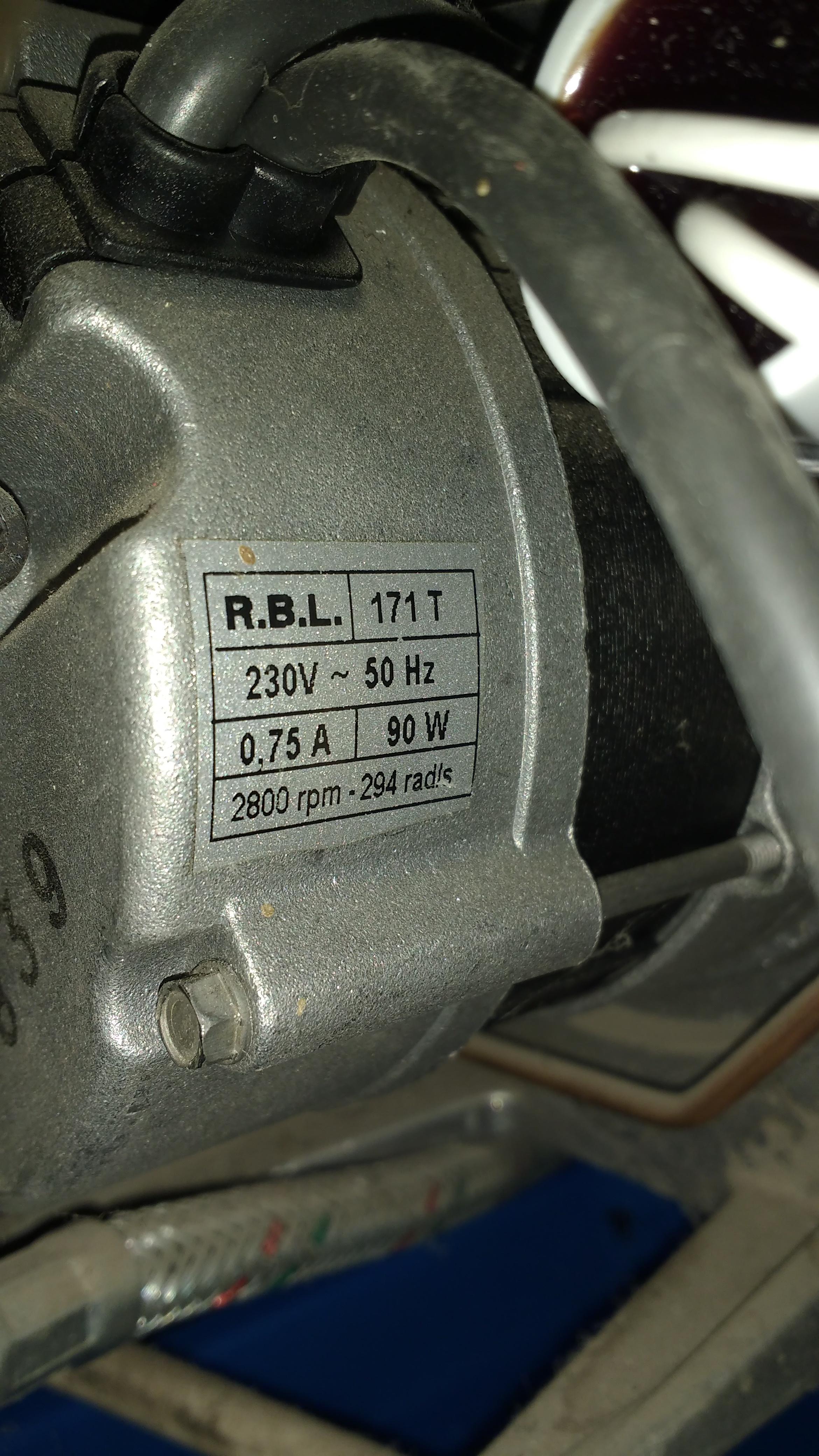

Not sure on the pump part number I need...
So RDB burner. Not sure on the RDB2 significance on the plate? This is from the manual we have for the boiler:
So "3008654"?

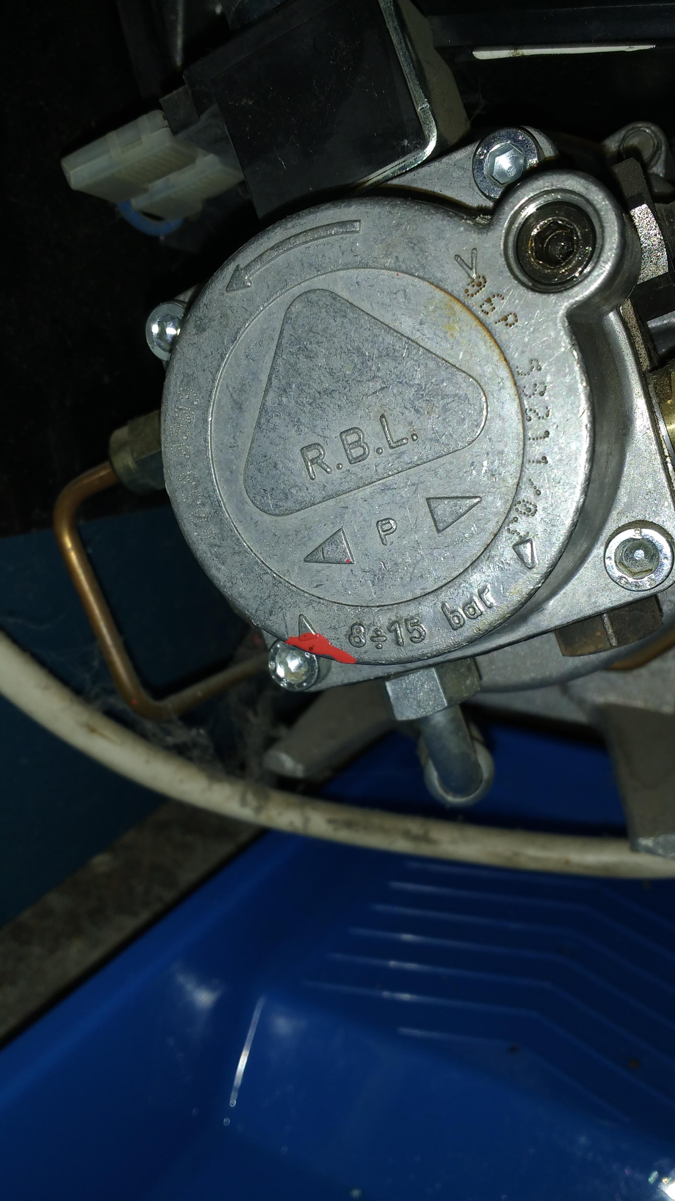

Picked up a new pump from the nice man. He did say it gets to the point when he'll usually just change the burner. He did say the pump is factory set but sometimes needs a tweak and did I have a pressure gauge. I haven't but I guess one of these?
https://www.ebay.co.uk/itm/Warmflow-Low-Pressure-Gauge-3019/262248801171?epid=13020305216&hash=item3d0f3f2393:g:Lt4AAOSwuYVWnh~k
Said he charges £75 for a service...were not there yet! ?

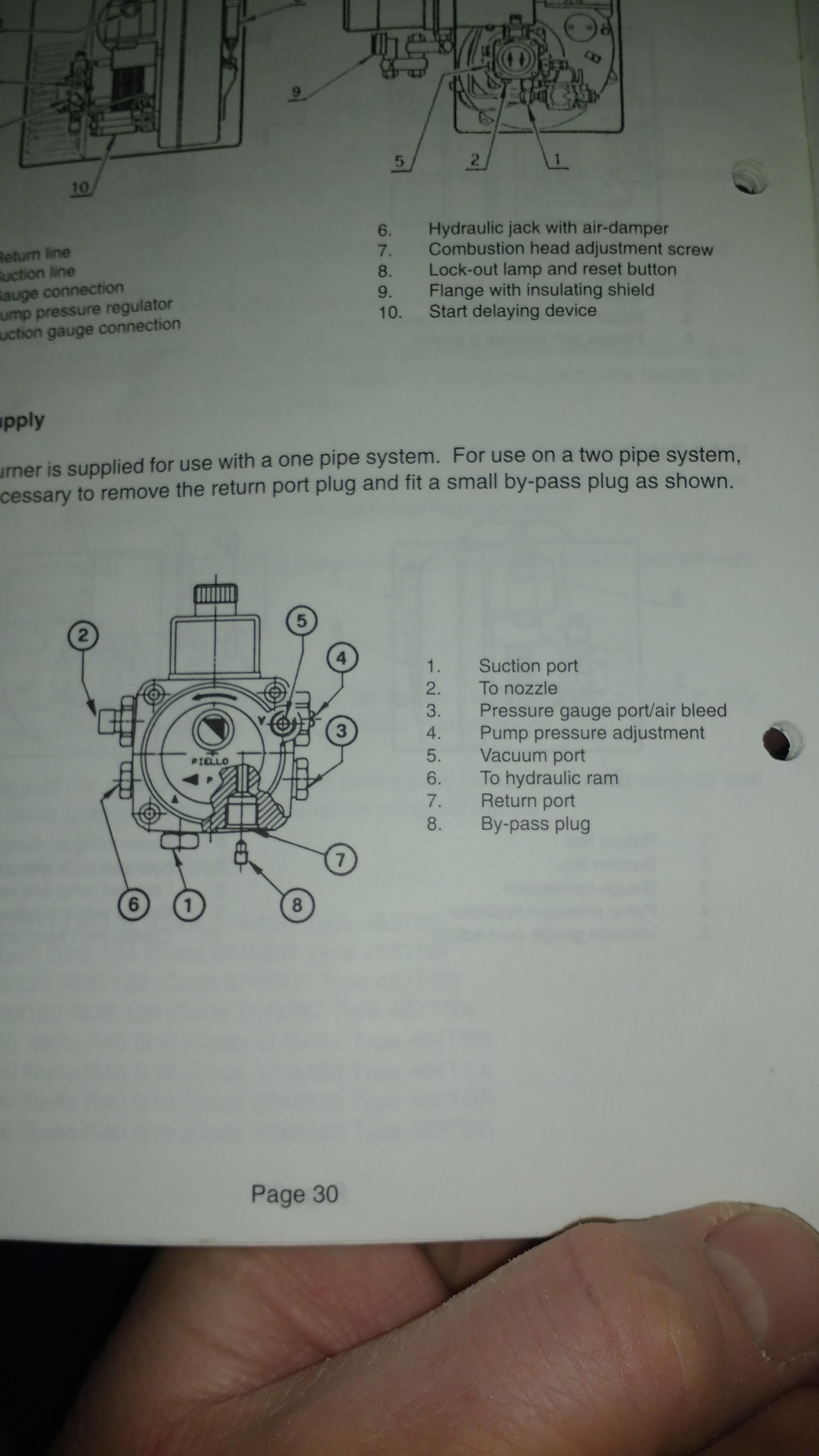

Nope, the nozzle presure will be something between 100 and 150psi.

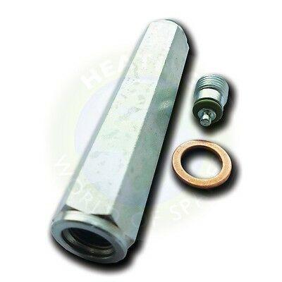

they do a kit with various fittings too or you can bodge one but a glycerine filled gauge is better, yes. Danfoss pumps are 1/8"BSP yes but I've no idea what the Riello is- the pressure gauge screws into the hole at the top of the long hex extension IIRC?
Yep, off of 3 below:
I'll have to look at the old jet to see what size I have. From that I can tell the pressure from the table in the book.
Lock out last night and it wouldn't reset. Plan this morning is to take the pump off initially and have a look. I've got the new pump but have no way of setting the pressure to the 8 bar required.
I've ordered one of these gauges from BES in the link above:
The bumpf says it's a bottom entry thread, 1/8" BSP. I'm hoping that applies to the male bit sticking out on the brass adaptor in the picture above.
In the Warmflow handbook, the long 80mm ish, hex connector (part No.3008876) is referred to as "Pressure Gauge". In reality it's where the pressure gauge attaches. Photos below taken from random eBay listings for this part. It looks like the grub screw where the pump attaches might be 1/8" BSP. Vernier at the ready for when I take it off. I may need an adapter I guess.

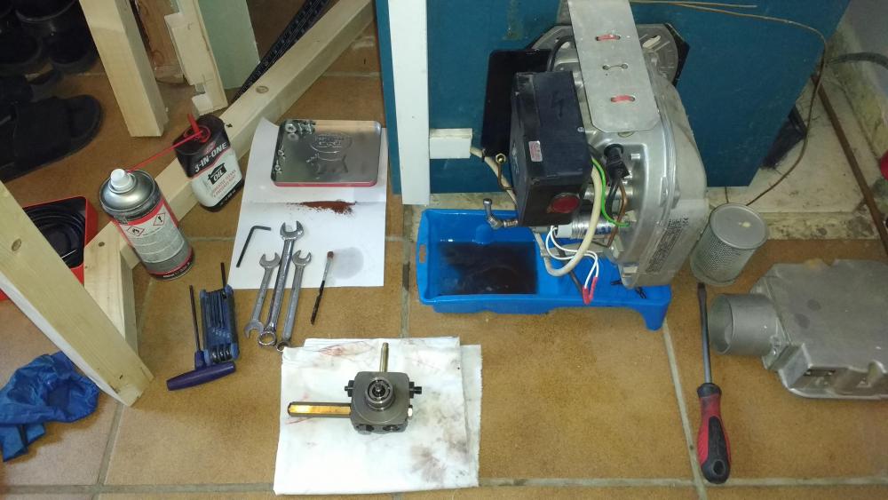

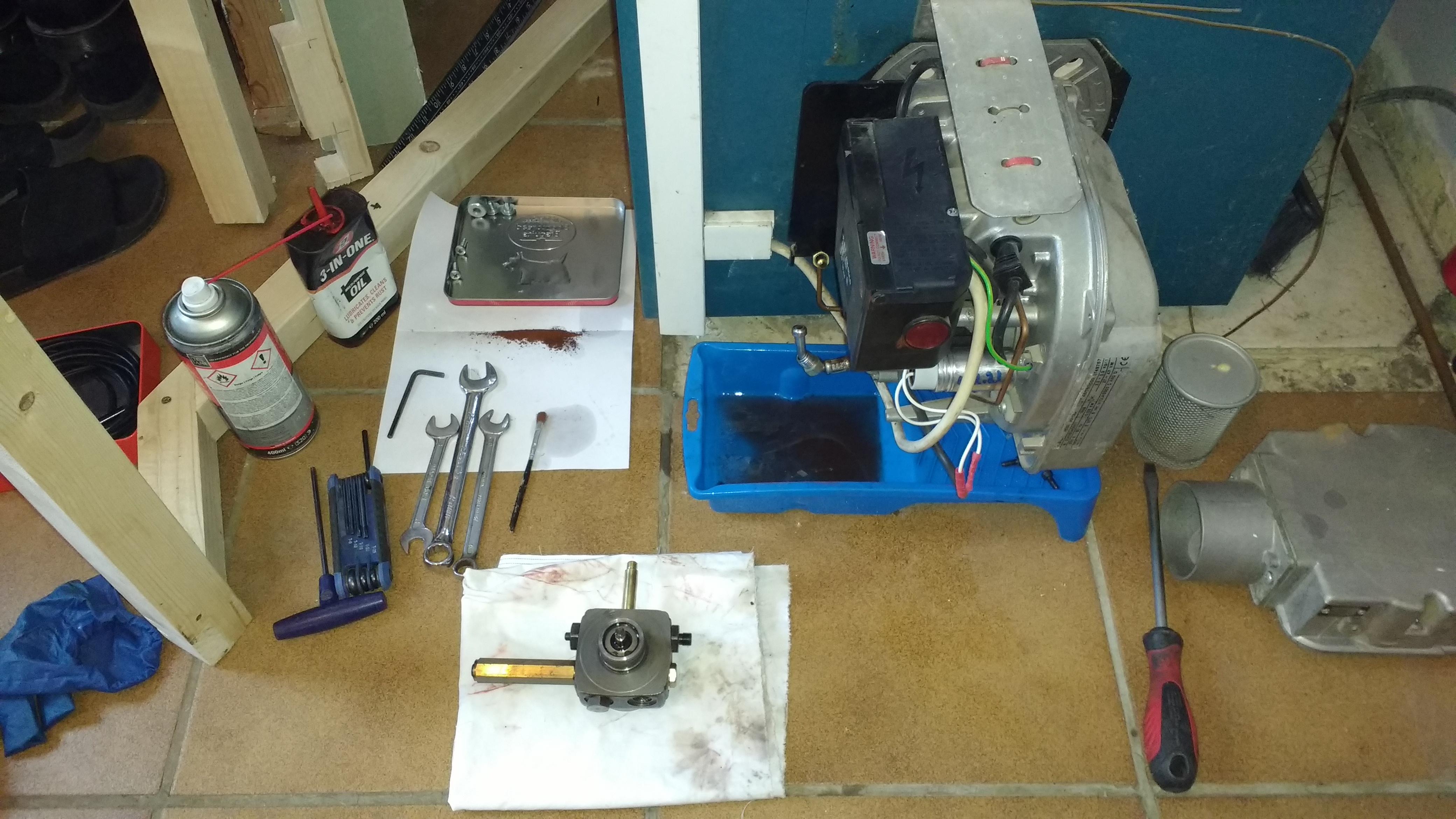

Speaking with BiL and he reckons the bearings in RDB burners can dry out but are easy enough to change.  Suggested I remove the pump then spin the fan by hand to feel if it runs smooth. On refitting the pump he suggested I lubricate the pump shaft with oil to try and get some in the bearings. If it's dry bearings maybe that'll help and I can refit the old one until I get the gauge.
I'm 2 cups of coffee, 2 toast and 2 paracetamol down. Just waiting for the pills to kick in before I start. Then it's off to the garage to get some lubricating oil. I've a 3kW fan heater running in the lounge and a panel heater taking the chill off in the boiler room.
I'd expect a dry bearing to squeal like a pig as it nipped up.
Does that boiler have a sight glass, or can you run it with the baffles out for a minute? You can do a rough pressure set by flame size-  as big as possible without actually touching the back wall...

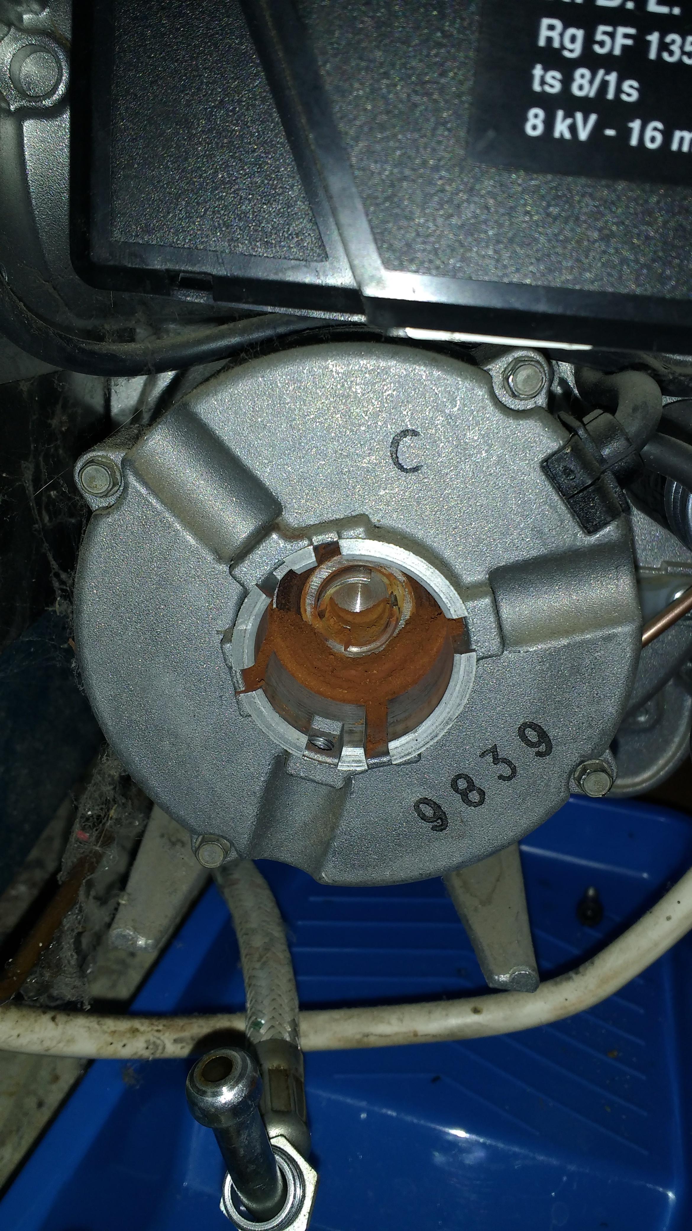

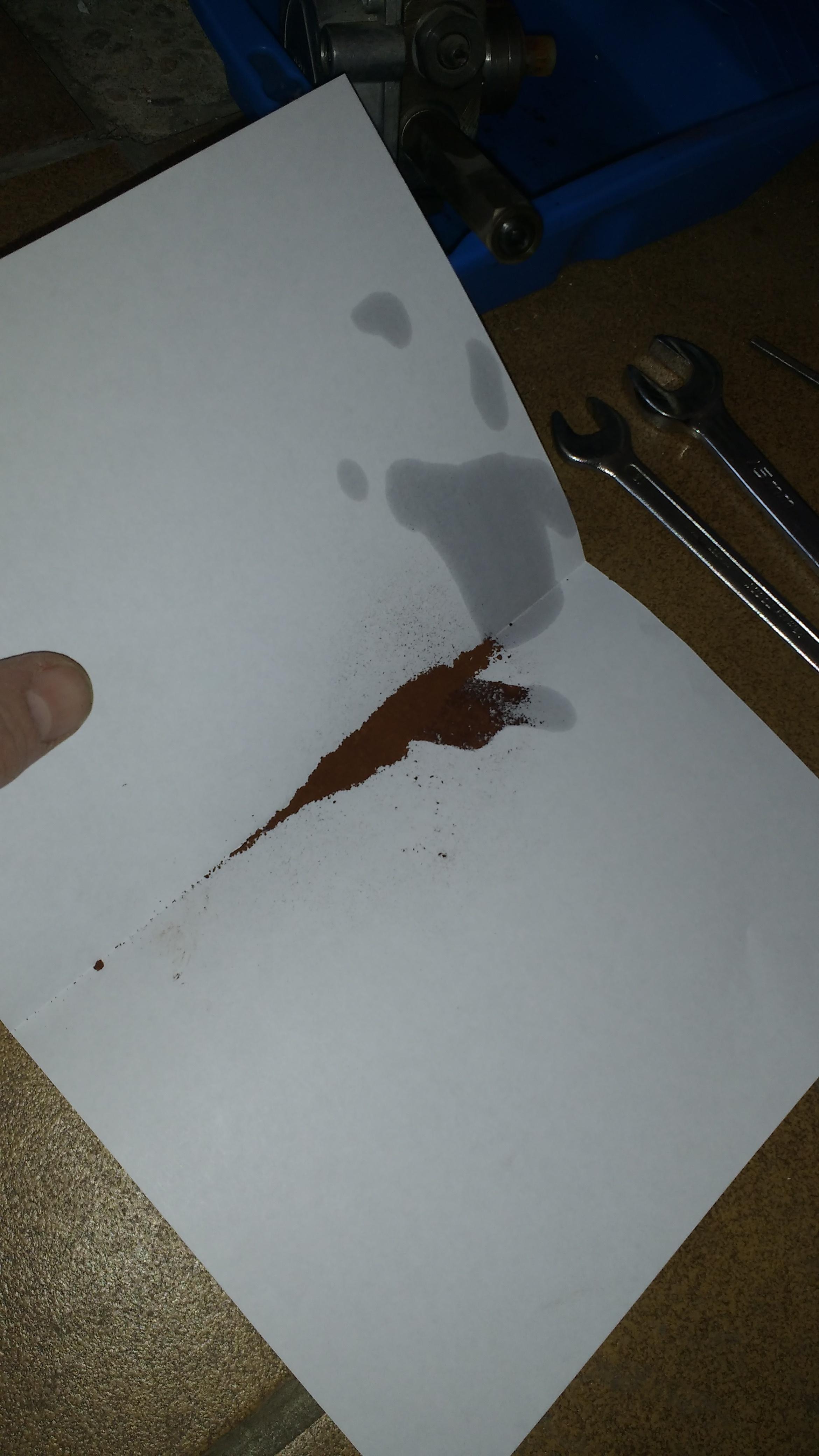

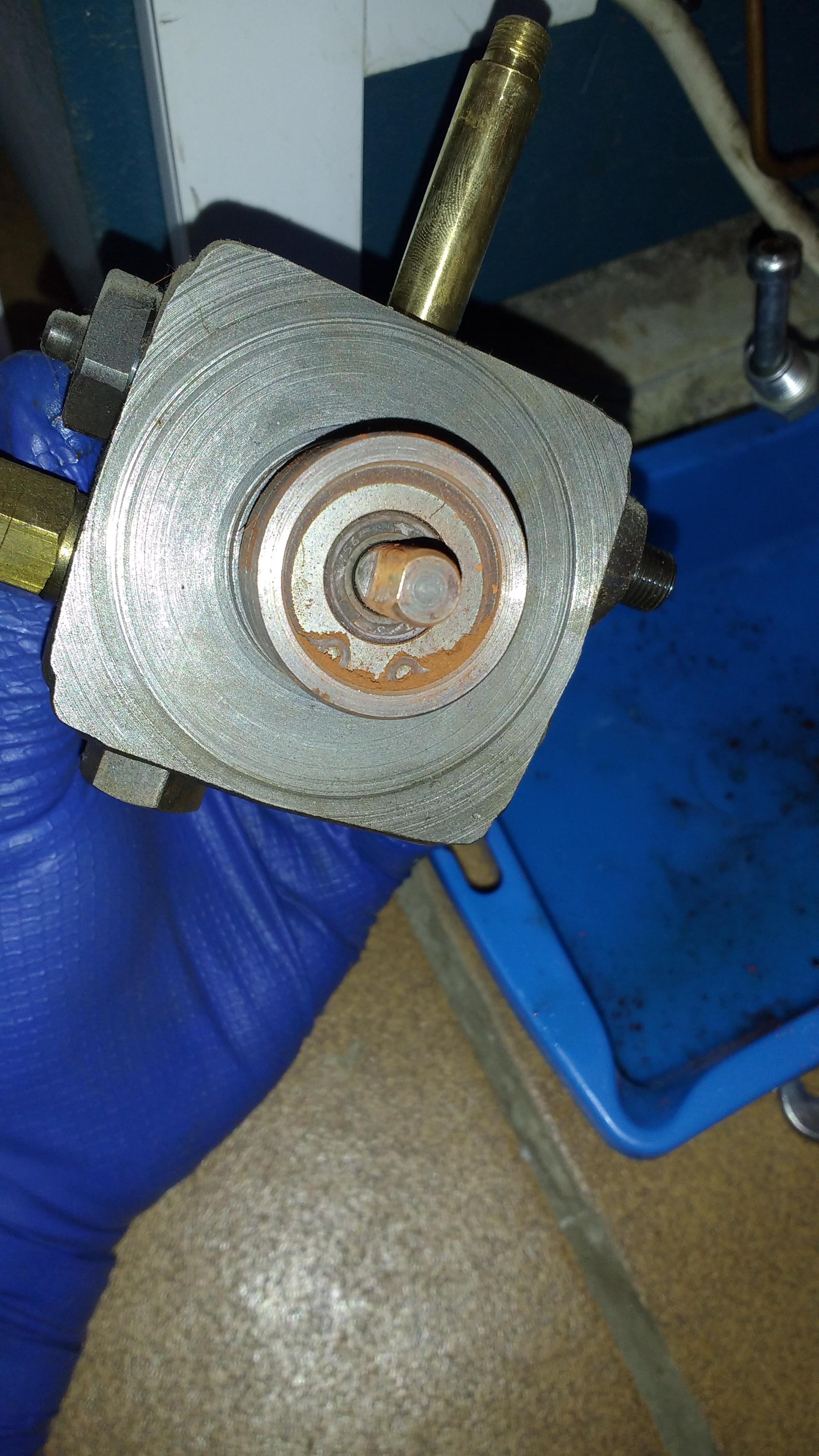

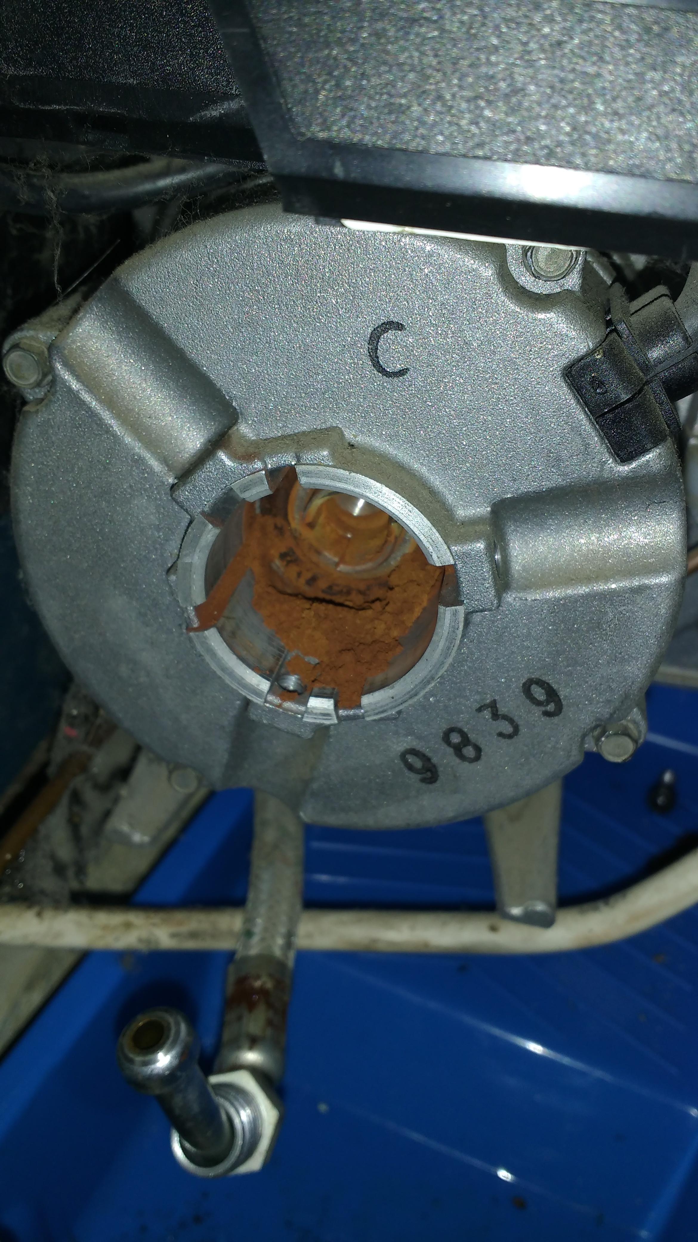

Some dry, powdery rust in there, quite a bit in fact.
No squealing when it runs. I've had the fan cover off and it turns as smooth as. Ditto if I stick my finger down where the pump engages.
The pump mind was as stiff as to turn!
I've brushed all the crap out, flushed the burner recess and pump bearing  out with penetrating oil, then stood the pump on end and filled the bearing with oil. Pump seems to turn pretty freely now. Hopefully this'll give me a bit of a reprieve.
Fingers crossed.
Coffee time while that oil soaks in. Why is it there's never a biscuit when I want one?
Edited by Onoff
that's a LOT of rust.
Pumps generally are stiff to turn as they have springs inside preloading bits. plus oil isn't compressible...

Been here 20 years and I changed the pump once in that time. Can't remember when. Going to put back together in a mo. Will report back.
