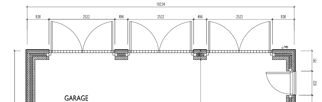

For various reasons we've had a time crunch and some pillars and the wall plate are going to go in the day before trusses. This makes me extremely nervous. The two pillars between the doors in the image below haven't been started. They are 140mm x 496mm and need to come up 2200mm. They then have a 90kg steel beam put on top to span over each doorway. The wall plate is then screwed to the top of the steel beams. On the rear there are some large lintels (1800 openings), but inner leaf masonry is already up to their bearings. That wall plate would be on mortar less than 24 hours old though.
Garage trusses are coming with house roof trusses. Each garage truss weighs 130kg as they are attic trusses (one is a double and weighs 260kg). There are 16 trusses giving a total weight of 2.2t. That means there will be about 330kg of truss load bearing onto each of the pillars. In some ways that's equivalent weight to building 90cm of blockwork above the beams I guess.
We lost some says last week and my brickie said he would come today but then cried off at 8pm last night. The trusses are coming on Tuesday. I see the following options:
  1. Crack on, it'll be fine. Advise on propping would be gratefully received.
  2. Delay truss install by a week, this would be house and garage. I'd be relaxed about this in the summer but with the weather we are racing to get watertight. Truss company can't delay by less than a week due to their schedule
  3. Rig something to store the garage trusses on site and then have a second day of crane (£500 + carpenter overhead)
  4. Something I haven't thought of
I'm gutted the pillars haven't been built as that in my mind is the key part. There is the shock loading and non vertical loading of installation to worry about as well.

I would delay a week and get it all up properly. I would be more concerned about putting the steel beam in place than the trusses - that needs to be done carefully and I wouldn’t want it onto green mortar especially 2.2m columns. They can’t be built in a day either as they will just rock over - are they a single block wide at the back ..??
The walls with the steel beams are 140mm inner leaf and have wind posts in the pillars. The walls at the back are cavity walls made of 100mm blockwork.

It's expensive. Even with rapid hardener your still relying on decent weather. A cold Day and frosty night is not what you want.
With a 150mm wide wall you have a small chance of getting the wall built in one go but it will be very wobbly until the beam holds it in place. If it's at all windy then no chance the pillars stay in place. What's the weather forecast.
Are the wind posts in place???
Is the truss company relying on your crane to unload the truss or can they unload them by hiab on the delivery lorry?? If they can unload them then still get them delivered on Tues and wait a few extra days.

So the garage is on a different stage ..?? But you need both up to wall plate at the same time for the roof..? Are you planning on roofing them both at the same time as assuming gable walls will need to be done, then that steel needs at least a week to set before you contemplate building anything off it. Garage lintels are notorious for twisting as they are unevenly loaded due to the shape of the gable.
I take it the rest of the corners and peaks are built and rock solid. If so rapid hardener in the mix, pray for a warm calm day and hope it sits in place. Your really rolling the dice though. Load the house up first and do the garage last but don't spread them. Let them sit there propped up till the house is done by the joiners. Should be at least a few days so maybe Fri or the Monday before they get to the garage by which time it should be solid.

Yes garage is on a separate payment schedule. I wanted them both ready for truss installation on the same day.
The garage gables are on the left and right of that image rather than the front of the garage where the doors are. The garage and house gables are going up after the chippie has done his truss work securing and bracing them in place.
