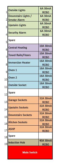

PeterW Posted January 22, 2017 Share Posted January 22, 2017 Chatting to the sparky about getting the layout of the circuits sorted and we've decided as previously it will be all RCBO. For an extra £30, is it worth splitting all of the circuits as below..? Bear in mind this is an all electric house which may in the future have solar installed (non-MCS) but only on a south westerly facing roof. Its a 3 bed house, all LED or low energy lighting. Induction hob in the kitchen and electric towel rails in 2 bathrooms along with upstairs electric tile warming (all centrally controlled) and ASHP for DHW and ground floor UFH. Immersion is for boost/legionella cycle. 1 Link to comment Share on other sites More sharing options...
dogman Posted January 22, 2017 Share Posted January 22, 2017 Oven? Link to comment Share on other sites More sharing options...
PeterW Posted January 22, 2017 Author Share Posted January 22, 2017 8 minutes ago, dogman said: Oven? Plugs in via kitchen socket..? Link to comment Share on other sites More sharing options...
dogman Posted January 22, 2017 Share Posted January 22, 2017 not enough juice needs 10mm cable at least( ps i am not an electrician so am prepared to be corrected) Link to comment Share on other sites More sharing options...
PeterW Posted January 22, 2017 Author Share Posted January 22, 2017 Hmm... just checked and it needs a 16A fixed connection - so thats interesting..! I know its not 10mm2 (that is on the hob circuit, or at least 6mm2 is from memory) but need a quick rethink..! Link to comment Share on other sites More sharing options...
ProDave Posted January 22, 2017 Share Posted January 22, 2017 Put the oven on it's own circuit as noted. Also make sure there are 2 or 3 spares ways in the CU, e.g. you might want an electric shower, and of course one for the solar PV. Mains drainage if not a circuit for the treatment plant. I have a broadly similar mix in a 20 way all rcbo board. 1 Link to comment Share on other sites More sharing options...
Declan52 Posted January 22, 2017 Share Posted January 22, 2017 Security alarm??? Link to comment Share on other sites More sharing options...
Steptoe Posted January 22, 2017 Share Posted January 22, 2017 Are you using Double Pole RCBOs, ? Oh, and I'd have the smoke alarms on with one of the lighting circuits, just a personal preference of mine. 1 Link to comment Share on other sites More sharing options...
Declan52 Posted January 22, 2017 Share Posted January 22, 2017 I split my downstairs sockets up into 3 areas. 1st was all the utility room, washing machine,dryer freezer. 2nd was the kitchen/sunroom, fridge dishwasher and sockets for kettles toaster and then TV unit plugs. 3rd was the rest of the downstairs, 1 TV computer few lamps. Link to comment Share on other sites More sharing options...
Ashburyselfbuild Posted January 22, 2017 Share Posted January 22, 2017 44 minutes ago, Steptoe said: Are you using Double Pole RCBOs, ? Oh, and I'd have the smoke alarms on with one of the lighting circuits, just a personal preference of mine. +1 for having the smoke alarms on one of the lighting circuits.If they are on there own, you may not notice if they trip. If they are off a lighting circuit you will soon notice. 1 Link to comment Share on other sites More sharing options...
Steptoe Posted January 22, 2017 Share Posted January 22, 2017 I'd also tend to split up the sockets more, perhaps 16 or 20 amp radials, and just use rings for the kitchen / utility areas, Rings are a dark ages legacy from when there was a copper shortage. Link to comment Share on other sites More sharing options...
Ferdinand Posted January 22, 2017 Share Posted January 22, 2017 1 hour ago, dogman said: not enough juice needs 10mm cable at least( ps i am not an electrician so am prepared to be corrected) There are some that can use 13A sockets. eg http://ao.com/product/oif22300x-beko-electric-single-oven-stainless-steel-16973-45.aspx Link to comment Share on other sites More sharing options...
Steptoe Posted January 22, 2017 Share Posted January 22, 2017 8 minutes ago, Ferdinand said: There are some that can use 13A sockets. eg http://ao.com/product/oif22300x-beko-electric-single-oven-stainless-steel-16973-45.aspx A heating appliance (which an oven is in effect) over 2KW should be on a dedicated circuit. Link to comment Share on other sites More sharing options...
Ferdinand Posted January 22, 2017 Share Posted January 22, 2017 Just now, Steptoe said: A heating appliance (which an oven is in effect) over 2KW should be on a dedicated circuit. I tend to agree. However... Link to comment Share on other sites More sharing options...

PeterW Posted January 22, 2017 Author Share Posted January 22, 2017 Right... plenty of food for thought ..!! @ProDave I had looked at a pair of 12/10 way units side by side which would give me spares. @Steptoe taking that point you made on smokes, I will include them on a light circuit and use the spare 6a for the alarm spur (as @Declan52 spotted I missed it..) Interested in the spur vs ring comment - doesn't that give issues on overloading ..?? Link to comment Share on other sites More sharing options...

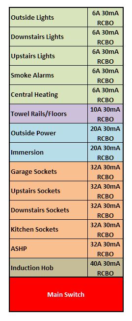

Nickfromwales Posted January 22, 2017 Share Posted January 22, 2017 Make the boiler feed a 16amp x 2.5mm2 radial and fuse down at the termination point. 6a is too close to the wind imo, with due consideration being given to future proofing. Pennies difference so better to do now. Link to comment Share on other sites More sharing options...
PeterW Posted January 22, 2017 Author Share Posted January 22, 2017 30 minutes ago, Nickfromwales said: Make the boiler feed a 16amp x 2.5mm2 radial and fuse down at the termination point. 6a is too close to the wind imo, with due consideration being given to future proofing. Why.........?? Not that I'm doubting you, it's just the only thing going on it is a time clock and a pump for the ASHP... Link to comment Share on other sites More sharing options...
Nickfromwales Posted January 22, 2017 Share Posted January 22, 2017 Any radials for fixed equipment I've ever put in have always been on either a 16a or a 20a breaker / rcbo and in 2.5mm2. The derating always got done at the termination point eg fused spur. There you select the fuse rating accordingly for the connected equipment. My choice here would be to install it so you can hook anything up later without worrying about loading. Fwiw I've never run a radial less than aforementioned, only ever deviating when it's outside lighting etc where I use 6a or 10a accordingly. Just can't see any point in running such a low powered radial unless you plan to run 2.5mm2 anyway ( which would leave you the option to upsize the breaker later on if so required ). I'm a bit old school that way tbh, but that's how I got taught as an apprentice spark with SWALEC. If your 101% sure it'll never be needed then take what I say with a pinch, but better to put it in now than later. Remember that you'll need a fused spur or a socket anyway ( so as to get localised fused connection at the termination point ) so not much more money tbh. 1 Link to comment Share on other sites More sharing options...
Steptoe Posted January 22, 2017 Share Posted January 22, 2017 I'd agree with @Nickfromwales Its the same amount of labour, and not much more expense, If you do decide on a socket, remember it must be UNswitched, Personally I have my boiler on a plug and socket, if there is a power cut I can plug it into the Genny so at least I still have heat. Link to comment Share on other sites More sharing options...
PeterW Posted January 22, 2017 Author Share Posted January 22, 2017 2 hours ago, Ferdinand said: The obvious things missing that would be added are an external socket, and electric gates. So I had an outside socket and typed over it by the looks of it - wondered what was missing !! Gates are from a separate supply as the main meter box is at the gates along with a modified meter box (including a lock...) containing a new IP65 consumer unit with a gate and a driveway light supply. Link to comment Share on other sites More sharing options...
PeterW Posted January 22, 2017 Author Share Posted January 22, 2017 Right... had a quick rework and based on a 21 way unit I've ended up here.. Just so we are aware, that boiler run is about 4 ft in the same room btw as this is all in the plant "cupboard"... 1 Link to comment Share on other sites More sharing options...
Steptoe Posted January 22, 2017 Share Posted January 22, 2017 (edited) Personally, Bedrooms on 2x 16a radials, Living room on a 16a radial, garage, C32, (what about that welder?) Smoke alarms with U/S lights ASHP prob needs a C as well Be careful on your selection between Bs and Cs, makes a big difference. Just a thought, Edited January 22, 2017 by Steptoe 2 Link to comment Share on other sites More sharing options...
