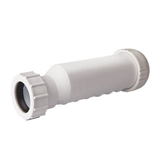

Onoff Posted January 22, 2017 Posted January 22, 2017 There's not a thing that doesn't need attention here that's for sure! The pipes were previously supported by blue baling string. That's the wc overflow coming vertically down. The smaller waste running under the dormer goes for about 8' unsupported so has a big bow in it. All under a glued chipboard floor. Going to gut the whole room, walls, floor and ceiling. Back on topic, these were the self sealing waste valves I mentioned above. Wondering if a good idea on a waste that goes into a soil pipe? http://www.screwfix.com/p/osma-waste-valve-white-x/1819K?kpid=KINASEKPID&cm_mmc=GoogleLocal-_-Datafeed-_-Heating and Plumbing&cm_mmc=Google-_-Product Listing Ads-_-Sales Tracking-_-sales tracking url&gclid=CI3U8ICo1tECFQgq0wodDwMJ9g
Temp Posted January 23, 2017 Posted January 23, 2017 Looks like they have a thing like a plastic bag inside that forms the one way valve? Seems like an ideal place for stuff to get bunged up.
Bitpipe Posted January 23, 2017 Posted January 23, 2017 Ah, the infamous 'Fanny Trap' as my plumbers called it. Correct name is a HepVo I believe. We looked into these when we realised that there was not enough clearance under the floor standing baths (on freshly tiled floors) for a normal trap. Decided against using them as when horizontal, they can get fouled with hair etc and will then allow smells back. Plumber was happier using them vertically. We ended chopping a nice hole in the floor to take a traditional trap for each bath.
Temp Posted January 23, 2017 Posted January 23, 2017 Now that you mention it, it does look a bit like one of those devices used to collect a sample from a horse.
ProDave Posted January 23, 2017 Posted January 23, 2017 That Hepvo unit is a "waterless trap" It allows something like an unvented HW tank blow off to be routed into a stack pipe (with certain strict conditions on what pipe to use). You cannot use a normal wet trap for that sort of application, as there is normally no water to keep the trap filled so it would evaporate and dry out. I will almost certainly be using one to avoid having to take the drain pipe outside.
Onoff Posted January 23, 2017 Posted January 23, 2017 My wife & daughter shed hair like Cousin It so maybe I should avoid? I just like the idea they might protect against soil effluent coming back up into the shower if I dumped the shower waste into the soil via a boss.
PeterW Posted January 23, 2017 Posted January 23, 2017 2 hours ago, Onoff said: My wife & daughter shed hair like Cousin It so maybe I should avoid? I just like the idea they might protect against soil effluent coming back up into the shower if I dumped the shower waste into the soil via a boss. Wirquin have brought out a waterless shower trap that has a removable filter and can all be serviced from the top - worth a look as it's the best of both worlds.
