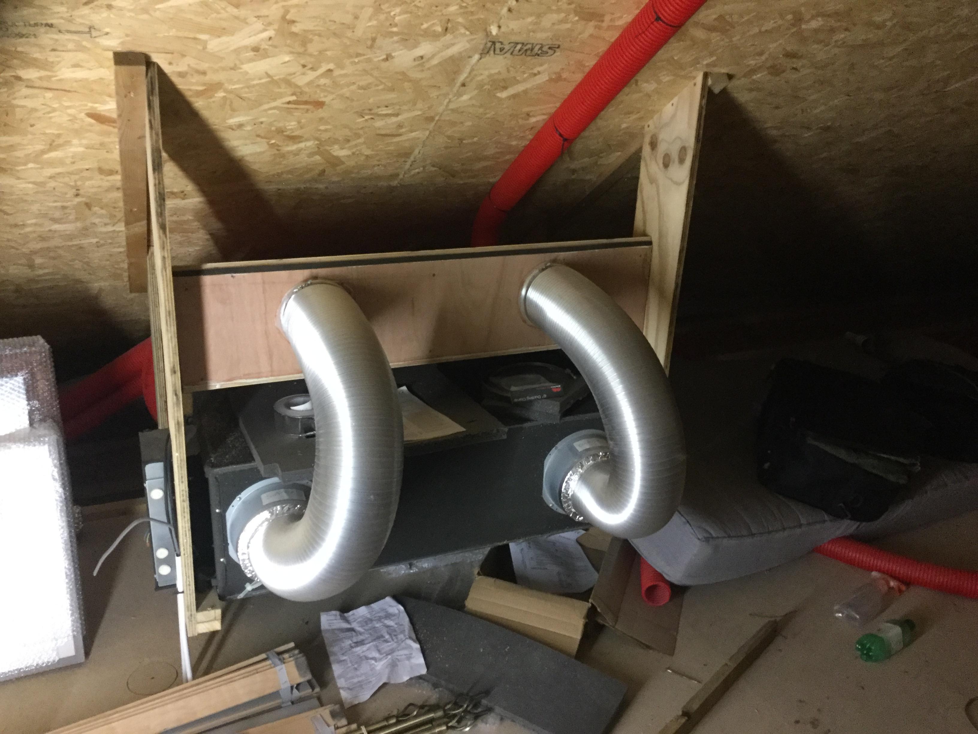

joe90 Posted November 19, 2020 Share Posted November 19, 2020 On 14/11/2020 at 16:38, BartW said: The noise element (I hope) should not be an issue with our build, as I am hoping to cleverly install it in the loft storage area. I did this, hung it from the roof trusses, not on the bedroom ceilings, mounted on rubber feet. NO noise in the house apart from air whoosh when on boost. 2 Link to comment Share on other sites More sharing options...
