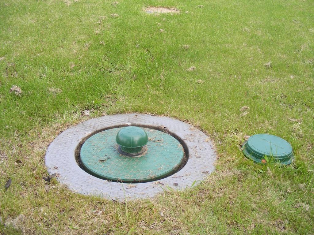

ProDave Posted November 17, 2020 Share Posted November 17, 2020 13 hours ago, Bart1664 said: Hi ProDave Which model Condor do you have please? Pro's and con's? Thanks ASP6 Here it is going into the ground One thing I liked compared to some others is the legs for it to stand on when you lower it in the hole,. and that "ring" around the base, you concrete in to above that level to anchor it into the ground. And this is what it looks like all finished. The big green lid with the vent is the housing for the blower pump. the small screw on green lid at the right is where you insert the hose to pump it out. 2 Link to comment Share on other sites More sharing options...

Bart1664 Posted November 17, 2020 Share Posted November 17, 2020 @ProDave How much noise does the blower vent thing make? acceptable/barely notice it unless you stand next to it? Link to comment Share on other sites More sharing options...
