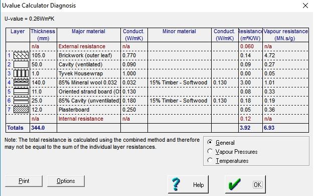

A_L Posted November 10, 2020 Posted November 10, 2020 32 minutes ago, Dodgy-diver said: im trying to find out what thickness of Celotex or similar I need If a new build in England allowing for a 15% timber fraction you need 120mm of PIR (U=0.295), ignoring any other fabric layers. There are variations in Scotland and I think in Wales.

A_L Posted November 10, 2020 Posted November 10, 2020 @Dodgy-diver, here is a solution using Frametherm32, U=0.26 https://www.buildingmaterials.co.uk/knauf-earthwool-frametherm-roll-32?ps=MjA5PTgxMDgmMzY2PTEwMzYyJjM3MT0xMDU1NCY0MzE9MTU3NTI=&gclid=EAIaIQobChMIg4z05df47AIVDO7tCh35nwObEAQYASABEgIOGfD_BwE&gclsrc=aw.ds#209=8108&366=10362&371=10554&431=15752infinity=ict2~net~gaw~ar~441793144077~kw~~mt~~cmp~Shopping_Smart+Shopping_Insulation_All~ag~Insulation+Only

Thorfun Posted November 11, 2020 Posted November 11, 2020 18 hours ago, A_L said: @Dodgy-diver, here is a solution using Frametherm32, U=0.26 https://www.buildingmaterials.co.uk/knauf-earthwool-frametherm-roll-32?ps=MjA5PTgxMDgmMzY2PTEwMzYyJjM3MT0xMDU1NCY0MzE9MTU3NTI=&gclid=EAIaIQobChMIg4z05df47AIVDO7tCh35nwObEAQYASABEgIOGfD_BwE&gclsrc=aw.ds#209=8108&366=10362&371=10554&431=15752infinity=ict2~net~gaw~ar~441793144077~kw~~mt~~cmp~Shopping_Smart+Shopping_Insulation_All~ag~Insulation+Only @A_L what software is that? I've been using https://www.changeplan.co.uk/u_value_calculator.php which seems to work but the software you're using looks very interesting
A_L Posted November 11, 2020 Posted November 11, 2020 2 hours ago, Thorfun said: what software is that? It is part of a package (NHER Evaluator) which was state of the art 2000-2010 but is no longer publically available. 1
Gone West Posted November 11, 2020 Posted November 11, 2020 I used BuildDeskU which I managed to download on two occasions each for 30 days free. It had a similar looking output but I used it in 2009. http://www.builddesk.co.uk/software/builddesk-u/download-builddesk-u/ 1
