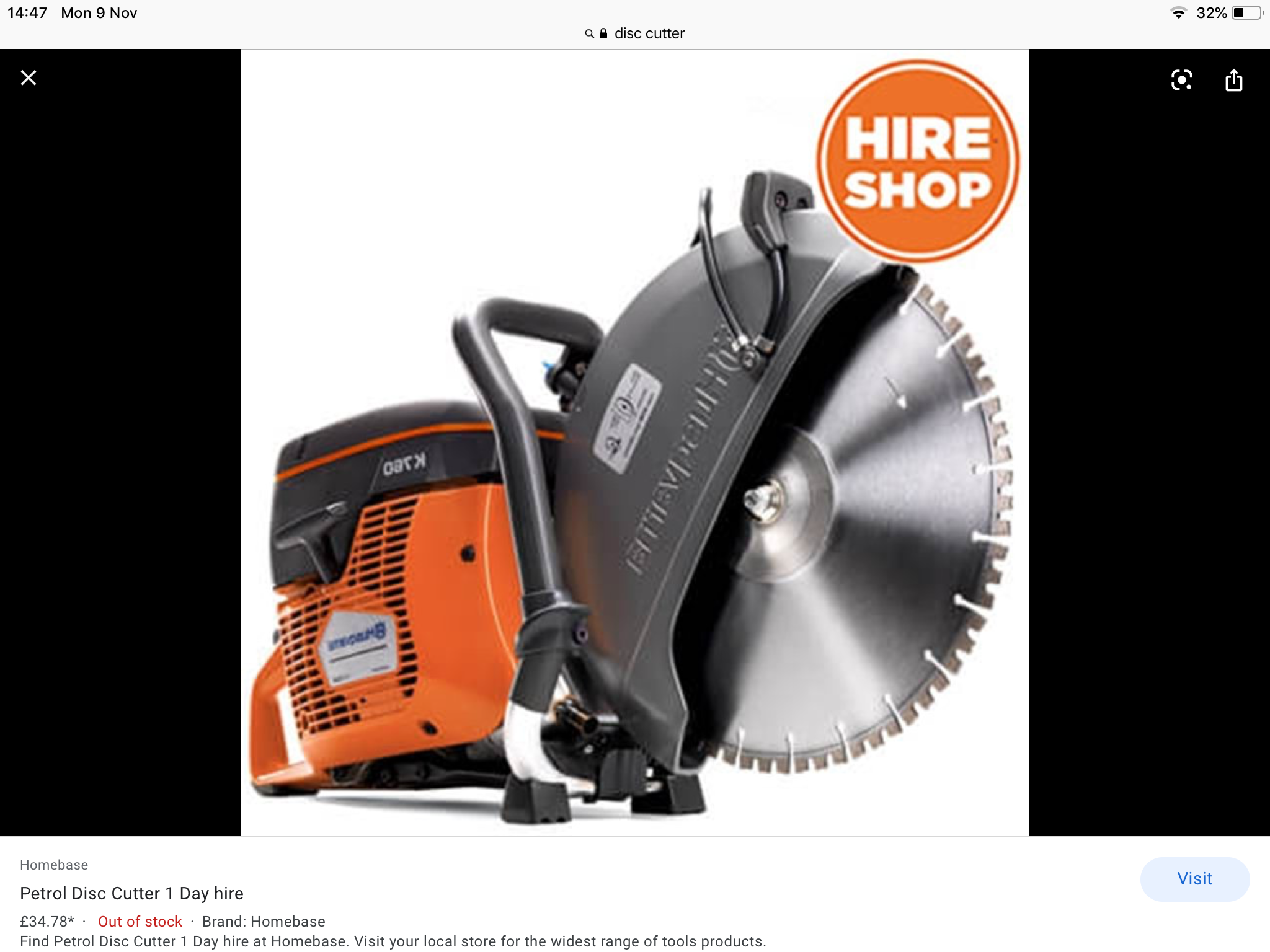

Russell griffiths Posted November 9, 2020 Share Posted November 9, 2020 thank me later. Link to comment Share on other sites More sharing options...
