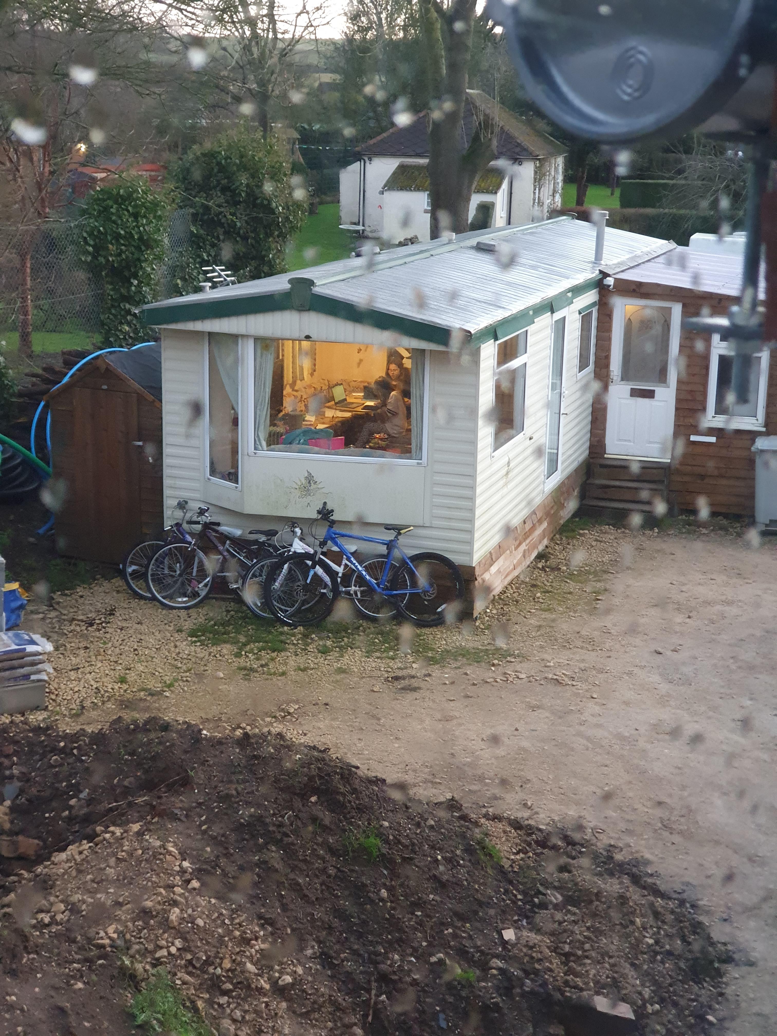

LA3222 Posted October 22, 2021 Posted October 22, 2021 I too am a van dweller, 32ft x 10ft, 2 berth with missus, 2 kids and 2 cats. 2.5 yrs in now, summers are far far worse than winter. It's easy to get warm in a van, nigh on impossible to cool the thing down, apart from that it's easy, just like a small flat tbh. I built a lean to next to mine, got a tall fridge freezer in, washing machine and tumble dryer as well as shelves and drawers for extra storage. I'd recommend spending a little money to do the same, it will make a massive difference to van life, cost me about £600 in materials. 1
