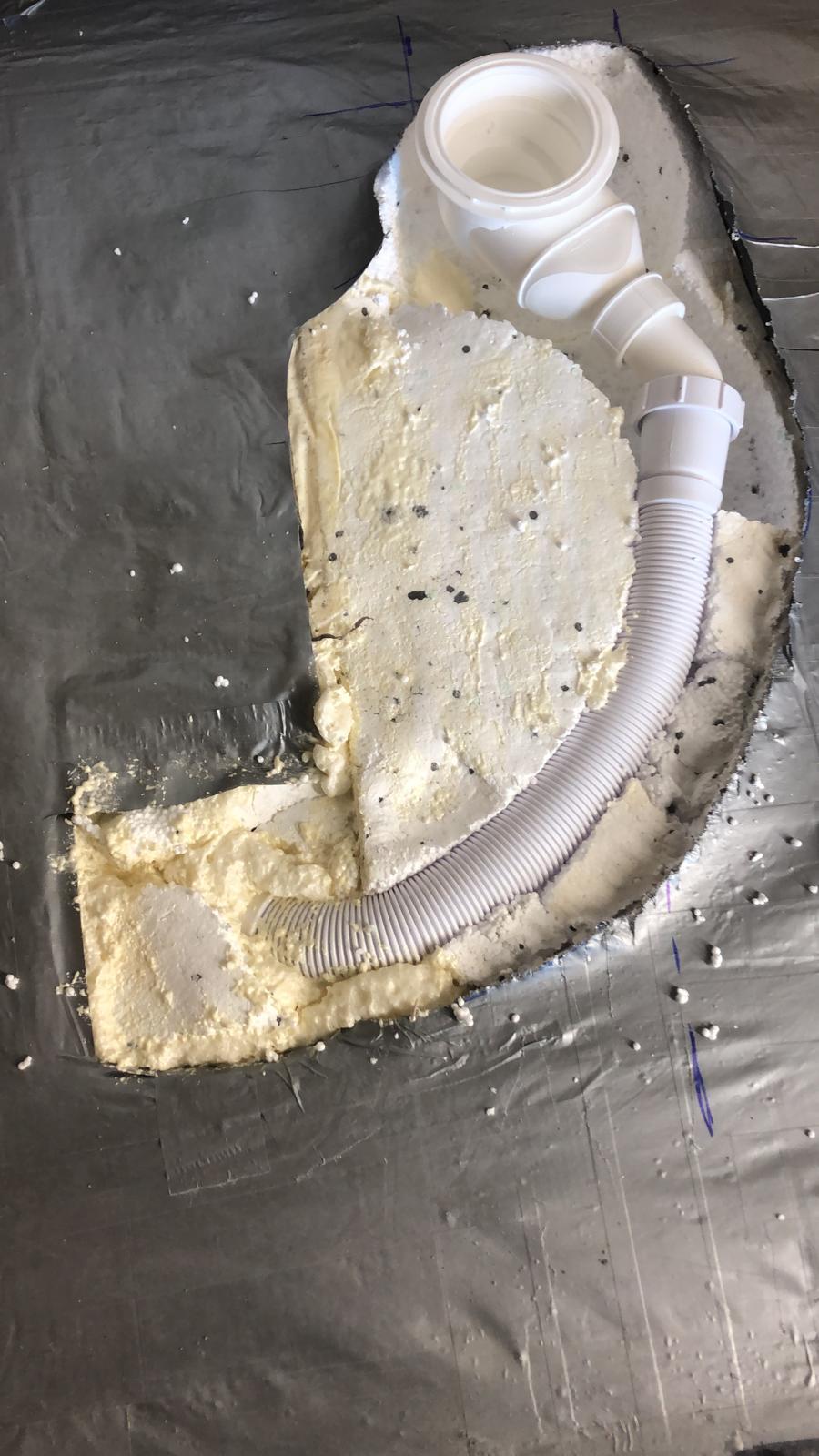

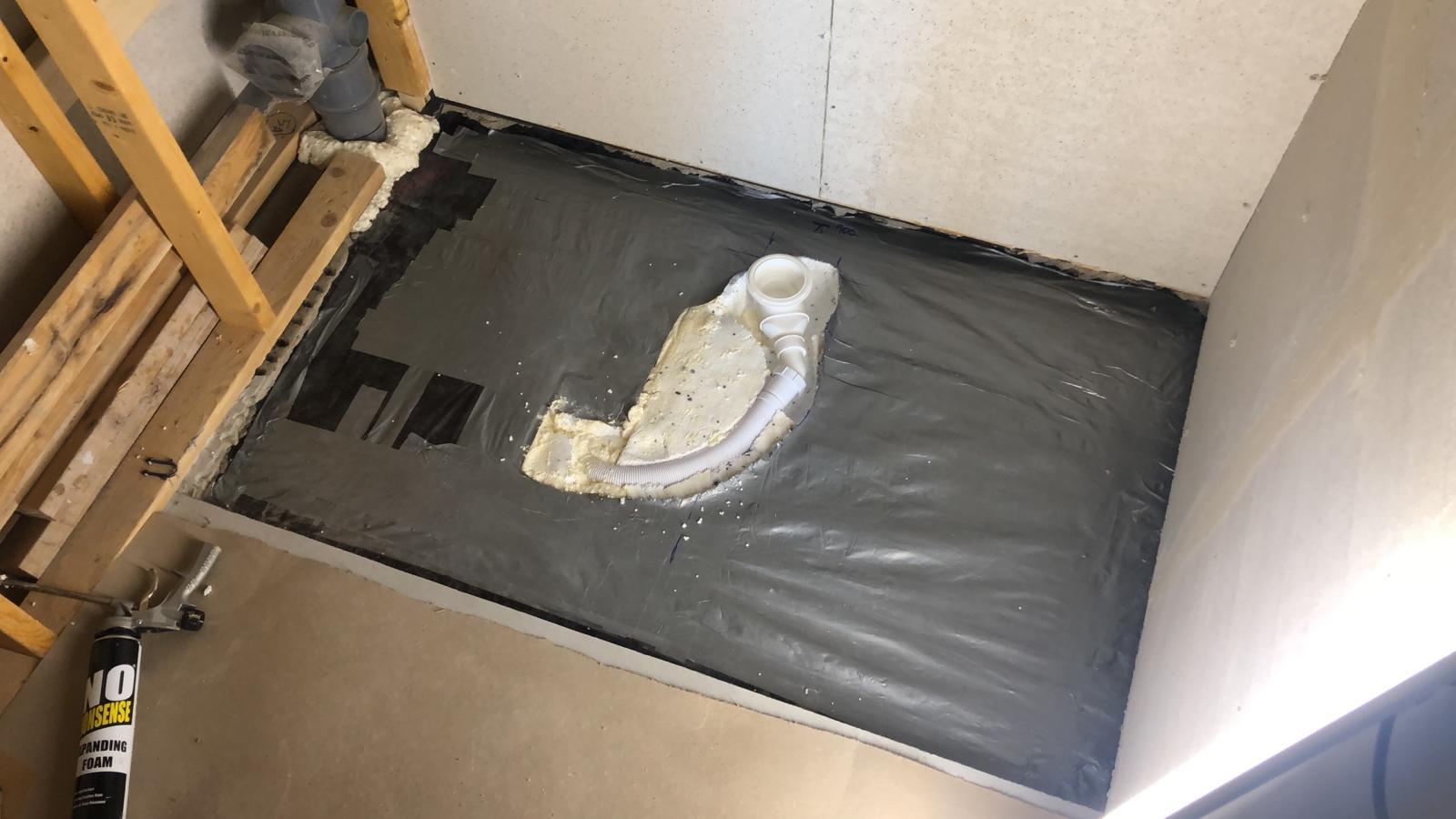

Nickfromwales Posted October 27, 2020 Posted October 27, 2020 The most recent one I did was the following; Cut out DPM, cut out insulation, foam insulation to block and beam, weigh down until cured. Then apply foam to top of upper insulation and spread DPM back on top until all in contact and keep doing so whilst foam cures so the DPM is bonded to the insulation. You could make a plywood baffle and weigh down if easier. ( Note, obvious waste connections done in parallel to these processes ). Then reinstate DPM and tape it up to death and back. Tray then simply laid onto plywood pattresses which were foam bonded to the DPM and then flexible tile adhesive onto those pattresses and tray onto that ( cleaning and preparation of the underside of the tray carried out as required ). Tray set into place and tile adhesive left for an hour or two to cure. Cardboard funnel then made and self levelling compound flooded into the remaining void under the tray ( nearly 2 bags in this instance ) to a) fully fill the void and leave the tray ‘locked in’ at all 4 corners and all 4 sides, and b) to mechanically support the trap ( which is best practice imho ).

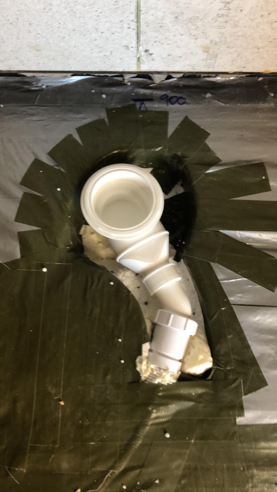

andy Posted May 16, 2021 Posted May 16, 2021 On 27/10/2020 at 14:06, Nickfromwales said: Other option could be to use Wedi insulated panels, which you can build up in layers of differing thicknesses, to achieve the same result. DPM will remain intact as the Wedi system is watertight. Just foam around edges then, instead of pouring SLC as the SLC would bridge damp. Right, it's about time I did some shower trays @Nickfromwales! I'm fed up of just having a bath... Thinking of Wedi Fundo Plano to keep depth as low as possible. I will need to put some sort of mix underneath the trays to get the correct height, is this normally done using a 3:1 dry mix? That would seem to be the easiest to tweak to get the levels bang on but has anyone else got experience of these Wedi trays?

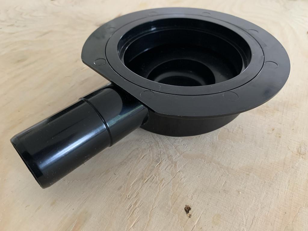

andy Posted July 31, 2021 Posted July 31, 2021 On 18/05/2021 at 17:47, Nickfromwales said: Any pics? Can't you just fit a strap on boss onto the soil stack? OK, so not the speediest reply @Nickfromwales but you know how it is, building a house and all that So for good or bad I went down the Wedi route and the next challenge is to join a 40mm ABS (or 45mm depending upon if I trim the pipe back or not) to a 40mm solvent weld. I have got a McAlpine T28M which would work fine but the knuckle would nessecitate cutting into the bottom of the Wedi base... I think if I cut it back to the thicker section then it's about the same fit as solvent weld but what can I weld them with? The whole assemly will be filled with a 5:1 dry mix so it has to be 100% before the tray goes down. See the pic of the trap.
Nickfromwales Posted August 2, 2021 Posted August 2, 2021 You cannot solvent weld onto that fitting. It would either be a push fit manufacturer supplied connector or a compression fitting as you have mentioned. IIRC the Wedi formers have a metal ring on the underside, and there is supposed to be a chunky compression rubber seal ( usually supplied with the waste ) that separates the top of the part above from the underside of the tray a little. Do you have one?
