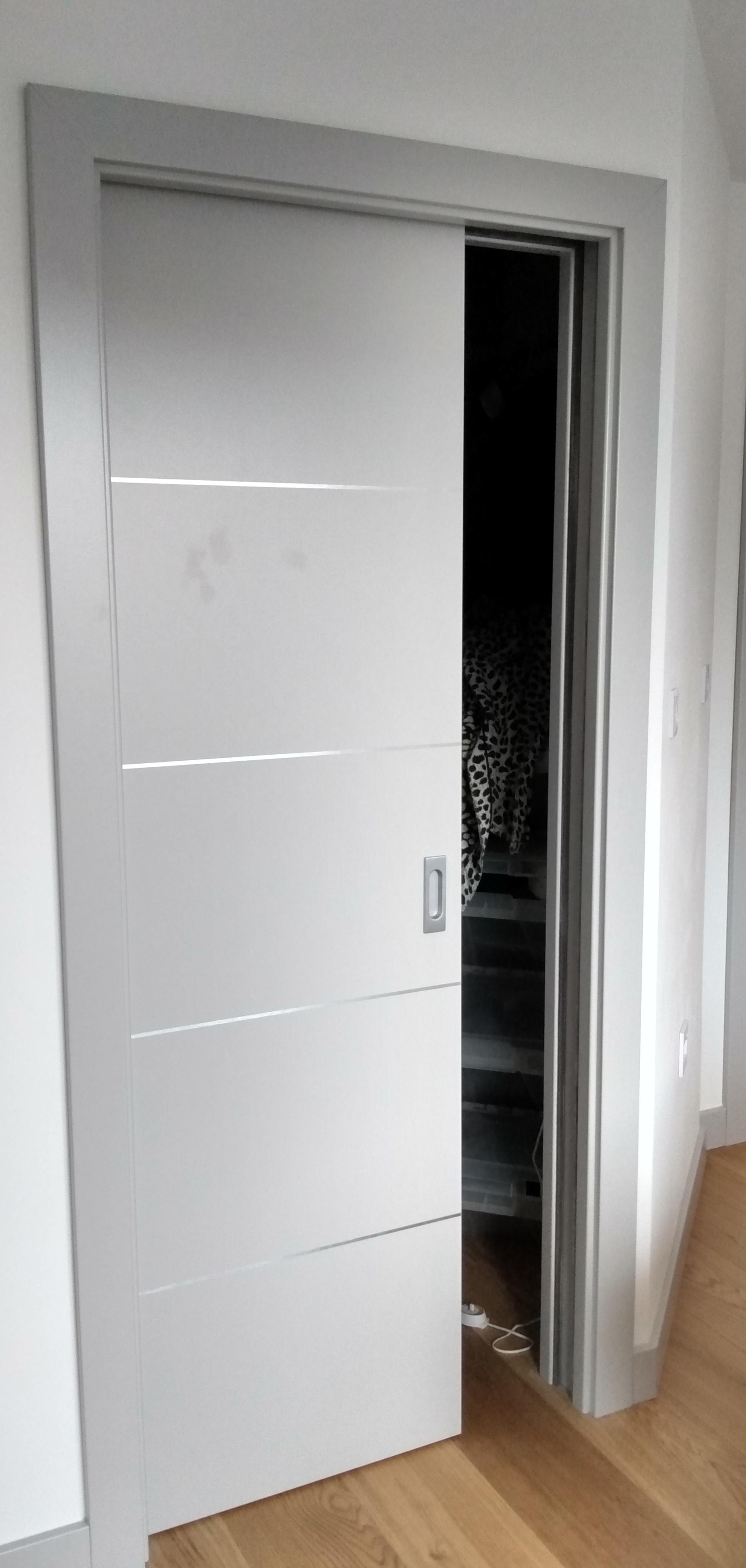

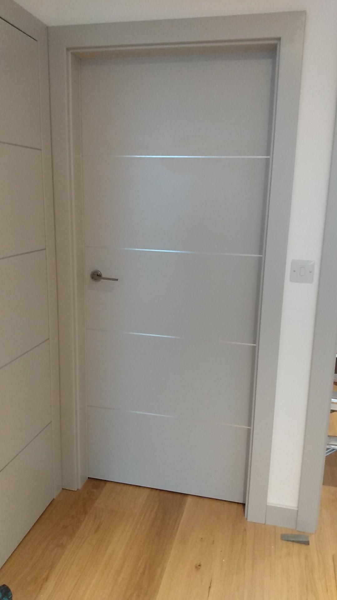

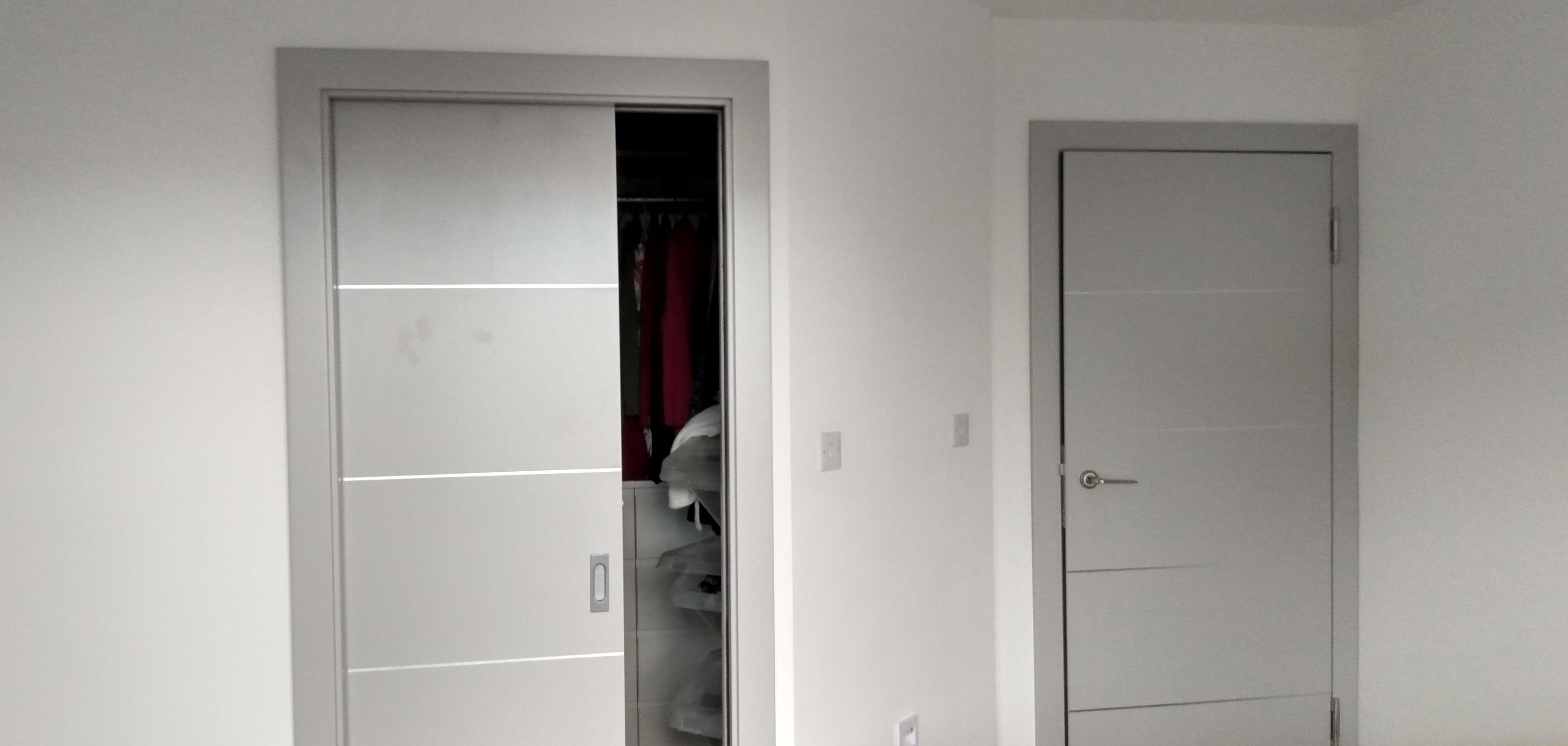

Posted
We are fitting them at the moment !! We had one pocket door  fitted into an Eclise frame  as it was already fitted. That worked  really well . We have a mixture of non FD and fd30  - the fire doors are really heavy !
Generally the fitting  has been fine- we are not expert carpenters. A couple needed a small trim off the bottom. Hinges and handles  are great. the TEV  team have been very helpful on the phone if we had any questions
We also got the skirting board to match  from them  it is slightly shorter lengths 2.4 metres .
