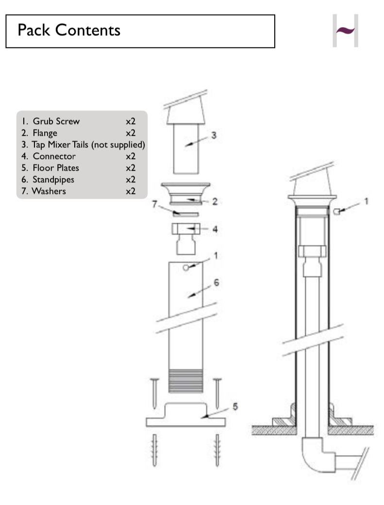

PeterW Posted October 24, 2020 Posted October 24, 2020 (edited) 14 minutes ago, pocster said: Are you sure ?????? . So water flows up the shroud ?? . But there’s zero thread at the base of the shroud - that can’t be right ?!?!?!? . Photos etc. later when on site . Appreciated .... the shroud is probably something like 1.5mm stainless or chromed pipe - perfectly suitable for water to go through. Alternative is they are something like this ..? They need a copper pipe up the middle. https://www.screwfix.com/p/watersmith-heritage-bath-standpipes/3166P If it looks like it’s welded or seamed clothes rail then they may have fobbed you off with something else though ... Edited October 24, 2020 by PeterW Deleted a line by accident..!
Pocster Posted October 24, 2020 Author Posted October 24, 2020 3 minutes ago, PeterW said: the shroud is probably something like 1.5mm stainless or chromed pipe - perfectly suitable for water to go through. Alternative is they are something like this ..? They need a copper pipe up the middle. https://www.screwfix.com/p/watersmith-heritage-bath-standpipes/3166P If it looks like it’s welded or seamed clothes rail then they may have fobbed you off with something else though ... It’s exactly like that - but how an earth do you fit a water supply to the end of the shroud ???
PeterW Posted October 24, 2020 Posted October 24, 2020 Ok ... is it a Watersmith one ..? Should be a pack of fitting with it, got a tap connector plus other bits ..? Should go together like this ..
Pocster Posted October 24, 2020 Author Posted October 24, 2020 3 minutes ago, PeterW said: Ok ... is it a Watersmith one ..? Should be a pack of fitting with it, got a tap connector plus other bits ..? Should go together like this .. Nope ! Nothing at all like that . Shroud connects to taps that it ?

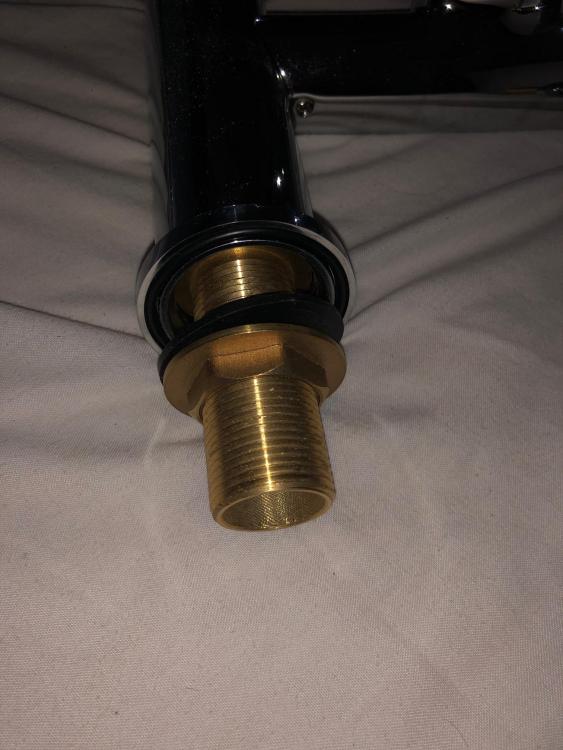

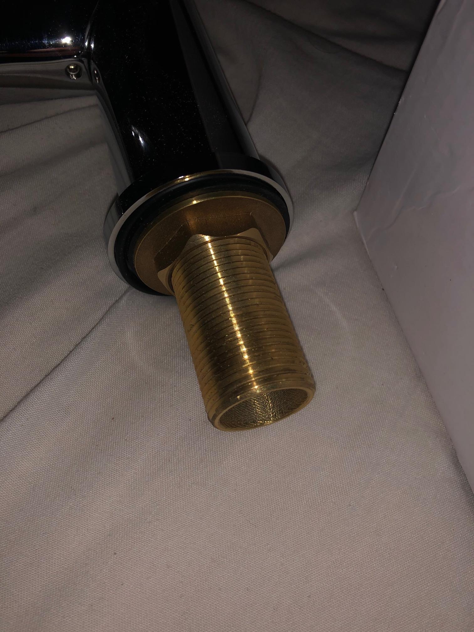

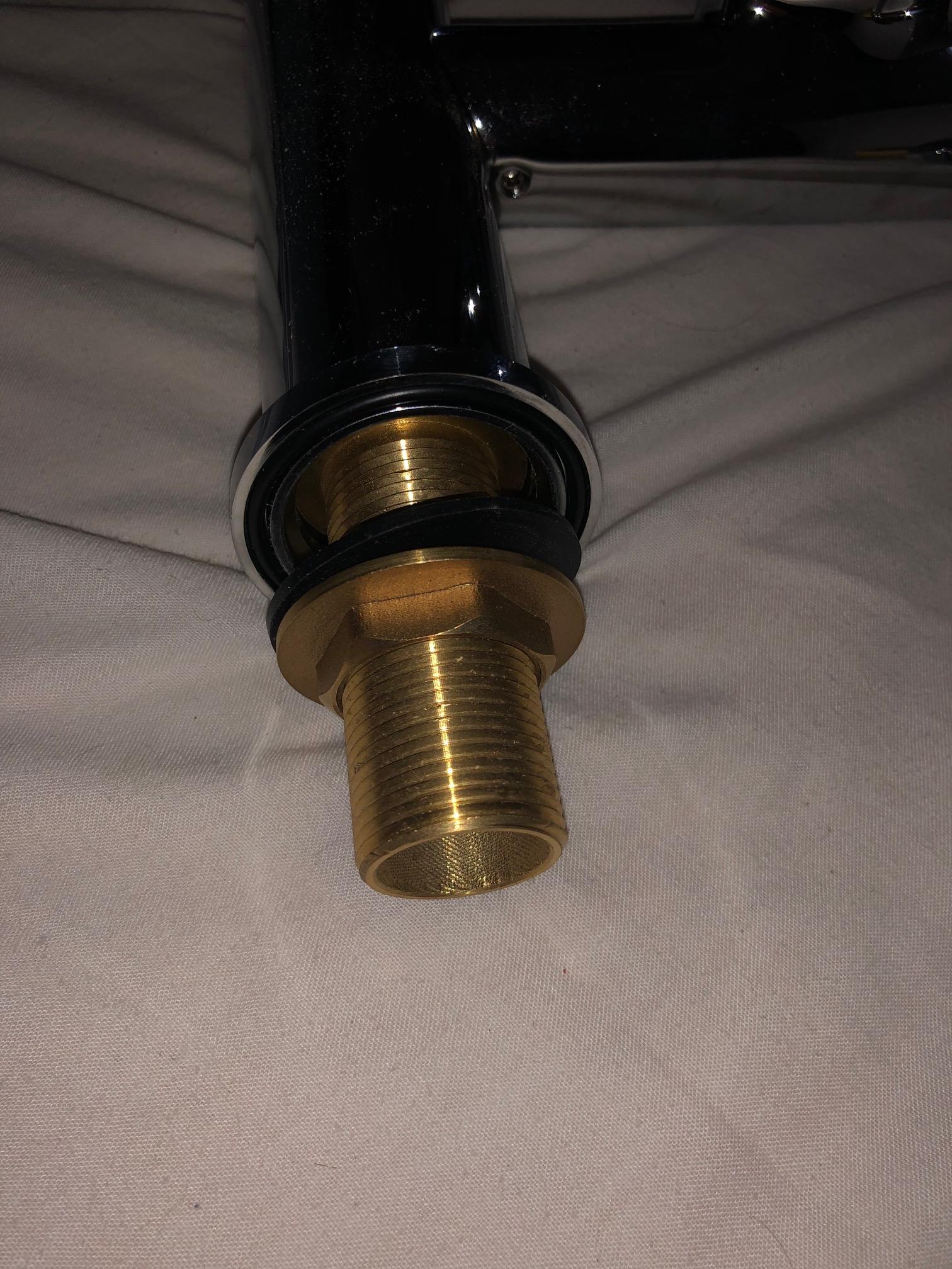

Pocster Posted October 30, 2020 Author Posted October 30, 2020 Hmmmmmm, I'm still confused. The shroud screws up over the thread. So a compression fitting just goes in the tap pipe end????
ProDave Posted October 30, 2020 Posted October 30, 2020 And even if you get the pipe shrouds to work, how are you going to connect the waste pop up mechanism without it looking naff? you should have bought a floor mounting bath filler if that is what you wanted? EDIT: Even more confused. the instructions posted are for a different tap to the picture of part of a tap posted.
Pocster Posted October 30, 2020 Author Posted October 30, 2020 12 minutes ago, ProDave said: And even if you get the pipe shrouds to work, how are you going to connect the waste pop up mechanism without it looking naff? you should have bought a floor mounting bath filler if that is what you wanted? EDIT: Even more confused. the instructions posted are for a different tap to the picture of part of a tap posted. Not looked at the waste mechanism . The instructions come with a multitude of install options. This was sold as a floor mounted bath filler i.e. in the showroom the 'deck' taps are on the shrouds. Haven't got the bath yet - so that's a separate issue. I think I need to look at the shrouds again next time on site. I *assumed* you just screw a compression joint onto that thread - then run a pipe ( copper/hep2o whatever ) down inside the shroud.....

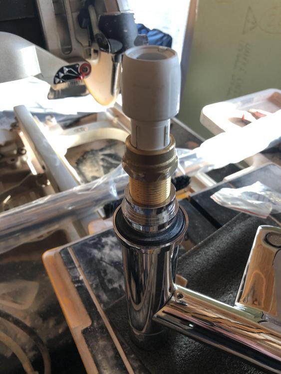

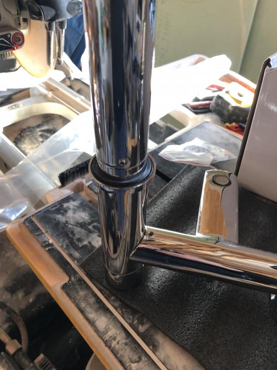

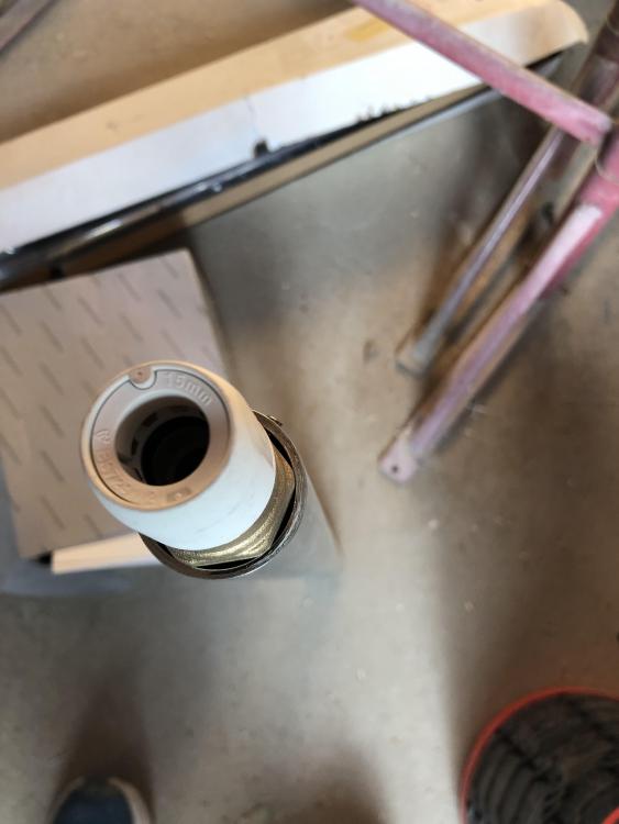

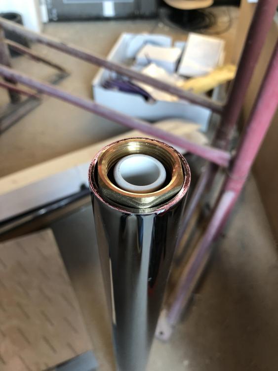

ProDave Posted October 30, 2020 Posted October 30, 2020 Take a picture of the shroud offered up to the bottom of the tap, and a picture of the bottom end of the shroud If the shroud has a female thread that screws onto the bottom of the tap, then there is no way you can connect another pipe to the tap and run it up the inside. 1
Pocster Posted October 30, 2020 Author Posted October 30, 2020 21 minutes ago, ProDave said: Take a picture of the shroud offered up to the bottom of the tap, and a picture of the bottom end of the shroud If the shroud has a female thread that screws onto the bottom of the tap, then there is no way you can connect another pipe to the tap and run it up the inside. Yes ! This is what I think I discovered!!! Will grab photos of the shrouds tomorrow.
Pocster Posted October 30, 2020 Author Posted October 30, 2020 Now I’m sat here thinking if I’ve been a k n o b . Please no-one quote that and answer yes ! Is it possible I had the shroud pipe up the wrong way ? . So the shroud threaded end goes into whatever bolts it to the floor . The non threaded end goes upto the tap - leaving the tap thread free for a connection . It’s possible . I only looked at them once ... Erm , amateur error !! maybe ..... ??
