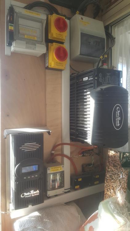

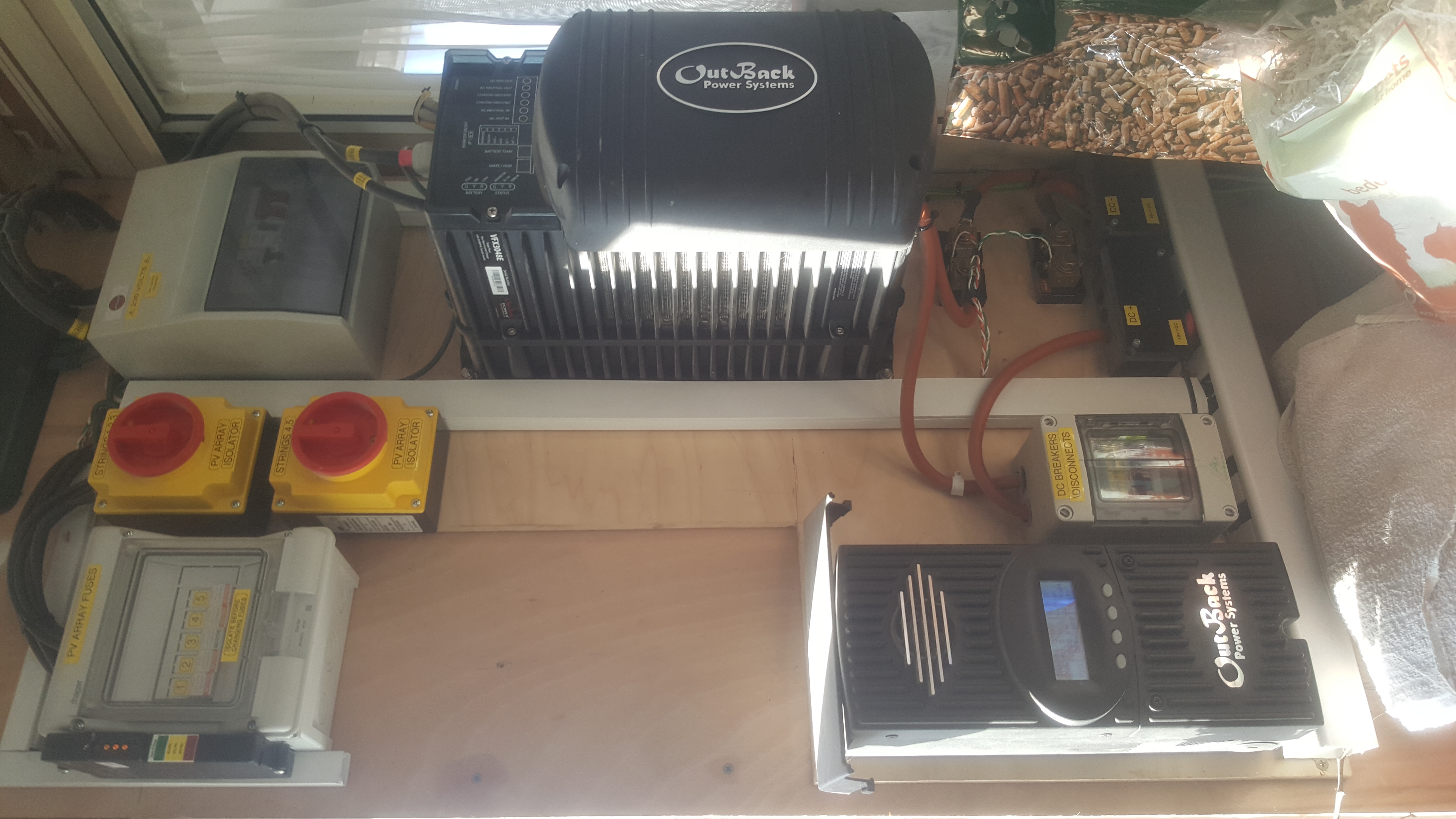

readiescards Posted January 19, 2017 Share Posted January 19, 2017 On 18/01/2017 at 10:09, Nickfromwales said: @readiescards has ventured down this path . He's going off grid. Maybe some leads / links paul ? As @Nickfromwales says yes I'm going off-grid. I've spent at least 18months investigating this option and asking a zillion questions of many potential suppliers and been to various green energy shows. In that 18 months things have changed in the battery world. Lots of research money going into batteries so what is best today might be old hat tomorrow, potentially a lot of space and weight. My thoughts on batteries: * Lithium - the new 2170 Lithium cell from the Tesla gigafactory and Samsung and others I think will reduce Lithium storage costs considerable in the future as they come online. This is to be in the Tesla Powerwall 2. Tesla say the Powerwall2 is suitable for off-grid and comes with a 10 year warranty. Only trouble is it needs an extra 'backup' module that they have not yet finished designing (due late Spring 2017). Lithium has the advantage of a faster rate of charge than lead acid - so when the sun is shinning you get to gather more. Lithium costs more but is supposed to have 3 times the life of lead acid some claim. Lots of companies entering this market Sonnen from Germany being another. * Aquion salt water batteries - they told me they expect to release a newer model in next few months. The current one version 2 has a better charge/discharge rate over version 1 (version 1 still for sale in UK though) but still not very good so you need tonnes of them. * Redflow ZBM - interesting option but not in common use in UK so decided to keep away from * NiFe batteries - much longer life than Lead Acid * Gel sealed for life lead acid - supposedly less life than non-sealed * lead acid - Rolls seem the most recommended - might need water monitoring, has a scrap value too I'm ether going for bleeding edge Tesla Powerwall2 or tried and tested lead acid Rolls with a Victron Quattro or Multiplus invertor/charge controller - got to make that decision in next couple of months! I'll have 8.8kWpe and of course a shitty old dirty (to quote @Nickfromwales ) diesel generator, LPG gas cooker & oven and an electric kettle for sunny days only. Link to comment Share on other sites More sharing options...
