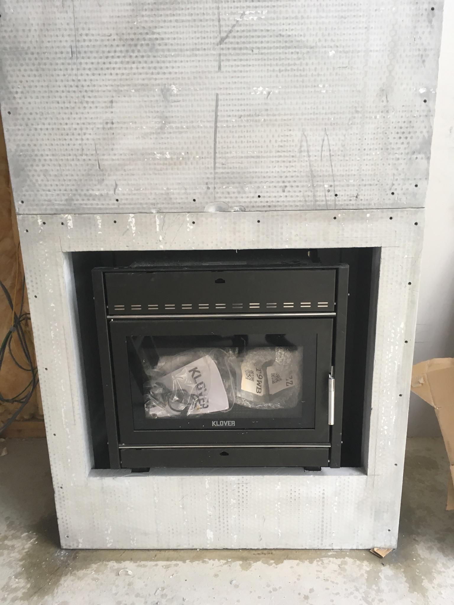

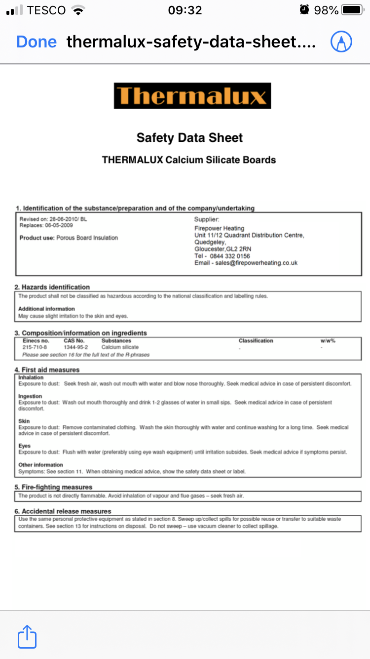

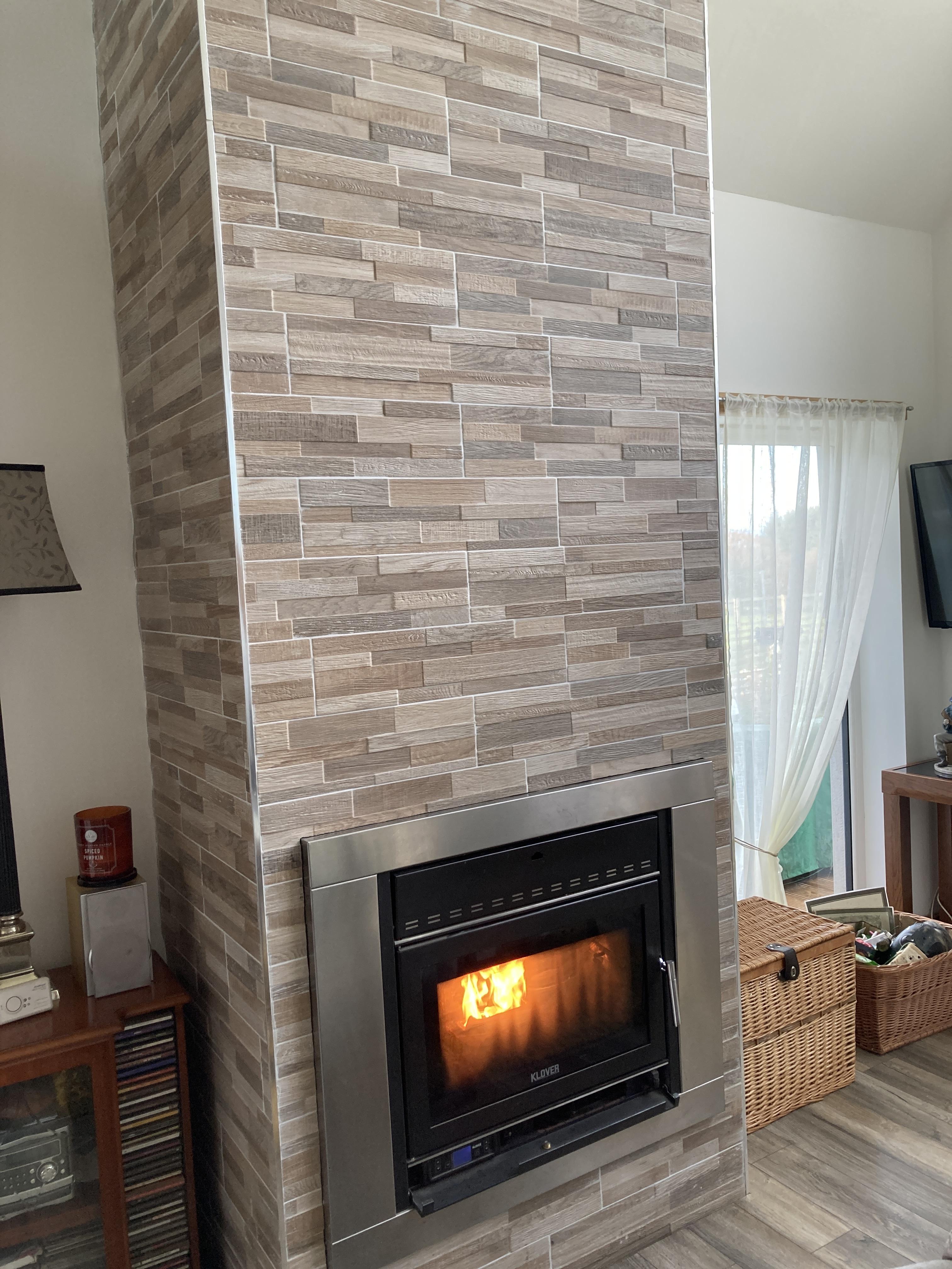

recoveringbuilder Posted October 21, 2020 Posted October 21, 2020 We have an insert pellet stove however originally it was to be a double sided wood burning stove, we have no chimney so a false wall was built using the attached product , this went right up to the ceiling (cathedral) with the flue inside then the black flue out through the roof, we then tiled the false chimney breast 1
