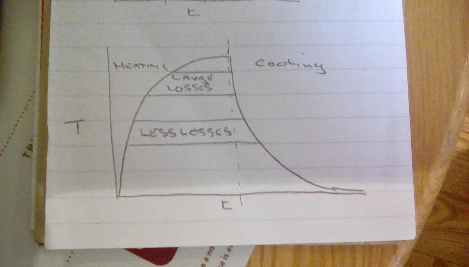

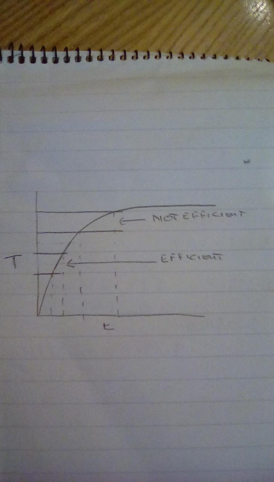

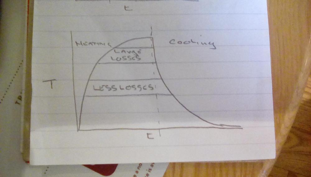

SteamyTea Posted October 25, 2020 Share Posted October 25, 2020 (edited) 32 minutes ago, gaschick said: The temperature of the boiler can be adjusted to between 65-85Oc. Temperature is not heat (heat is the old word for energy). The reason you can adjust the temperature is that there is sweet spot for effective heating, or reheating, the cooler returning water after it has been though the radiators. This sweet spot is generally after half the energy has been removed. So say your water leaves the boiler at 80°C and returns at 60°C, then the radiators, on average, should have a temperature of 70°C. [to get the ° sign, hold the Alt key down and then put in the number 248] So my estimate of 8kW sizing was a bit low, this is the problem of working with averages, rather than actual data. I also probably under estimated the DHW needed, I forgot you had a large 5 bed house. When using a heat pump, it is more normal to have them running constantly, or as close to that as possible. This is generally not how a thermal boiler is set up. They tend to put is a lump of energy, then none, then another lump. This is partly why they are not that efficient at converting chemical energy to thermal energy. The stated efficiency of a boiler is the maximum it can achieve in ideal laboratory settings, real life knocks a few percent off that figure. 18 minutes ago, gaschick said: We have just checked, and our boiler is set to just under 65oC. This is plenty warm enough for us! So it seems your boiler is a bit oversized as it it set to the lowest temperature. I don't know if it is possible to downgrade your boiler to a lower output, some can be changed with smaller jets. That would reduce the fuel used. I do not have much against oil boilers, they are pretty good and the emissions are not as bad as people think. There is price volatility in the fuel costs which can be an issue as we have got used to relatively low heating oil prices over the last decade. Generally electricity prices are less volatile and new generation capacity from renewables are now the cheapest method to increase capacity. So that should suppress prices long term. Edited October 25, 2020 by SteamyTea Link to comment Share on other sites More sharing options...

SteamyTea Posted October 26, 2020 Share Posted October 26, 2020 (edited) All comes down to the nature of heating and cooling. With a cooling curve. Edited October 26, 2020 by SteamyTea Link to comment Share on other sites More sharing options...
