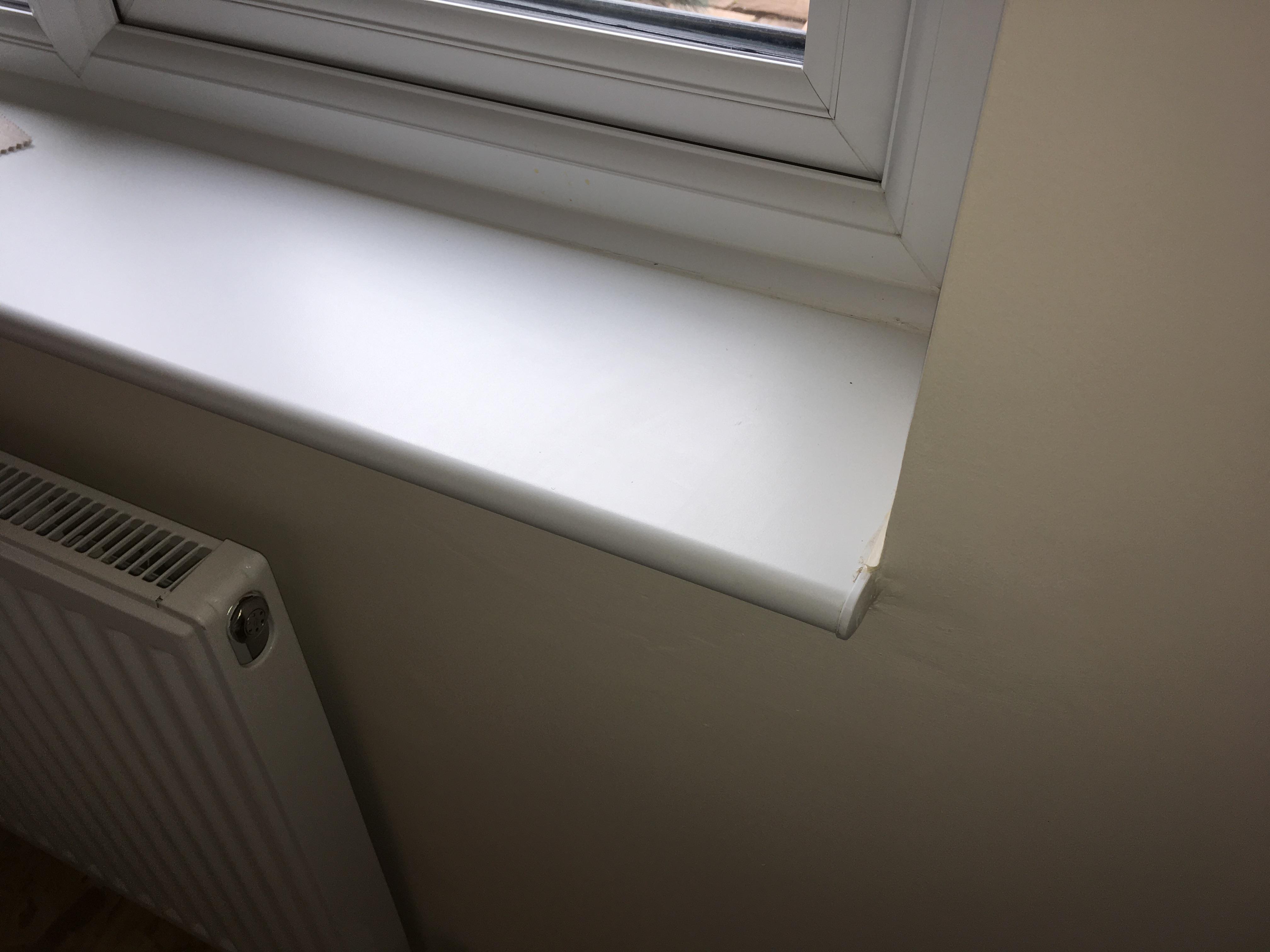

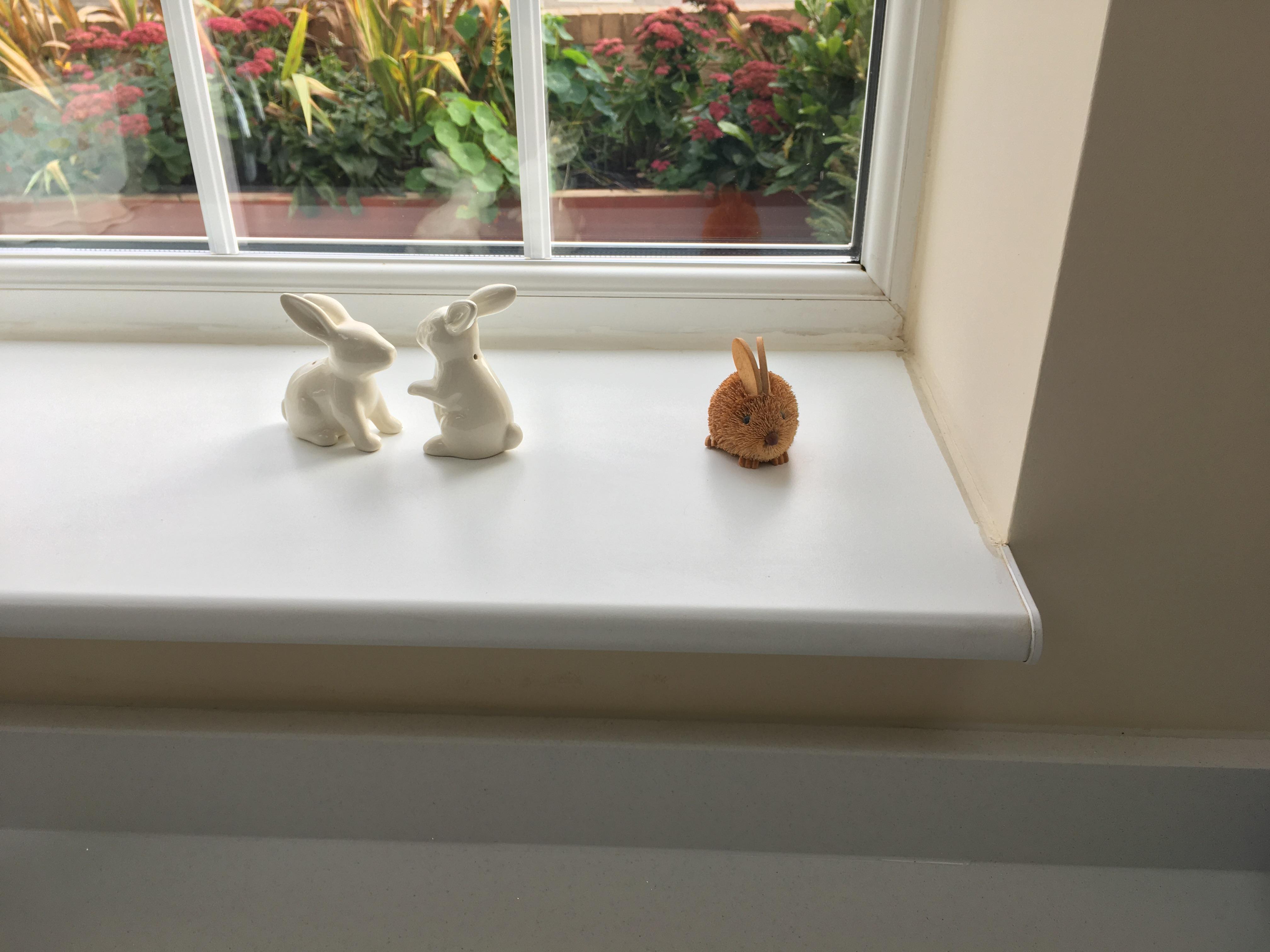

MikeGrahamT21 Posted October 16, 2020 Share Posted October 16, 2020 Duraboard gets my vote every time! Melamine faced Chipboard, real easy to keep clean and doesn't scratch easily unlike PVC. Link to comment Share on other sites More sharing options...
Oz07 Posted October 16, 2020 Share Posted October 16, 2020 Mdf won't warp if fitted properly. Suspect Dave means proper timber Link to comment Share on other sites More sharing options...
canalsiderenovation Posted October 16, 2020 Author Share Posted October 16, 2020 5 minutes ago, MikeGrahamT21 said: Duraboard gets my vote every time! Melamine faced Chipboard, real easy to keep clean and doesn't scratch easily unlike PVC. I've never heard of Duraboard, this looks good. So you don't have to paint it? Link to comment Share on other sites More sharing options...
MikeGrahamT21 Posted October 16, 2020 Share Posted October 16, 2020 Just now, canalsiderenovation said: I've never heard of Duraboard, this looks good. So you don't have to paint it? No its pre finished. If you've ever had laminate worktops, its basically just the same as that, but not as thick. Can send some photos of mine if you want? Link to comment Share on other sites More sharing options...
canalsiderenovation Posted October 16, 2020 Author Share Posted October 16, 2020 2 minutes ago, MikeGrahamT21 said: No its pre finished. If you've ever had laminate worktops, its basically just the same as that, but not as thick. Can send some photos of mine if you want? That would be really appreciated @MikeGrahamT21 thanks. Link to comment Share on other sites More sharing options...
MikeGrahamT21 Posted October 16, 2020 Share Posted October 16, 2020 9 minutes ago, canalsiderenovation said: That would be really appreciated @MikeGrahamT21 thanks. Link to comment Share on other sites More sharing options...
canalsiderenovation Posted October 16, 2020 Author Share Posted October 16, 2020 Thanks @MikeGrahamT21 I have issues with the end caps! Link to comment Share on other sites More sharing options...
MikeGrahamT21 Posted October 16, 2020 Share Posted October 16, 2020 (edited) 10 minutes ago, canalsiderenovation said: Thanks @MikeGrahamT21 I have issues with the end caps! Yeah? How so? I think they really finish them off nicely. You could always get some of the iron on melamine strips and use those if you wanted? Edited October 16, 2020 by MikeGrahamT21 Link to comment Share on other sites More sharing options...
canalsiderenovation Posted October 16, 2020 Author Share Posted October 16, 2020 1 hour ago, MikeGrahamT21 said: Yeah? How so? I think they really finish them off nicely. You could always get some of the iron on melamine strips and use those if you wanted? I don't know, I think it's how they sit on. My parents something similar on their UPVC ones and they keep falling off. Link to comment Share on other sites More sharing options...
MikeGrahamT21 Posted October 16, 2020 Share Posted October 16, 2020 38 minutes ago, canalsiderenovation said: I don't know, I think it's how they sit on. My parents something similar on their UPVC ones and they keep falling off. mine don't come off, they're glued on, bit of gripfill ? First photo ones have been on since 2012 Link to comment Share on other sites More sharing options...
