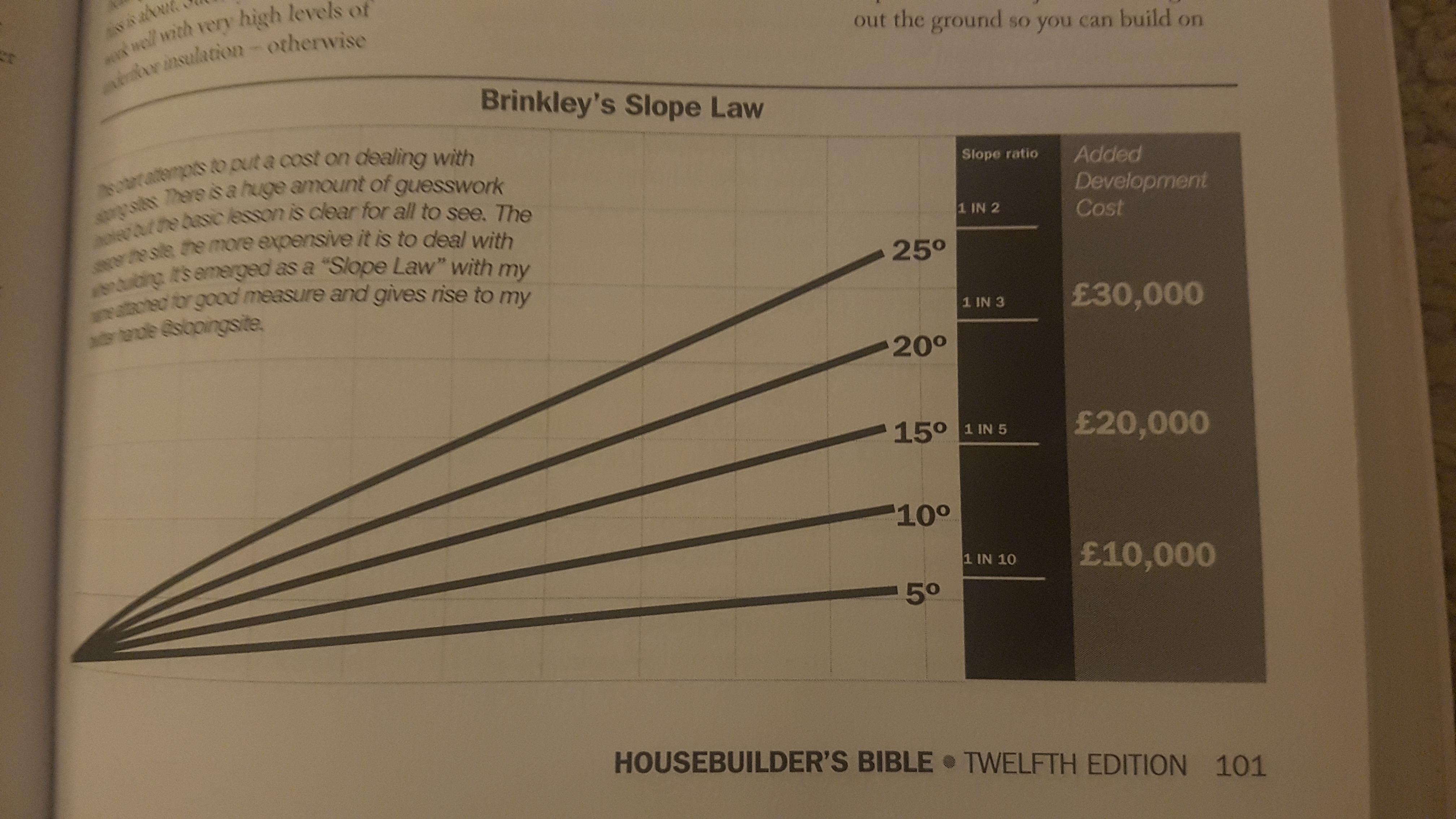

Thedreamer Posted October 15, 2020 Share Posted October 15, 2020 3 minutes ago, Kirsty said: Hi All, We are at the very beginning of our self build journey. We’re trying to work out if we can even afford to do this at all?? We have seen a plot which is in our ideal location but it’s on a steepish slope so not sure if this will make building on it too expensive for us. We’re really just looking for any advice on where to start. Any particular threads that are worth a read or any book recommendations for a total novice? Thanks Home Builder's Bible, well worth a purchase. On the slope there is actually a diagram in the book that suggests what extra % you pay when building on a sloping site. Link to comment Share on other sites More sharing options...

Moonshine Posted October 16, 2020 Share Posted October 16, 2020 (edited) Here is the @Thedreamer referance, and suggest getting the book. We have a sloping garden plot which we got planning for, which is off the above chart. We knew that the slope was always going to be the unknown, and a big cost without knowing the full extent of it. However we have tried to minimise the area of the basement that is getting cut into the slope. We probably won't know the cost to do the ground works until we are sat on the block and beam at 'ground level. Though we are getting some ground investigation work done and a structural engineer to design the retaining walls (Looking at £5k for both these things) Once these specs are know we are going get ground workers to quote on the work. Only then will we have an informed idea of cost. My hope is that because my site is dense sand I will able to use a raft and solid retaining walls. If I have to use piles then I am a bit stuffed as they are expensive. How steep is the slope and what are the ground conditions? E.g. clay is bad and you will need some expensive foundations. Maybe the plot is still on the market is because it's not a financially feasible site for them? Edited October 16, 2020 by Moonshine 1 Link to comment Share on other sites More sharing options...

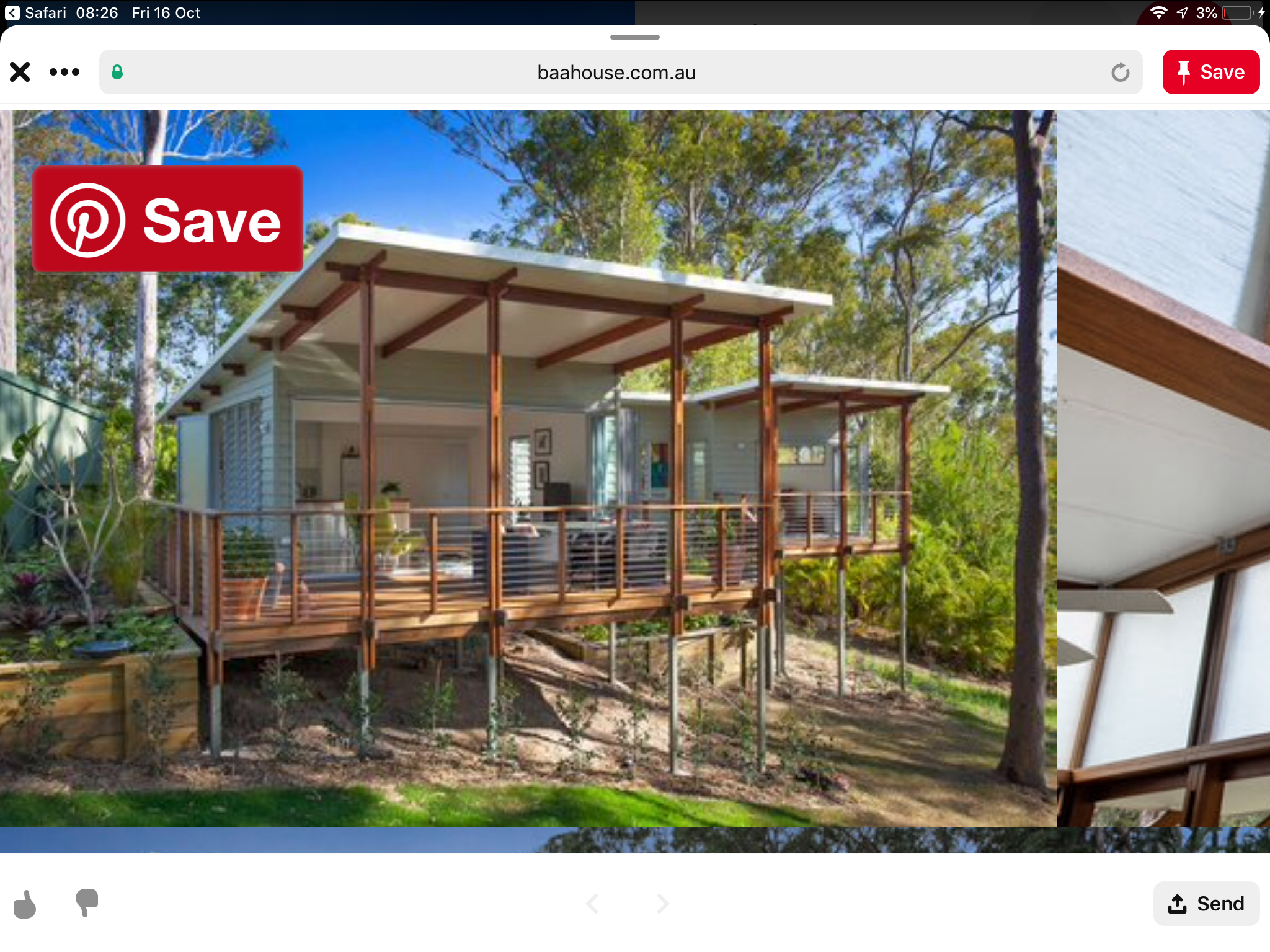

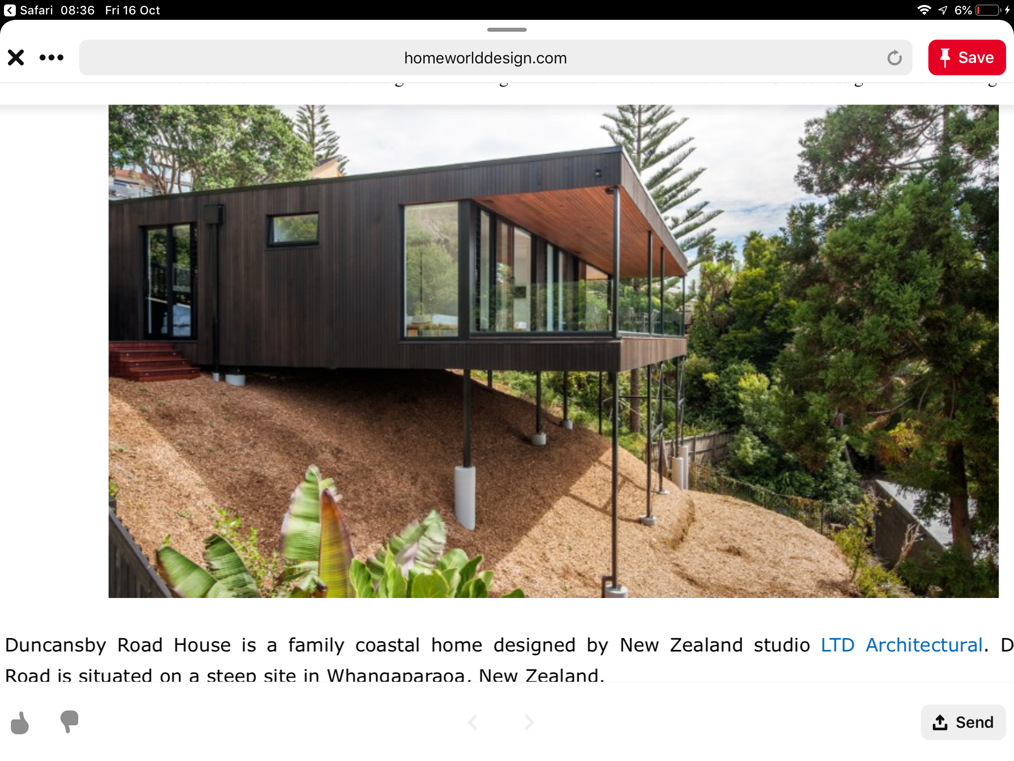

Russell griffiths Posted October 16, 2020 Share Posted October 16, 2020 (edited) I think in this country we seem to think that a house has to be stuck to the ground, other countries like America and Australia build on far greater slopes than we have because they are not restricted by our boring house building. Edited October 16, 2020 by Russell griffiths Link to comment Share on other sites More sharing options...
