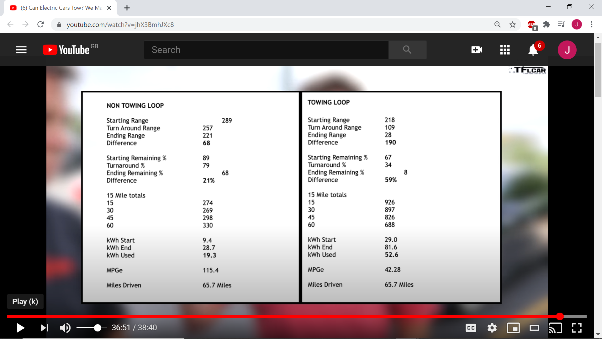

Ferdinand Posted October 15, 2020 Posted October 15, 2020 An interesting little video about towing a double horsebox (2 tons ish) with a Model X. USA so using air conditioning for the first half. Cut and paste of fuel consumption screen below. It tows but the energy consumption suffers more than a little. F
Thorfun Posted October 15, 2020 Posted October 15, 2020 but 42.28 mpg is still better than a 'gas guzzling diesel' twin cab, right? and when you're not towing you get that lovely electric drive that just can't be beaten. ? and also doing your bit for the planet at the same time! win-win in my books.
Ferdinand Posted October 15, 2020 Posted October 15, 2020 1 hour ago, Thorfun said: but 42.28 mpg is still better than a 'gas guzzling diesel' twin cab, right? and when you're not towing you get that lovely electric drive that just can't be beaten. ? and also doing your bit for the planet at the same time! win-win in my books. The other minor issue is that they report it was taking 1% of battery capacity per mile of journey. And after they realised it would not reach home and turned on econo-max it still had a Max range of around 125 miles with the horsebox in tow. So the current solution would be to take the Tesla, but make like Roy Rogers for the rest of the journey when it ran out of batteries. ? Another few years yet. I’m another one that is waiting.

LSB Posted October 15, 2020 Author Posted October 15, 2020 3 hours ago, Ferdinand said: An interesting little video about towing a double horsebox (2 tons ish) with a Model X. USA so using air conditioning for the first half. Cut and paste of fuel consumption screen below. It tows but the energy consumption suffers more than a little. F thanks for this.
LSB Posted October 15, 2020 Author Posted October 15, 2020 2 hours ago, Thorfun said: but 42.28 mpg is still better than a 'gas guzzling diesel' twin cab, right? and when you're not towing you get that lovely electric drive that just can't be beaten. ? and also doing your bit for the planet at the same time! win-win in my books. very much so, but I would like to point out that I do less than 2k a year in it, my other car (well hubbys) is much smaller and more economical for commuting, which I only do 2 days per week as I work from home the rest of the time. Living in the back of beyond doesn't make for a lot of planet friendliness, no buses, trains, too far to cycle / walk unless just going out for fun. But, the barn conversion will be different, ASHP, PV, rainwater harvesting and maybe even a windmill, certainly in the future. 1
LSB Posted October 15, 2020 Author Posted October 15, 2020 1 hour ago, Ferdinand said: The other minor issue is that they report it was taking 1% of battery capacity per mile of journey. And after they realised it would not reach home and turned on econo-max it still had a Max range of around 125 miles with the horsebox in tow. So the current solution would be to take the Tesla, but make like Roy Rogers for the rest of the journey when it ran out of batteries. ? Another few years yet. I’m another one that is waiting. so, you are suggesting getting the horses to tow the car & trailer ??
