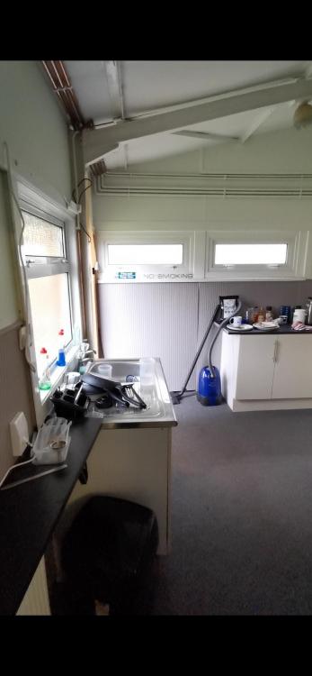

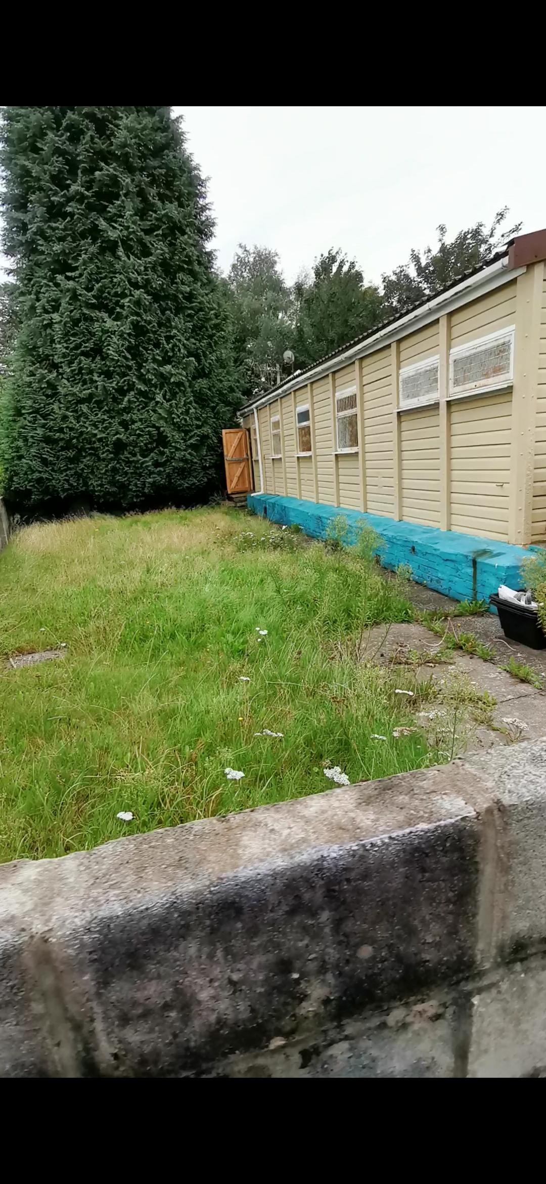

October 13, 20206 yr Author Temp Where can I find a page that specifies what building regs requires so that I can show a building control officer once he's on site, any ideas please Also the building was only bought recently and it is currently tenanted but when I viewed the building before purchasing it seemed a solid floor! There is no timber work in the building as far as I know, it is concrete posts and slabs for the building and steel frame for the roof which are also buried into the ground as pictured No signs of any water leakage so I think it's pretty water tight and sturdy building just interesting to see what building control think

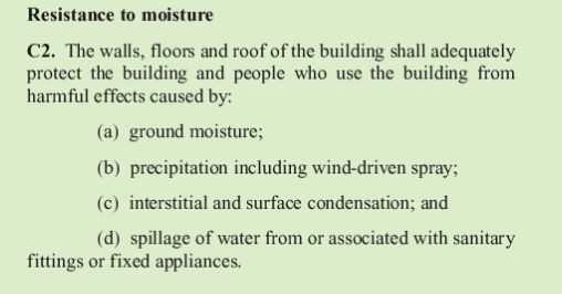

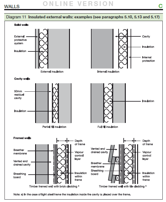

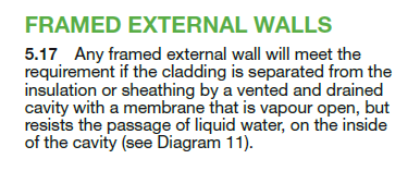

October 13, 20206 yr 1 hour ago, Tiaan davies said: Where can I find a page that specifies what building regs requires so that I can show a building control officer once he's on site, any ideas please Regarding cavities... The Building Regulations are somewhat vague but they are the ONLY legal requirements. The so called "Approved Documents" is what most people work to.. https://www.gov.uk/government/collections/approved-documents These outline ways of meeting the Building Regulations. They are not legal requirements so you are free to adopt other ways of complying, however BCO sometimes treat them as if they are mandatory and the only way of complying. Approved Document C covers water ingress.. https://assets.publishing.service.gov.uk/government/uploads/system/uploads/attachment_data/file/431943/BR_PDF_AD_C_2013.pdf Each Approved Doc has a section in green near the beginning that references the relevant section of the Building Regulations (the law). In this case see page 5. Diagram 11 on page 33 covers external insulation. If the walls are concrete I would suggest the nearest option is top left (External Insulation of solid walls). Thats EWI with a cladding board and render or similar waterproof "protective system". However there is a section for "framed" external walls. This was probably intended to refer to timber framing but the BCO might interpret it to mean any type of framing (eg concrete posts and concrete panels). That option is EWI, Membrane, Cavity, Cladding. You will have to propose whatever external cladding solution you want and see what the BCO says. As for how thick the insulation deeds to be that's a whole different ball game and I'm out of date with the figures.
