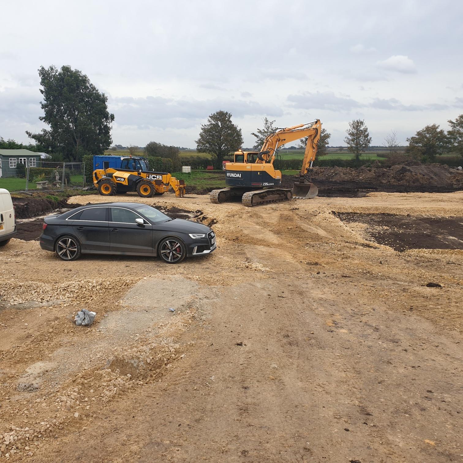

Faz Posted October 12, 2020 Author Posted October 12, 2020 I did my ticket last week (£1250 plus vat) so good to go on the forks - you are spot on with the comment though - park it up in travel mode with the forks on the ground and even every time you leave it. I have to say though that the handbrake on thing before adjusting the boom went out of the window early doors - am talking about tweaks on levels running over the site btw. We bought the machine rather than have it on hire - £1560 pcm we were quoted for hire - bought it for £26k. Dug & poured Plot 1 last week, dug plot 2 today with the pour tomorrow and mine is a 2 day dig with the pour on Friday. All rain dances are banned! It is starting to cut up bad!
Faz Posted October 12, 2020 Author Posted October 12, 2020 The forks wasn't parked up in that photo btw - I was just policing up the barriers after the concrete had gone off and was on a fag break! All was left neat & tidy!

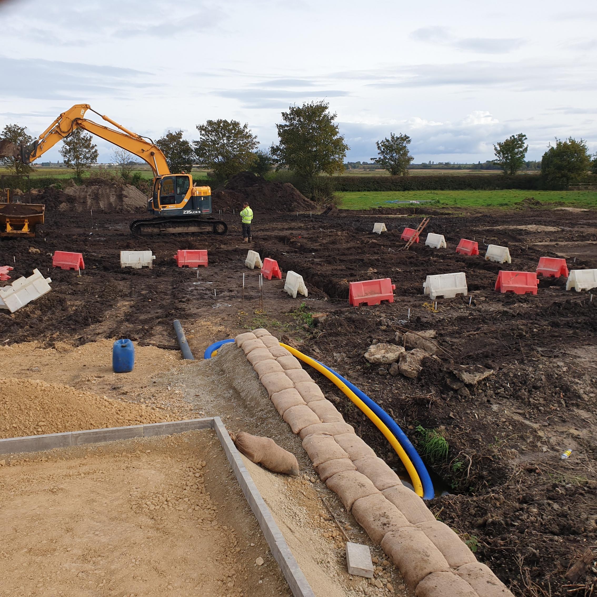

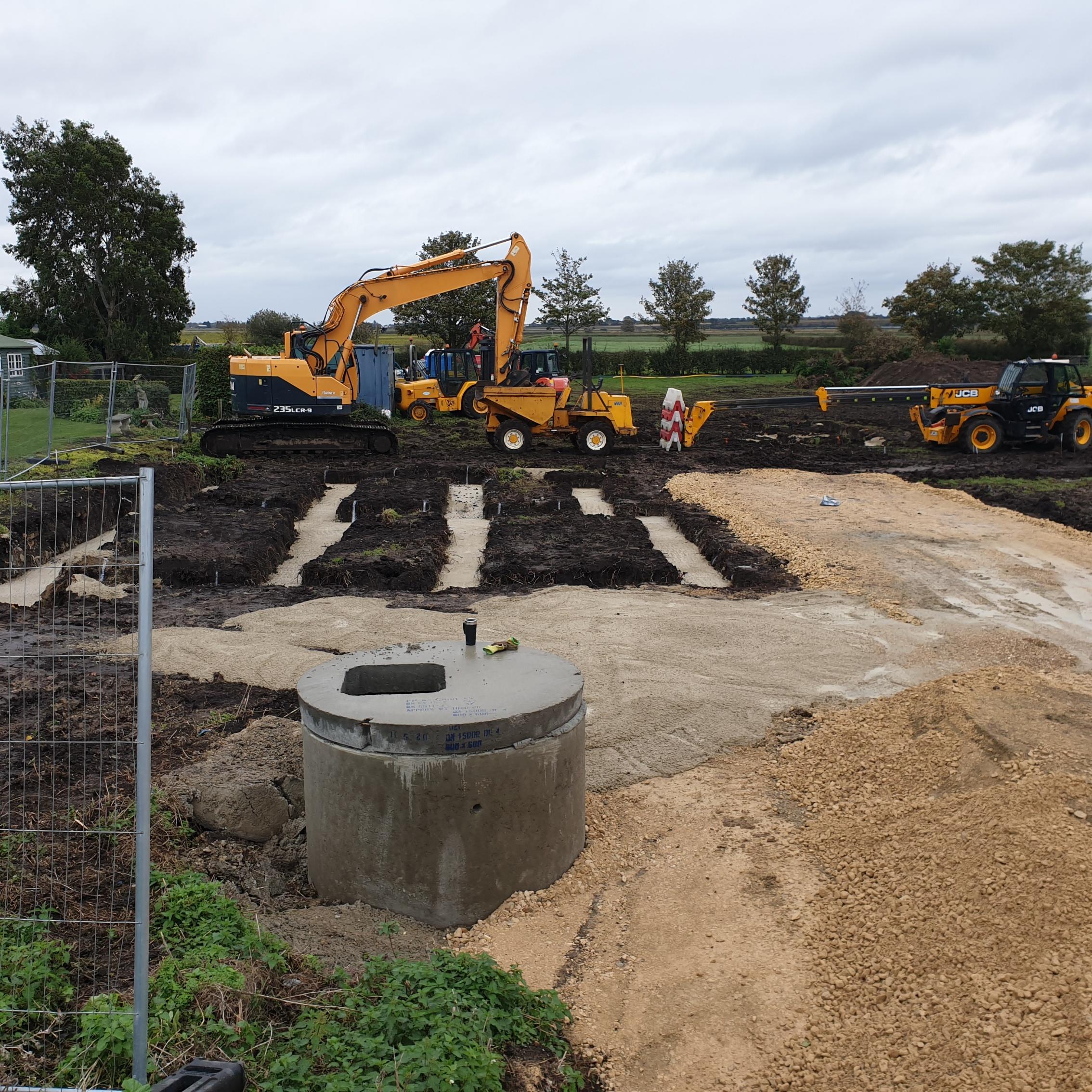

Faz Posted October 15, 2020 Author Posted October 15, 2020 The plot 1 foundation wasn't as much of a success story as I had hoped - the lad on the concrete pump must have dozed off and poured over the nails setting out the levels - we were 50mm up in one corner - brickie not happy (mind you - when have you ever found a happy brickie?) Plot 2 went better as I stood over them - >5mm tolerance. My monster goes in tomorrow. The ground is cutting up real bad - we are on peat here so I ordered 160 tonne of 50mm clean for Monday to stone up the rear of the plots.
Oz07 Posted October 15, 2020 Posted October 15, 2020 Was it worth those barriers!? Looking good apart from that
Faz Posted October 15, 2020 Author Posted October 15, 2020 We already had them mate from our last job in London - needed to stick them somewhere so brought them up here. I just thought that spacing them around the holes to protect idiot trespassers from themselves didn't hurt. We will use them going forward to try and segregate pedestrian areas from vehicle zones. If we didn't have them I wouldn't have bought them specially for this job tbh. We brought a whole container of surplus kit from the last job (92 flats in Bromley) and not sure what we are going to do with a lot of it - 15 - 20 Graffe & Forza walnut FD30 doors of varying sizes - not going to use them here if anyone is interested? I reckon I have enough architrave to do at least 2 plots here all free courtesy of Graffe - they had no idea what they were shipping day to day that lot.

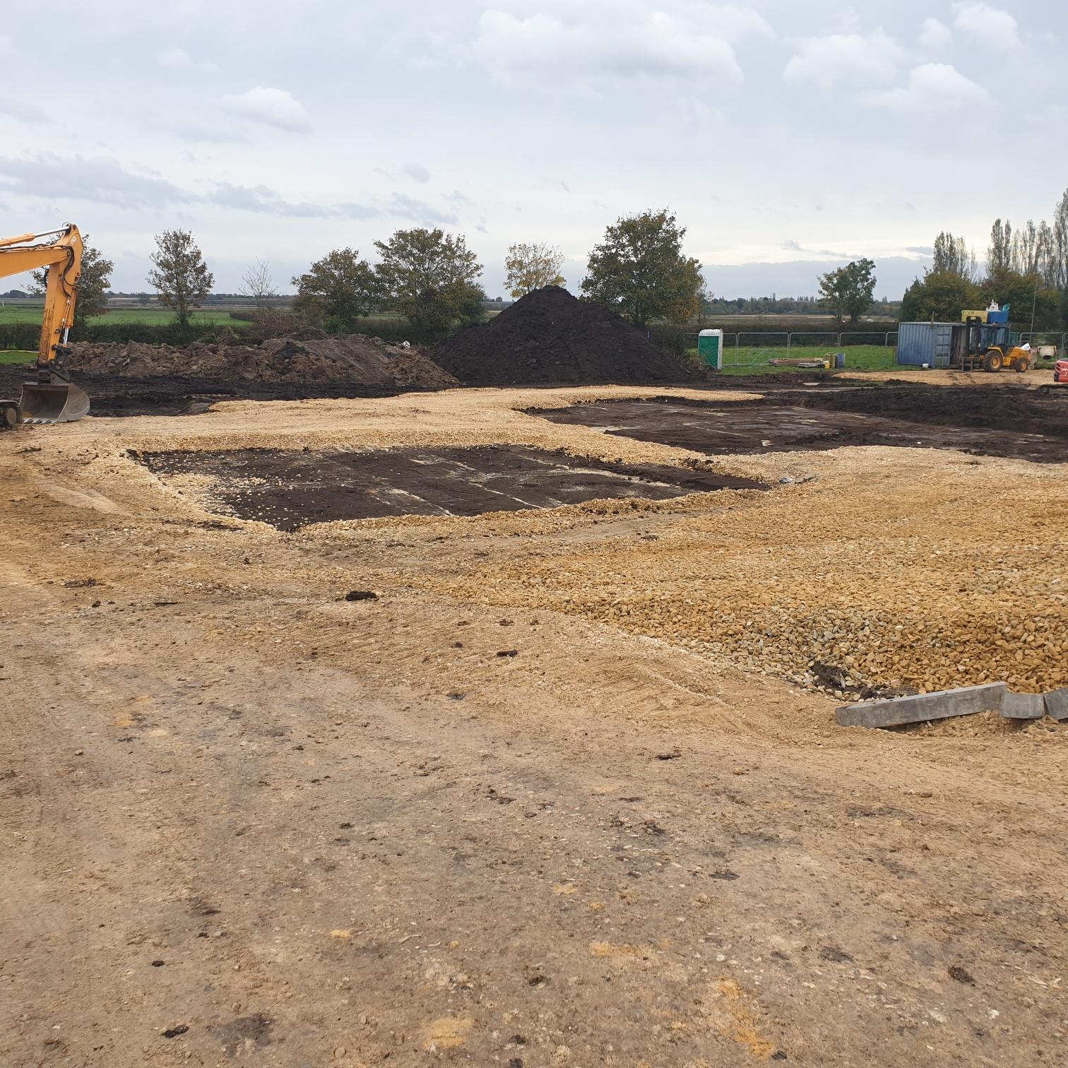

Faz Posted October 24, 2020 Author Posted October 24, 2020 Made some fairly decent progress - all 3 foundations dug and poured with minimal waste concrete (3 - 4 cube for the 3 houses plus the quad garage - I can live with that). 240T of 50mm clean limestone spread around the plots. The clay goes away next week (I found a local farmer who wants the stuff so loading and transport costs only - £2000 all in). Got water and power (borrowed from the neighbor) laid in yesterday so teas are now available in the cabin & water there for the mixing station. Getting tea laid on must be milestone No 2 after getting the concrete in! Bricks & blocks etc arrive next week and the brickie starts on the 3rd Nov. Game on. 1
