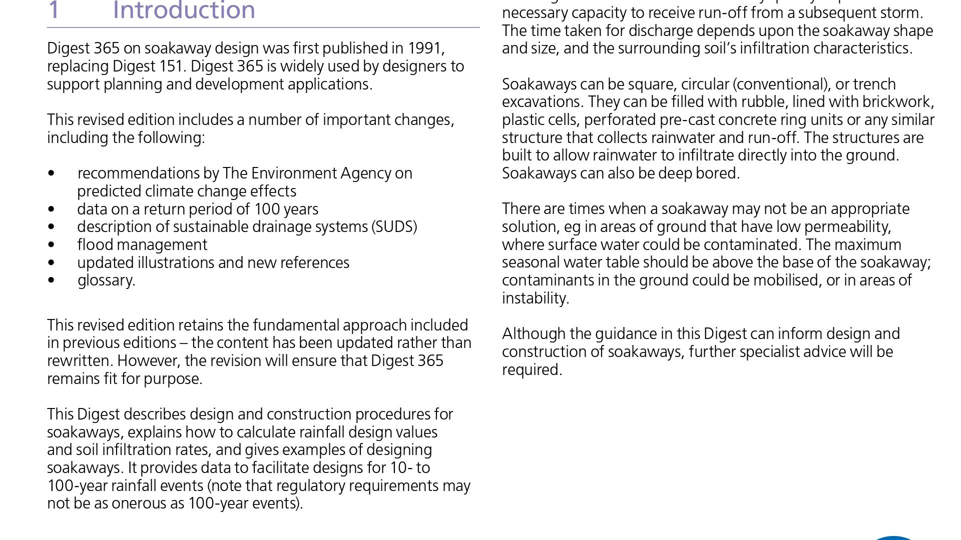

Moonshine Posted October 9, 2020 Author Share Posted October 9, 2020 41 minutes ago, Mr Punter said: Is there any chance to include a soakaway or permeable paving? There is, but trying to get my head round sizing of a soak away, I have been using bre365 but not sure of what rainfall rate to use 10 year, 30 year or 100 year return. Link to comment Share on other sites More sharing options...
jamieled Posted October 9, 2020 Share Posted October 9, 2020 For soakaway sizing it is the 10 year design event. Link to comment Share on other sites More sharing options...
Moonshine Posted October 9, 2020 Author Share Posted October 9, 2020 2 minutes ago, jamieled said: For soakaway sizing it is the 10 year design event. Thanks, have you got a source for that? Based on 10 year, the soak away size could be accommodated, and maybe better to work with two, one to the front of the house, one to the rear, rather one big one to the front. Link to comment Share on other sites More sharing options...
jamieled Posted October 9, 2020 Share Posted October 9, 2020 It's in my head ( sorry not helpful and it doesn't mean its correct). I just checked my work copy of the BRE digest which states the 10 year: Inflow to the soakaway I = A x R where: A = the impermeable area drained to the soakaway; R = the total rainfall in a design storm (a 10-year return period should be used); calculation of R is shown in the box below. Link to comment Share on other sites More sharing options...
Moonshine Posted October 9, 2020 Author Share Posted October 9, 2020 17 minutes ago, jamieled said: It's in my head ( sorry not helpful and it doesn't mean its correct). I just checked my work copy of the BRE digest which states the 10 year: Inflow to the soakaway I = A x R where: A = the impermeable area drained to the soakaway; R = the total rainfall in a design storm (a 10-year return period should be used); calculation of R is shown in the box below. Thanks, but I think that is older version, where as the 2016 version isn't as clear cut as that. Link to comment Share on other sites More sharing options...

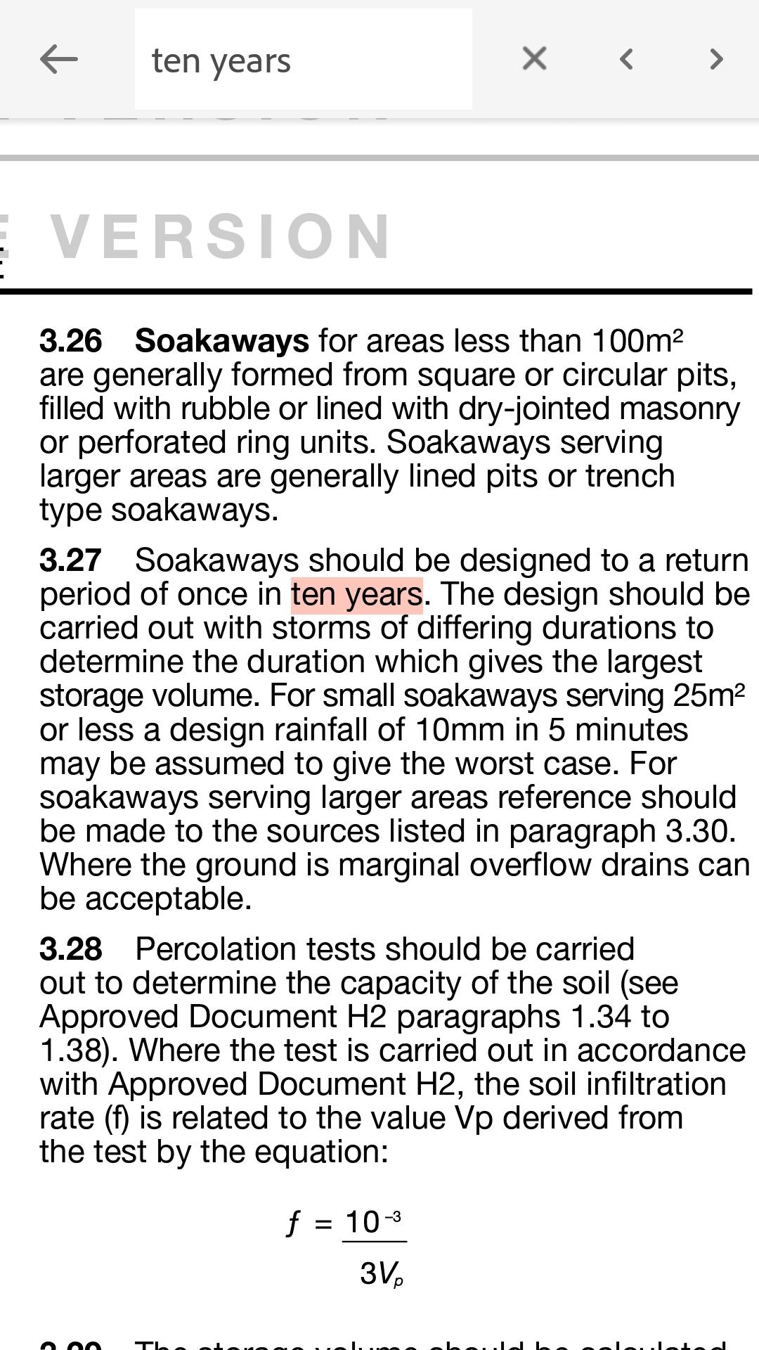

jamieled Posted October 9, 2020 Share Posted October 9, 2020 It's possible (depending on where you are) that it is your local authority who will dictate what the design standards now rather than bre. Some of them publish their drainage standards. Link to comment Share on other sites More sharing options...
Moonshine Posted October 10, 2020 Author Share Posted October 10, 2020 8 hours ago, jamieled said: It's possible (depending on where you are) that it is your local authority who will dictate what the design standards now rather than bre. Some of them publish their drainage standards. I have just had a closer look at approved document H (I obviously didn't read it properly) which states ten years. I wonder if build control may ever ask for more than that. Link to comment Share on other sites More sharing options...
